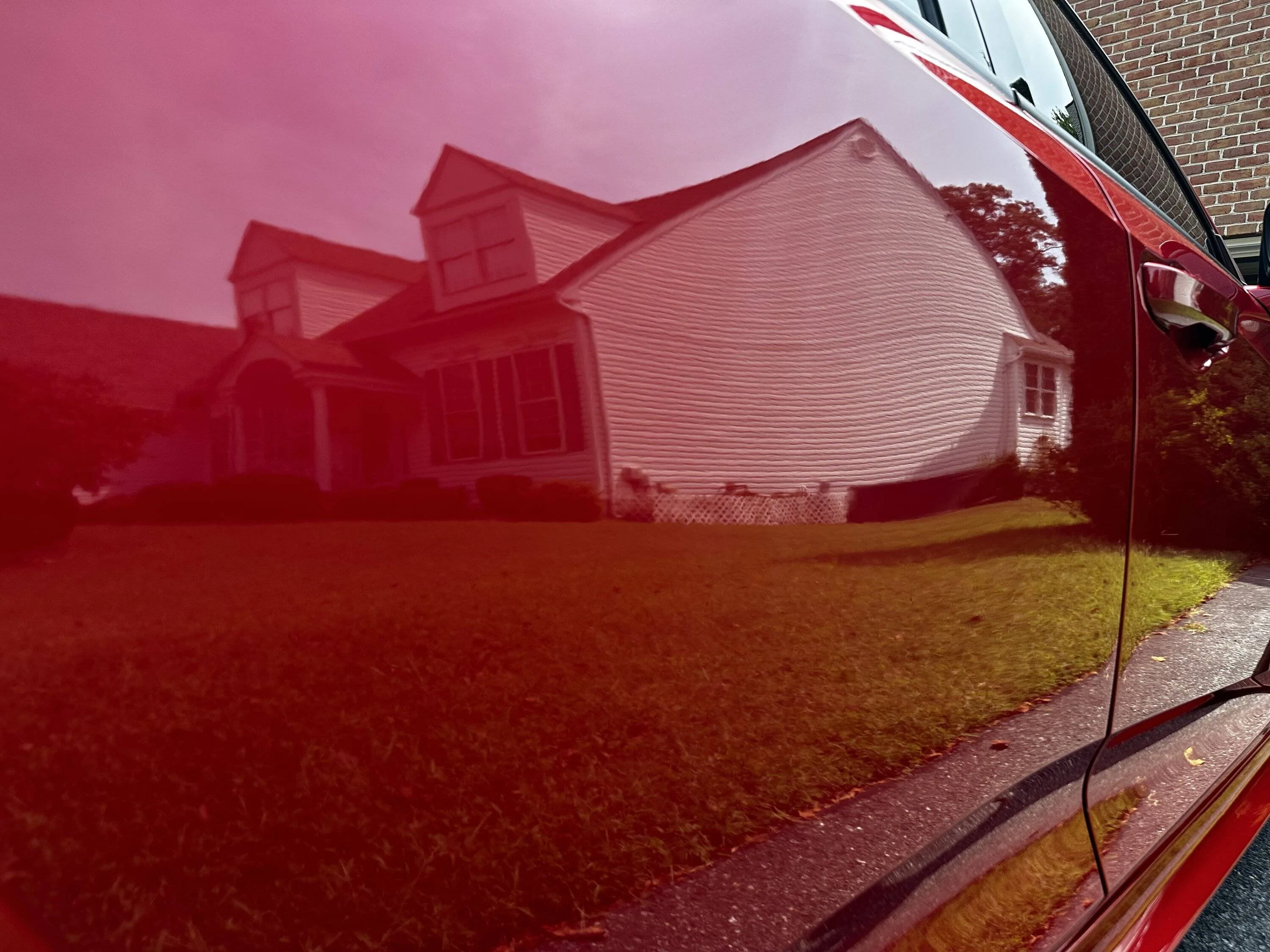

Ceramic is just an evolution of wax that last longer. No one should ever pay the ludicrous 4-figure sums I've seen tossed around for ceramic coating.
As for prep, sure some cars may need clay/polish from the factory but mine didn't- and trust that unless you're standing next to them, a "detailer" isn't going to clay and polish your car if they don't have to, yet they'll still charge you the same.
I basically followed the steps in the above video, used a "prep" spray that is basically isopropyl alcohol, and applied about half of a $180 bottle of AMMO Reflex Pro (old formula) in ~30 minutes, and I could shave in the reflection of my doors.
