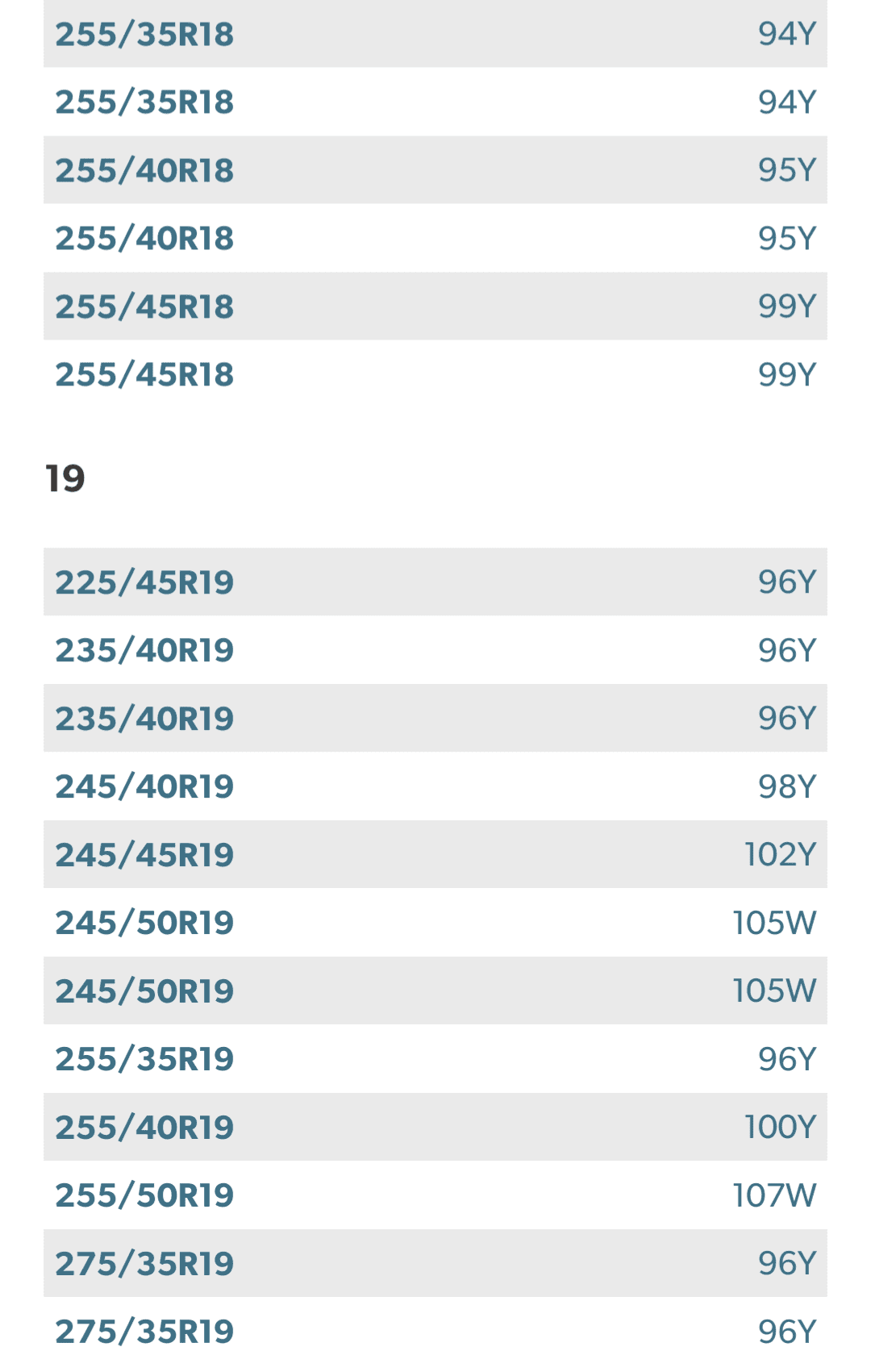

Vredestein have limited sizes.. 255 max width in 18s
Acura Integra Winter Tire Specs (Type S) Screenshot_20230724-085916
