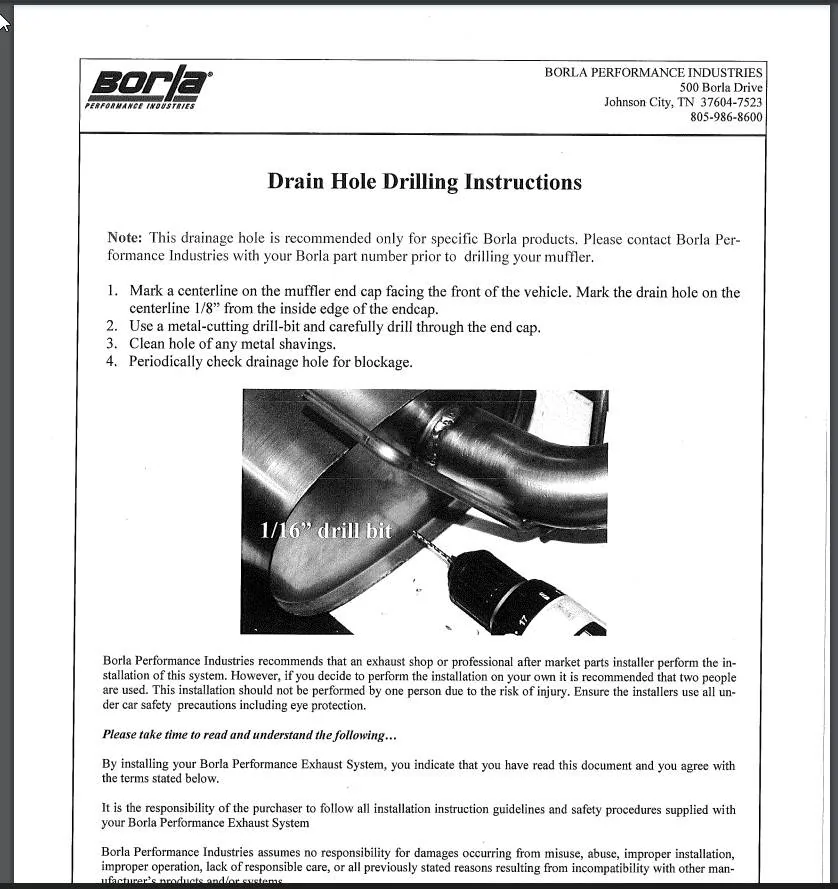

While this was true with older cars. Some water in the exhaust is normal; combination of condensation and natural combustion by product.
As the engine heats up or if driven the moisture will evaporate or burn off. After a number of rotations by the pistons, it would vacuum the water vapor, there could be a small number of droplets in the exhaust but i do believe modern cars and Hondas have weep holes in the mufflers.
Weep holes are like drain holes to allow water to escape. During summer time your exhaust system heats up quickly enough to evaporate water; so you'll notice in the winter it looks like your exhaust tips are dripping out water.
I haven't checked the Type S three mufflers to verify we do have weep holes but we can easily drill 2mm or 1/6" holes at the low point to drain water if the concern is rusting. This is commonly necessary for aftermarket exhaust systems as they don't drill weep holes for you.
Edit: Forgot to add that these honda/acuras should have 409 stainless steel or aluminized stainless steel mufflers. Cheap exhaust are the aluminized ones. So rusting would take a very very long time.
Acura Integra Winter Storage borla drain hol

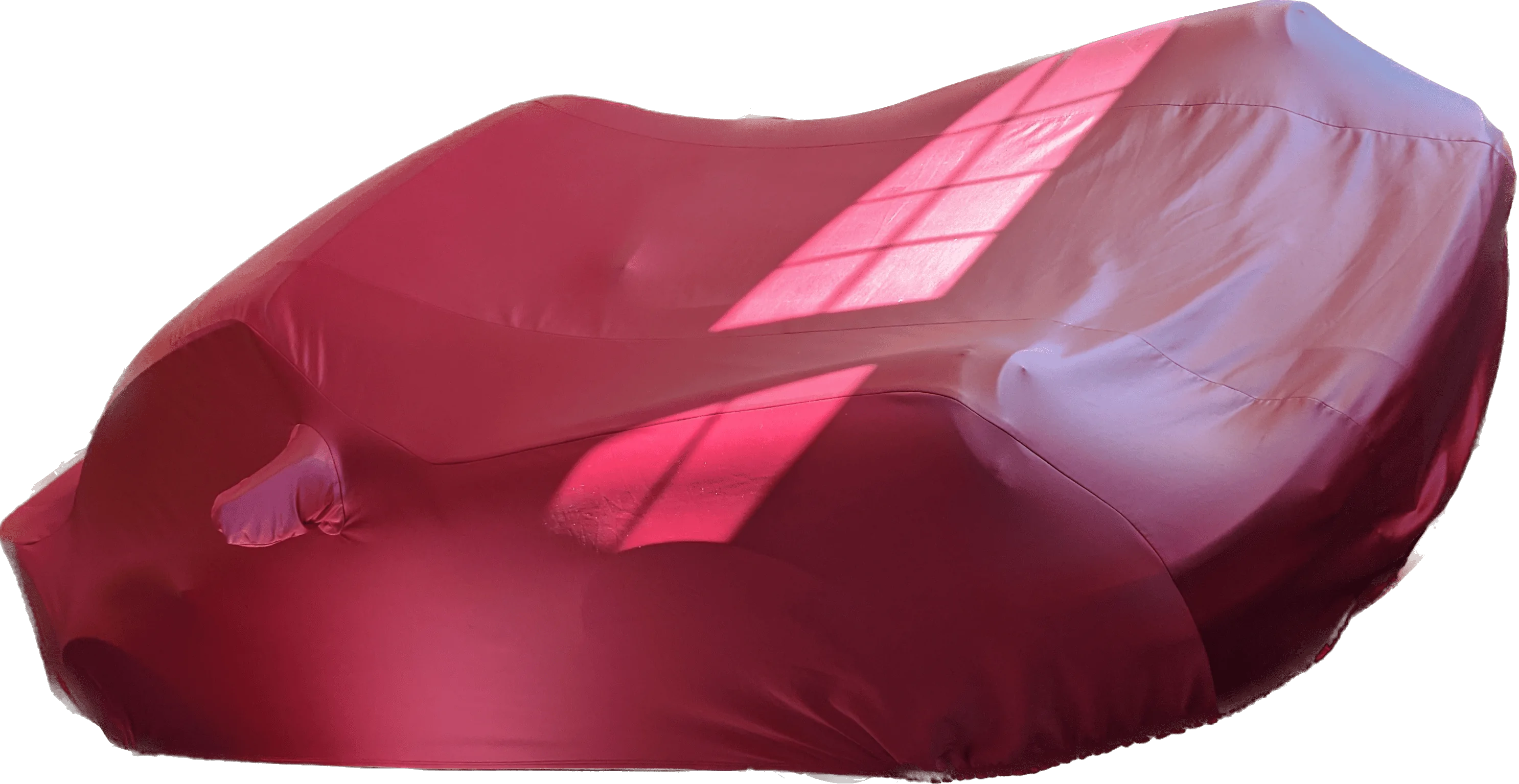

https://www.carbag.com/shop/carjacket/m2/
helps keep out mice.
I have been using one to store the 911 for years with good results.
We get a deal on the car itself and shafted for everything else. Is there anywhere us Canadians could pick up this or a similar zip up car cover in Canada and avoid paying almost 50% of the price in shipping and duties?
Maybe it's just me but it seems much harder to find than it should be.

As a person of French Canadian descent I’m not sure why shipping is so high to our neighbors in the north.
The car bag is nothing more than a tarp with a zipper on 3 sides. Simple but effective bordering on genius.
