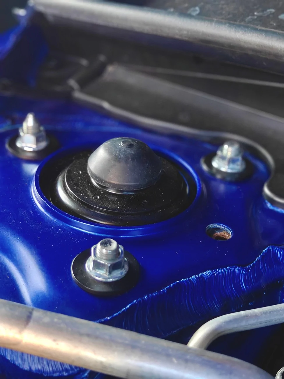

Did some.lught wrenching today.. installed the Wunderladen strut locking washers so that the struts don't shift when I'm removing the nuts for the strut tower bar or if I need to access the battery.
Is it easy for the struts to shift when the nuts are removed when the car’s on the ground? I remember the dealer was concerned with removing my strut bar to replace the battery and messing up the alignment.

If you're maxed out on factory camber with the pins removed it shouldn't be an issue. However if you're dialed in to a specific setting, it could be a problem. The wheels would want to naturally camber in more when the nuts are off.

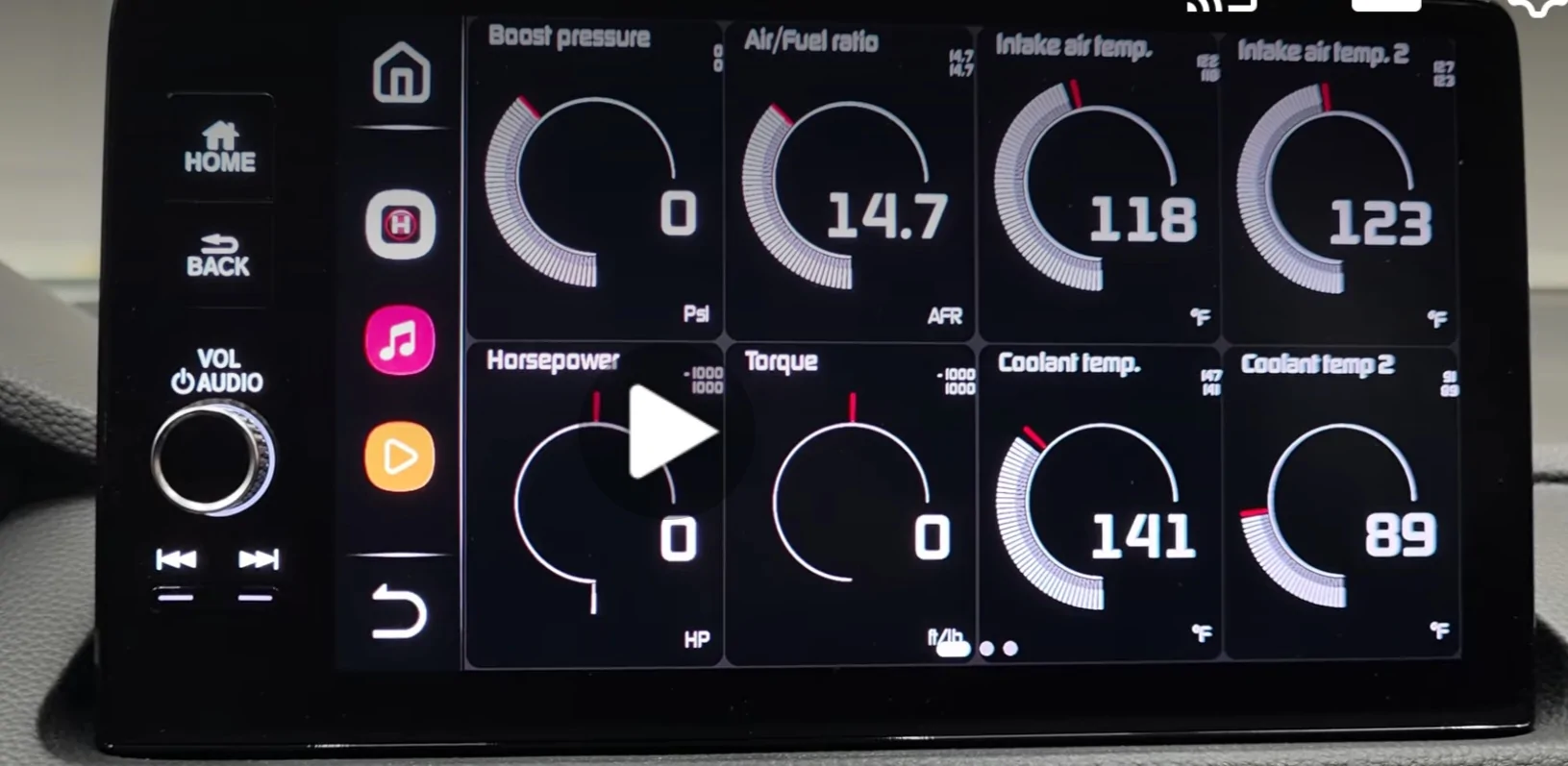

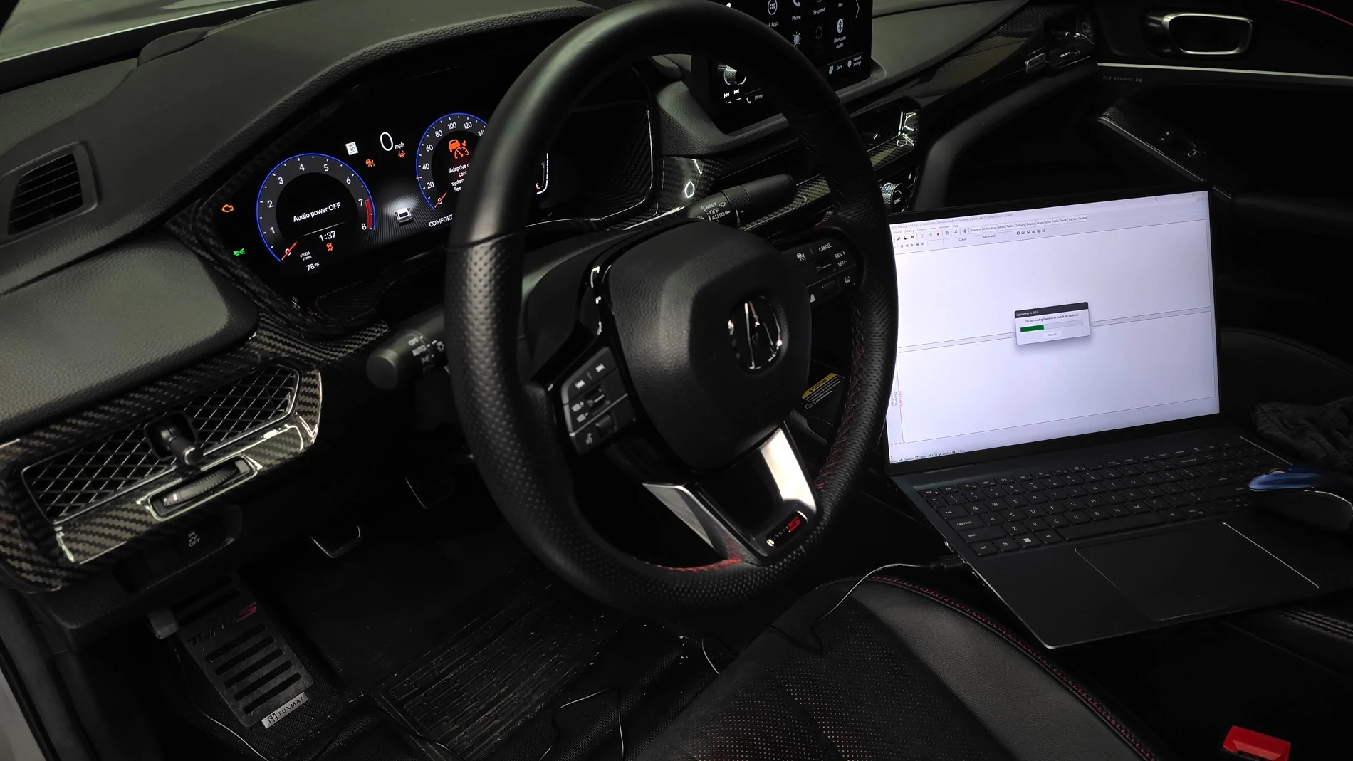

Still playing catch-up, flashed a couple weekends ago, I flashed to Phearable Stage 2, got metrics on my infotainment via Autolinkr/Android this past weekend.

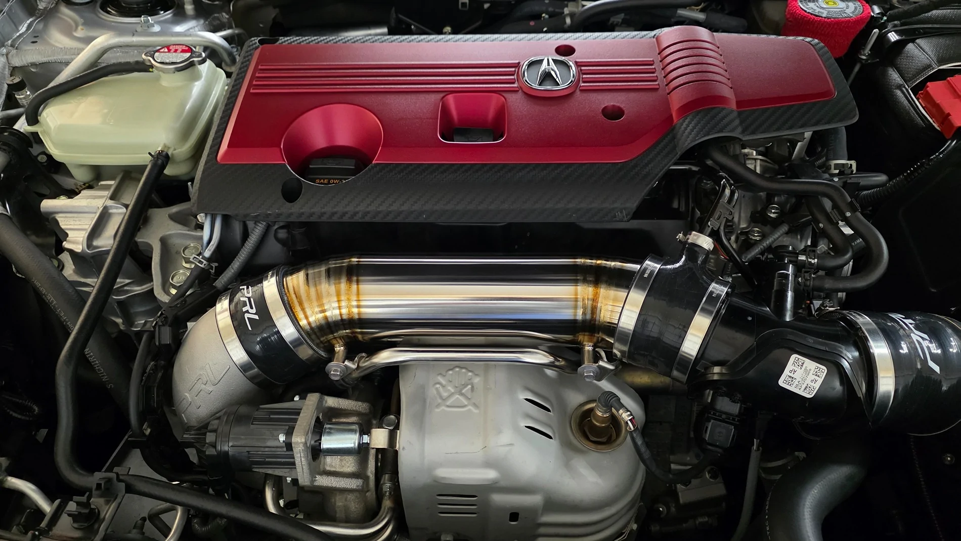

Installed a PRL engine mount & inlet today.
How did your poll rate end up looking?
