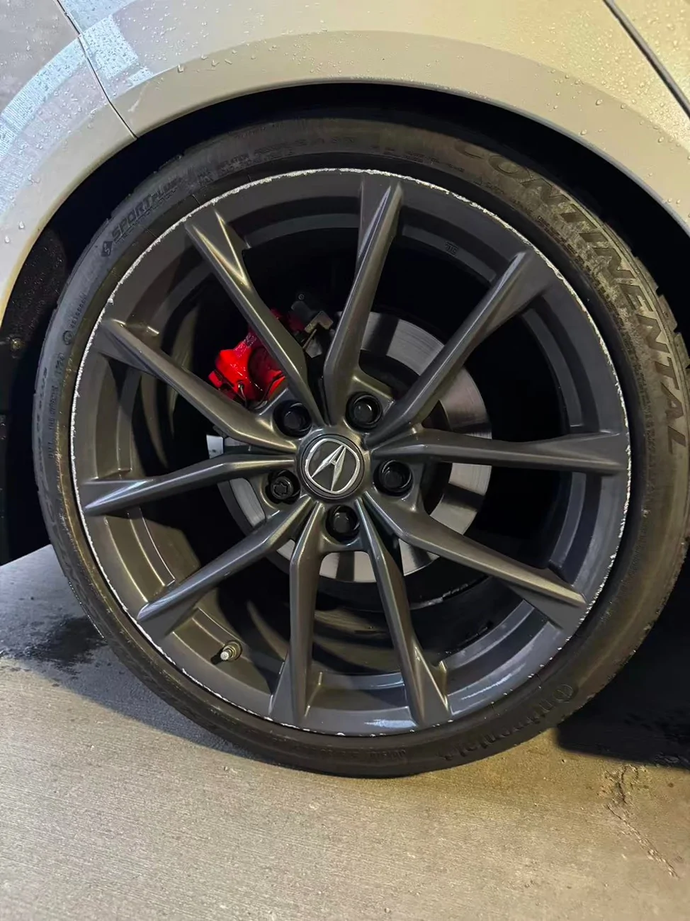

I did a boo boo, got the wheel and tire protection package so hopefully they fix it
You don't have ceramic do you? Make sure to strip it first if you do.
My experience with the dealer service from whoever they subcontract has been marginal... They damaged my wheel where the wheel weights were by using something metal/hard to pry off, they didn't clean the lube off, they used the wrong color wheel weight after (factory is black), and the wheel wasn't correctly balanced. The curb rash got fixed, at least... 😐
