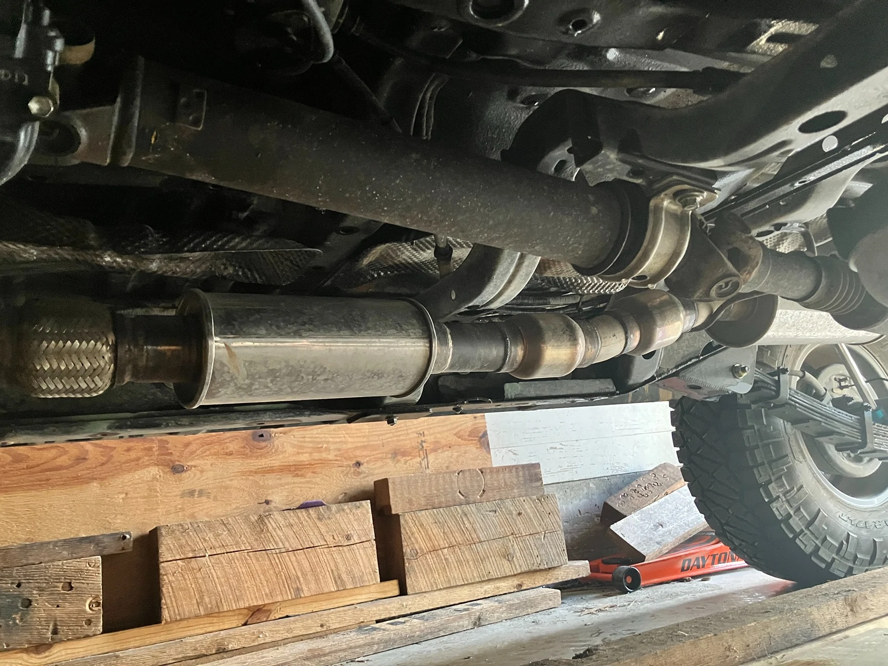

If you run out of room between the resonators and need a bit more you can always run some mini resonators... I have two between my vibrant resonators on my off road truck and they killed some rasp and drone and it sounds great since the entire exhaust is no more than 4.5' long.... Pic below and link to product https://www.totalflowusa.com/mini-race-universal-mufflers
