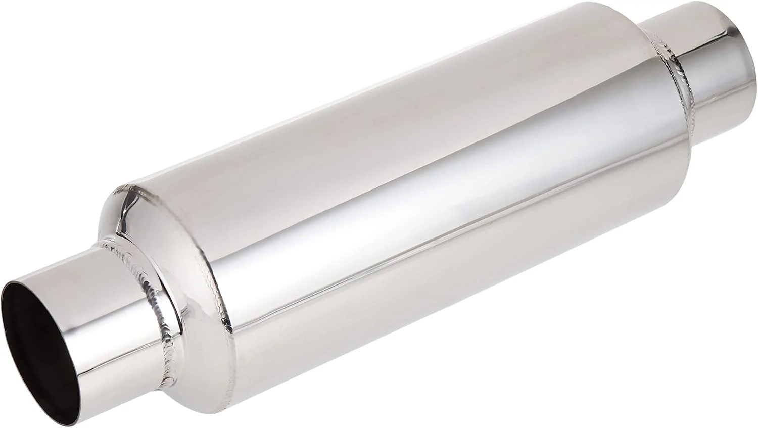

Ordered Vibrant 1142 (Ultra Quiet) and 17950 (bottle) resonators which arrive tomorrow, and will see which of the two will fit in the space available. The UQ should technically be quieter than the bottle, but the bottle is much longer so it could be about the same. I bought both to up the odds of one of them fitting.
Will report in after!
Probably very similar at idle and part throttle. I’m sure the uq will be a hair better at calming down rasp and what not beyond 2.5k rpm
both solid choices imo
