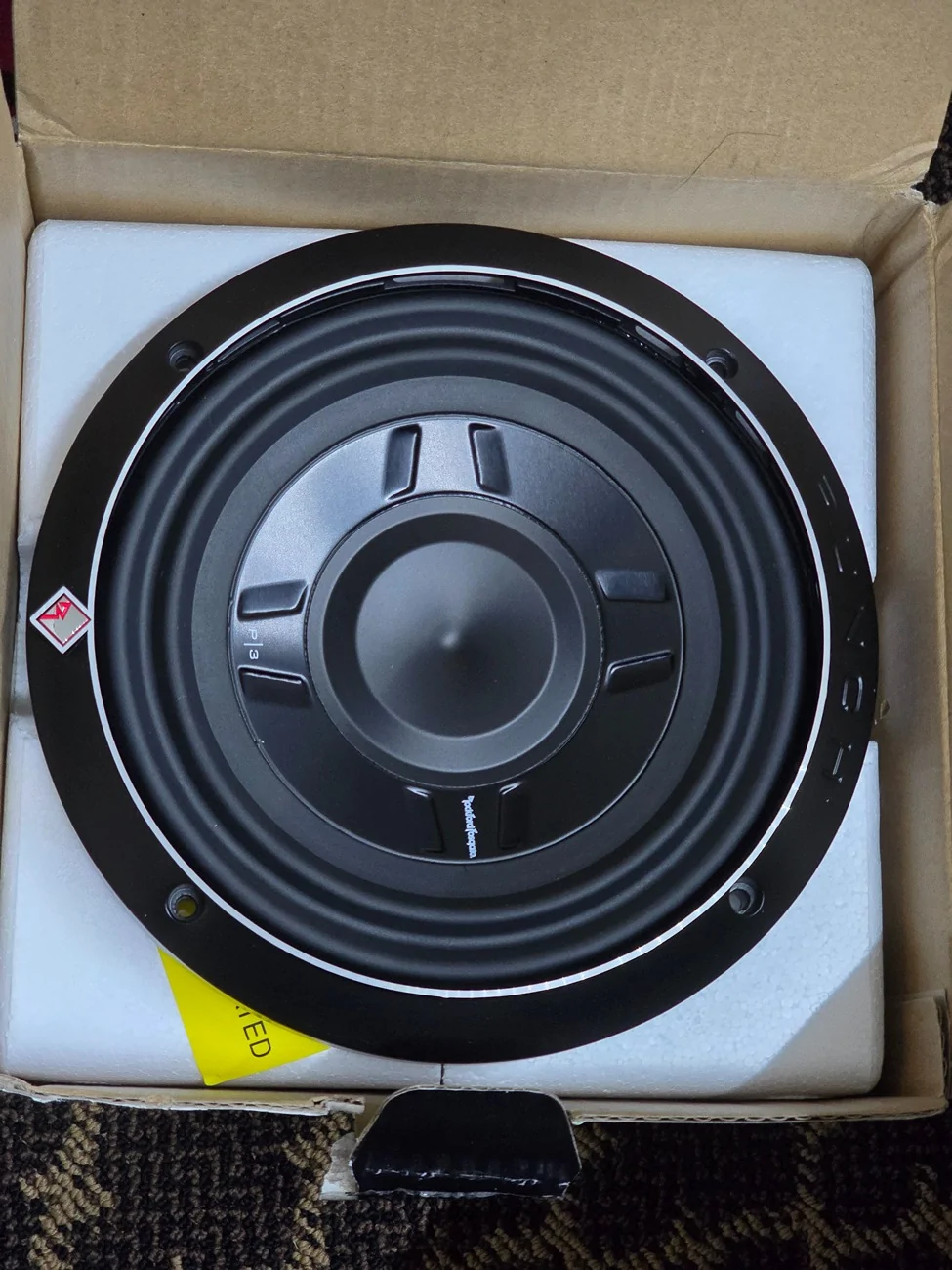

I decided it was time to add a bit more oomph to the sound system. I don't recall where now but I saw someone did a frequency curve test and showed the low end had a lot of bass. I don't know how they did their test, but that is certainly not the case in my car. My sub gets totally lost in every situation other than idling, and mids seem to be really bright. I love mids, but I like my hearing too. For reference, I've tried every setting under the sun, and turning off dts neural, dolby, etc while using lossless audio. The stock system is okay and I'd call it mid-tier, but nothing to write home about. The fender in my gti blew the els away, and even the bose in our audi is better... And it's a bose πŸ˜‘

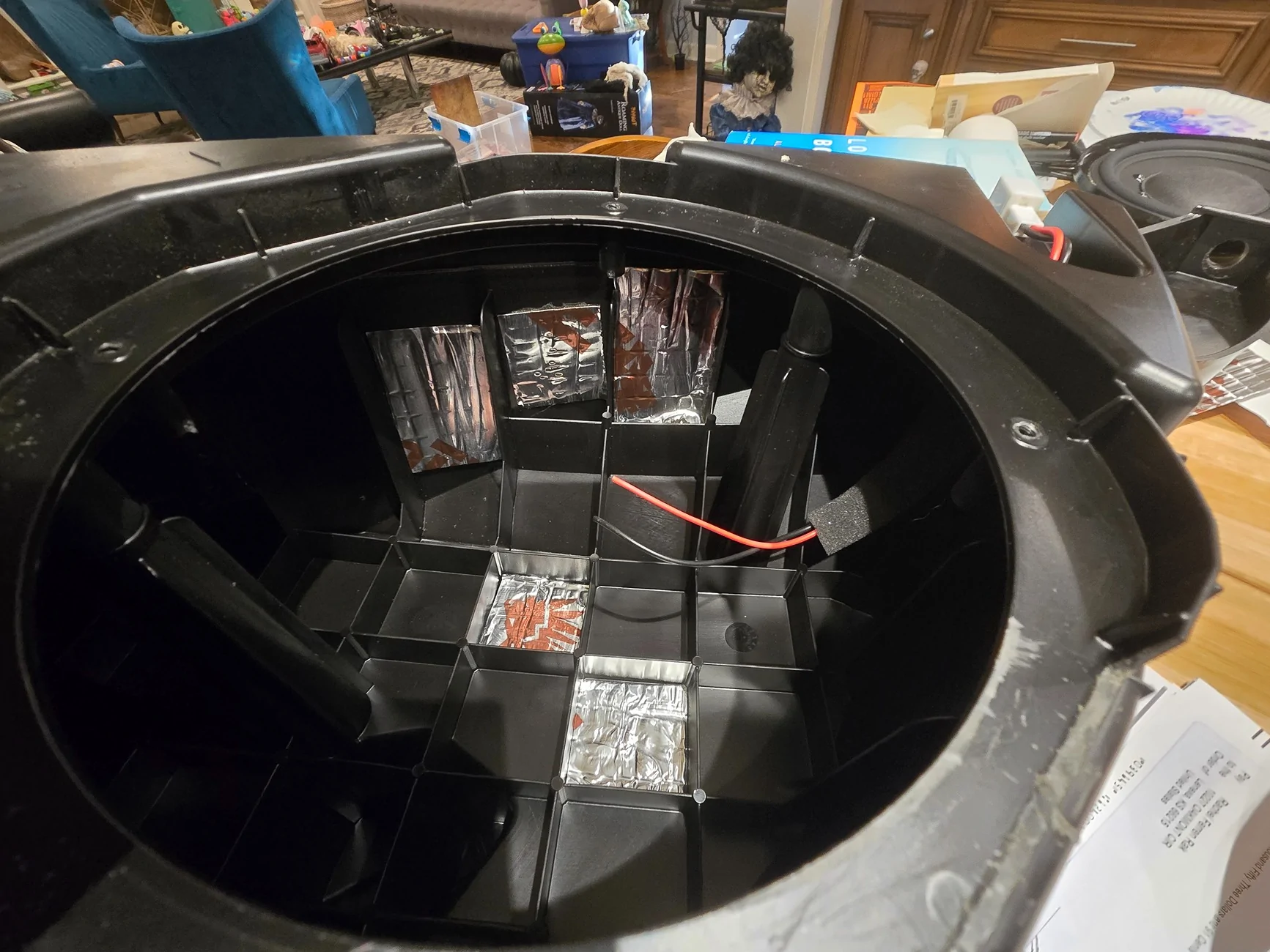

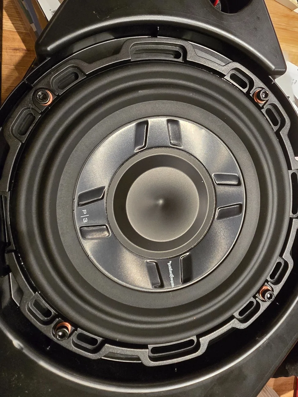

I followed another thread I saw where they tested the Rockford 8",so I bought one and gave it a go. For 170$, ripping up an old pillow, and a bit of kilmat in strategic locations it really cleaned up the bass. Post Malone doesn't sound washed out anymore! I listen to a variety of music, and classic rock has really started to shine now. I don't like "too clean" of a sound for classic rock, because it was always intended to be heard on buzzier speakers so the middle of the road tweeters and mids in the els do a good job there. There's room for an amp by the box, so down the road I may add an inline high feed mono to triple the power output, but that may be overkill.
The other thing I did was place kilmat behind the rear plastic trim at the lower hatch area. I did sound deadening on the walls there on the metal but it always bothered me how cheap and hollow that plastic was. Some kilmat there makes a huge difference in feel, and it no longer echoes when you tap on it. It feels a lot more premium now... A lot.

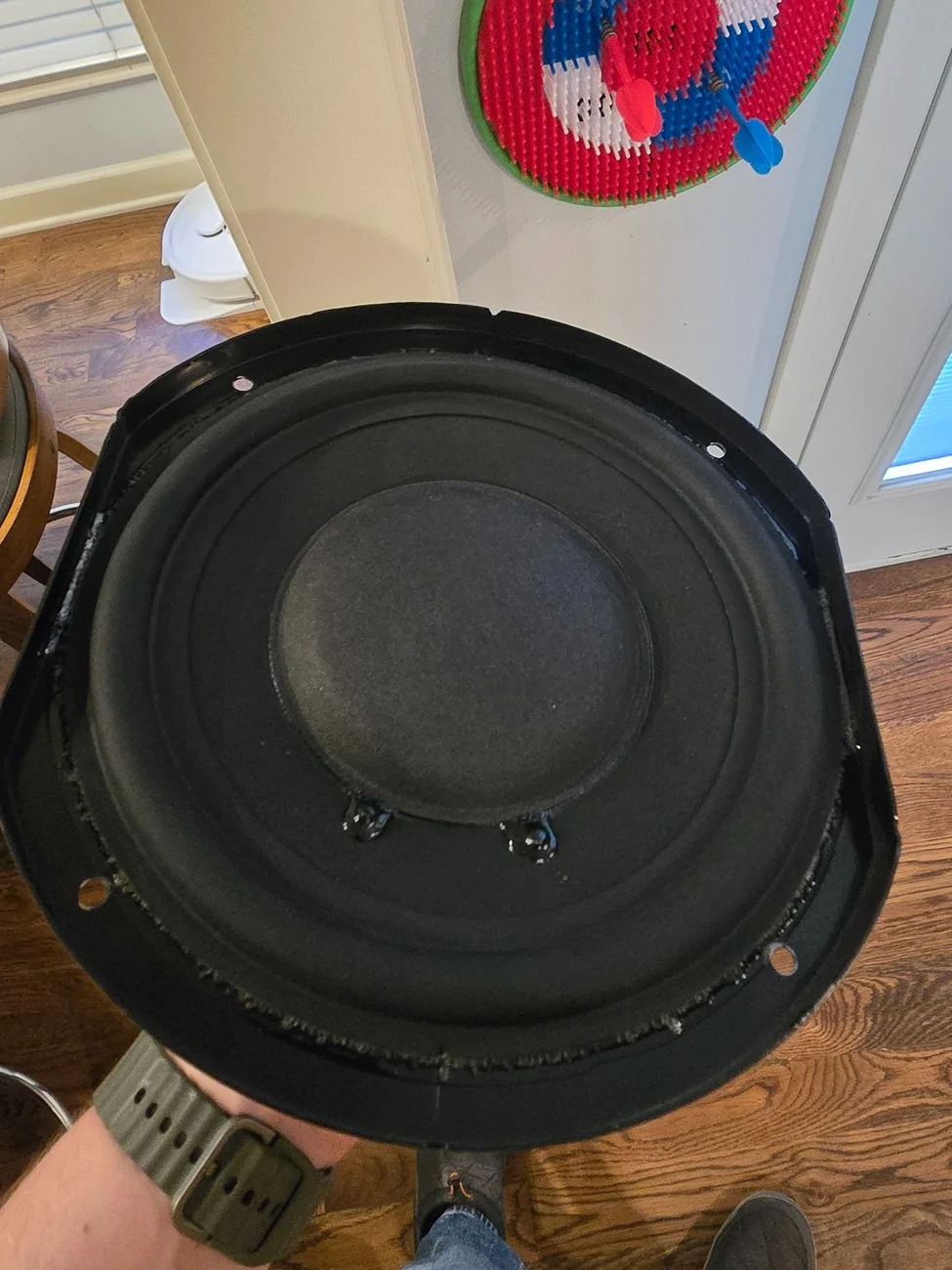

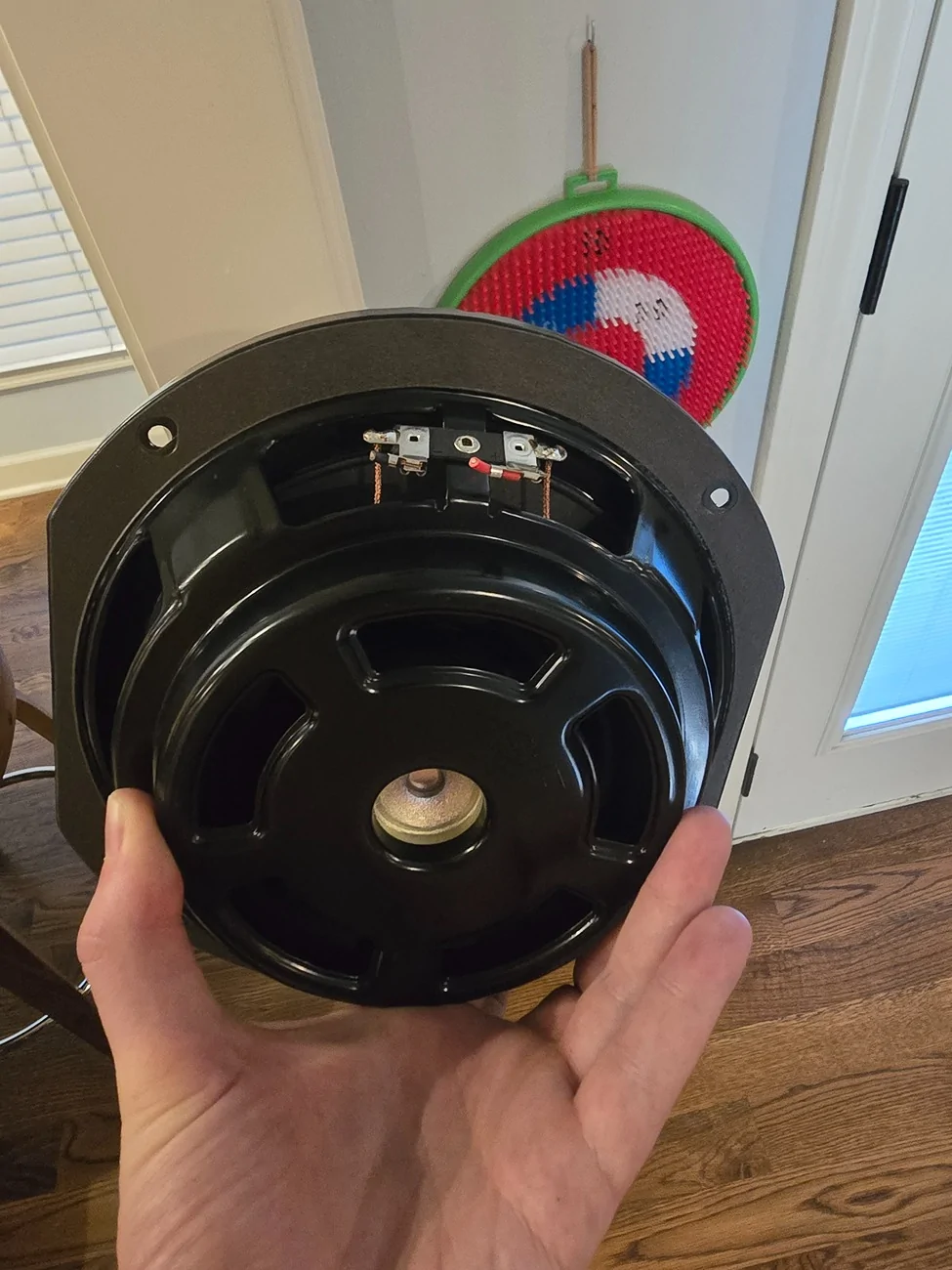

Just plug and play for the woofer?
1,286
869
For the most part.
I had to trim a tiny bit of the thin top plastic on the box, and hacksaw a tiny bit of the surround at the bottom. Super easy to do and I filed it so it looks like it was made for it. I also used a few copper washers under the screws that came with the Rockford so there was no chances of them going through the screw mount backside, but could also just cut them down or use a different screw.
