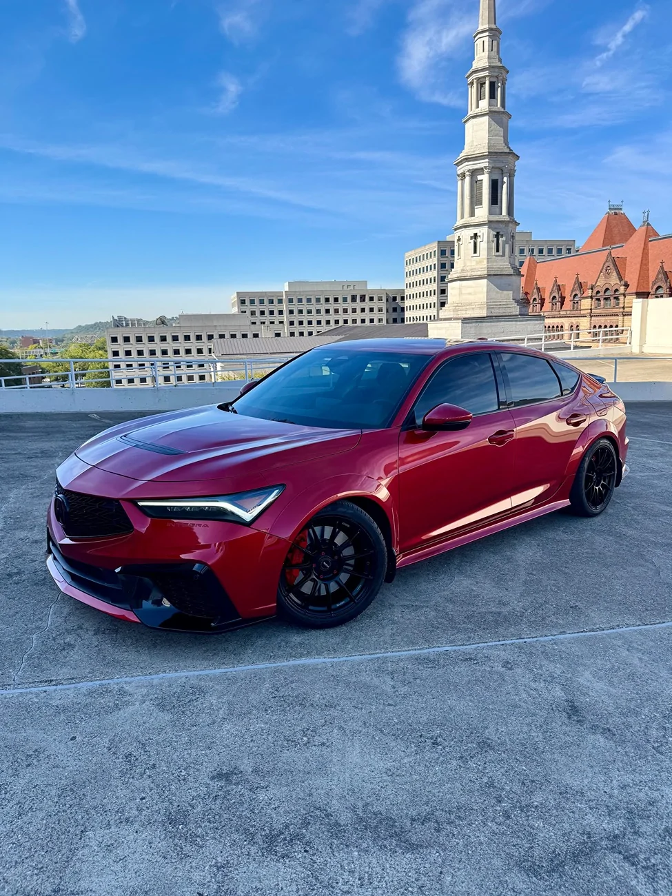

Temps are starting to drop overnight in Cincinnati, and I was getting antsy to get my new wheels on the car.
These are the Sparco FF4 (concave) in 18x9.5 +45, Pirelli P Zero AS+3 265/35 on Eibach pro kit springs.
Definitely notice a slightly cushier ride and lower tire noise, but both of those are to be expected. Not enough miles on them yet to comment on wet/dry grip as compared to the PS4S for daily driving duties.

This looks really good.
Honestly I don't recall seeing many (any?) black wheels on PRP. It's a great look.

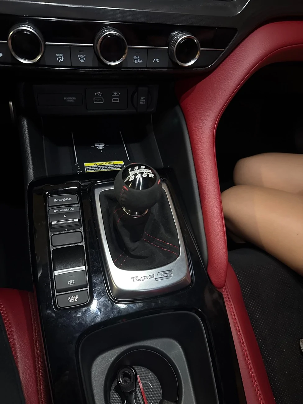

Mugen shift knob install=complete!
A lot harder than it should be.

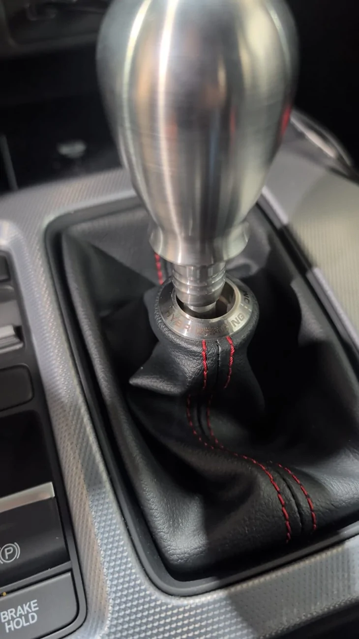

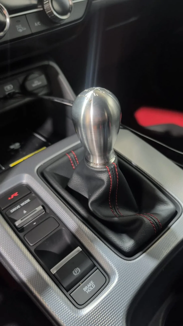

Great shift knob!
The stock collar puts up a fight, and from experience with all trims of the Civic and Integra since 2016 it's just not worth the hassle retaining it.
Easier to swap out for an Acuity or Hybrid Collar, and swap knobs in minutes, sometimes under a minute.
Hybrid Collar for reference mated to a Dream Stainless Shift Knob. Collar just pulls down or snaps up and locks in place.

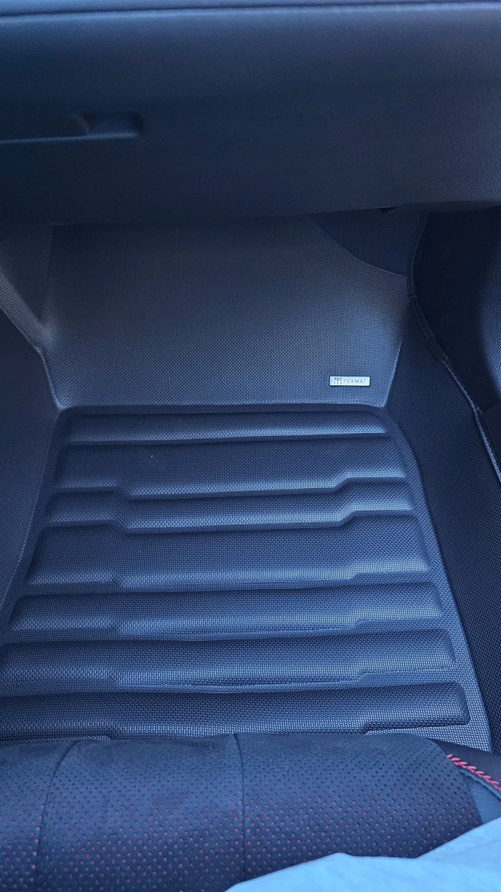

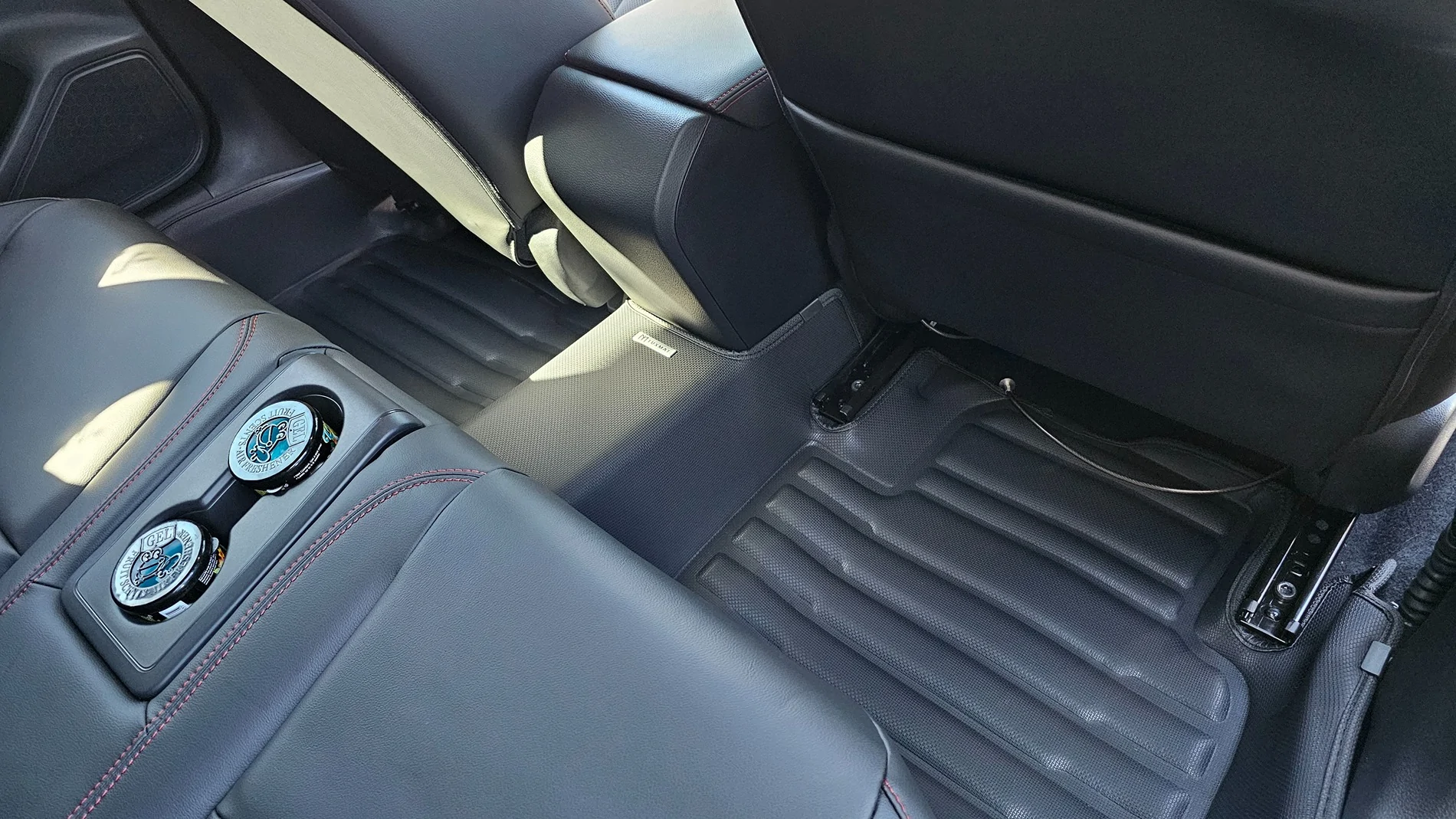

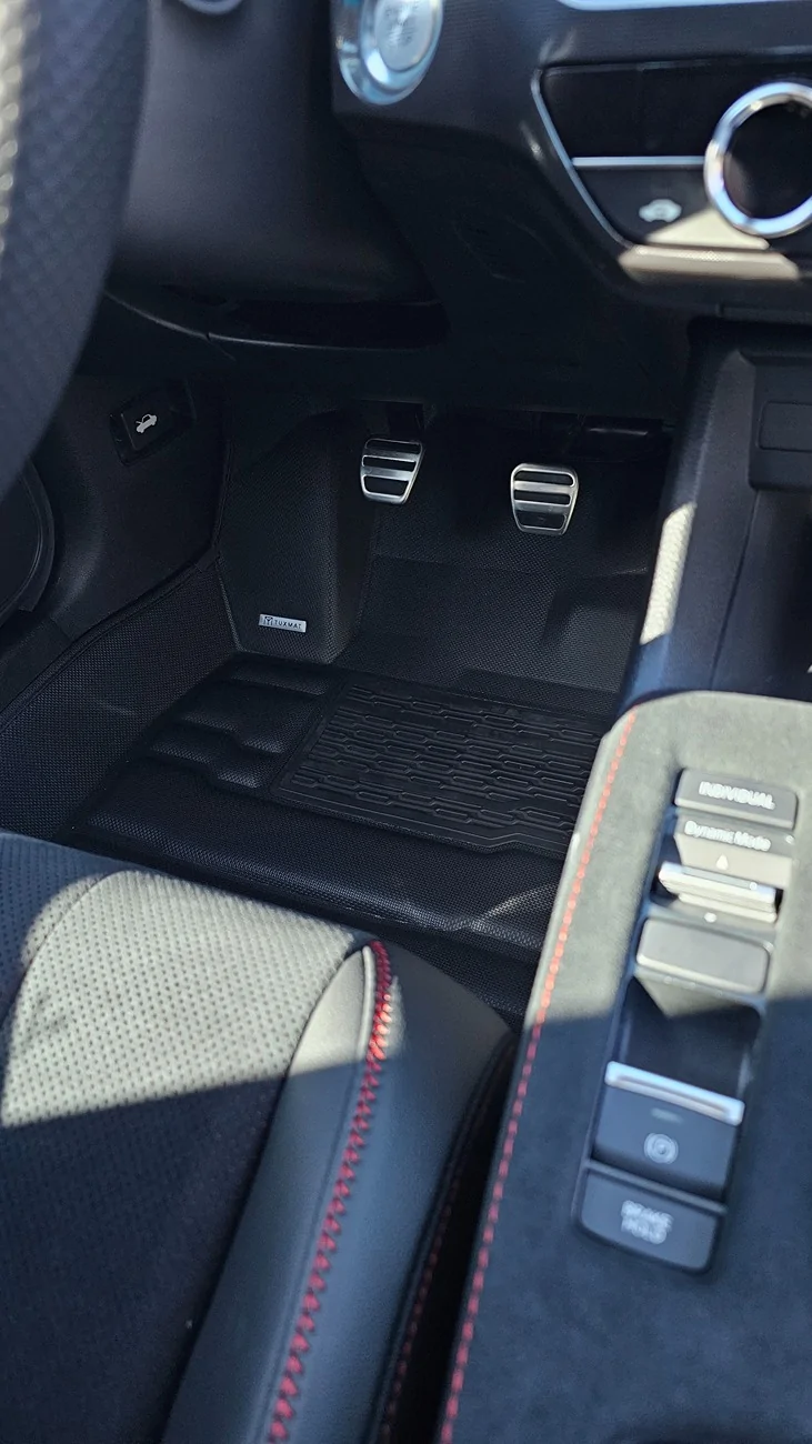

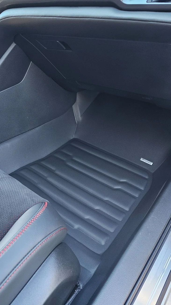

And then my "truck" box showed up. Install & fit are nice. I tucked mine underneath the kick panels, transmission tunnel, & door trim. I only have a few clips next to the seatbelt mount points. Hard to photo, but they are a perfect match for the interior

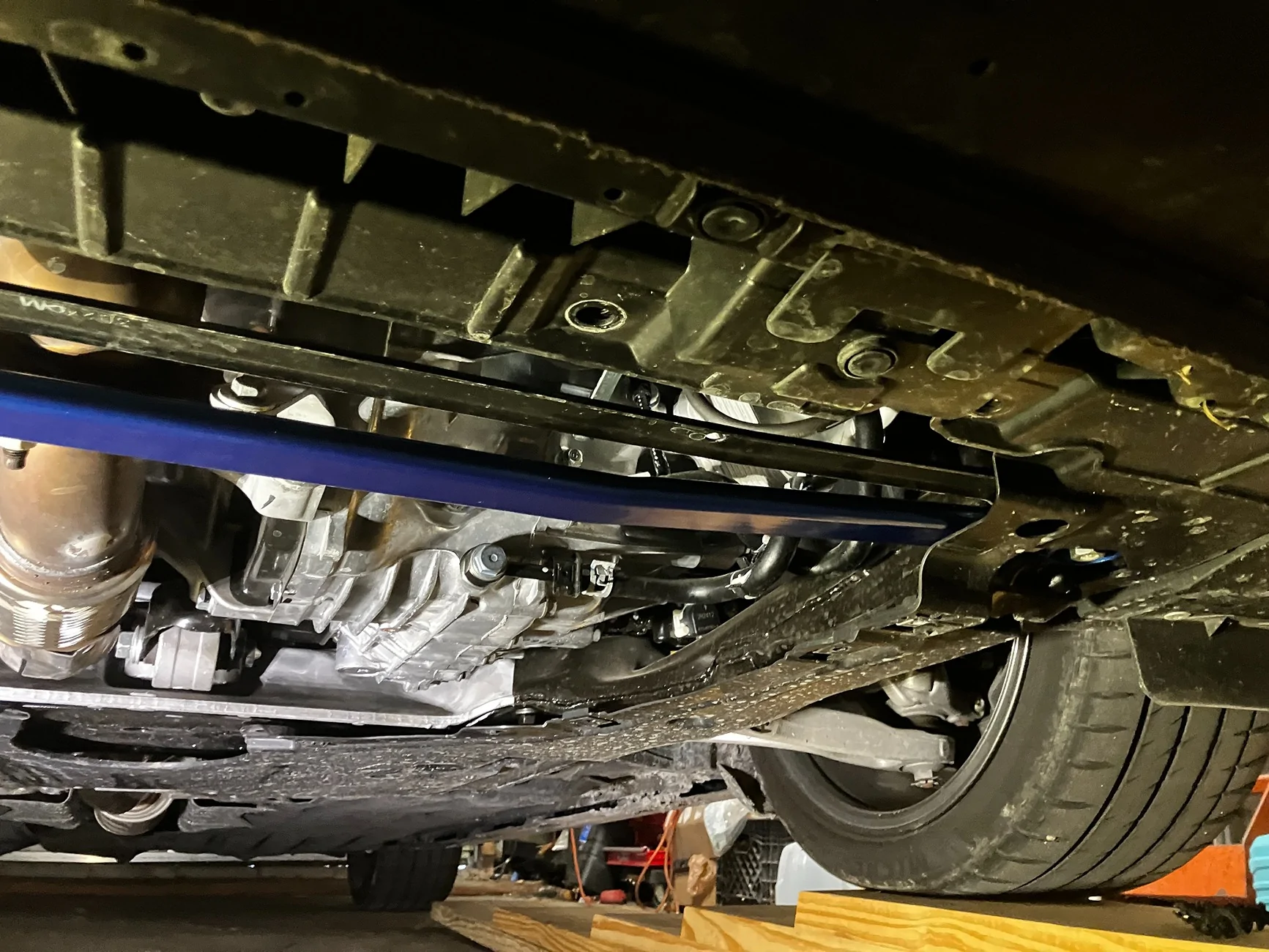

Built ramps for it and performed a oil change while adding a Spoon magnetic drain plug and a Cusco lower front brace... Brace fits perfectly despite not being listed for the Type S going to try the rear next.... After driving it hard the front feels a tad bit stiffer with a little more turn in....
No modification needed on the front lower brace?
