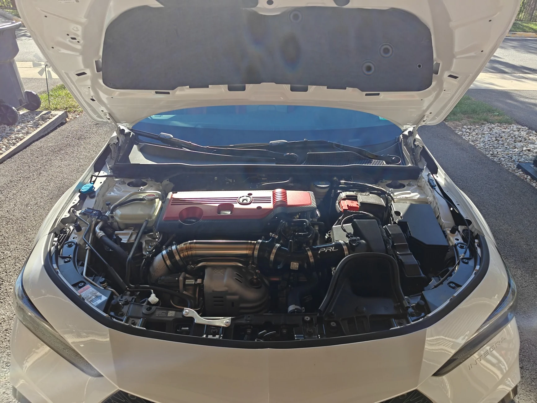

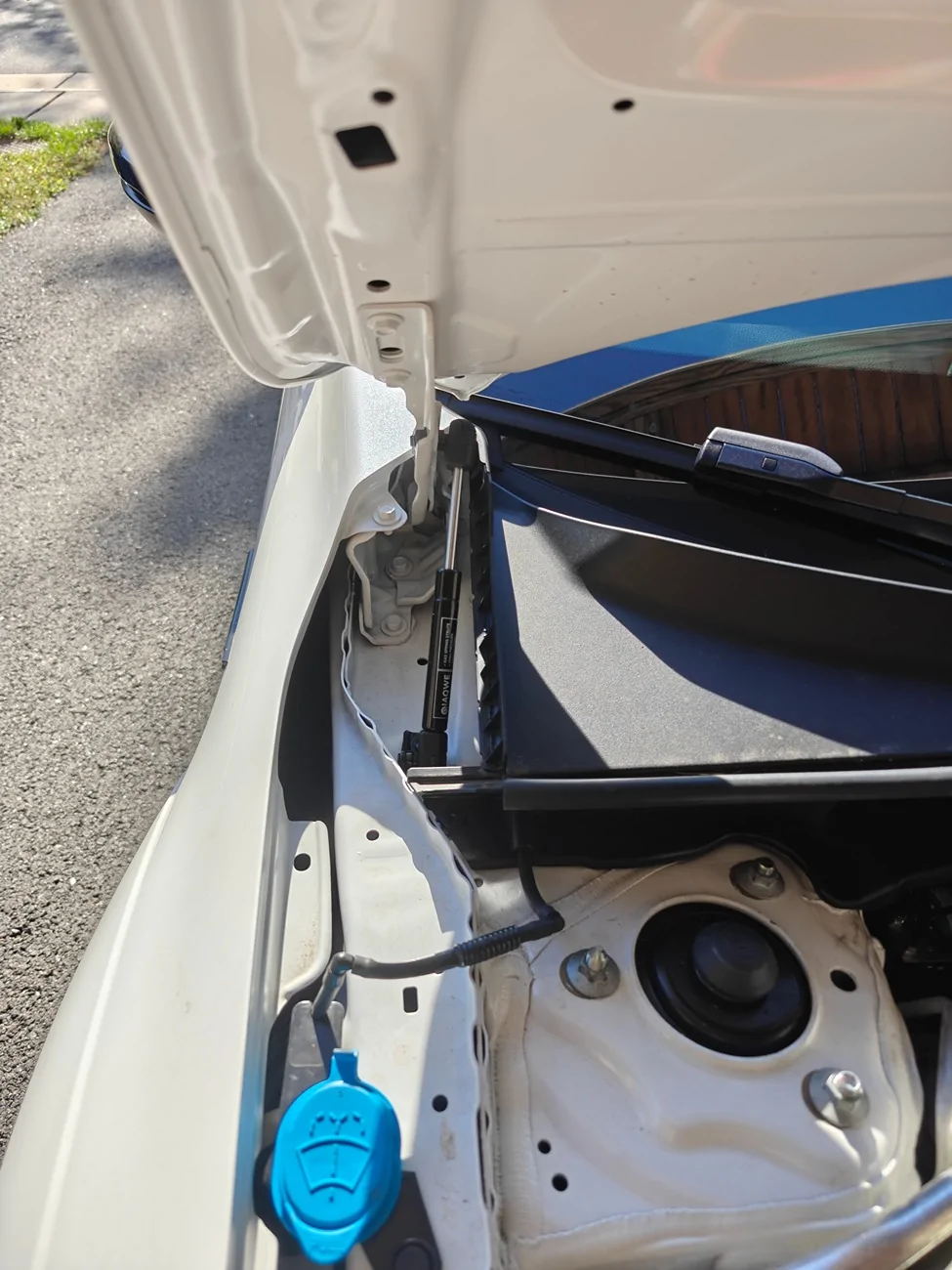

WOT Performance hood struts.
Had to use a proper riveting gun for the rivnuts. The shadetree nut washer and bolt method wasn't working for me - the rivnuts just kept spinning on the bolt not matter how much normal force I applied.
Also, the passenger side hood "mounting" hole was not cleanly bond welded so the bolt had to be threaded in rather than simply inserted. The driver side was fine.
All in all, a worthwhile install for not a lot of money.
Btw, I hate logos on everything so I removed the WOT decals only to find out the struts have even more obnoxious Chinese branding painted underneath. So, don't remove the decals unless you plan on replacing them with black vinyl blanks (which I might do).

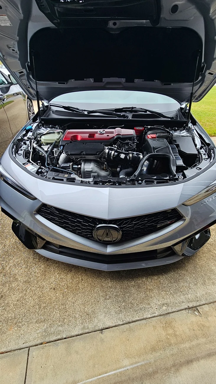

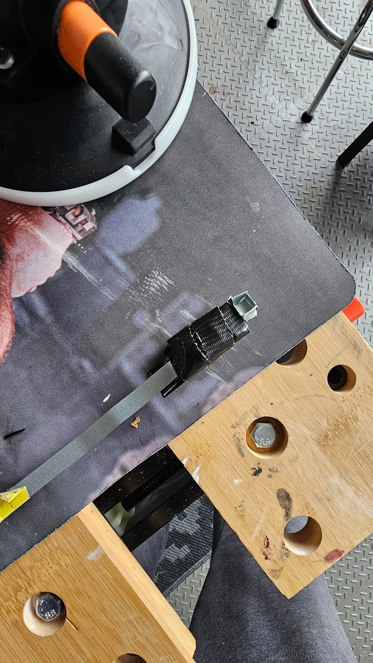

Amazon hood struts & a hood prop delete. If these fail I'll never try them again
The left was a monster & I had to make my own nut holder.

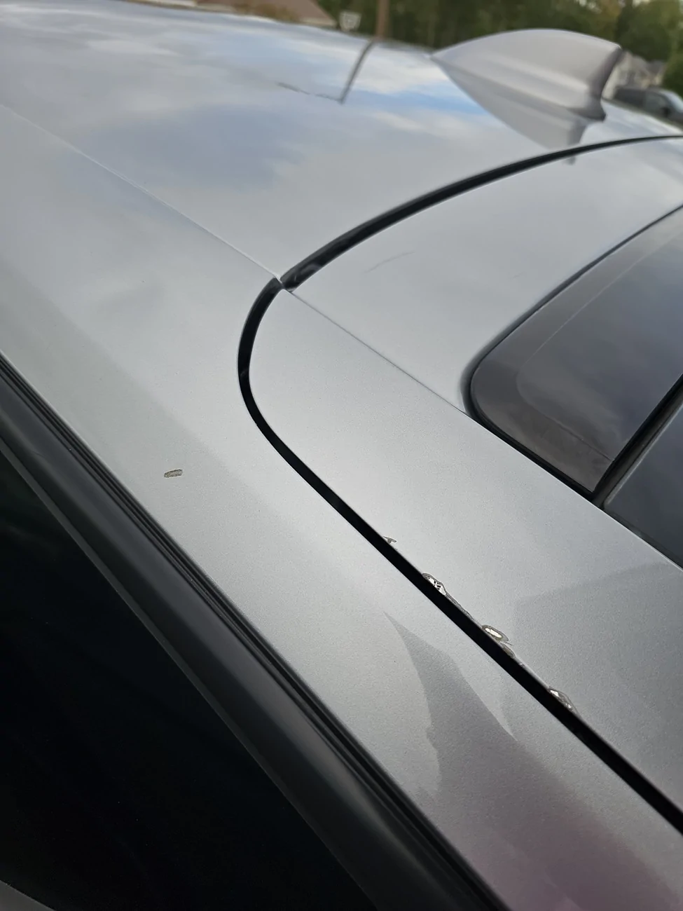

Got hit by a flying object on the highway, so my one week old is going to visit the bodyshop for an estimate.
