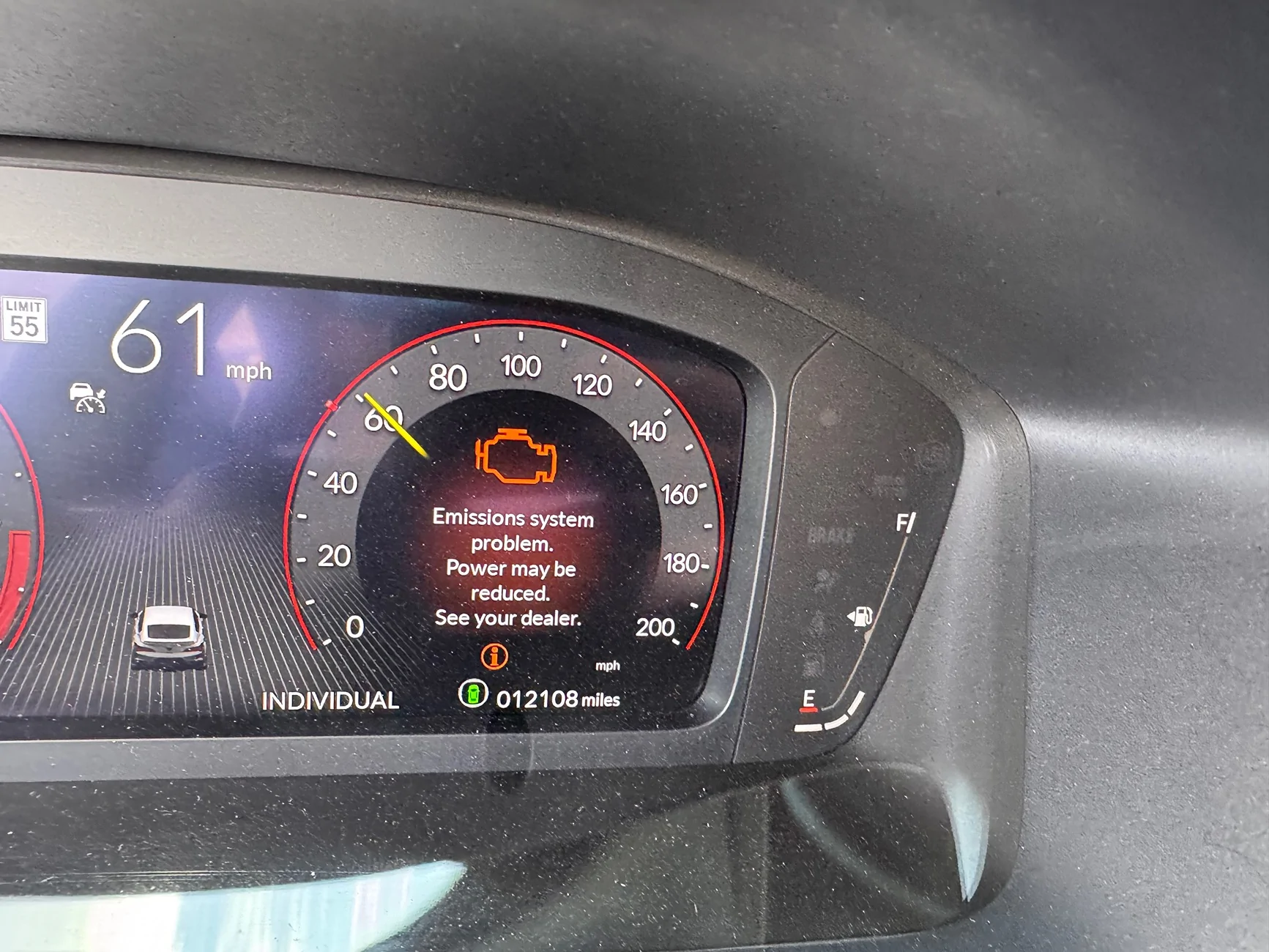

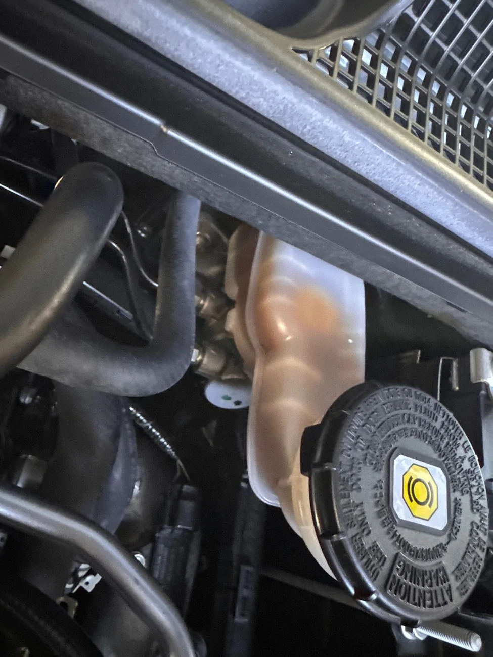

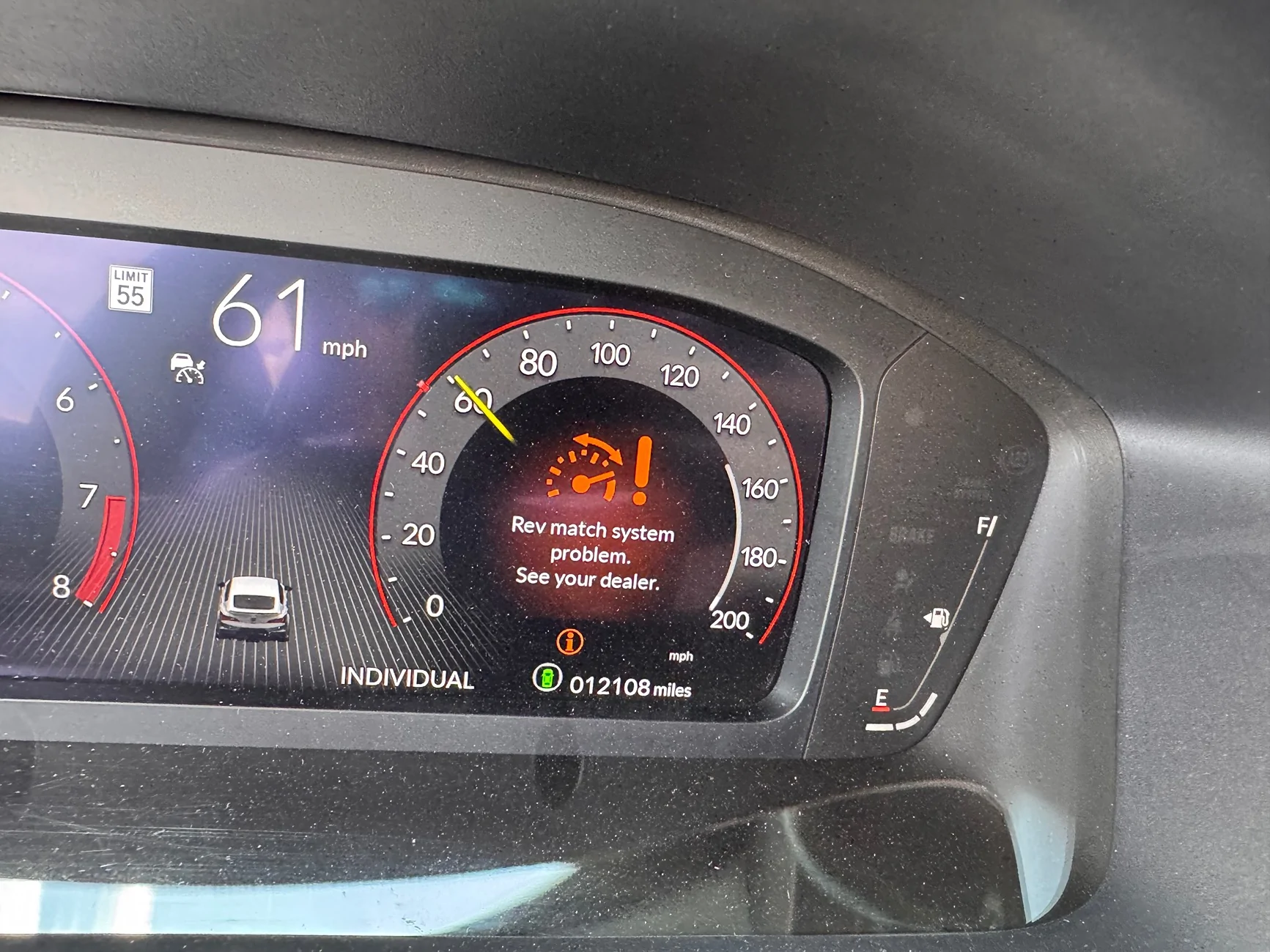

Well it was the other day but I finally did a track day! What a blast! Even boiled fluid and poped a few check engine lines after 60 miles. Whats the fluid everybody’s running to help with the boiling?
I've run Castrol srf, endless, rbf660, and Rbf600. They're all great. I run the Rbf600 now because I flush frequently anyway and it comes in smaller bottles at a good price point. The 660 and srf are typically overkill unless you're pushing a really heavy vehicle.

Thanks. Looking into the srf. How much does this car hold ?

1000 ML bottle of SRF is enough for a full flush. Or two 500 ml bottles of RBF 600 or 660.

All good stuff mentioned above. I'll add, once you crack the bottle of fluid, it's good for up to three months, then pitch it. 1000mL should be good, but if that fluid got into a lot of crevices, you might want an extra bottle around just in case... Same fluid for clutch with same MC, so just go ahead and bleed out the clutch too.
