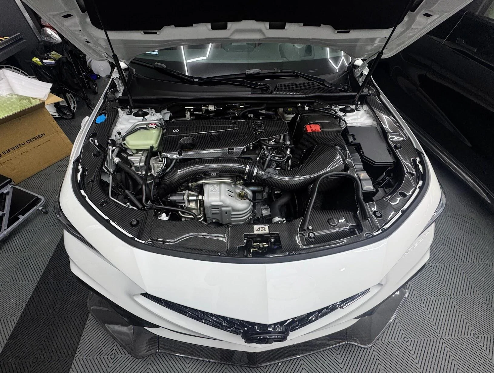

PRL is definitely louder but this is just so it for me.
I definitely have no regrets either going from PRL to the Infinity Design. Definitely makes makes more power than PRL. Dyno'd and picked up power all the way up and made my all seasons break traction up top on the dyno once it hit 500whp. Couldn't finish a clean run as kept losing traction. Didn't have the same traction issues on the dyno with the PRL.
