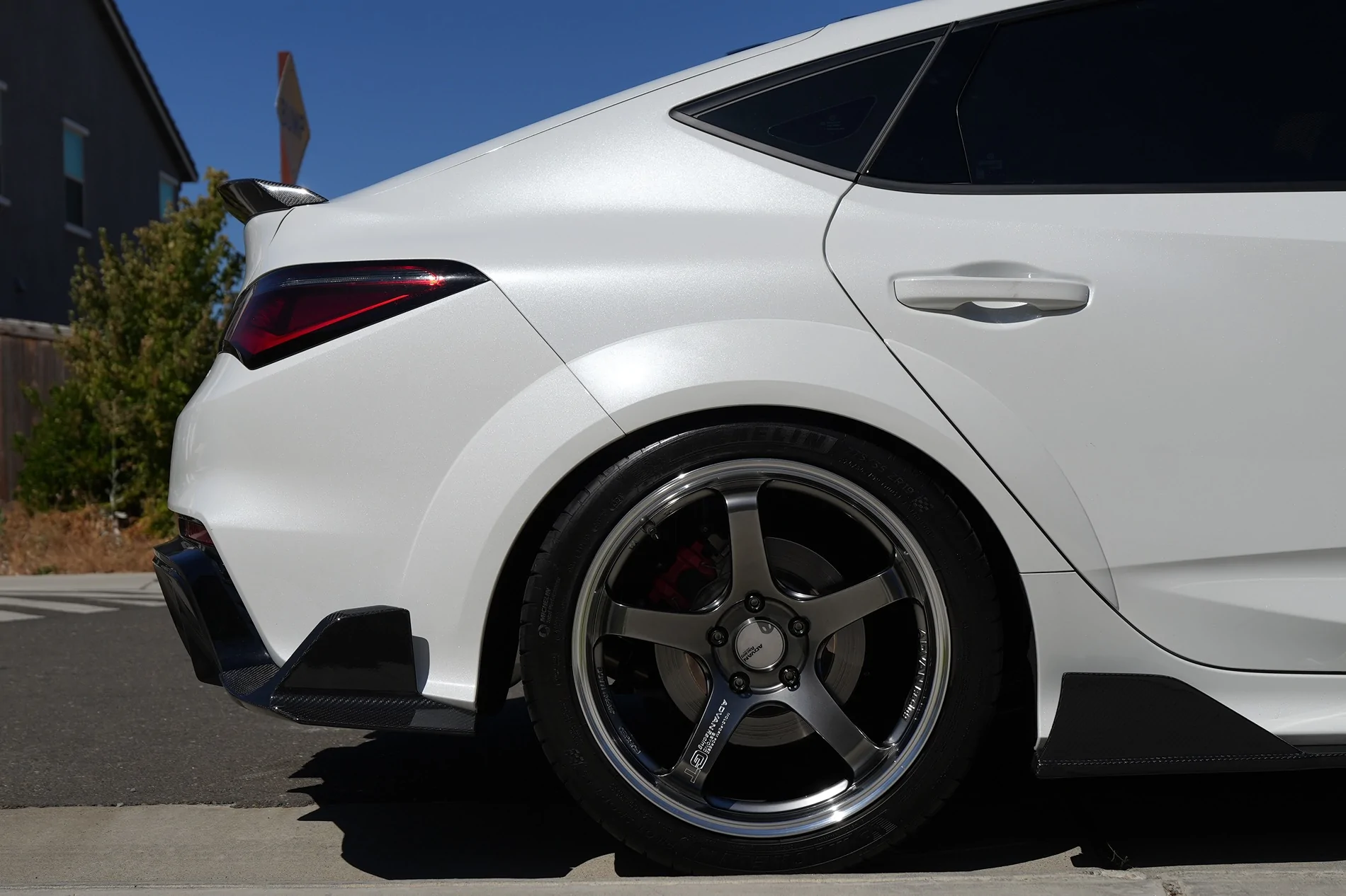

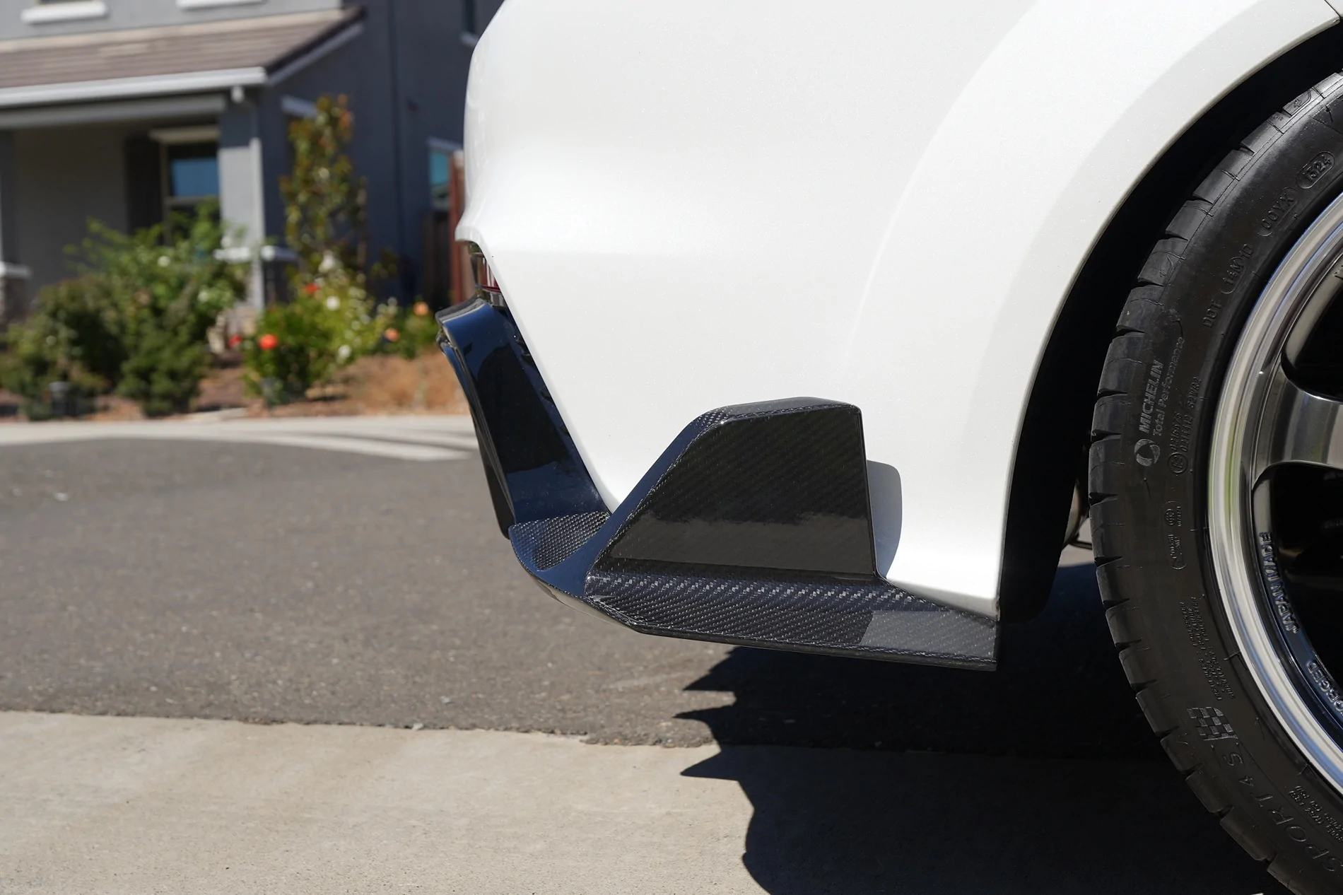

Jogon rear carbon spat for those who’s are interested. It’s definitely an aggressive piece! The dry carbon itself is top notch quality and reuses oem mounting holes which is nice. I’ll post a video shortly on my YouTube. It’s giving me A90 Supra vibes.
if it was me, I think you would need the full Jogon kit to complement everything.

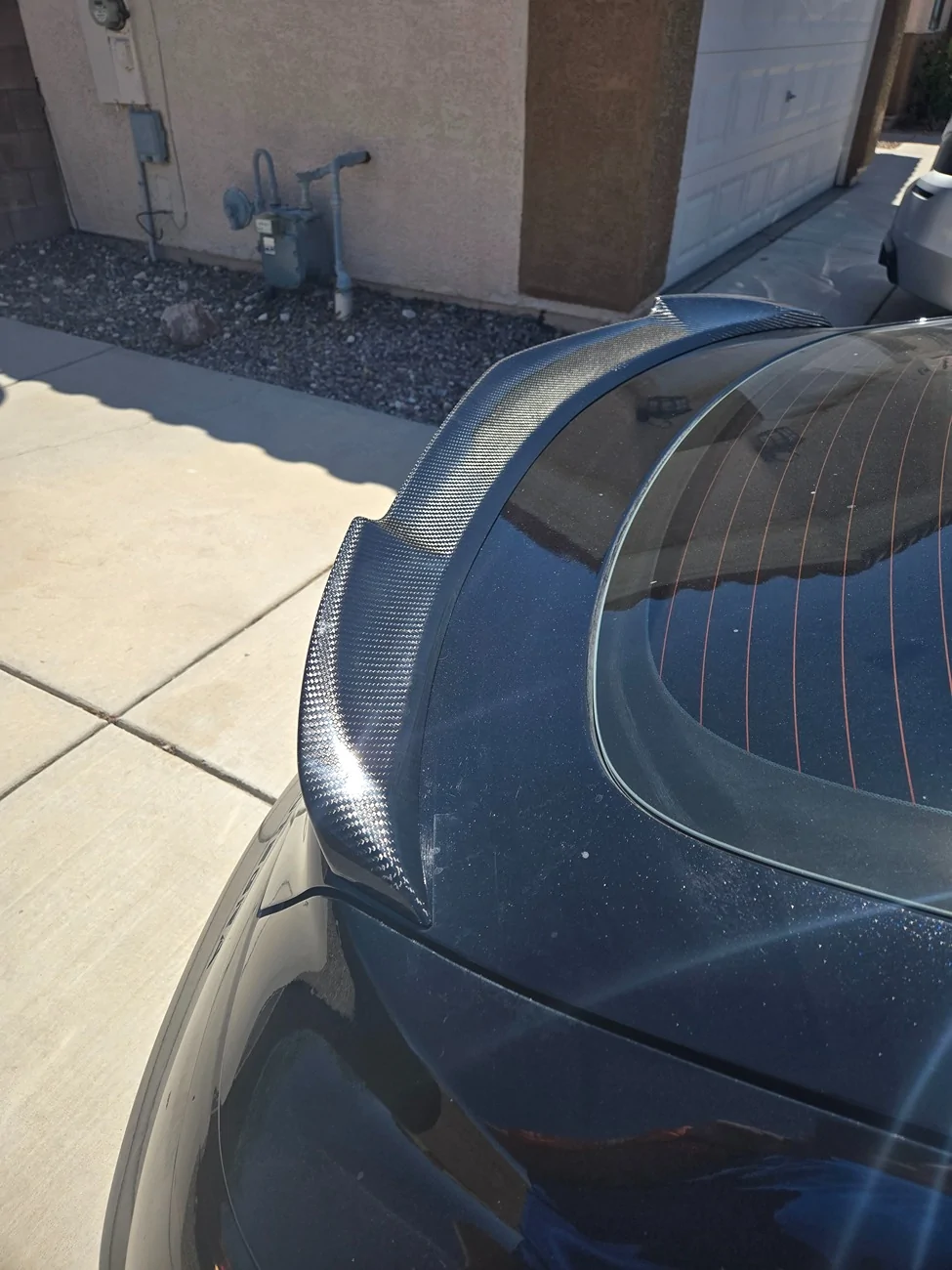

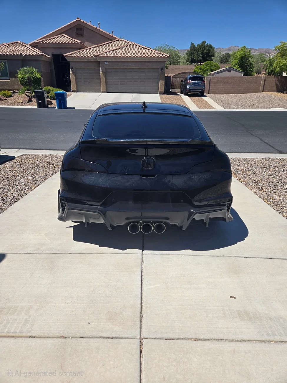

So technically, it was yesterday... but I finally got the stock carbon spoiler on. It was actually way easier than I anticipated. For reference, my car is a 2025.
I took the factory painted spoiler off, and all of the holes were existing. I was surprised because I worked at dealers for almost 9 years, and haven't seen a factory lip spoiler bolted on. Ive put on probably 10 factory carbon lip spoilers over the course of my career, all with double sided tape.
When I removed the carbon spoiler from the box, I found that one of the tabs was broken off completely and another was almost broken off. It also didnt come with whatever clips are supposed to hold it on (almost looks similar to zip ties). I opted to cut all of them off and just use the double sided tape. Cleaned everything up good with denatured alcohol and everything is nice and stuck. I also covered the holes with double sided tape. If it leaks, ill pull it off and fix it.
My only complaint is there was a nasty pain chip/gash in the paint under the factory spoiler, which is now just visible with the carbon one. The carbon one seems slightly more narrow than the painted one. I filled it with regular black paint for now. Once it comes off, ill get some actual touch up paint for it.
Also, inb4 everyone saying the spoiler will fly off. Sure, its possible, but I have not seen that happen once when the surface is prepped properly and the right tape is used. However, if im wrong, ill gladly report back so others dont experience the same mishap.
Next up is carbon mirror cap replacement and probably some lowering springs. I also still have some OEM goodies to install.
Those look great. Poking around, they also have front bumper canards. Ive been looking for some, but couldn't find any. Im going to have to add these too my list of carbon goodies im going to spend too much on.
