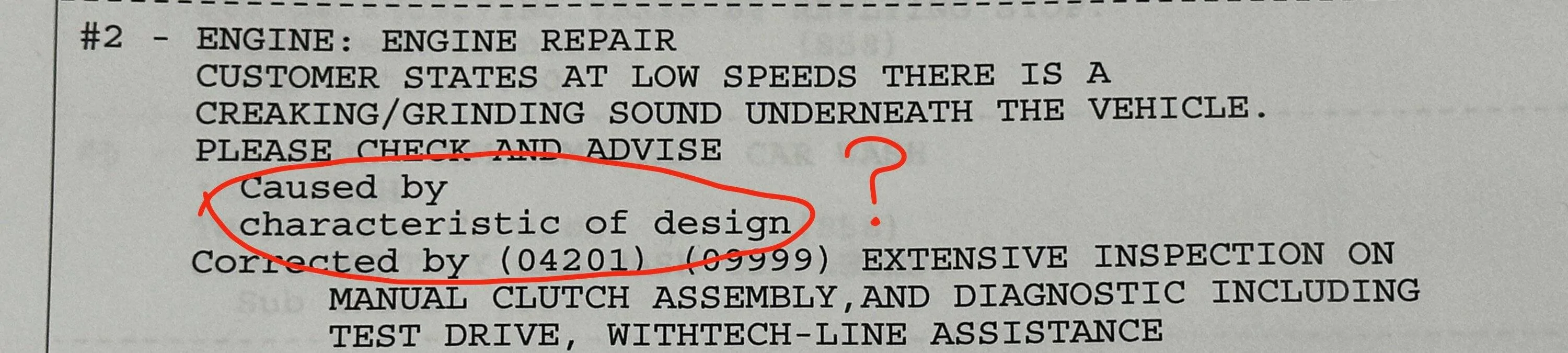

I took another run at this and finally solved it. Spoiler: bad rear engine mount.
On Friday Acura claimed there's nothing wrong with my car:
I made a short video summarizing the issue and what I found:
I'll be following-up with the dealer tomorrow. If the service advisor was right that they have several of these cars running around town with the same issue, I think they owe each of the owners a phone call. (And a new mount.)
