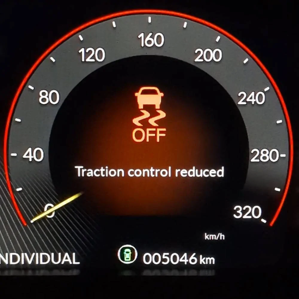

Lol, why does it suggest that it's off when in fact it's only reduced?
SilverRocket
Oct 23, 2023
202
269
The Moon
'24 LSM ITS
Old reference??? I mean there was a time not to long ago that button (on other Honda's/Acuras) removed all the nanny systems with exception to ABS.
It does clearly say on screen "reduced".
That's one thing I'll definitely give BMW and other manufacturers. They have multiple levels of traction control reduction up to and including completely off.
This is technically a software fix, so anything is possible but they'd improve this car so much if they made it so that when you're stopped, if you hold the parking brake and the TCS button simultaneously it goes completely off without the VSA warning.
