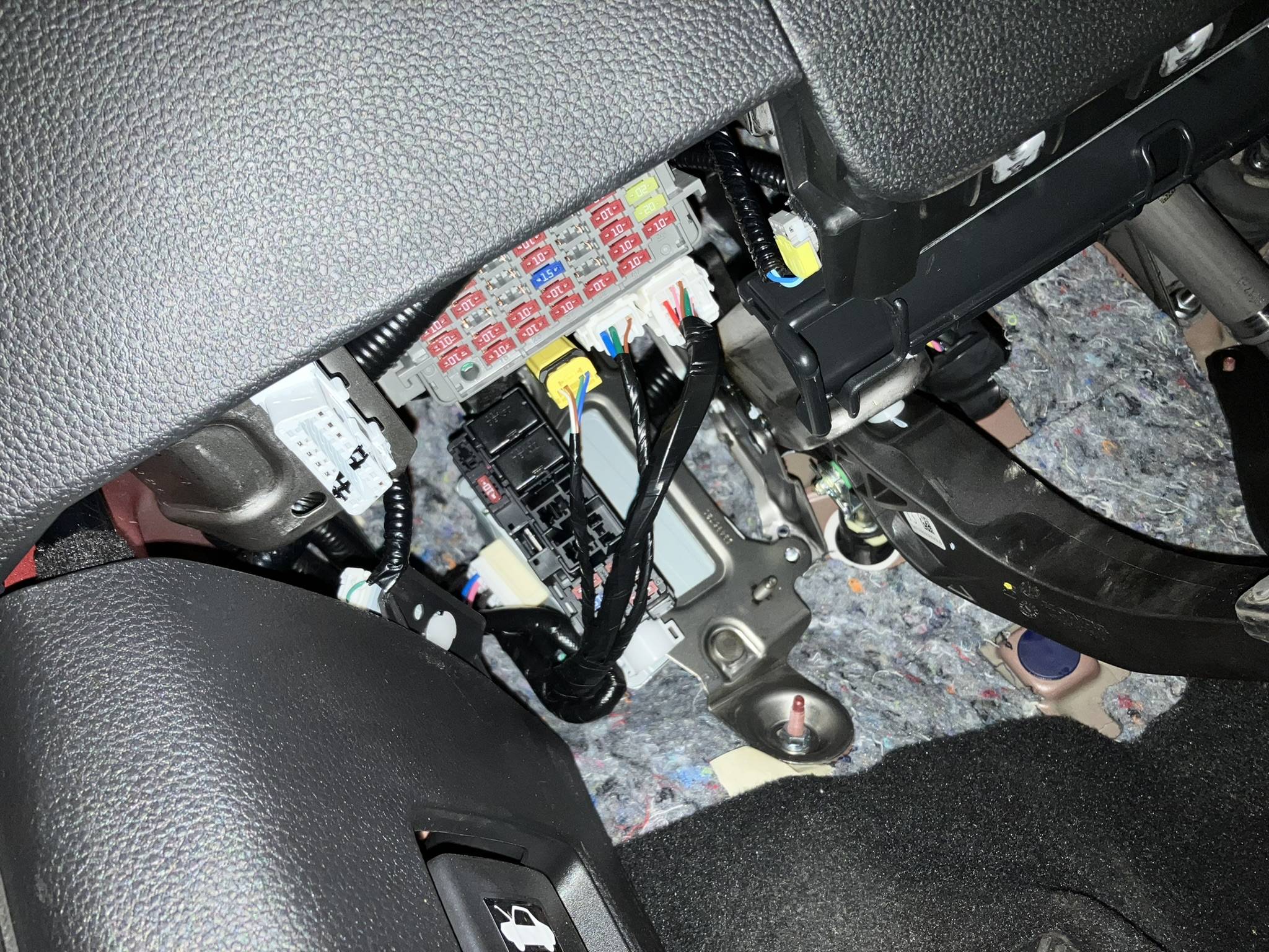

I'm not sure how to identify the obd2 reader, but I assume you're referring to something in this general area?

The OBD plug is that big white trapazoidal shaped one top left in your photo.

Ronnoc might have found it. I can't reproduce it with the car parked, but I was able to make the buzz worse by wiggling the wire headed to the yellow terminal (I think, can't see it while driving obviously). I'm now wondering whether I'm hearing a rattle or a crackle of electricity through a faulty connection. My guess is the latter. I'm not sure if it's a coincidence, but I noticed the clock was off by 10 minutes after I finished messing with it.
Either way, I'm thrilled to know where it is. I owe you a beer Ronnoc, send me a message if you want to collect on that.

All good man. No worries on the beer glad I could help. Mine is actually the bigger black wire thats shielded right next to the obd2. If you take it to the dealer let me know what they say. I've been too busy to get in there.

No charge for todays service. They found that the looming around the wiring was pulled tight and adjusted the connections. Unfortunately the issue didn’t occur while they were in possession so I’ll need to drive it for a while to see if it comes back.

I checked this wiring in my car as I have a similar sound from that area and I found that the wiring in my car is quite tight as well. The large yellow connector has some play within the connection area itself, but is pretty quiet when I do move it and doesn't seem like a candidate for the rattling/buzzing sound.
One thing I've learned is that some other wiring connectors in the interior are indeed loose and do rattle, so that is something to keep an eye out for.

The thing that keeps me focused on the wiring is that after the buzz starts, touching the cable directly affects the sound. The joy of intermittent issues…
