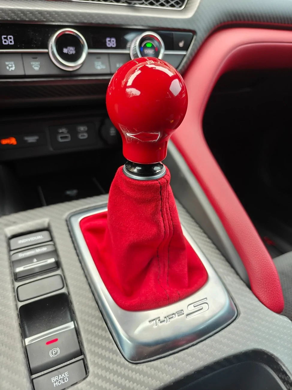

I have the acuity 4 way adjustable short shifter. It gets rid of all slop, lateral and otherwise. It’s my favorite mod to date.
I agree just installed this last week and it really firms up the shift and I didn’t even get the optional spring, great mod tbh.
So do I... (read the saga of this thread for the details) it didn't get rid of the lateral slop I dislike, but it did improve other aspects of the feel enough for me to keep it. It's a great product. Acuity told me that the lateral slop I was targeting is a built in feature of the Honda transmission that can't be cured. Good guys to be so honest.
