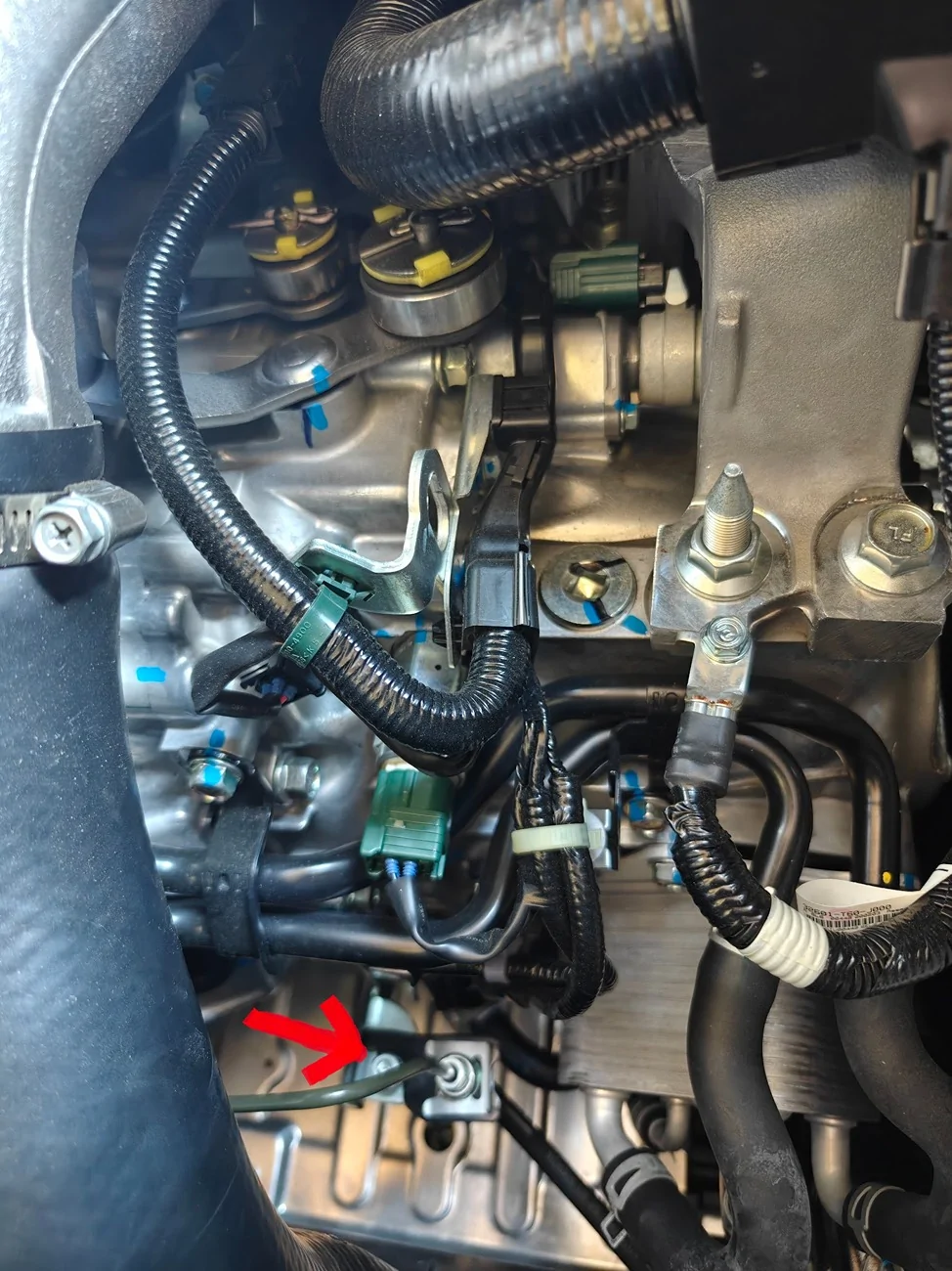

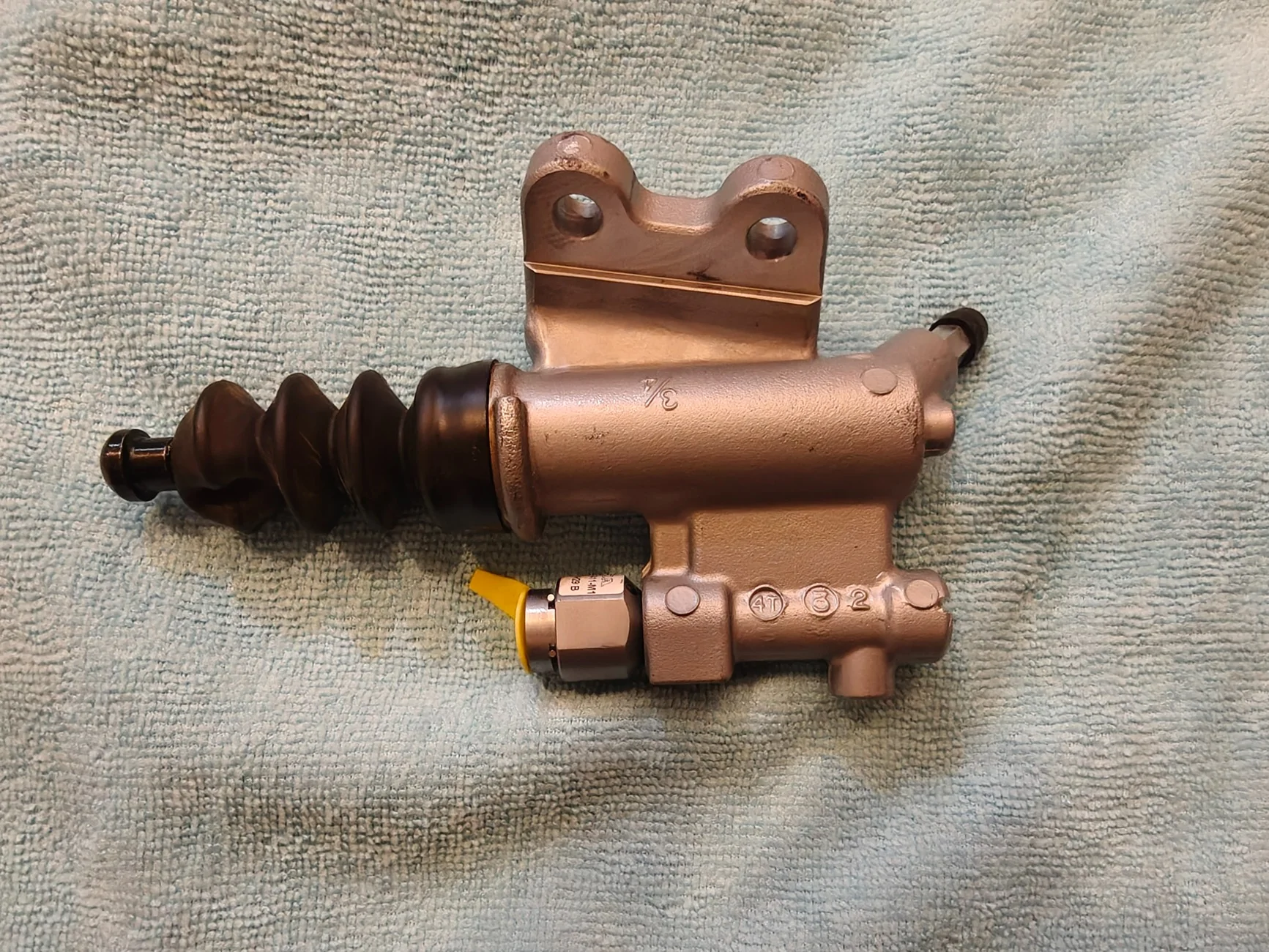

Swapped out my OE clutch slave cylinder for a CDV-deleted slave from JSR Engines. The swap was pretty easy. After removing the airbox, I found that rather than breaking the seal between the soft and hard lines like every DIY video I found advises, it's easier to unbolt the bracket assembly of the soft to hard line fitting (see attached photo with red arrow pointing to the 10mm nut to remove) so that once the slave is unbolted from the transmission it can simply be swung down and then back up through the space previously occupied by the lower airbox assembly.
Then it's just a simple matter of sliding out the retaining clip for the hard line fitting on the slave, and quickly reinstalling the hard line onto the new slave (assuming you went the same route as me and bought a pre-modified slave). I lost maybe two drops of hydraulic fluid in this manner.
As for bleeding, I used a vacuum oil extractor with a smaller hose fitting that was snug enough on the bleed nipple to effectively enable me to bleed the slave without a helper. Took maybe five minutes, including master reservoir refilling and a bit of clutch pedal testing. It was one and done as far as bleeding - super easy system to bleed.
As for change in feel, it's obvious. Rapid clutch-outs results in very fast RPM realignment, whereas before there was a good bit of slip before RPMs settled. Next is a tune to remove the throttle plate rev hang and then the shifting is going to be as close to perfect as it can get for a cable actuated transmission!

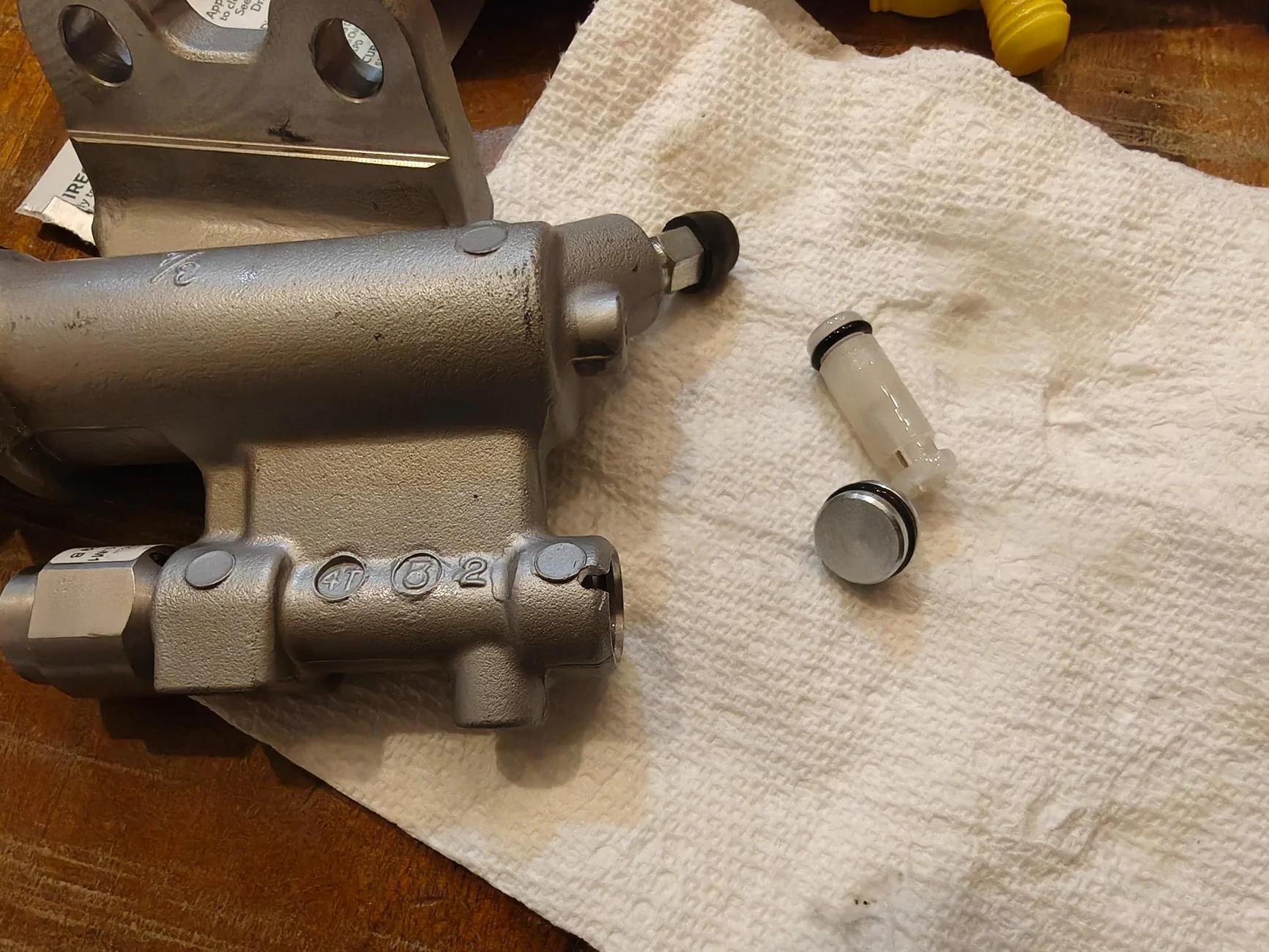

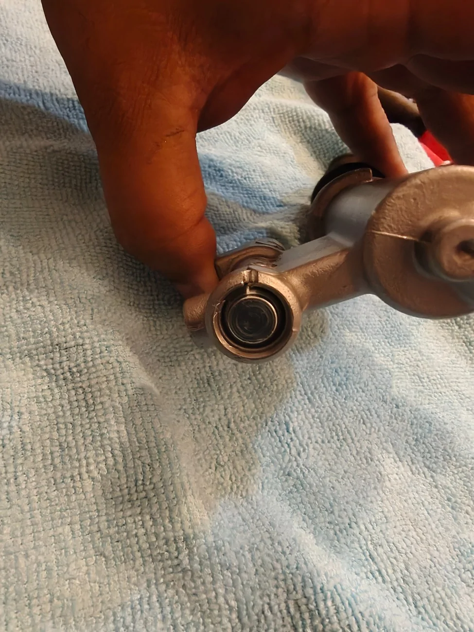

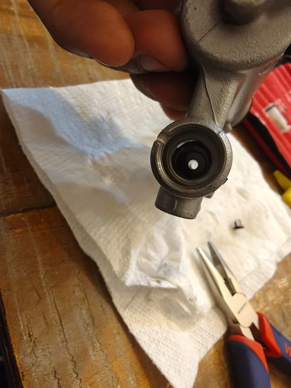

FYI, I went ahead and disassembled my original slave cylinder and successfully removed the delay valve innards. Reassembled and ready to install into the next car!
Anyone interested for a fair price, ping me.
Nope, definitely in your head, no human can feel the difference in 37 ms of engagement speed, it takes you 500 ms to shift anyway unless you're Ayrton Senna, studies show human reaction speed is 200+ ms, blah blah did I miss anything?
Glad it went well.
Spart
May 31, 2025
179
163
2025 Integra Type S
Ok dude. You're right.
The sarcasm may have been lost in transit. I have been CDV-less for the past 600 miles and enjoying it a lot.
Question - do you mind if I quote you in my CDV delete instruction video on your experience? Specifically this:
Also, have you given any thought to changing your trans fluid yet? (Forgive me if you've already mentioned that in this thread, but I didn't pick up on it.)

I got the sarcasm, I'm just not all for continued and unnecessary quarreling between two otherwise helpful members. Everybody is entitled to their opinions, even if we think they're wrong.
Anyway, on to better things. No, I don't mind at all if you quote me. Thank you for asking.
As for the trans fluid, no I haven't considered it. Is the stock trans fluid not up to task, or are you just talking about a break in flush with the same stuff?
