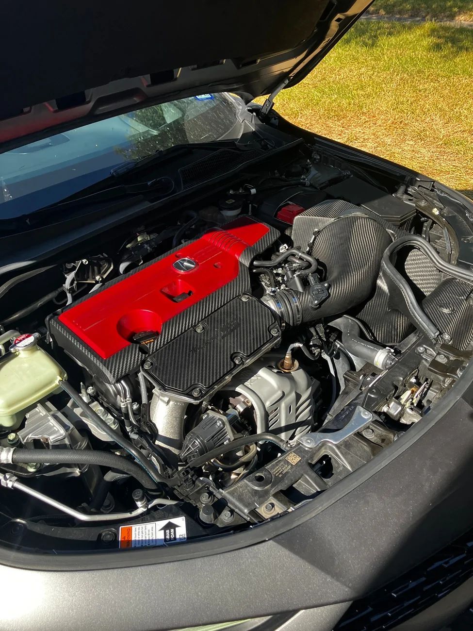

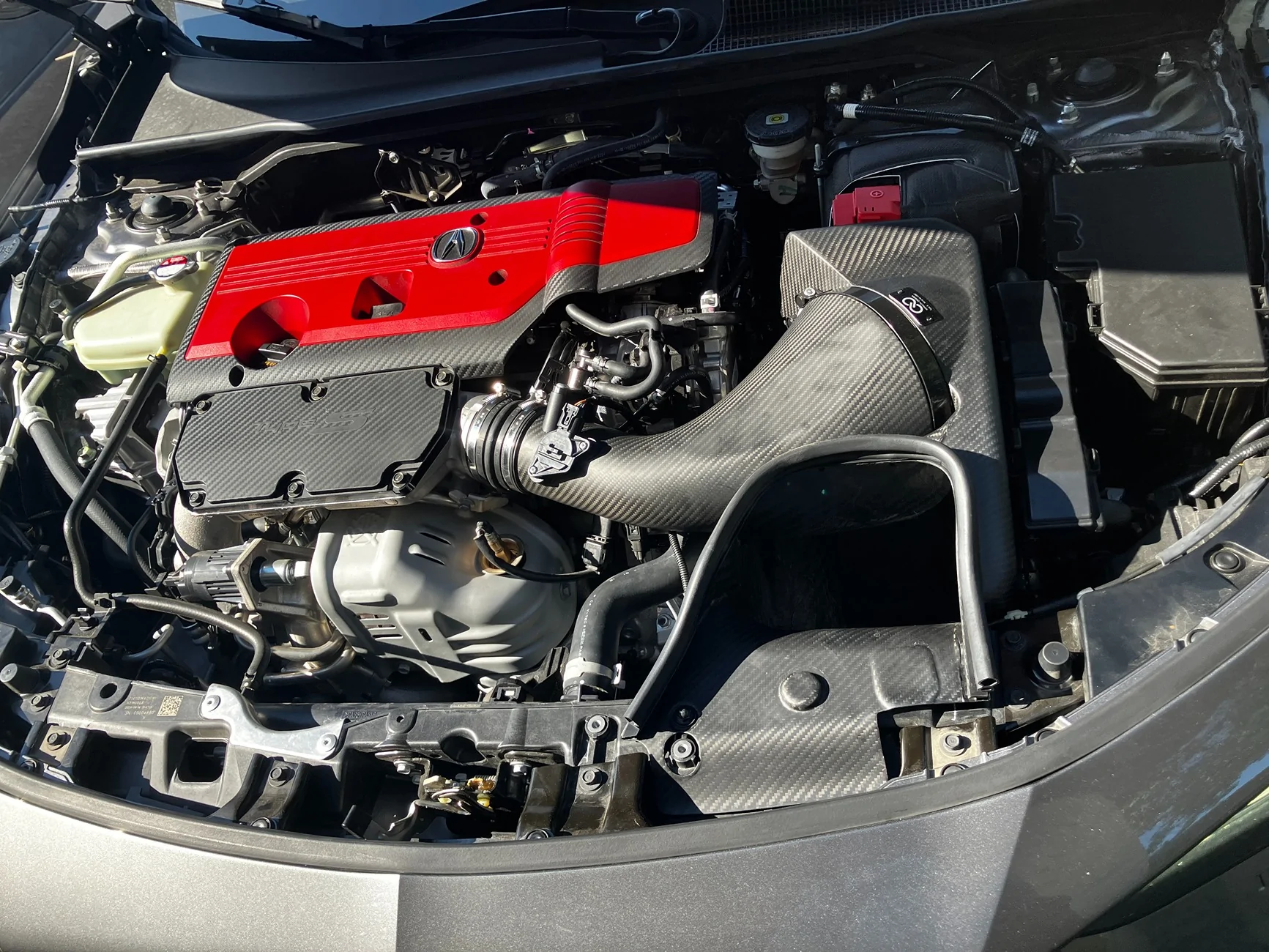

Installed HPS intercooler pipes and and my Infinity intake still need to swap the infinity turbo to intake pipe but saving it for another time... Love this intake thanks for importing these Unity!

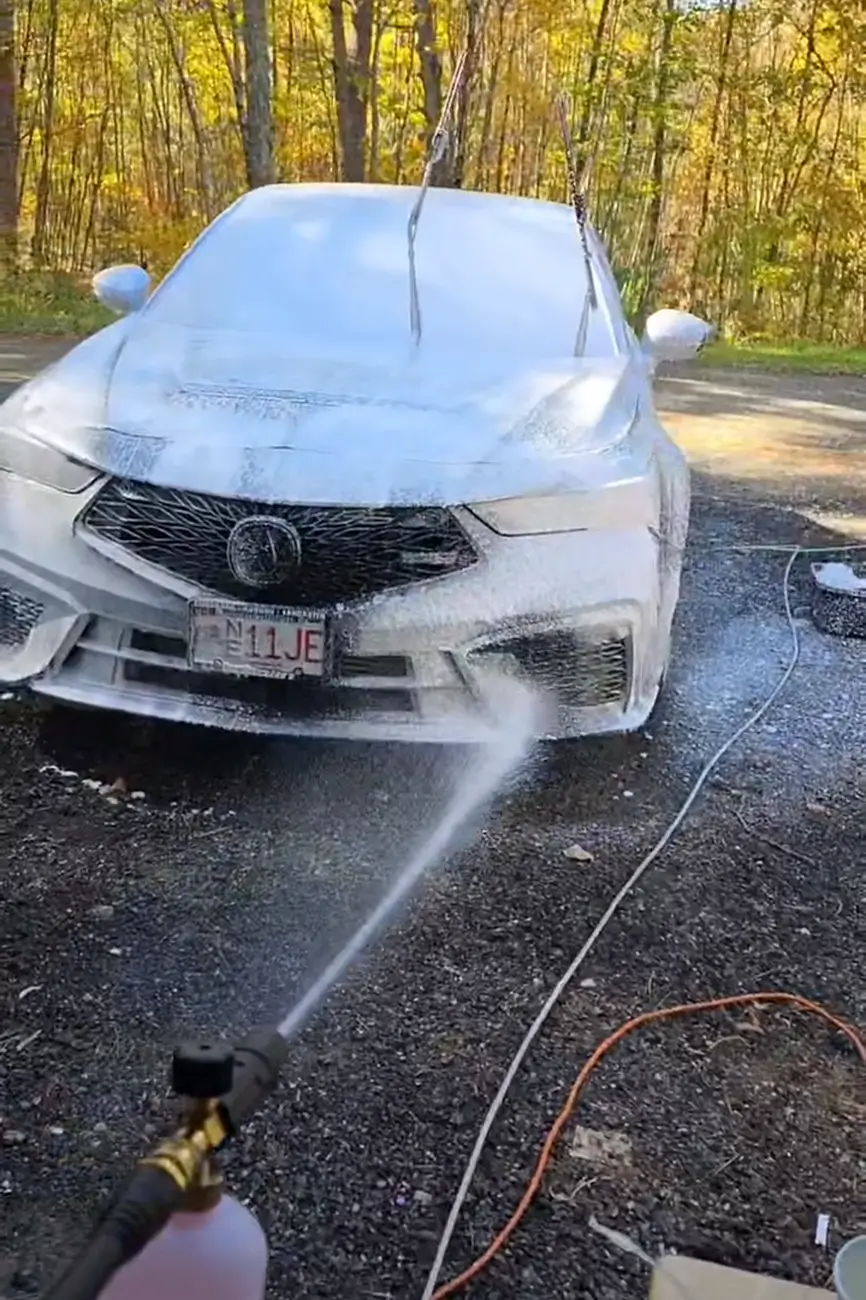

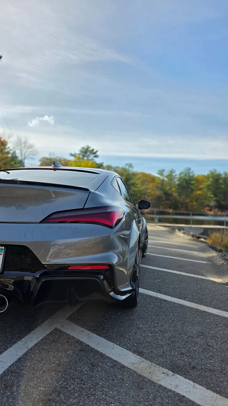

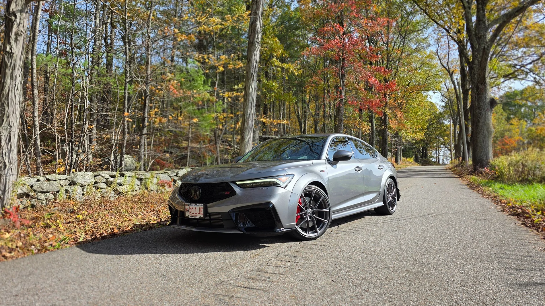

Kept it simple. I washed, clayed, and ceramic coated it. Let it cure for a couple of days, and then drove it for many smiles per gallon 😁
I appreciate the info on the fluids. I'll be using the AC Delco fluid to swap for the oem transmission fluid soon.
This car drives and looks so damn good! πŸ”₯
I'm always staring at it 🀩😍

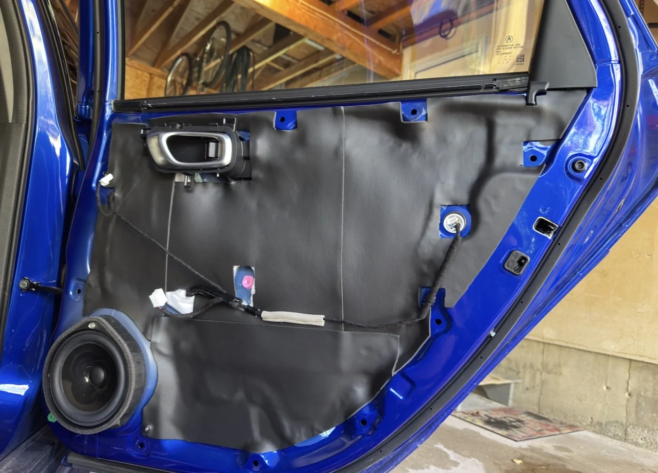

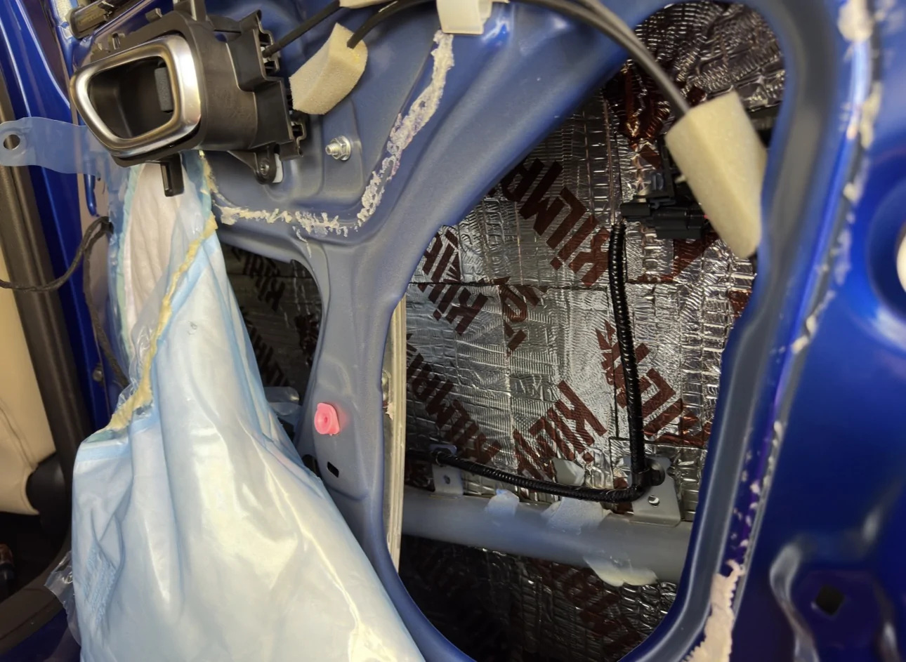

Anyone know of an aftermarket alternative to the green panel clips with a higher force threshold? Or is it possible the green ones lose a lot of their retention ability once removed?
I've spent the last couple days working on improving the cabin acoustics / road noise. I've done the doors so far (kilmat on the inside of the exterior and back of the interior panels, aggfoam over the vapor barrier), and one of my door panels is slightly warped and it's enough to keep popping one of the clips on its own. I've swapped clips around (thinking maybe that one was weak -- visually, it looked fine), but it didn't make a difference. I ended up adding some extra aggfoam to that spot so it doesn't rattle, but I'd prefer a real fix.
At least the doors sound so much more solid and satisfying to close.

The green clips bend too much when used, so I would treat them as one time use.
I inspect each when I pull off a panel and if the area around the bottom of the barb part looks a slightly different green or is bent, the clip goes in the trash.
They're cheap, just find a decent online parts supplier of the oem part and buy a bunch. Don't buy from dreamshop... They are stupidly overpriced there.

Check that door panel for a couple molded prongs that mate into the rectangular slots in the door pull handle mechanism. They can bend and interfere with reinstallation, resulting in what looks like a warped door panel.
