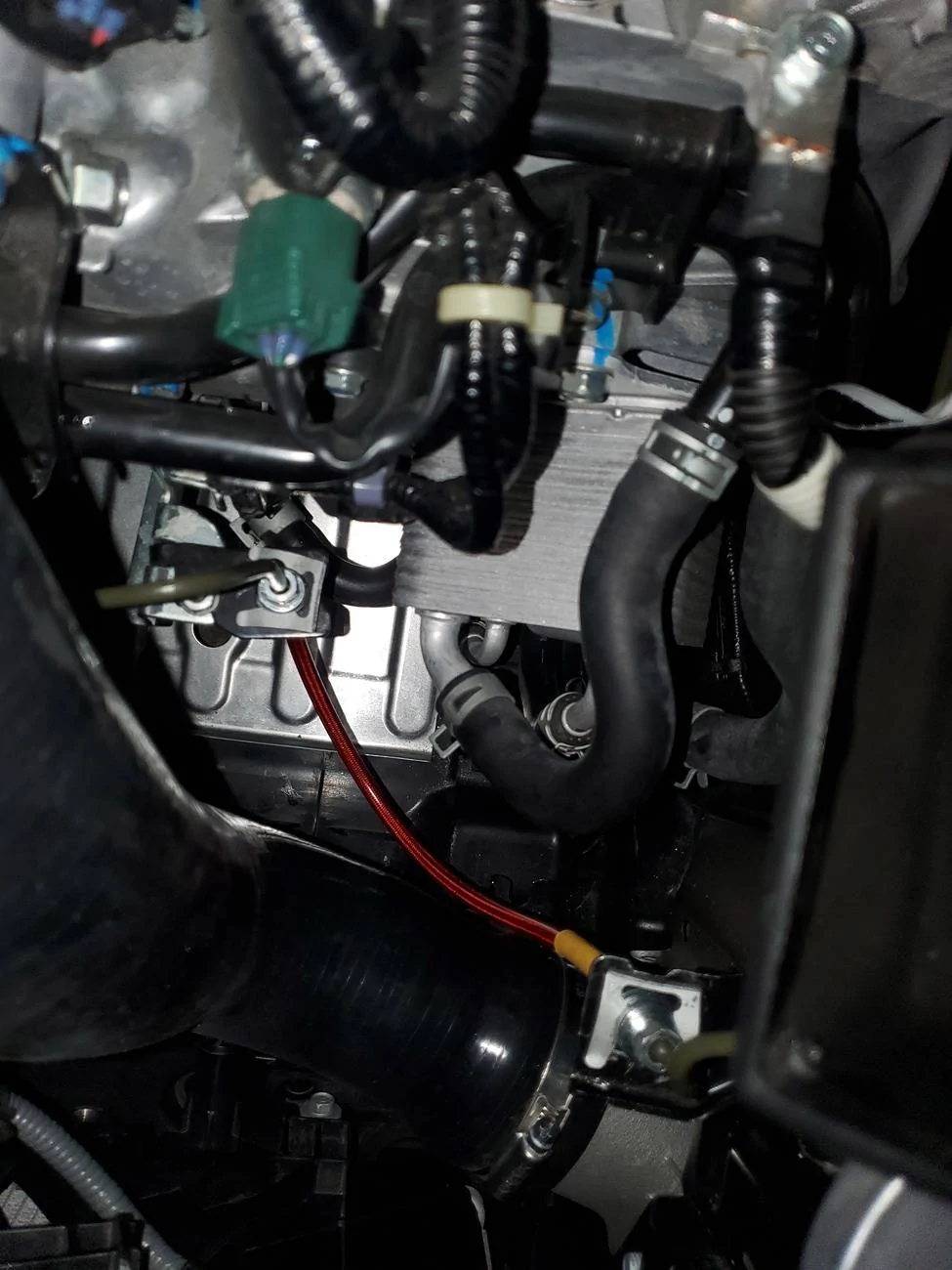

Installed the sirimoto clutch line. Took my time because of the brake fluid.
Easy bleed process with a stahlbus bleeder on the clutch mc. Clutch feels more direct and give some feel in clutch pedal.
Bleeding that line also helped my brakes feel even better. I guess there was some air left in the system.

Did you do the CMC bypass and CDV delete while you were in there?
Yeah, while bleeding the clutch isn't technically required while bleeding the brakes, it's certain wise to do so. Better fluid there makes a decent difference.
Agree 100%!
I did not. I am on the fence with those two mods. I know there is a better feel with the whole clutch package done.
I am just undecided at the moment.
But to be honest.... I was on the fence with the cluth line and I just installed it ?
