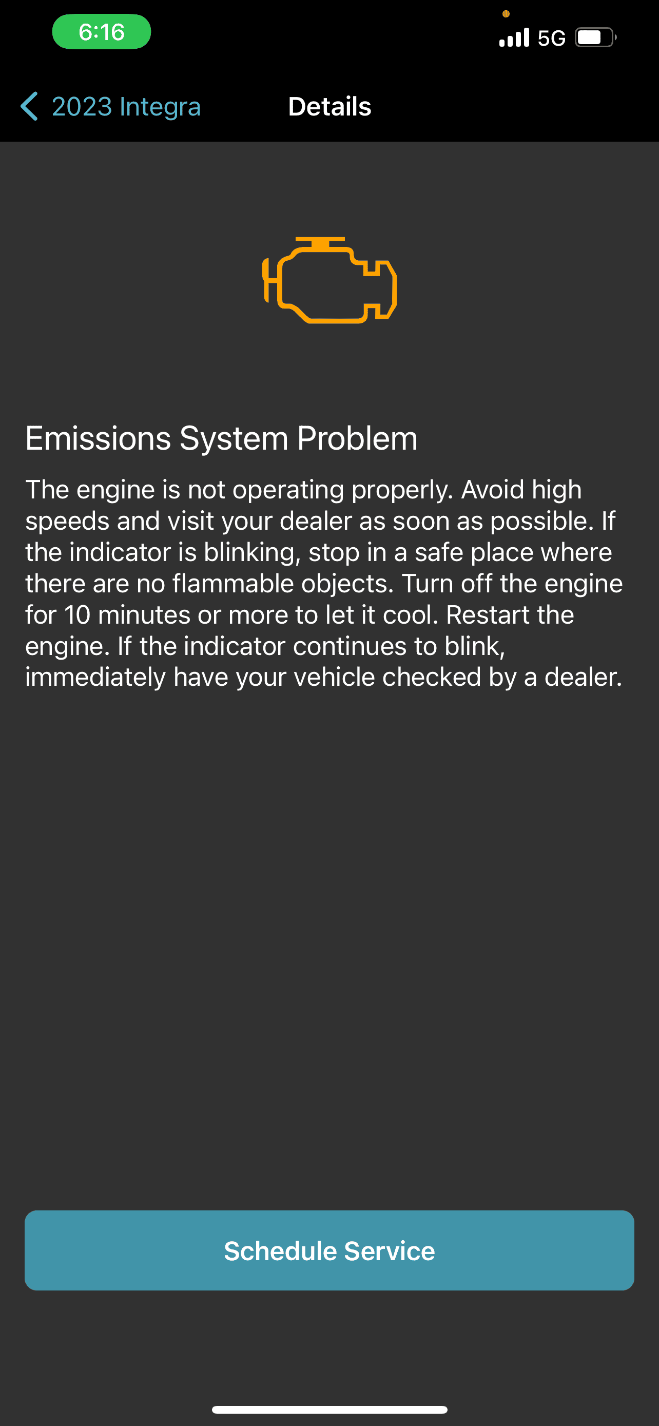

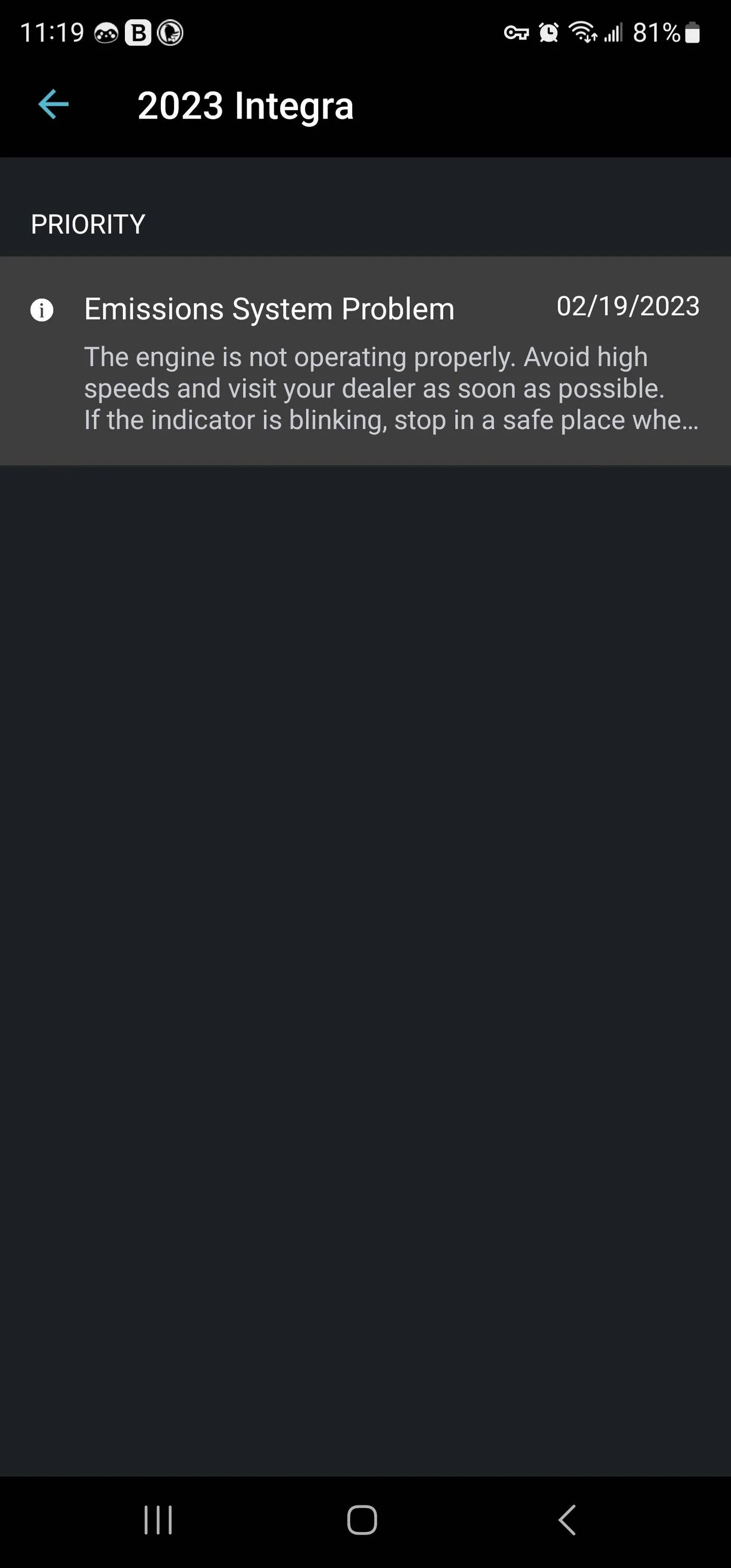

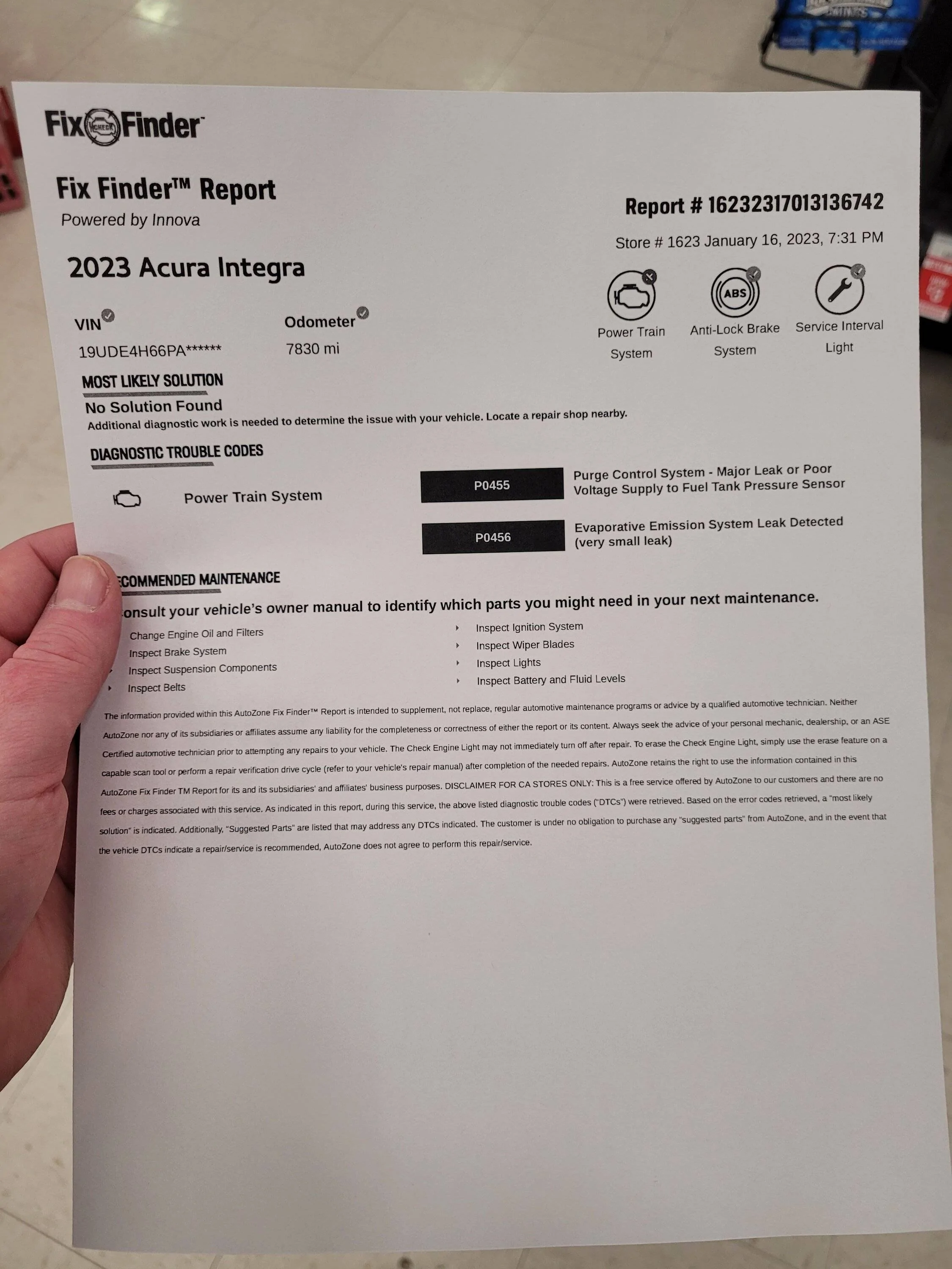

I promised I'd keep you updated and here's the most recent update. They dropped a loaner vehicle off on January 18th and held onto the Integra until January 27th. They said they replaced the "Purge Control Solenoid Valve" and the "Canister Vent Shut Valve" and hoped that that would solve the issue. Well...for the 4th time this check engine light code popped up again last night. This is the last chance that they have to fix this issue before it falls into the lemon law territory for my State. For anyone wondering, I fill up with 91 octane at a Love's gas station right off the highway. I count 5 seconds before I pull the nozzle out just like the manufacturer recommends. I'm kinda at a loss at this point. They're gonna be sending another loaner vehicle on Thursday so I'll let you know the outcome of this whole situation.

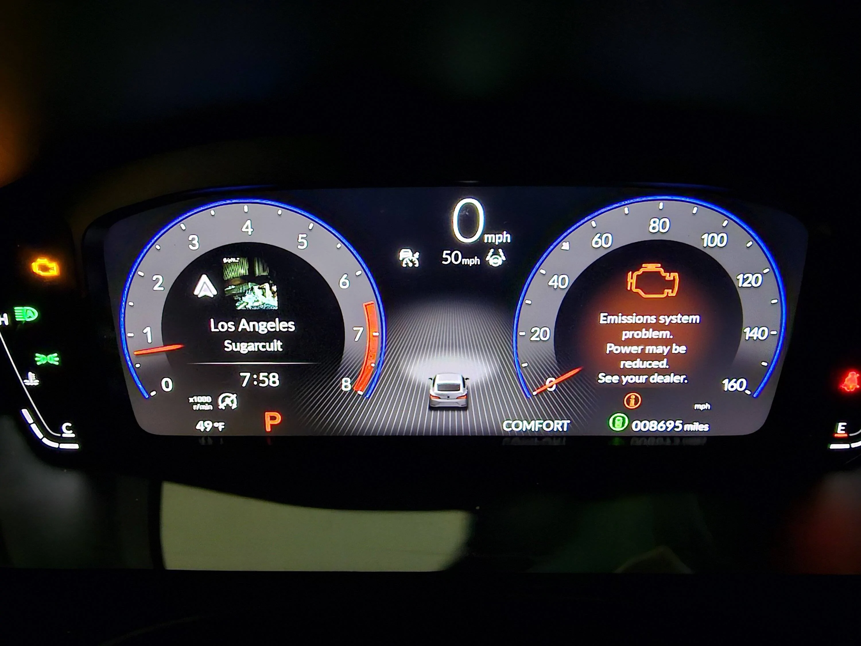

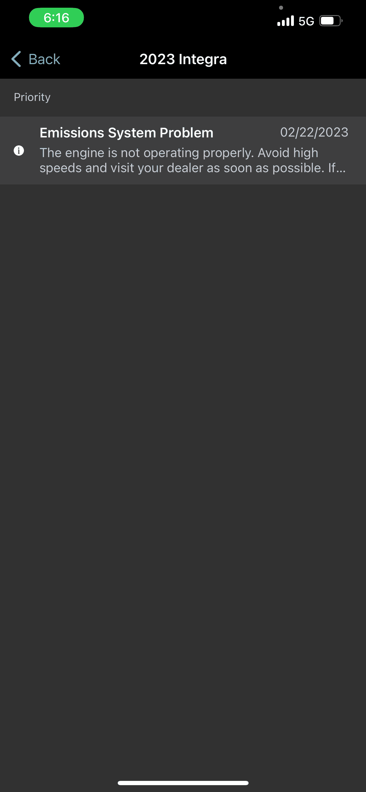

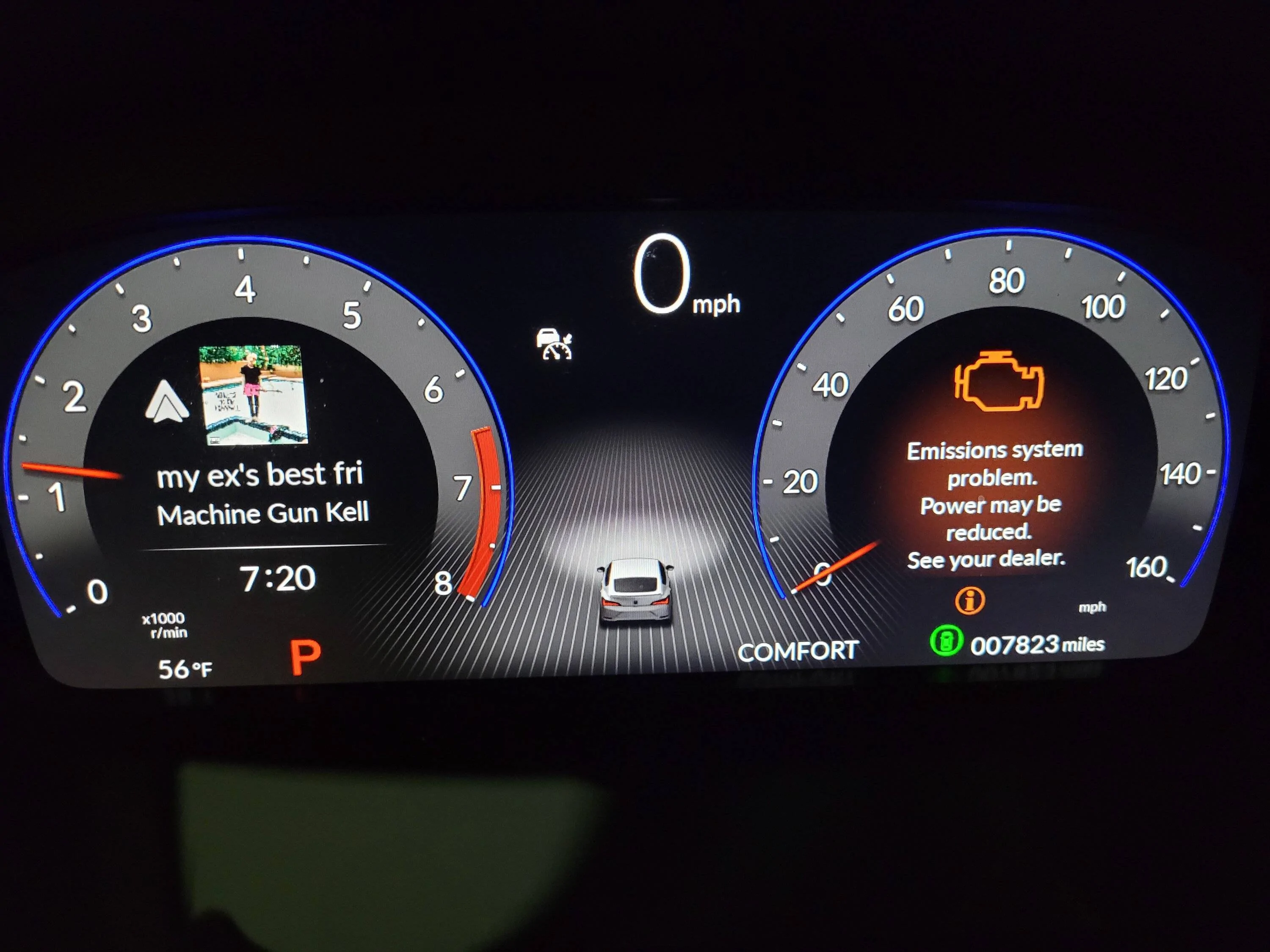

Same issue for me as well, just dropped my car off at the dealership today for the 3rd time for the exact same issue
