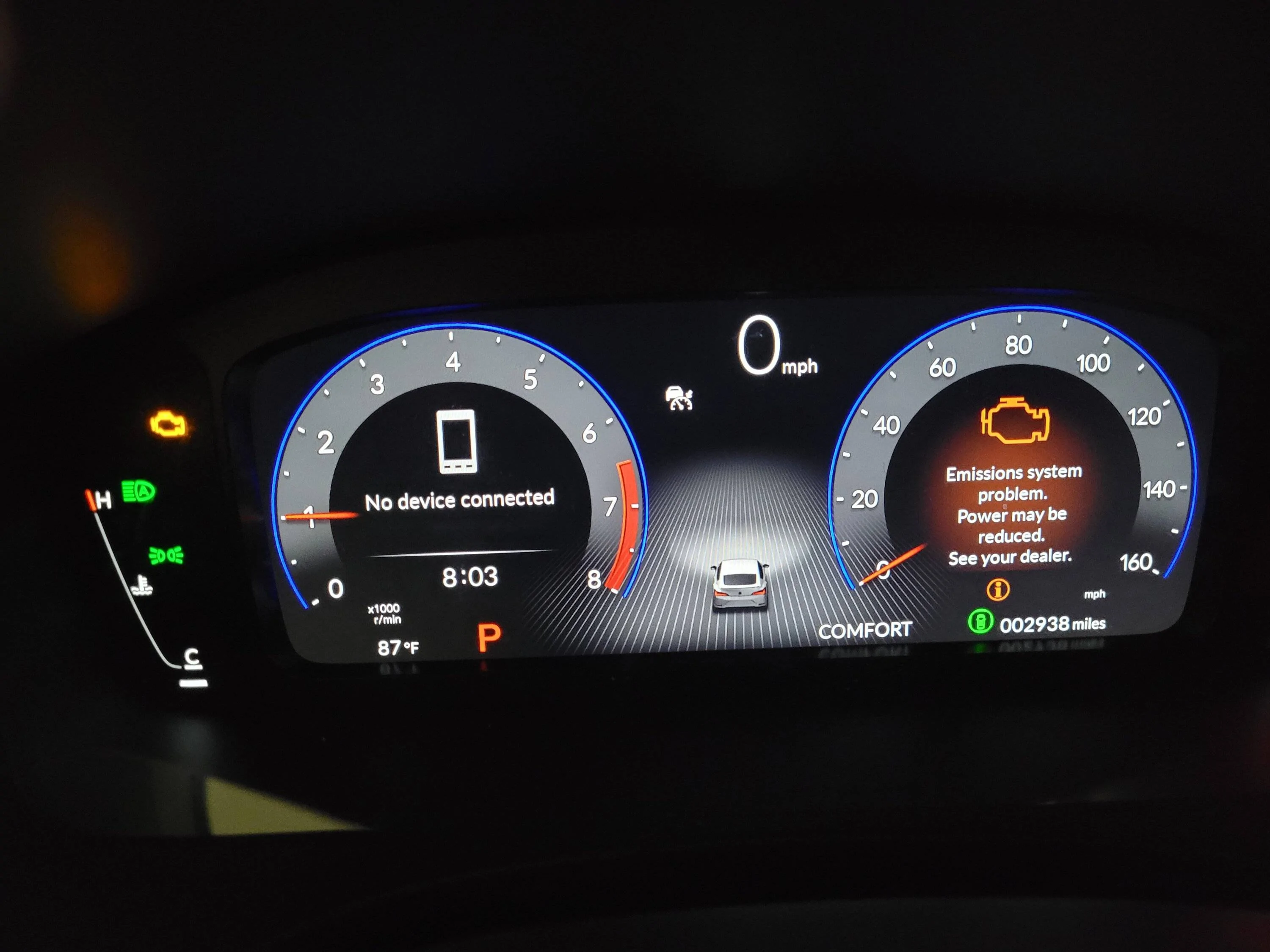

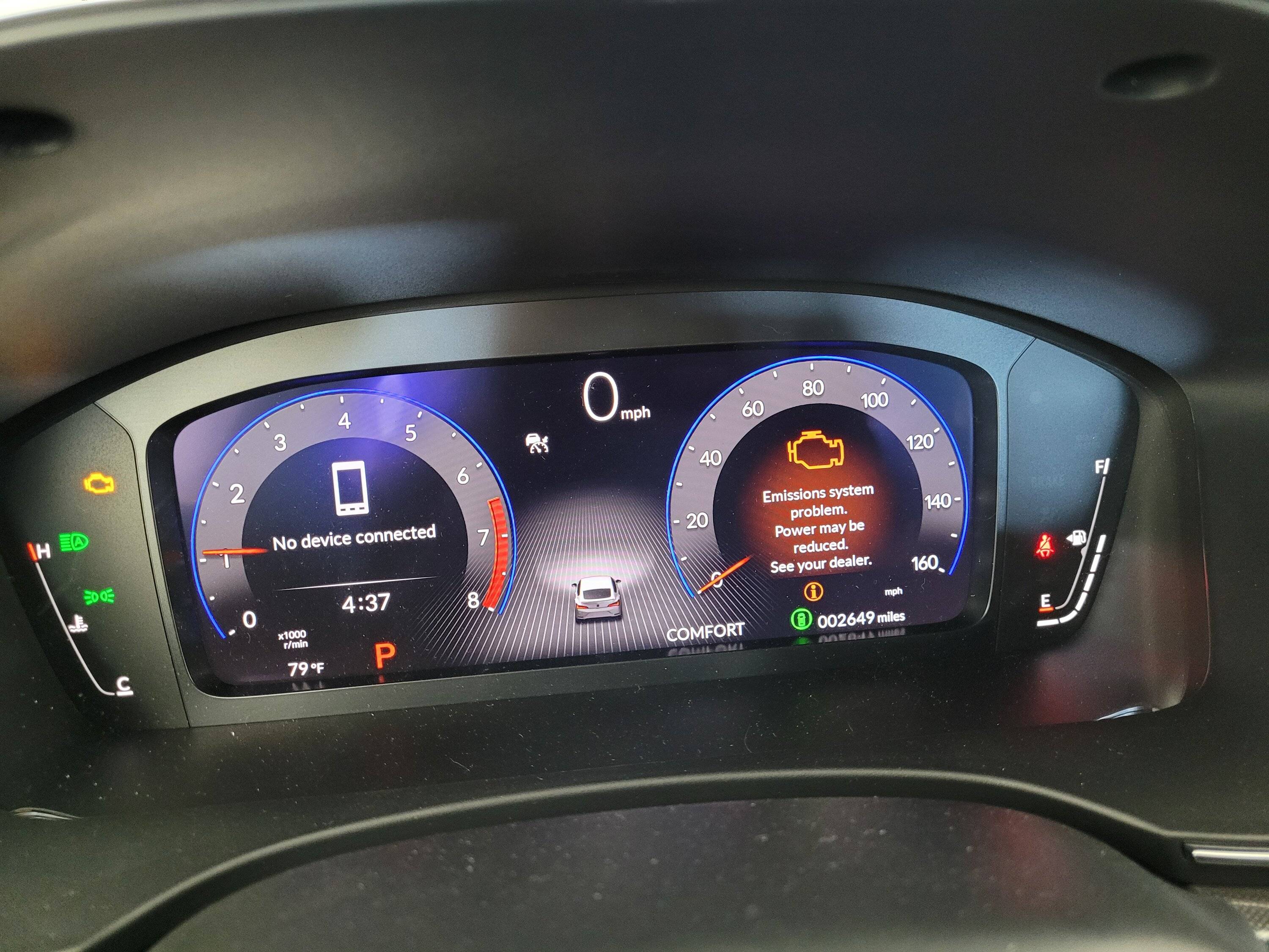

So I've had the same problem happen to me. I took ownership of my 2023 Integra with a CVT, yeah yeah go ahead and rag on me, back in June and I've put 2649 miles on mine when the check engine light came on. This happened a couple days ago and the earliest any Acura dealership could see me was today so hopefully it gets resolved.

So I got my Integra towed to the dealership on Friday, September 16th, and they explained that the check engine light/ emissions problem turned out to be error code P0455 and P0456 "Small and Large EVAP Leak detected." They performed the EVAP test on my car and it passed with no problems. They then checked the system with their smoke machine to verify everything was sealed properly and it passed that too.
They reached out directly to Acura and they said they're tracking at least 5 other Integra's experiencing this same issue. They decided to simply clear the code and give me back the car. Well...the same emissions error just popped up this afternoon and they're closed so hopefully I'll be able to get this resolved tomorrow.
