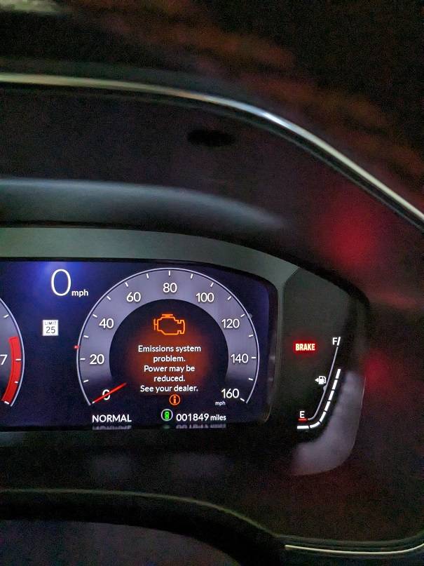

Seems like this issue is hitting a lot of us who purchased the new Integra. Mine is an early delivery MT (VIN is number 450 off the line!) purchased last June, and I just got this CEL today out of nowhere. I'll be heading into the dealer to discuss, but I am not too happy about a $180+ diagnostic fee they quoted over the phone, if we already know this is a problem nationwide...

Seems like this issue is hitting a lot of us who purchased the new Integra. Mine is an early delivery MT (VIN is number 450 off the line!) purchased last June, and I just got this CEL today out of nowhere. I'll be heading into the dealer to discuss, but I am not too happy about a $180+ diagnostic fee they quoted over the phone, if we already know this is a problem nationwide... View attachment 225772
There should be no reason a dealership charges a diag fee. I would call a different service center. None of mine charge a fee if the car is covered.

Well, I am glad I had this owner group to reference! Went in to talk to my sales team and the GM. Explained how this light was on, what many of you have experienced already from what you have shared on this forum, and how I was quoted a $200 charge to troubleshoot. They were apologetic to say the least, and the GM asked me to wait a moment while he went back there and had a short conversation.
Apparently the guy on the phone was new and didn't know how it worked with customers who had purchased brand new cars at their dealership. Once that was straightened out I ended up leaving the car for them to look at and make the filler neck repair, as well as hopefully my first oil change. Service team rep when she was checking me in said they have already had 2 other Integras in for the same CEL and fix.

Update: Dealer kept my car over the weekend (my choice) and not a penny was charged for diagnostics or repair/service. As it should be.
They identified the CEL as: p0455 p0456 Evap leaks. Ordered fuel filler capless unit.
Part is backordered, but they temporarily cleared the code for me with assurance that there would be nothing mechanically hazardous if it came on again. I am the 3rd Integra owner with this issue at my dealership, according to the Service dpt. rep, but they will let me know when it arrives. I also received my first free oil change (filter P/N 15400-PLM-A02 and AC-U0W20 full synthetic oil, in case anyone needs it in the future) and complementary tire rotation. Ironically the CEL has stayed off since I picked the car up, but we'll see.
