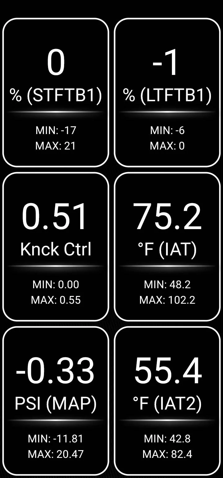

Just had this issue pop up my car 5 days ago. I remembered this thread. Now before the cel I did something I don't normally do. I filled up at a mom and pop gas station because I was very low and in a rush to get to work. 2 days later this code popped up. P02455, p02456. I decided to check my fuel trims on ktuner and this what I saw.
Acura Integra Integra Emissions System Problem Screenshot_20230114_063004_TunerVi

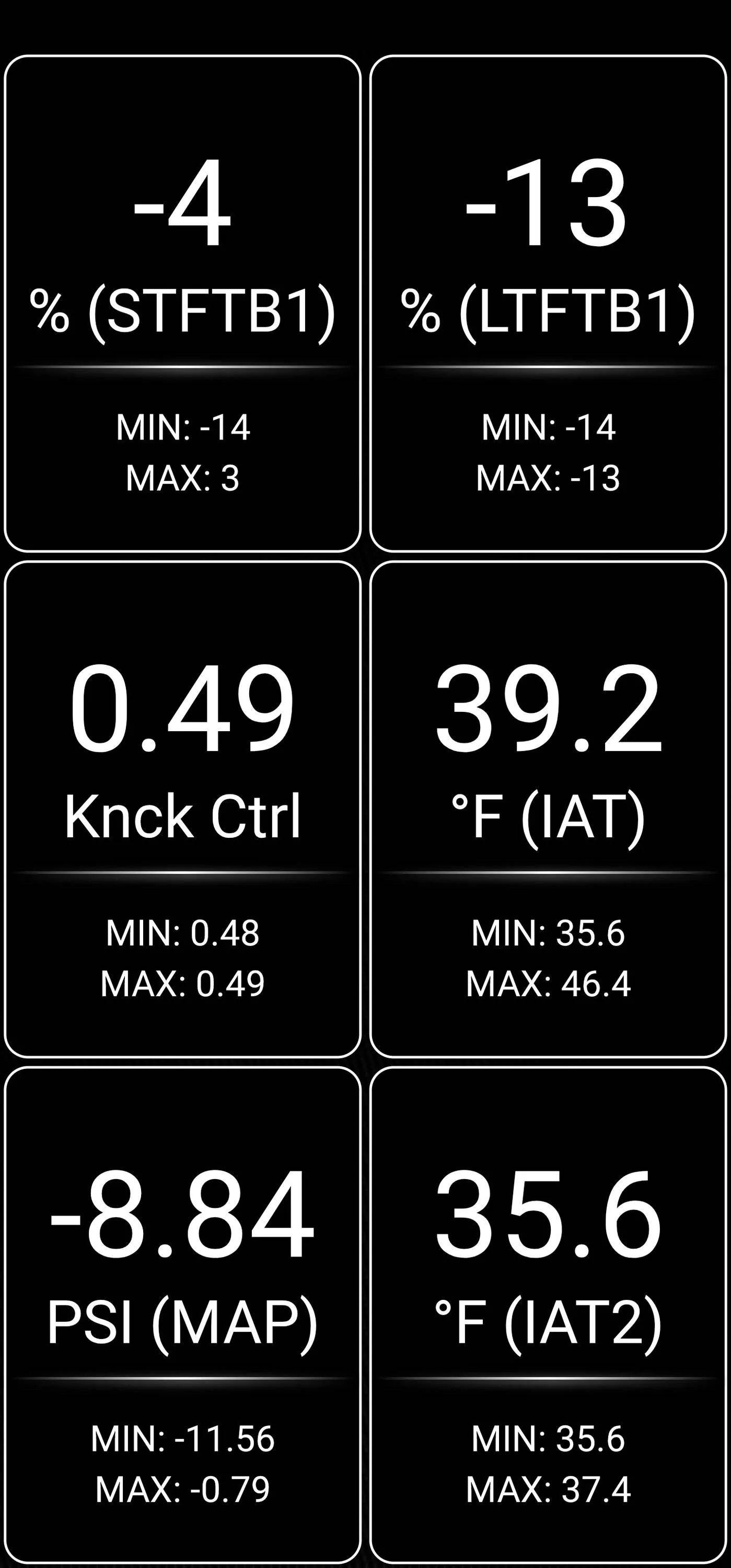

-14 on ltft which is really high,my avg is -4 to 0. Before I decide to make an appointment to see the dealer I went to my usually gas station and filled up on 93. Within 20 mins my ltft dropped to -5.

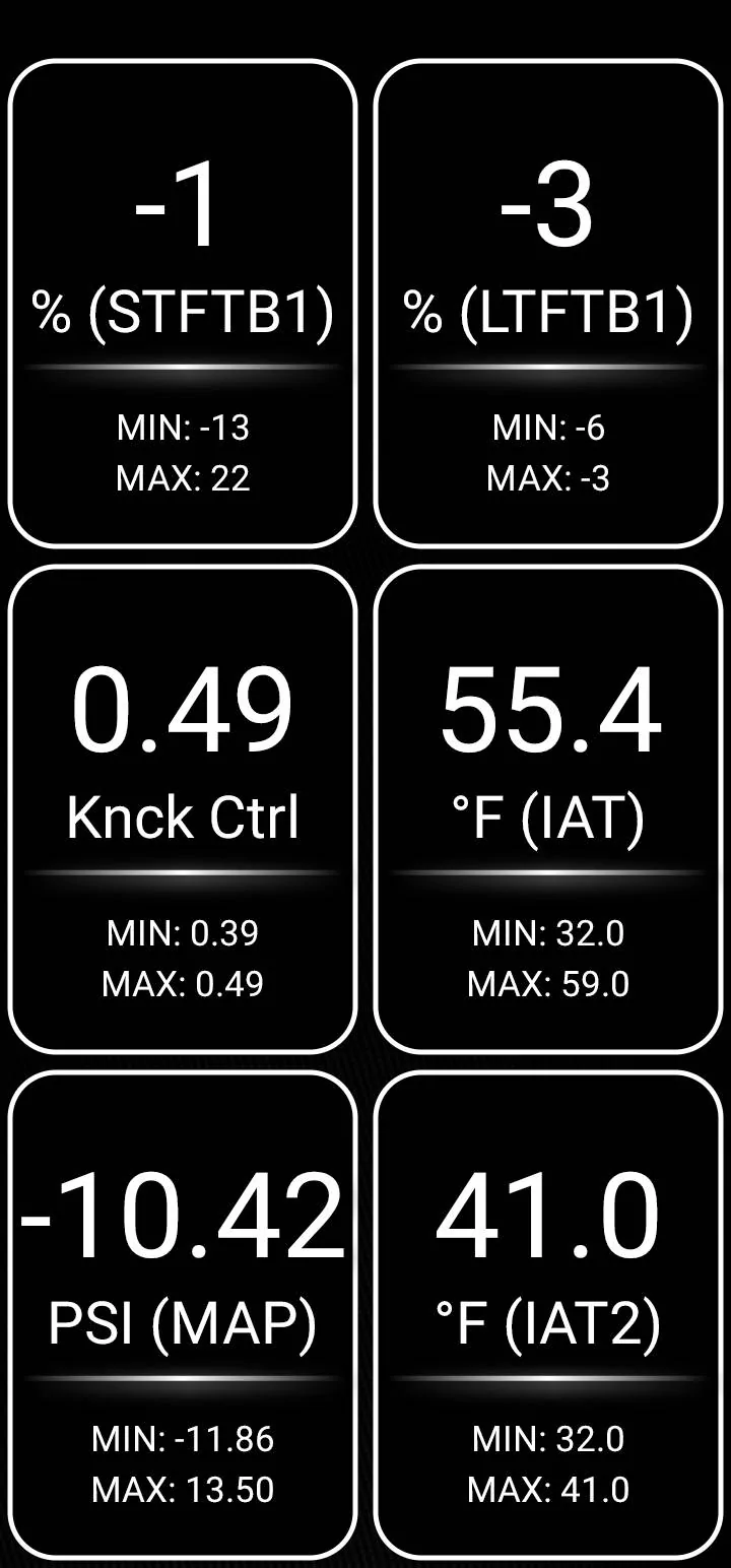

Acura Integra Integra Emissions System Problem Screenshot_20230114_064712_TunerVi

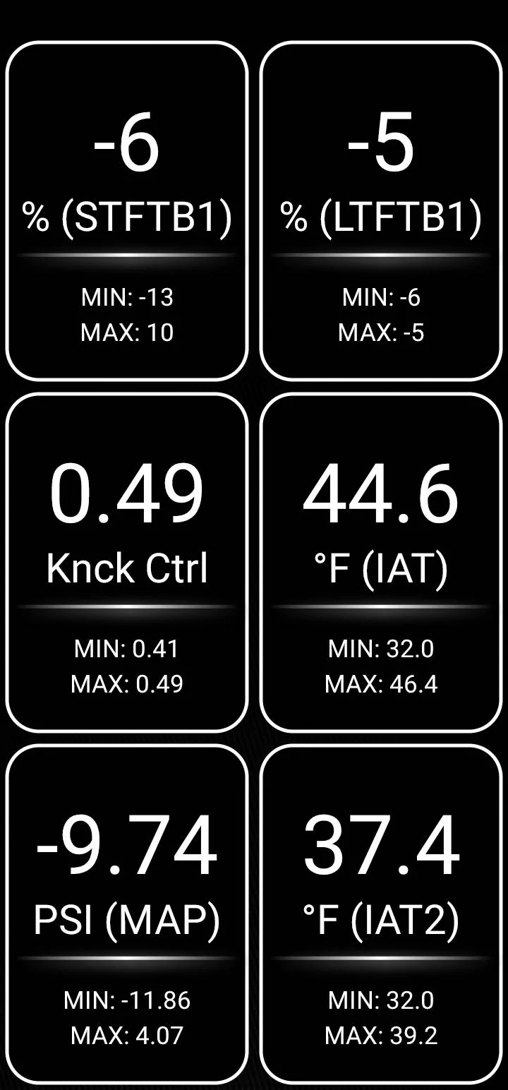

I cleared the cel drove for a few days and has no come back and my ltft are still within range
Acura Integra Integra Emissions System Problem Screenshot_20230115_064657_TunerVi
So it's either two things.

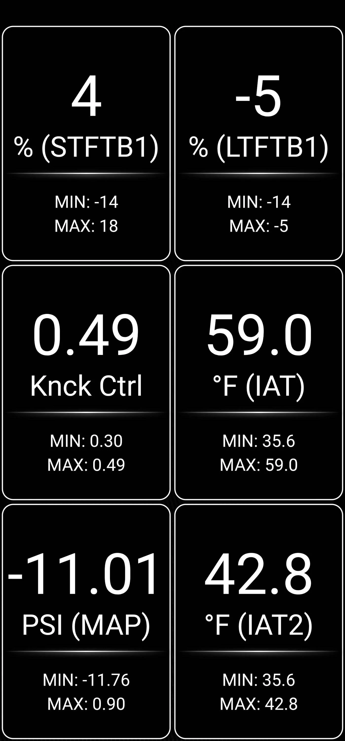

Bad gas or I rushed filling up and left fuel in filler neck and going back to another gas station release whatever fuel was trapped but doesn't explain the high ltft ?‍♂
Acura Integra Integra Emissions System Problem Screenshot_20230115_064305_TunerVi
RB2490
Sep 12, 2016
399
301
new york
It's been 200 miles so far, no cel and fuel trims back to normal.
