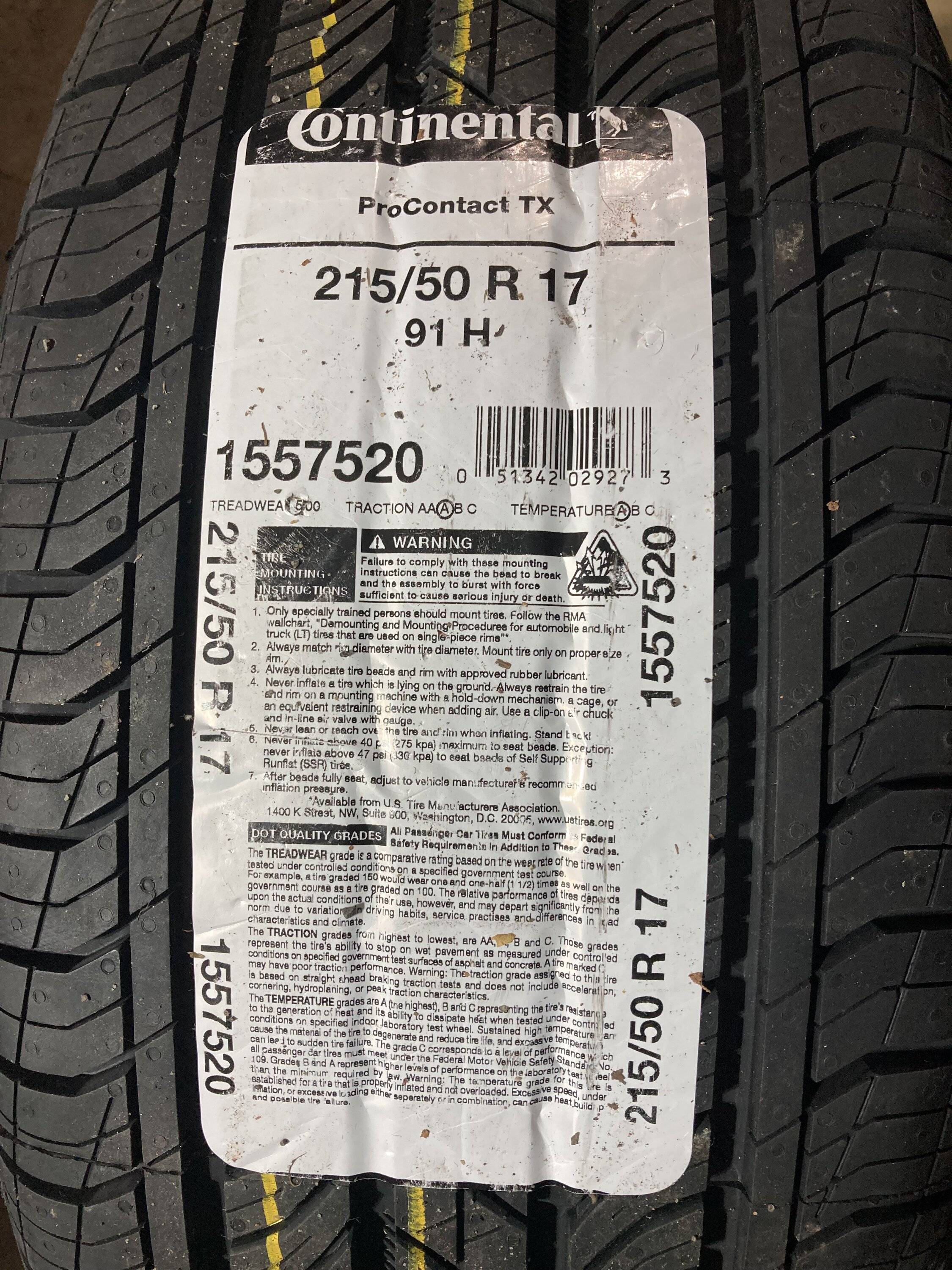

Here is the tire I bought: Continental ProContact TX 215/50R17 91H
The wheel I bought was the basic steel wheel (very plain) with 17 inch diameter and 7 inch width. I chose this wheel because I could not find a fancier looking one at TireRack which looked close enough to the wheels on my 2023 ATech to make it worth the extra money. So I went with the ugly+cheap option.
I have not yet mounted it to prove it fits on all 4 wheels (I need to borrow a jack from other family members, later).
It does fit in the spare tire well, with the folding trunk floor sitting flat enough to satisfy me (just the tire is there: I removed the original foam filler thing that came with my car):
The edges of the folding trunk floor touch where they are supposed to touch at the left and right edges, so for any cargo-carrying needs, this is good enough for me.
I can feel a small bulge near the center of the folding floor if I put my hand in the area a few inches forward of where the moveable trunk floor folds, so the foldable trunk floor is not actually 100% flat. But visually, or for carrying cargo, it is fine. And I love the idea of having a full size spare without any goofy range or speed limitations.
A note on tire width: the specs I found 2 days ago on a (non-Continental) web site for the Continental ProContact TX 215/50R17 91H tire said it was 8.5 inches wide. Upon arrival I measured its width at about 8 and 13/16 inches wide. And just now I found another site (https://tiresize.com/tires/Continental/ProContact-TX-215-50R17.htm) saying it is 8.9 inches wide. This is the critical dimension for whether a full size tire is going to fit in the spare tire well. There might be other tire choices that might be even a 1/4 inch less wide than this one and be a better fit.

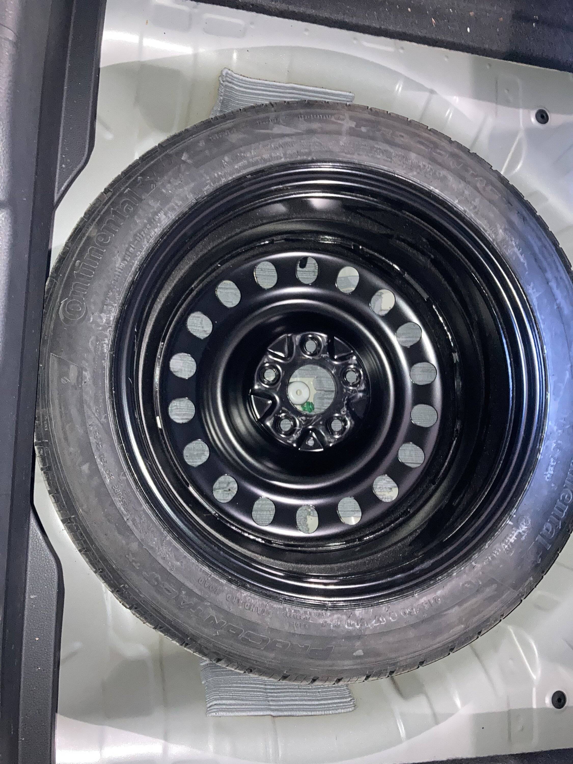

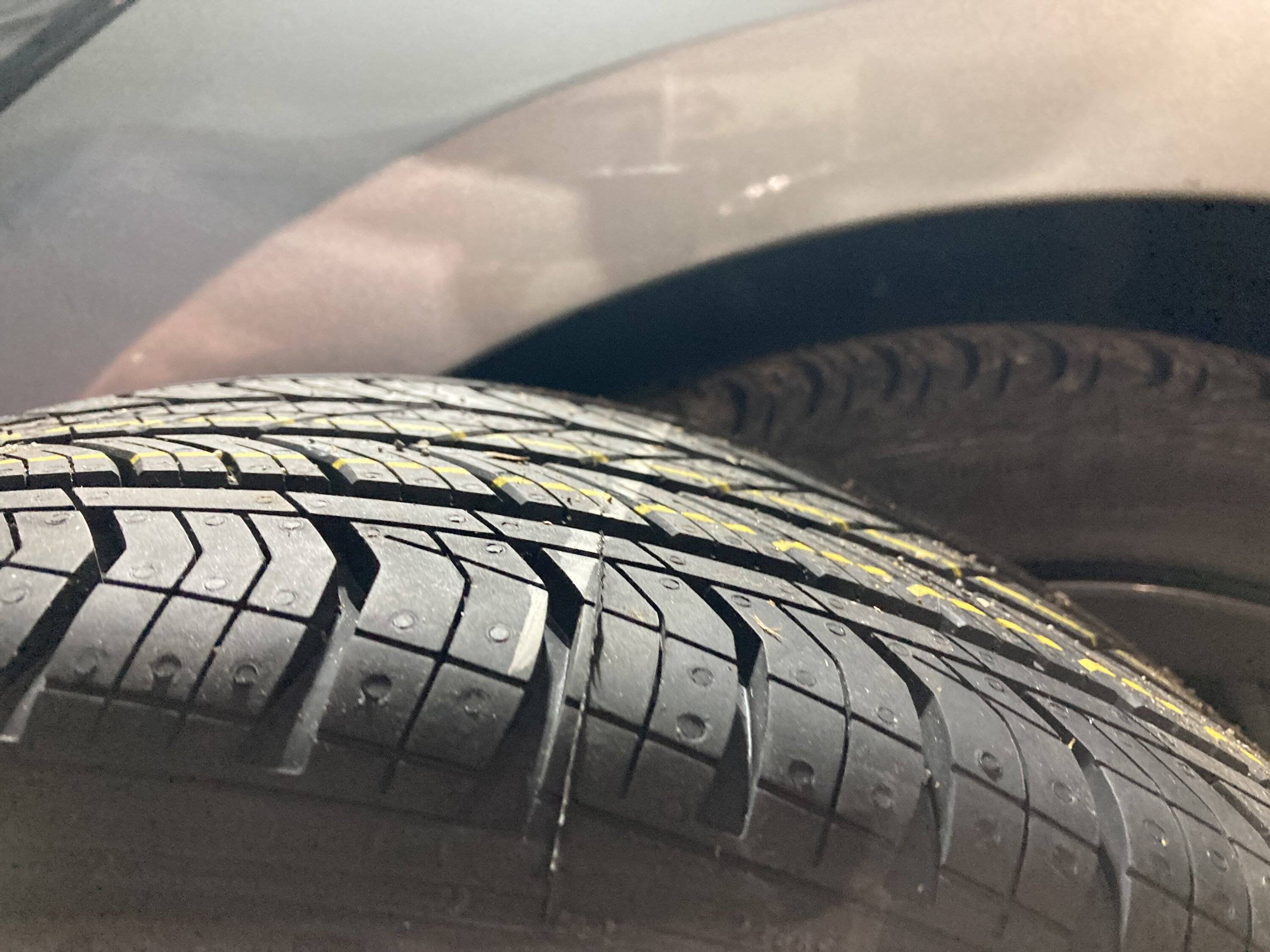

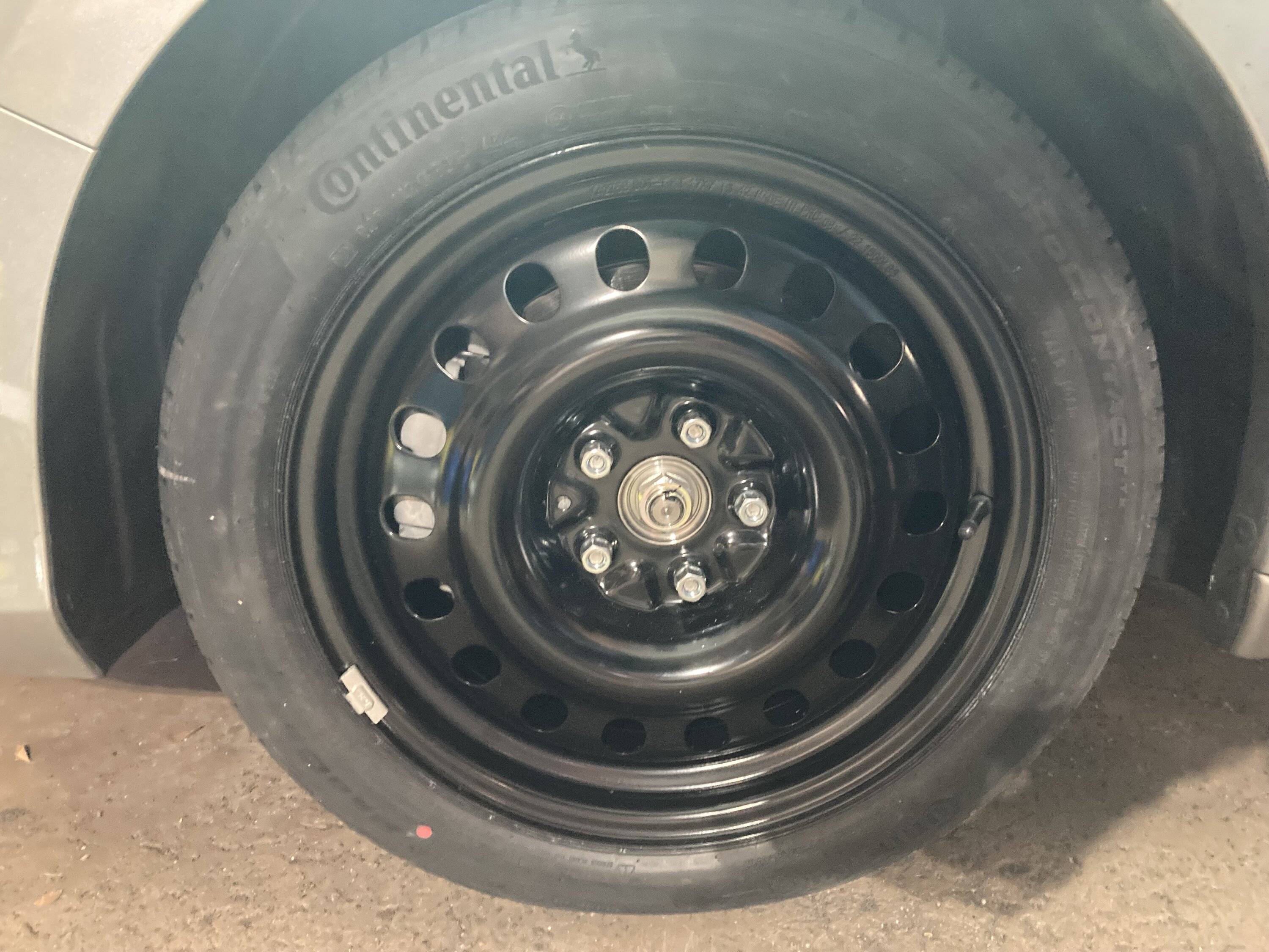

I did put this full size spare on the front, and did a quick local drive where I got up to only 45mph. It seemed fine. I hope these pictures will help answer questions for others who might want to get a full size spare tire. The first 4 pics (the second shows the tire width, and the third shows that the outer tire diameter seems to match that of the original tires that came on my ATech):

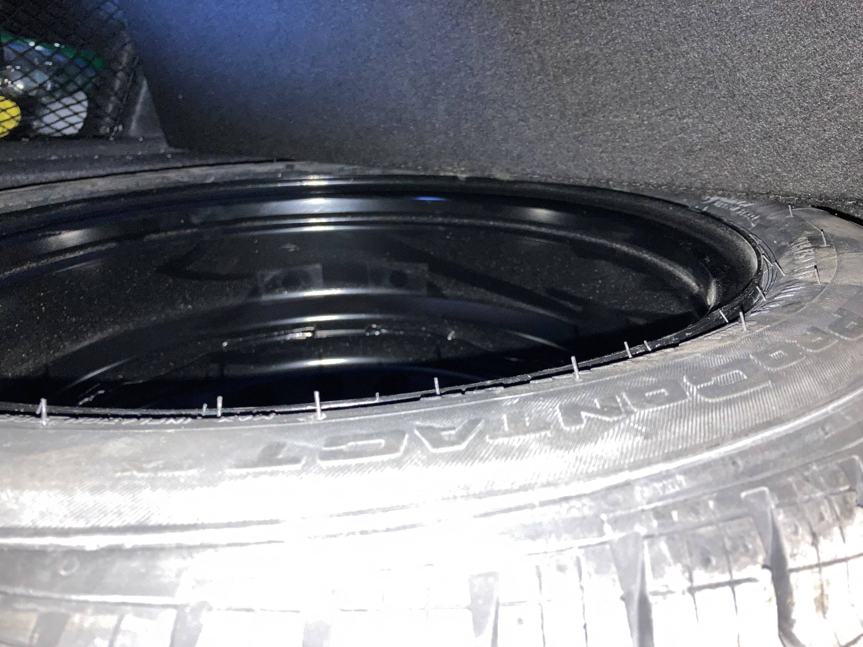

The next 2 pics show the tire+wheel sitting in the spare well, first from above, the second a near-horizontal view with the folding trunk floor half open (shows tire is in contact with folding trunk floor):

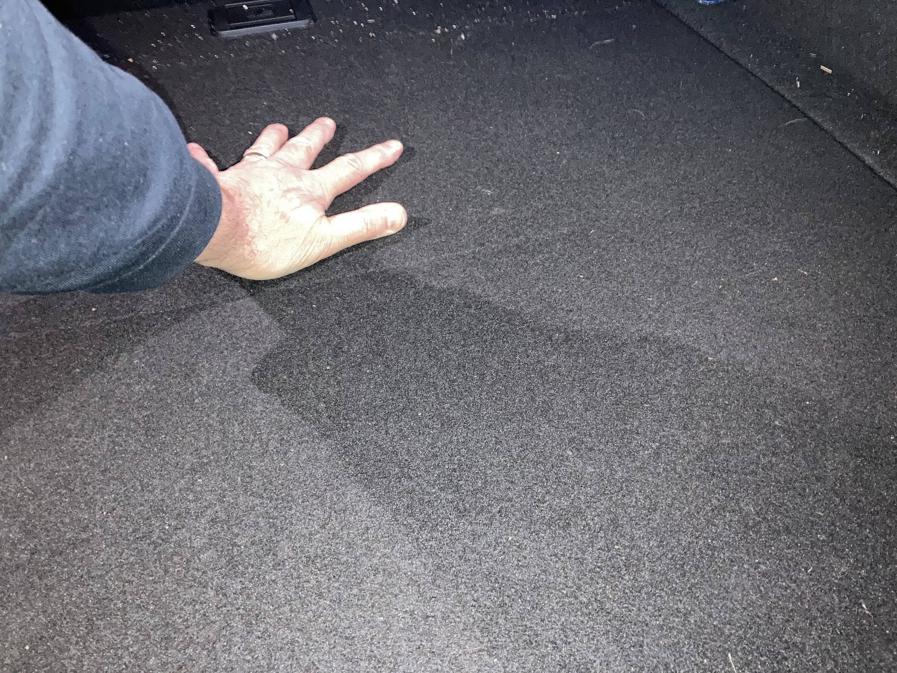

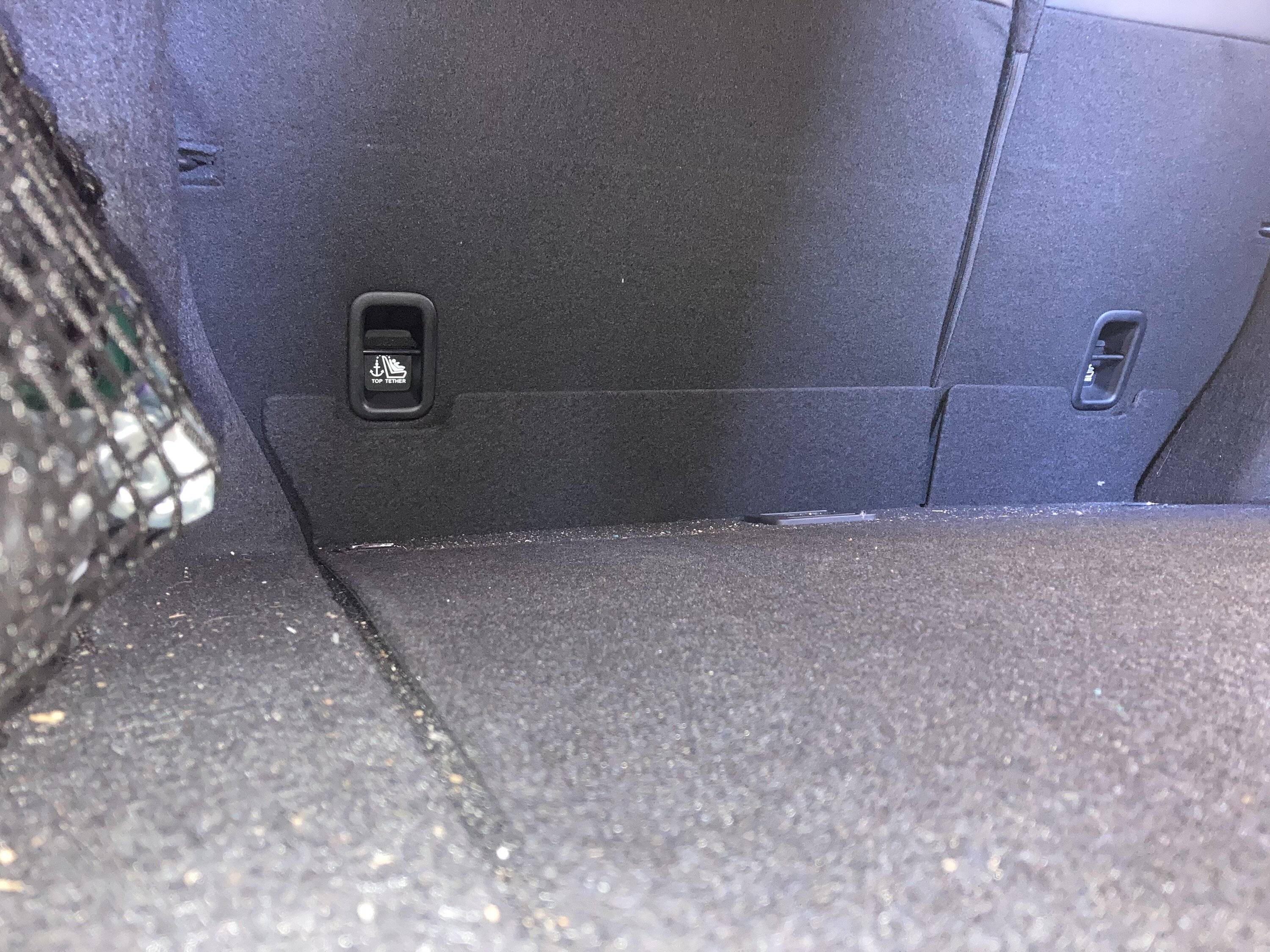

The last two pics show the bulging. The first shows my hand where the bulging of the folding trunk floor is most noticeable. The second show the left edge of the folding floor - a close look shows it is not totally in place. It is close enough for me, and I don't think would be noticeable to anyone who casually opens the hatch. And I don't think it impairs the ability to use the hatch area for cargo. I chose this tire because it is what comes standard on the Acura base. A different tire with the same diameter but perhaps 1/4 inch smaller in width might eliminate the bulge.

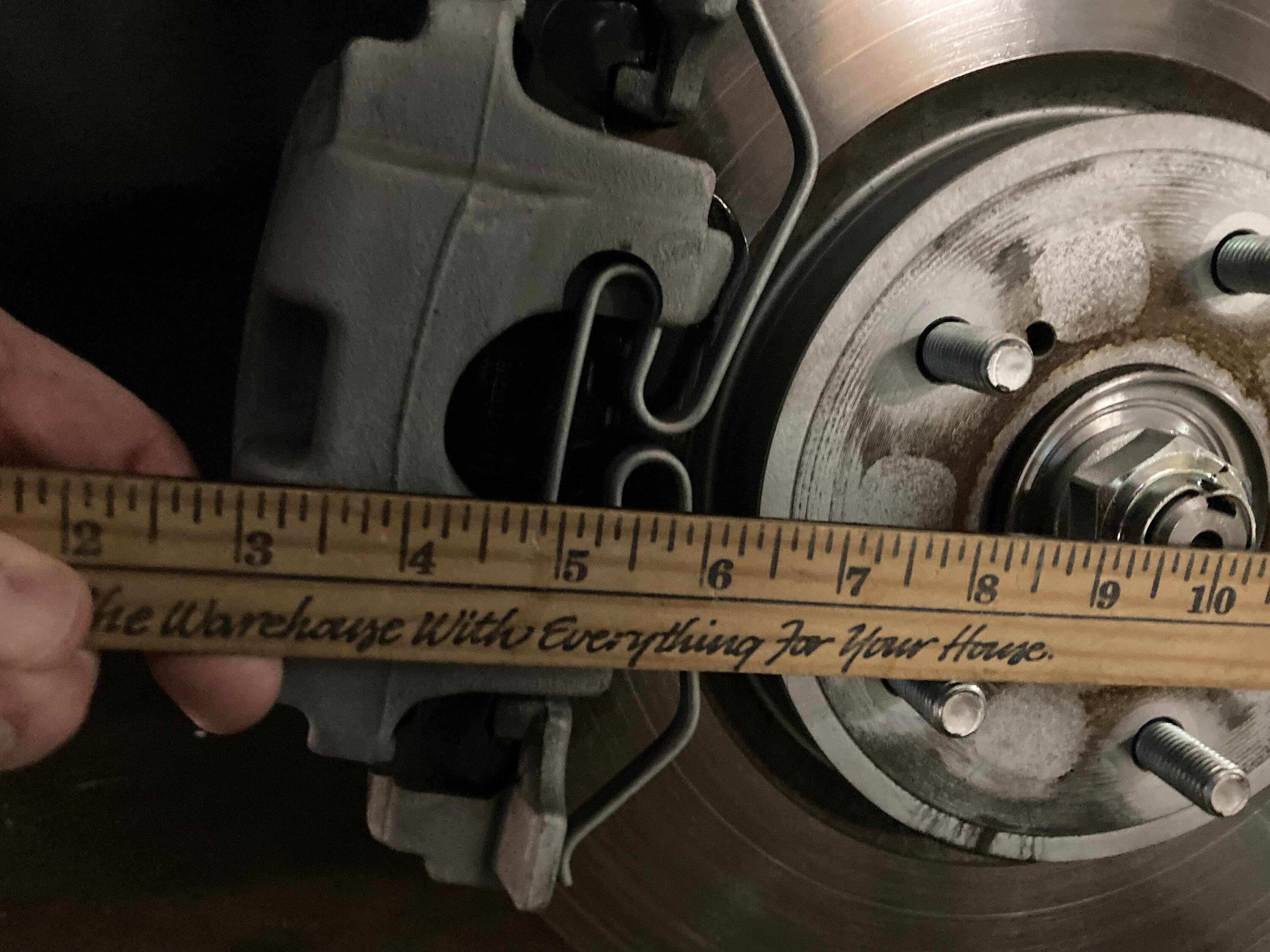

thanks for your detailed info. I tried a compact spare. it fit the car, and drove ok. My only concern is the clearance on the front brake is very small. Did you happen to put your hand in there to see how much room there is between the brake caliper and the wheel?
carl3pedals
Oct 21, 2022
NJ
2023 Integra 6MT

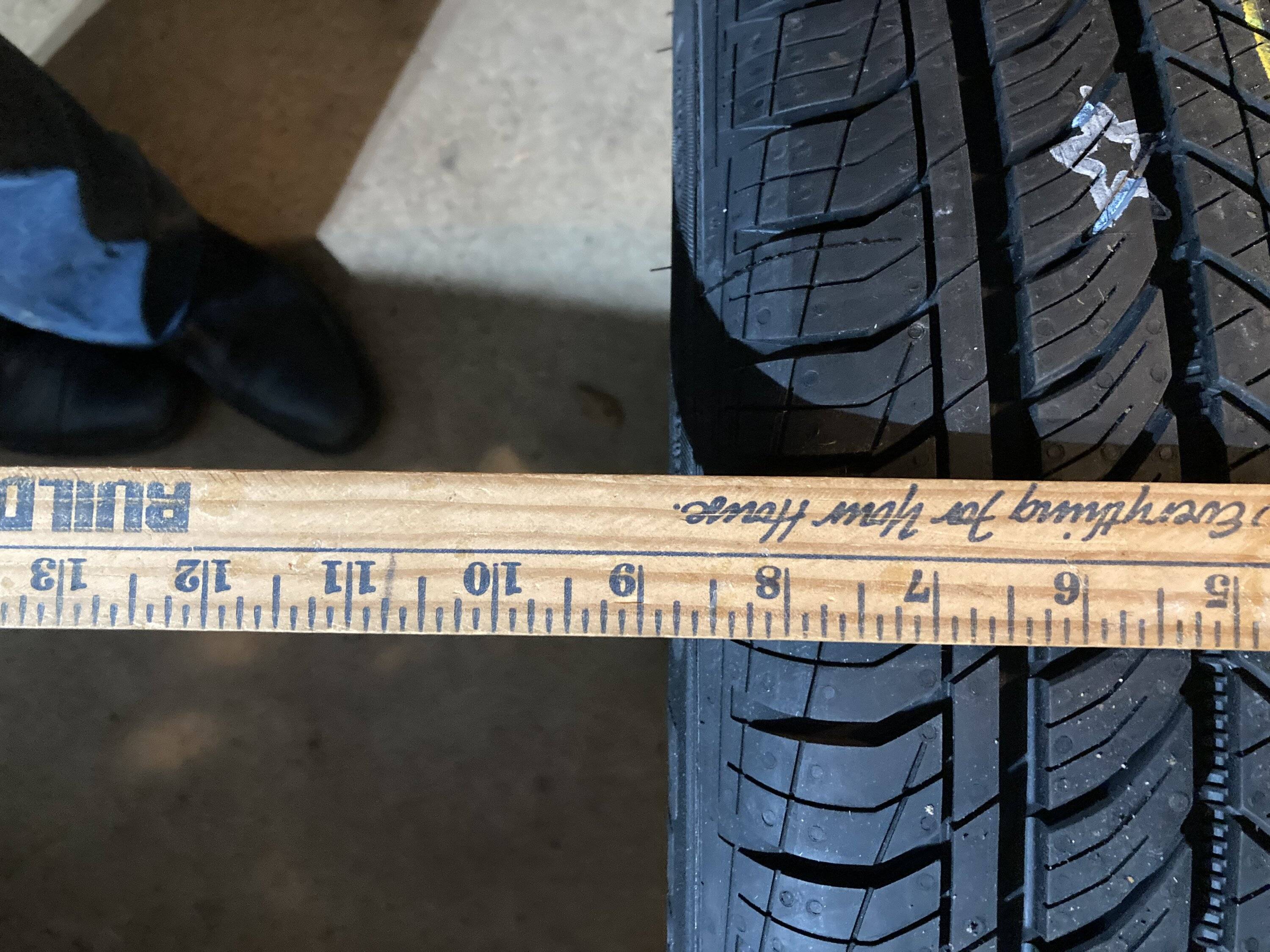

This picture attempts to show the "radius" dimension from the center of the hub, to the outermost clearance point of the disk brake assembly, on one of the front wheels. The "10" inch mark on the ruler was centered on the hub, so the radius dimension was a little over 7 inches. I can't speak for what offset clearance is needed. My impression was that the 17" spare wheel that I bought cleared the disk brake assembly with ease, but I did not stick my hand back there to prove by how much. I am not a wheel and tire expert, but I think the 17" size of the wheel refers to its outer diameter, not inner clearance.

Thanks for taking the time to measure. You are correct that the 17" refers to the tire diameter. I am not sure what you are referring to about "offset". Because I had read here and other places about the front brake being larger than the rear, I tested the compact spare I purchased to make sure it would work on the front. I mounted it and it spun freely. but there is only 1/4" clearance between the brake caliper (the area in your picture where the 3 is on the ruler) and the inside of the wheel.
