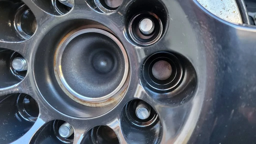

Thanks for taking the time to measure. You are correct that the 17" refers to the tire diameter. I am not sure what you are referring to about "offset". Because I had read here and other places about the front brake being larger than the rear, I tested the compact spare I purchased to make sure it would work on the front. I mounted it and it spun freely. but there is only 1/4" clearance between the brake caliper (the area in your picture where the 3 is on the ruler) and the inside of the wheel.
Offset refers to the backspacing of the face of the wheel from the center. It is an important number to use when ensuring a wheel will fit.

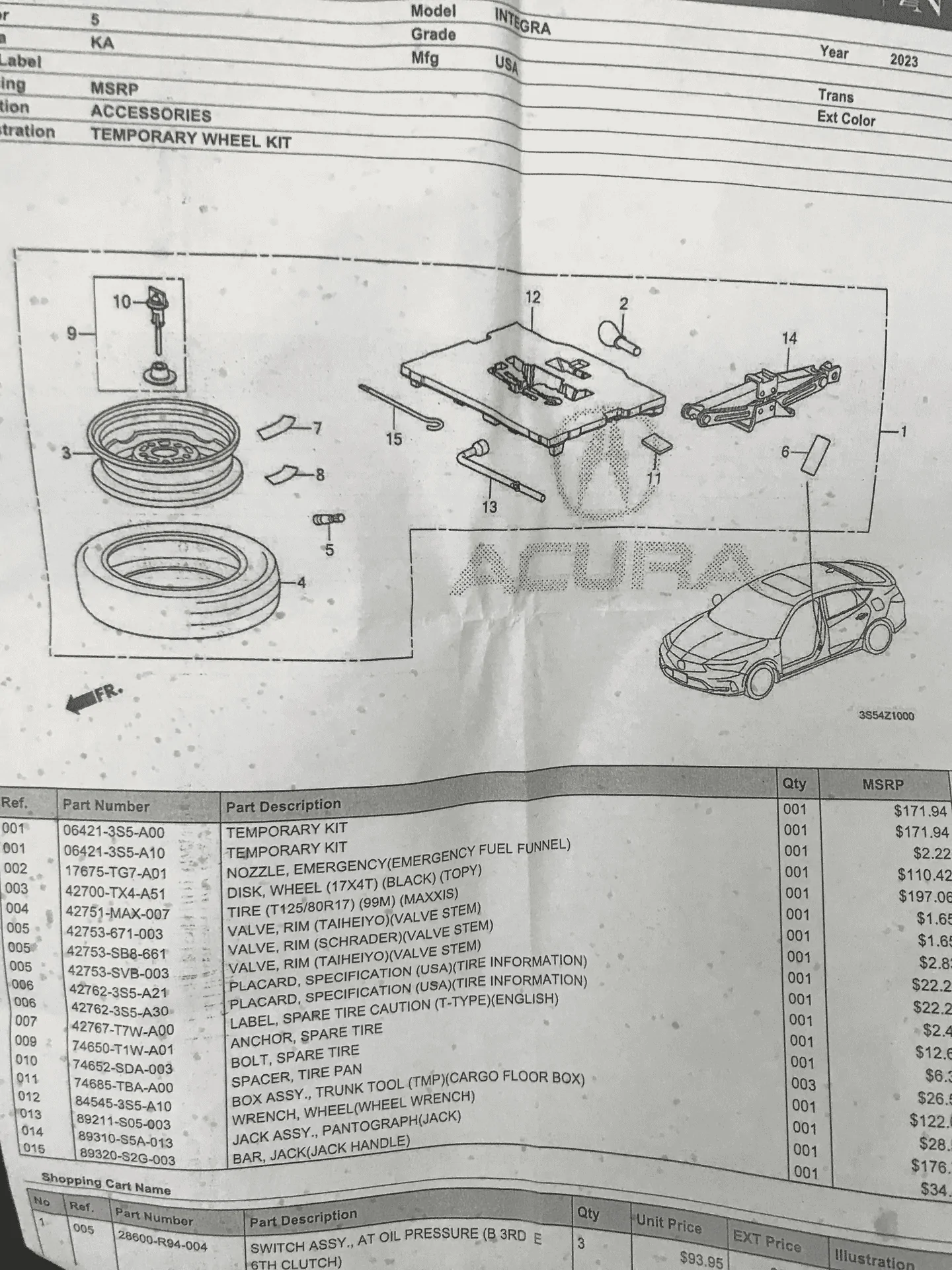

84545-3S5-A10. Perfectly flush cargo floor, because it dove tails into the spare tire, which in my case is although not the exact part number but is still exactly the same 17x4T size from the Accord.

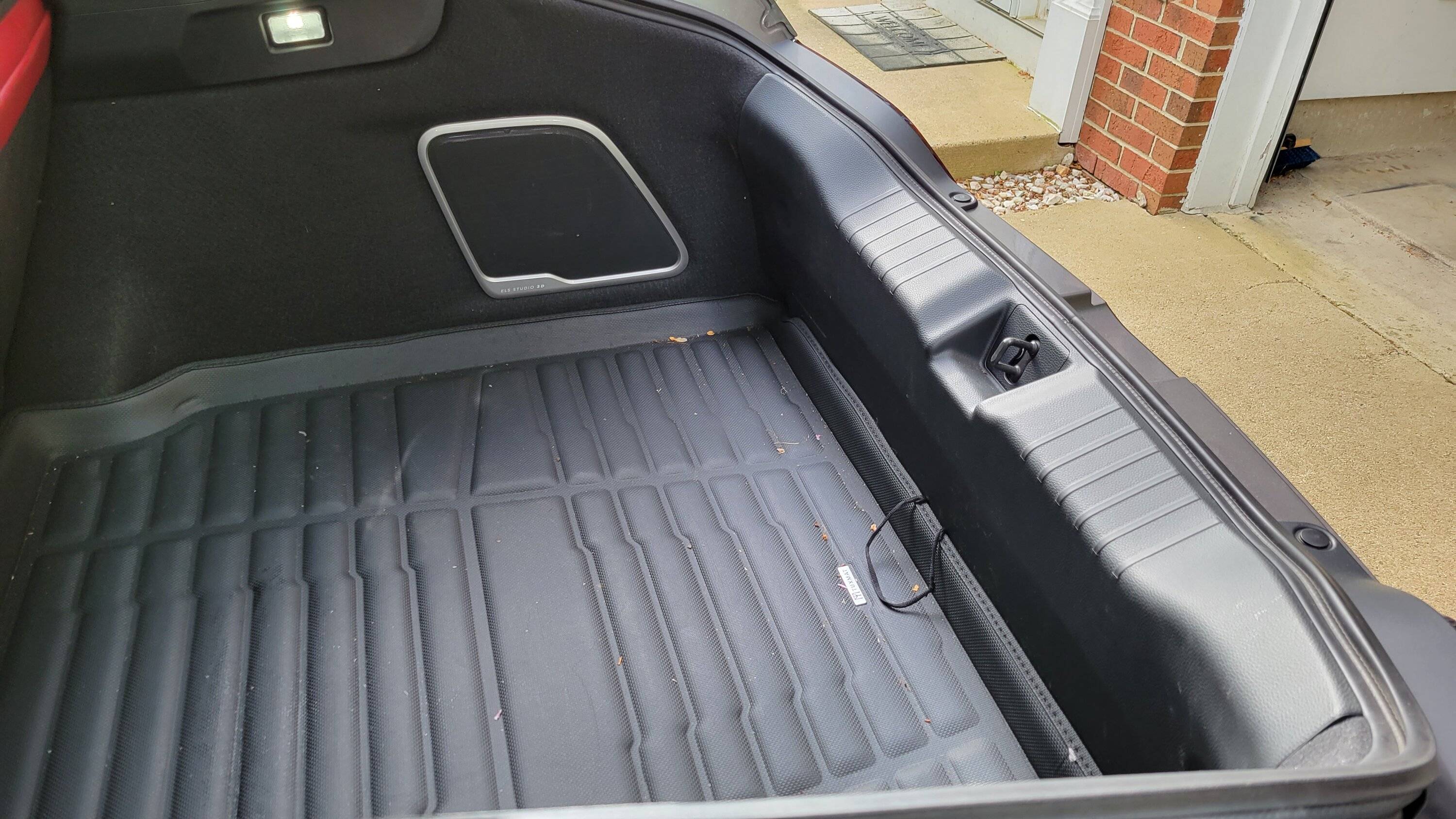

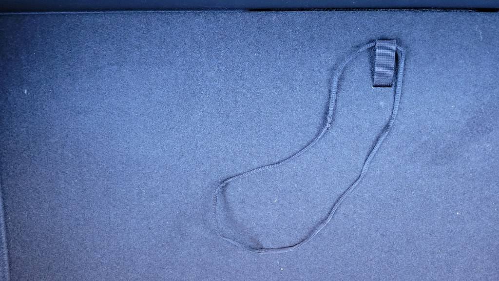

The day wasn't a total loss, though. One of the things that bugged me about this car was that there was no way to prop up the hatch floor to get to the tray underneath it, or where I had hoped my spare tire would live. In a burst of inspiration, I grabbed an old shoe lace and Robert was almost immediately a sibling of one of my parents.
The string is hidden by my TuxMat. Visible only for the picture.

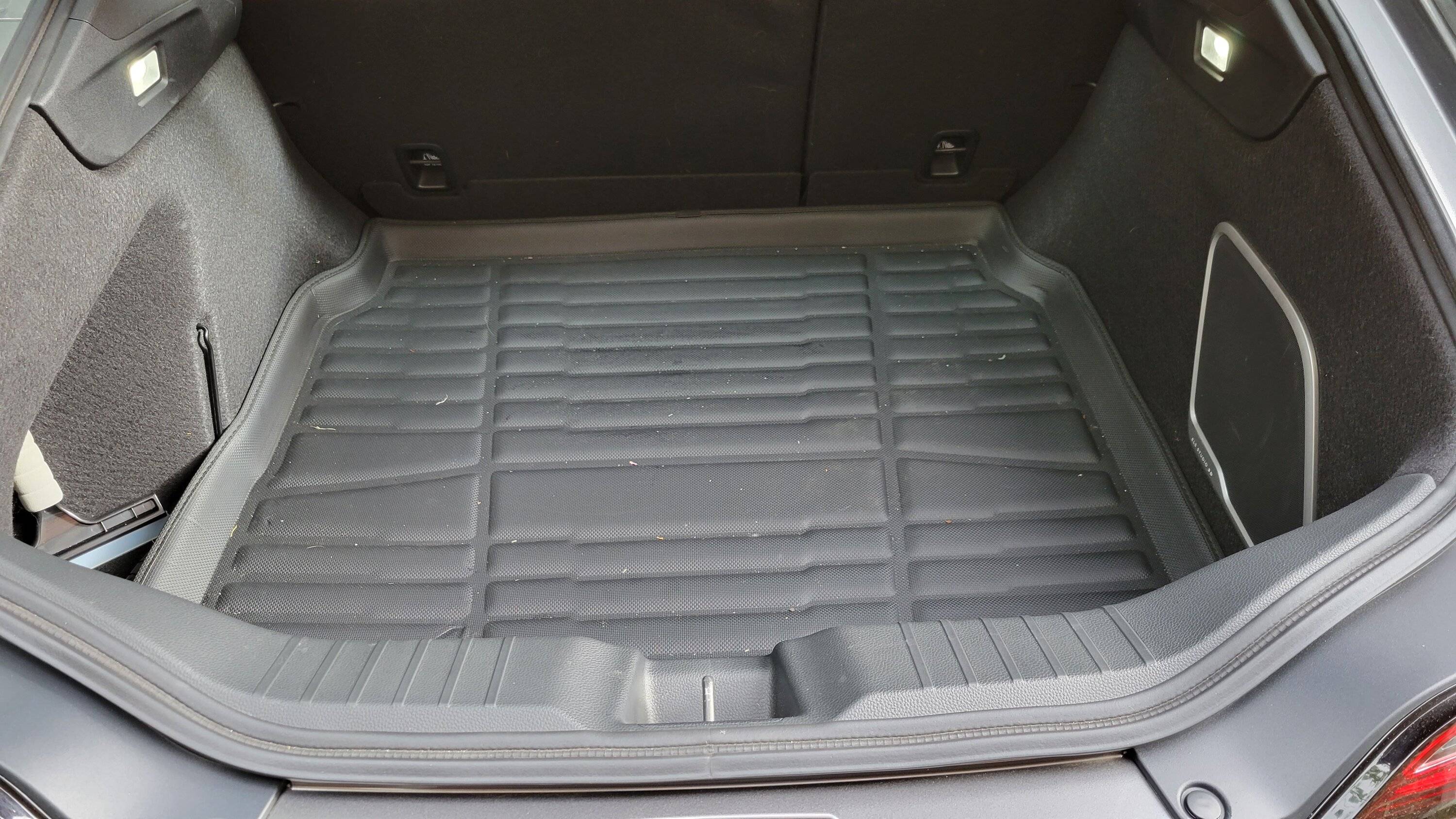

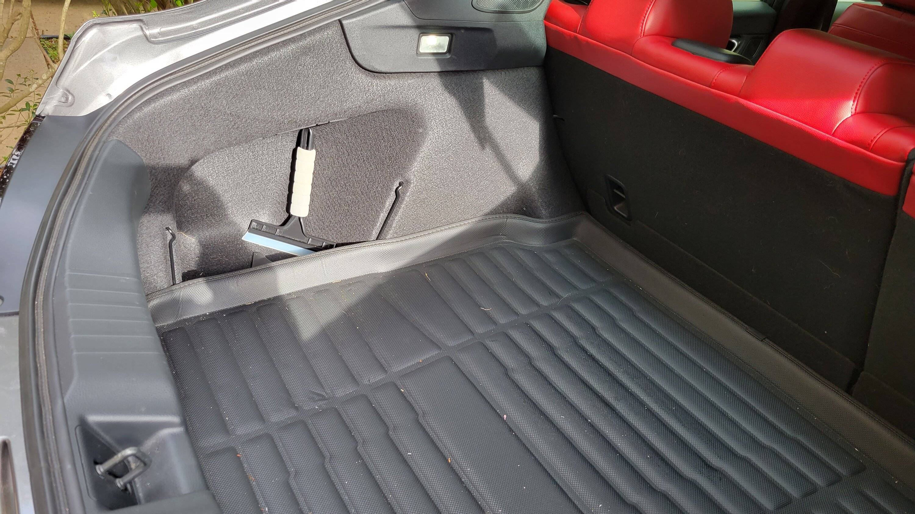

Do you have a pic of the tuxmat cargo liner? I installed the mats today but cargo liner was ot available, just will alert by email when it is.
BKK Jack
Jack
Jul 9, 2022
356
279
NoVA
2023 LCM/Red ASpec Tech 6MT
I do not have a pic of the cargo mat, but I can get one later today. Standby...
