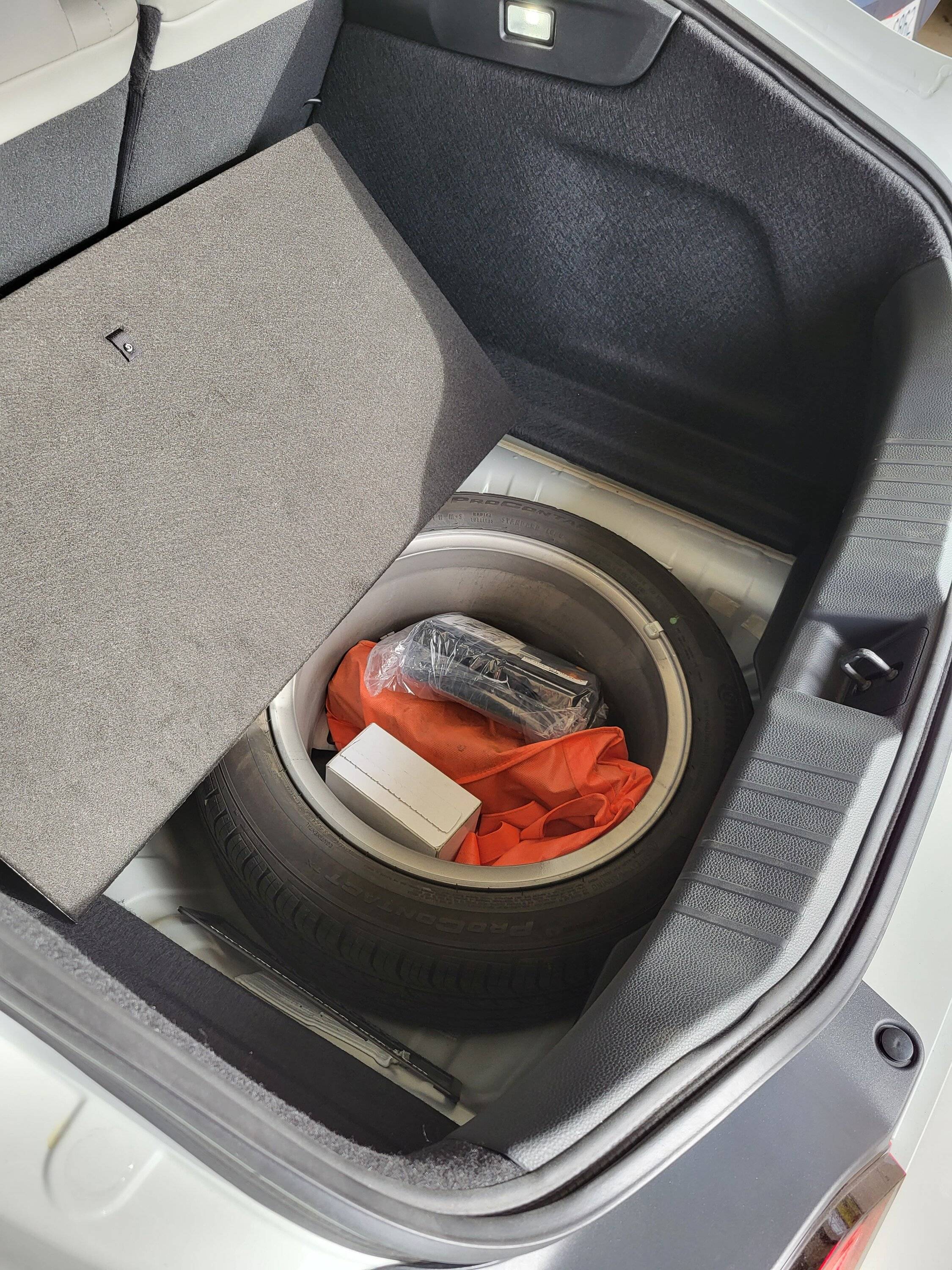

I ended up using one of the fullsize 17" oem wheels as a spare. Found that it fit perfectly under the trunk floor, and needed an M6 bolt to secure it down.

thanks for the pic!
does the full size spare fully support the cover?
I put a doughnut spare in the well and the cover sagged badly....

thanks for the pic!
Yes, the fullsize sits snugly and the cover rests on it at exactly the right height.

thanks for the pic!
What size is the tire?
