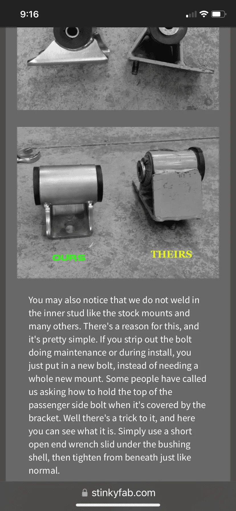

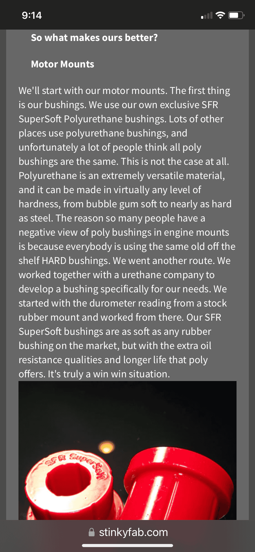

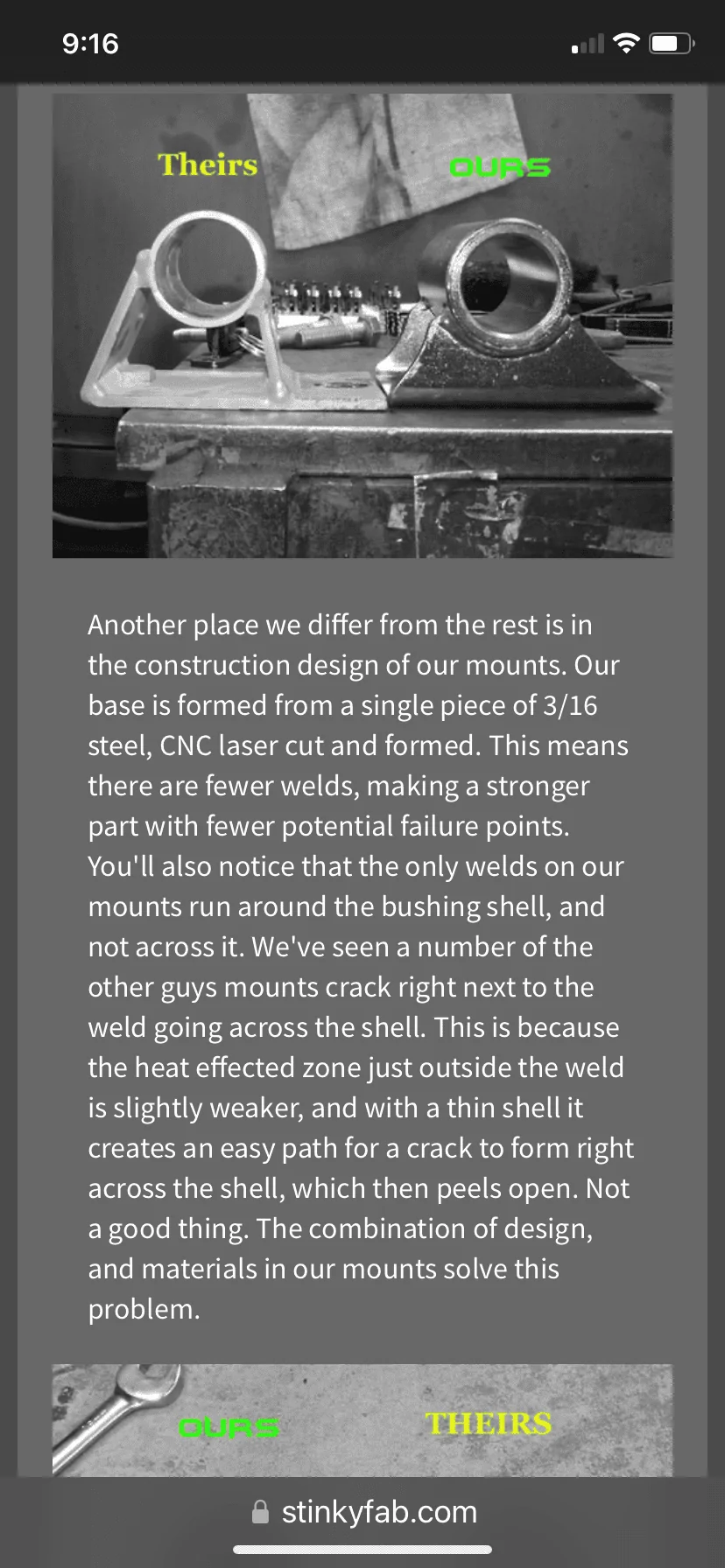

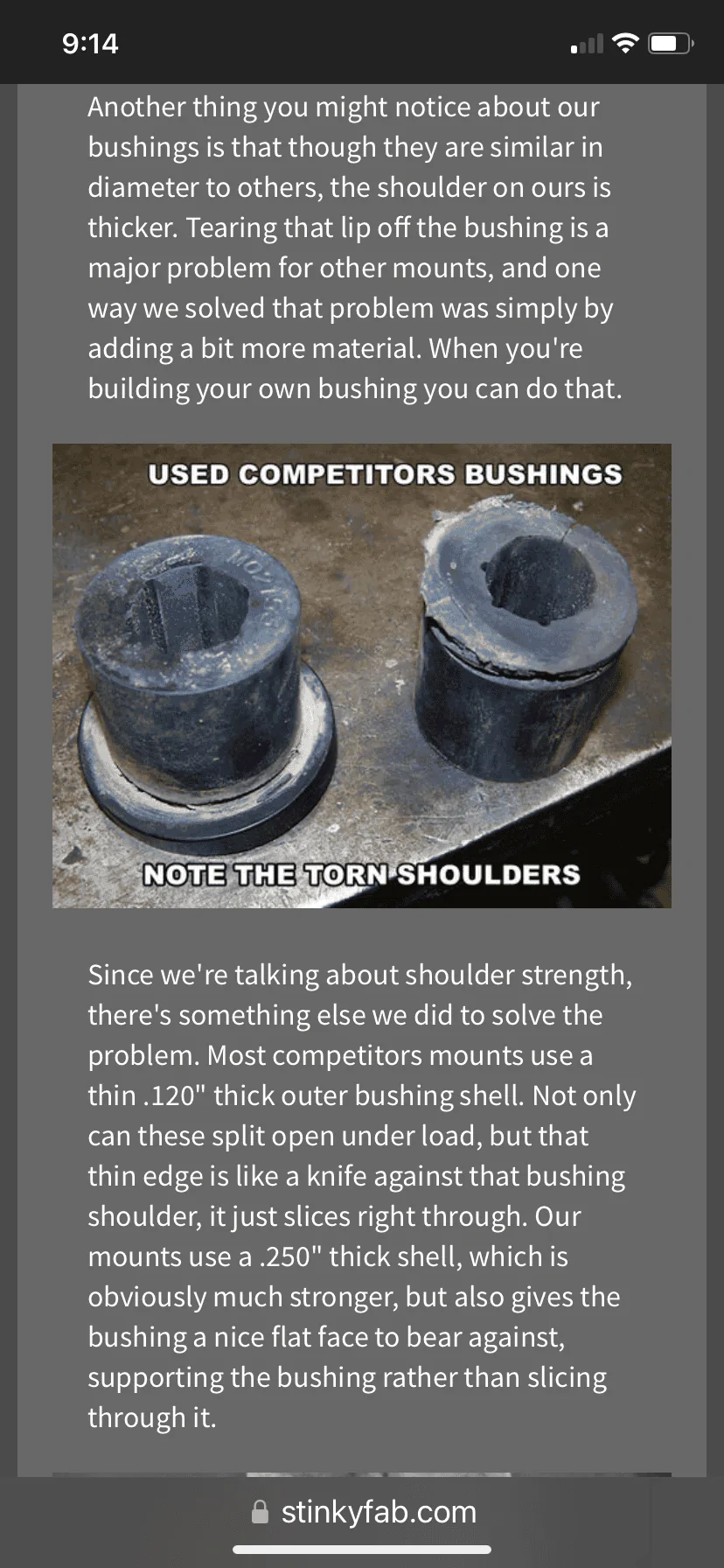

Sounds similar! Without getting too far off track, I'll attach some screenshot to quell any curiosities or perhaps summon any comparisons/opinions from the more experience group on here, like yourself. Apparently, they call theirs a super soft polyurethane.
