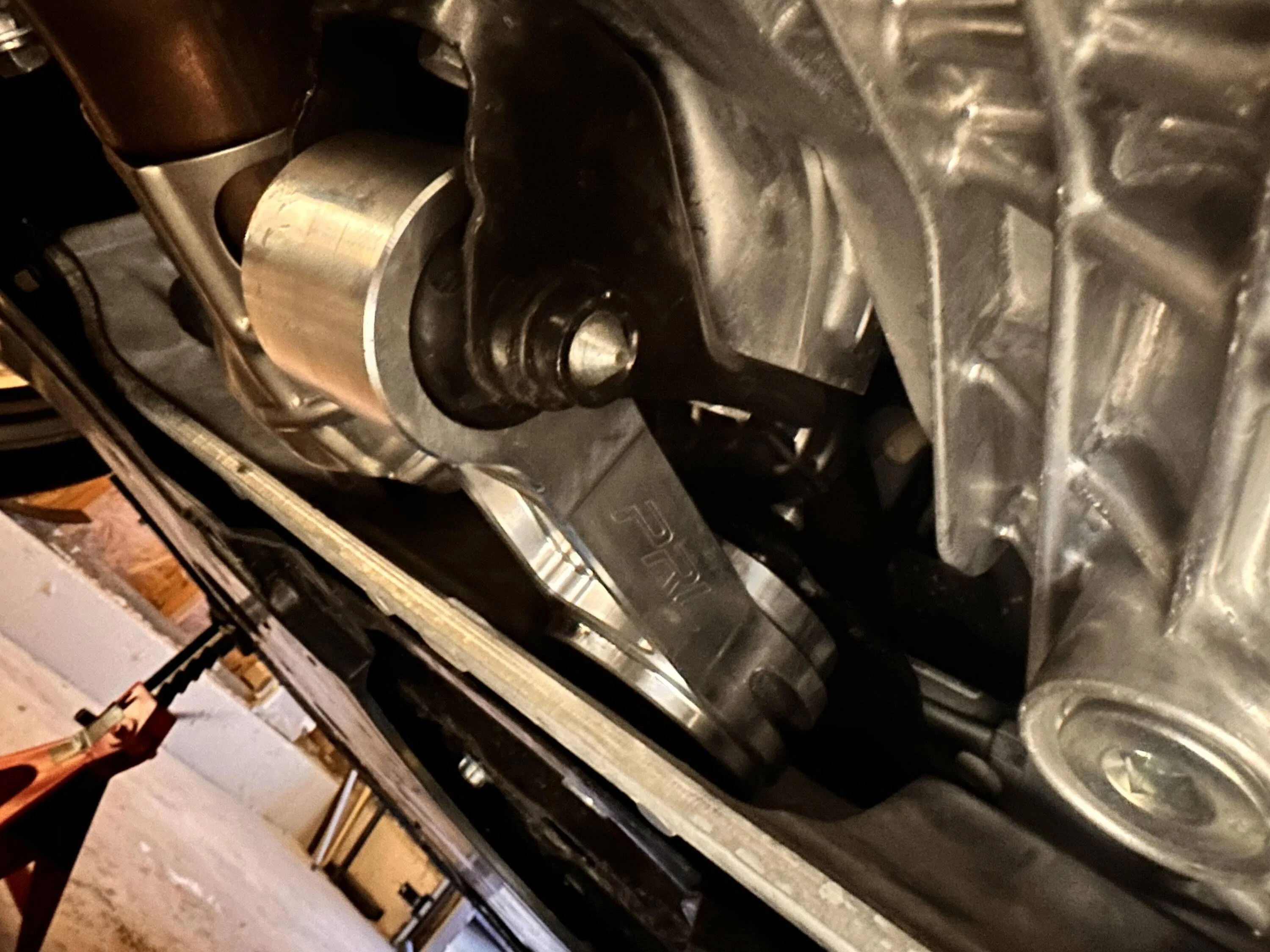

Installed PRL RMM about two weeks ago and did some field testing.

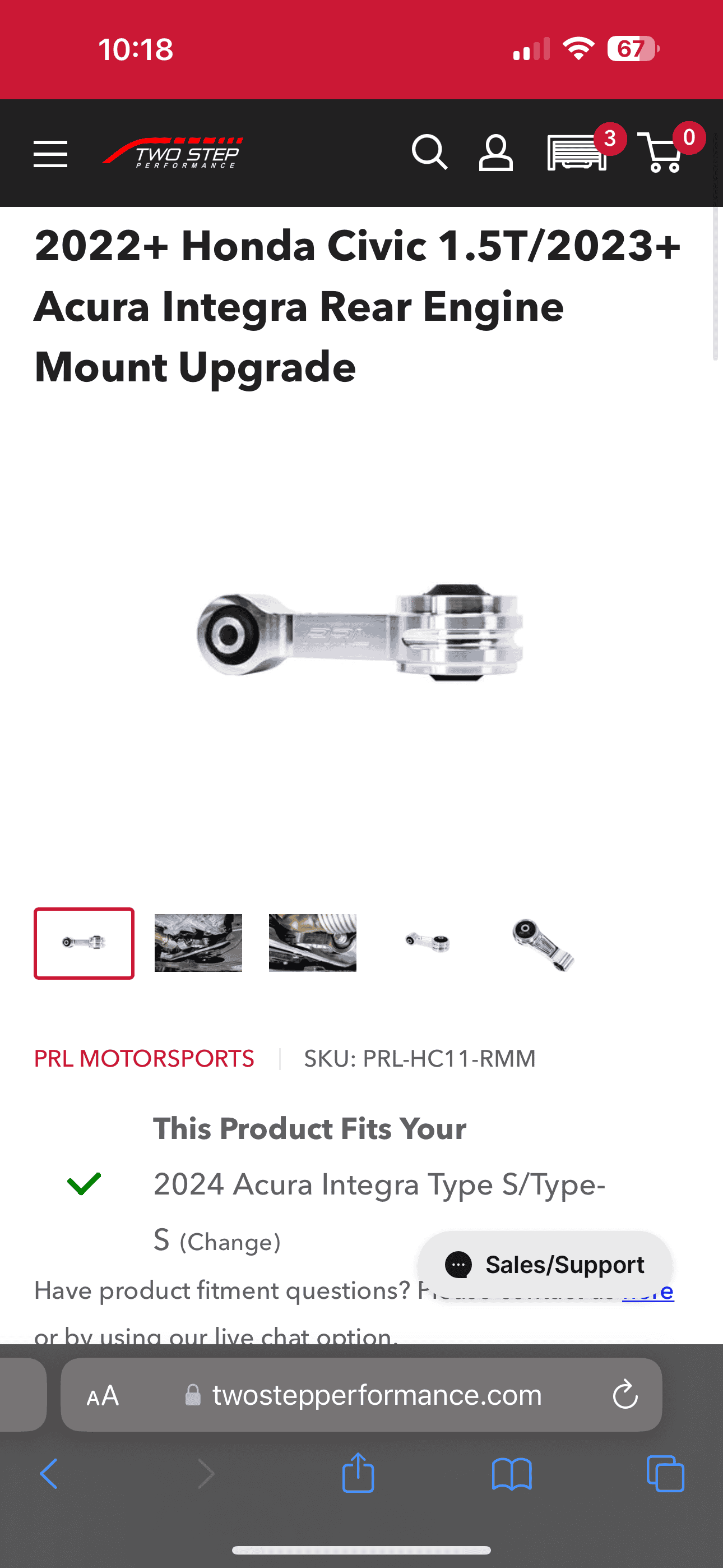

bought it from Two Step Performance
“2022+ Honda Civic 1.5T/2023+ Acura Integra Rear Engine Mount Upgrade”
customer support confirmed that these do fit the Integra Type S DE5
SKU: PRL-HC11-RMM
