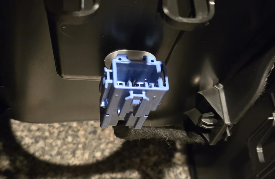

Ok, I'm trying to track down details on the connector that attaches to the wire harness for the rear USB ports. I scavenged one from a used dash harness I bought off of e-bay and just haven't had any luck searching suppliers online yet. Sent some pics to one supplier, so hopefully they can figure it out for me.

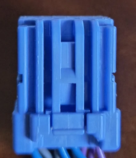

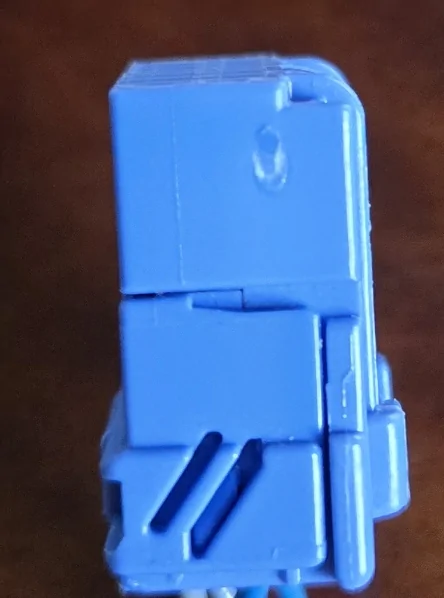

The connector I'm talking about is the one that plugs into the A-Spec center harness and is part of the dash wiring harness. I've attach some pics of the same connector used elsewhere on the dash harness as well as a picture of the A-Spec center console harness connector.
I guess another option would be to not require the A-Spec center console harness, which is what I'm guessing you had in mind. I know the connectors needed to to that, but if you wanted the plastic zip-tie anchor clips that'd be something that would need to be figured out.
Ah, makes sense. It's always the not so obvious one, right? If you don't find anything, another option is to find a matching pair of connectors with the same pitch and pin style as these, and just de-pin the car's connector and swap it to the new one. It's not a simple plug and play solution, but it's a step closer for those of us who aren't afraid to take things apart to that level.
I didn't spend too much time on mine. In an ideal world it would have been plug and play, but I was still happy that I could use the harness Mikstore provided and plug it into the accessory connector at the corner of the fusebox and call it a day.

I've done some digging of my own, and it seems like this particular connector is made by Sumitomo. Unfortunately, Sumitomo connectors don't seem to be readily available on consumer-facing sites like DigiKey or Mouser. Even the color in the Integra seems to be a special SKU that isn't public. The plug and receptacle seems to match the PN 6098-4640 and 6098-4675 respectively:
https://prd.sws.co.jp/components/en/detail.php?number_s=60984640
https://prd.sws.co.jp/components/en/detail.php?number_s=60984675
https://www.ebay.com/itm/145116976616
The particular blue color shows up on eBay and various grey market sites as 6098-4641:
https://www.ebay.com/itm/404751508671
https://chcwld.en.made-in-china.com...male-Buchse-Connector-6098-4641-in-Stock.html
Of course, take this with a grain of salt, since I didn't want to take apart my console again to take specific measurements, so I'm just eyeballing this for the best visual match. But none of the connectors from the usual suspects Yazaki, JAE, TE Connectivity, Amphenol, etc were even close, so my gut feeling is that this is the connector we're looking for.
