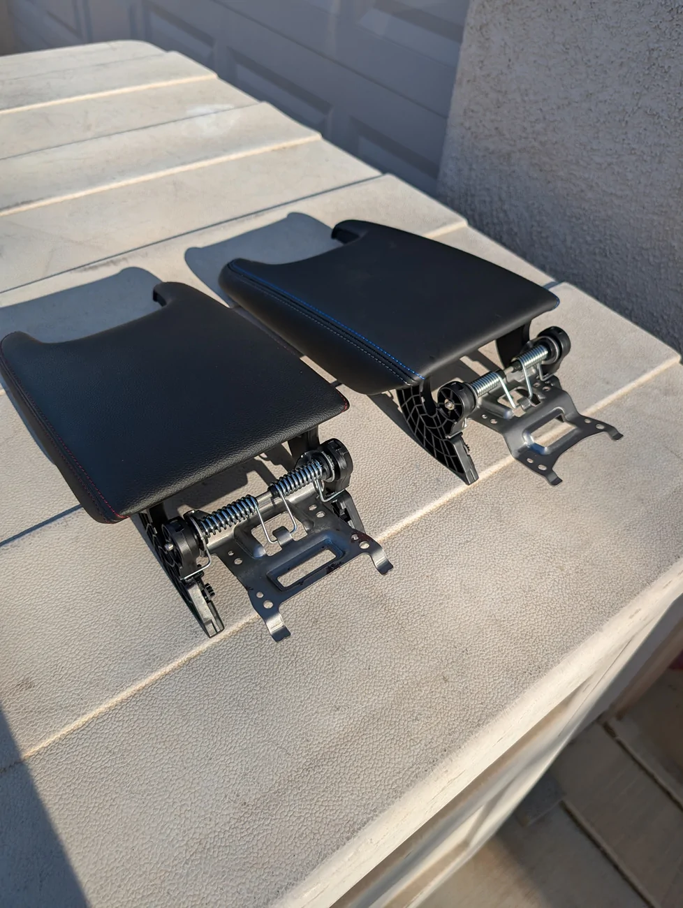

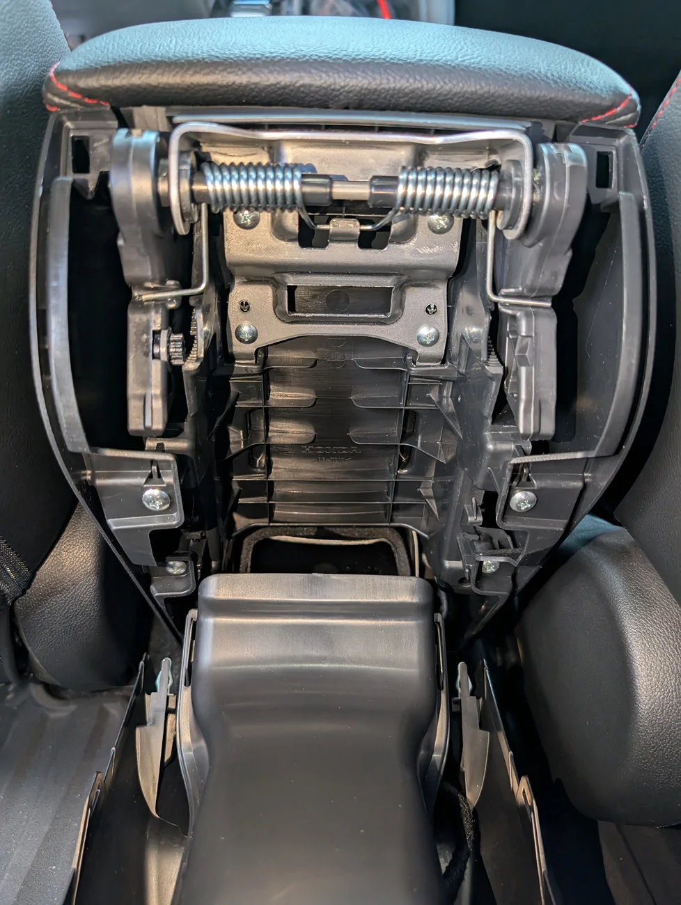

Small development for the few people that probably care enough to do this but there is a way to keep your current armrest with the correct bracket for the Type R box.
Previously I believe the only know solution was the FL1 armrest which as of writing run around $200 without shipping from japan.
The development I stumbled upon is you can take either a Type R or now the Prelude (uses the same center console as the Type R) and swap just the brackets.
Acura Integra Rear AC vents part kit from 2022 Civic 1000001983

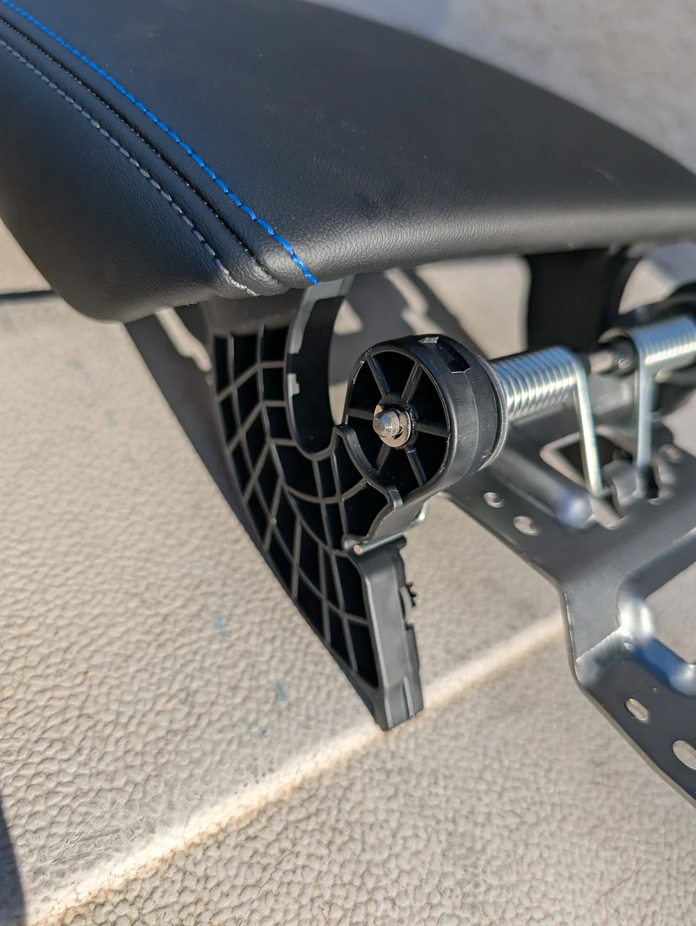

The bracket for both is held on with a small E clip. Once the clip is removed you can slide the long pin out of the armrest and the bracket. Re-assemble is just swapping the bracket over and putting the pin and clip back on.
Acura Integra Rear AC vents part kit from 2022 Civic 1000001984
Just re-use the original 4 screws from you old box and you're good to go.
Acura Integra Rear AC vents part kit from 2022 Civic 1000001985
As of right now the Prelude is the cheapest option at around $160 new before shipping. It's not a whole lot cheaper but is around $60-70 cheaper than the Type R armrest and can be sourced for any dealer or Honda parts vender domestically.
Your other option which would probably be the most economical if you get lucky enough is to find either car at a salvage yard. You could also ask around on their respective forums if someone has a torn one that they'd let go for cheap.
Also if someone really wants blue stitching on their armrest (not sure why anyone would) and doesn't have the rear A/C they could do the opposite and put the Integra bracket on the Prelude armrest.
If you don't feel comfortable removing the clip and swapping the bracket over, you can just remove a few screws holding the padded armrest onto the base and swap that over instead.
this is what I did, just removed the 4 screws and swapped the upholstered lid.
Maybe I missed it being mentioned but the prelude console lid is a soft close lid, my Integra type S one was not. Small thing to consider for those that go the prelude route.
