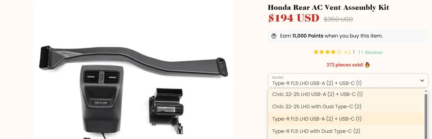

Seems like only hope for us CVT folks to get rear console a/c vents is to find some custom duct solution that would fit with our wider shifter assembly... been looking and still don't have any ideas.
Could it be that Mikstore offers another variant of this duct? I've seen various options available in their store and while I understand that the one advertised in the video was for the manual transmission there are other ducts that were more oriented towards different transmission configurations.
