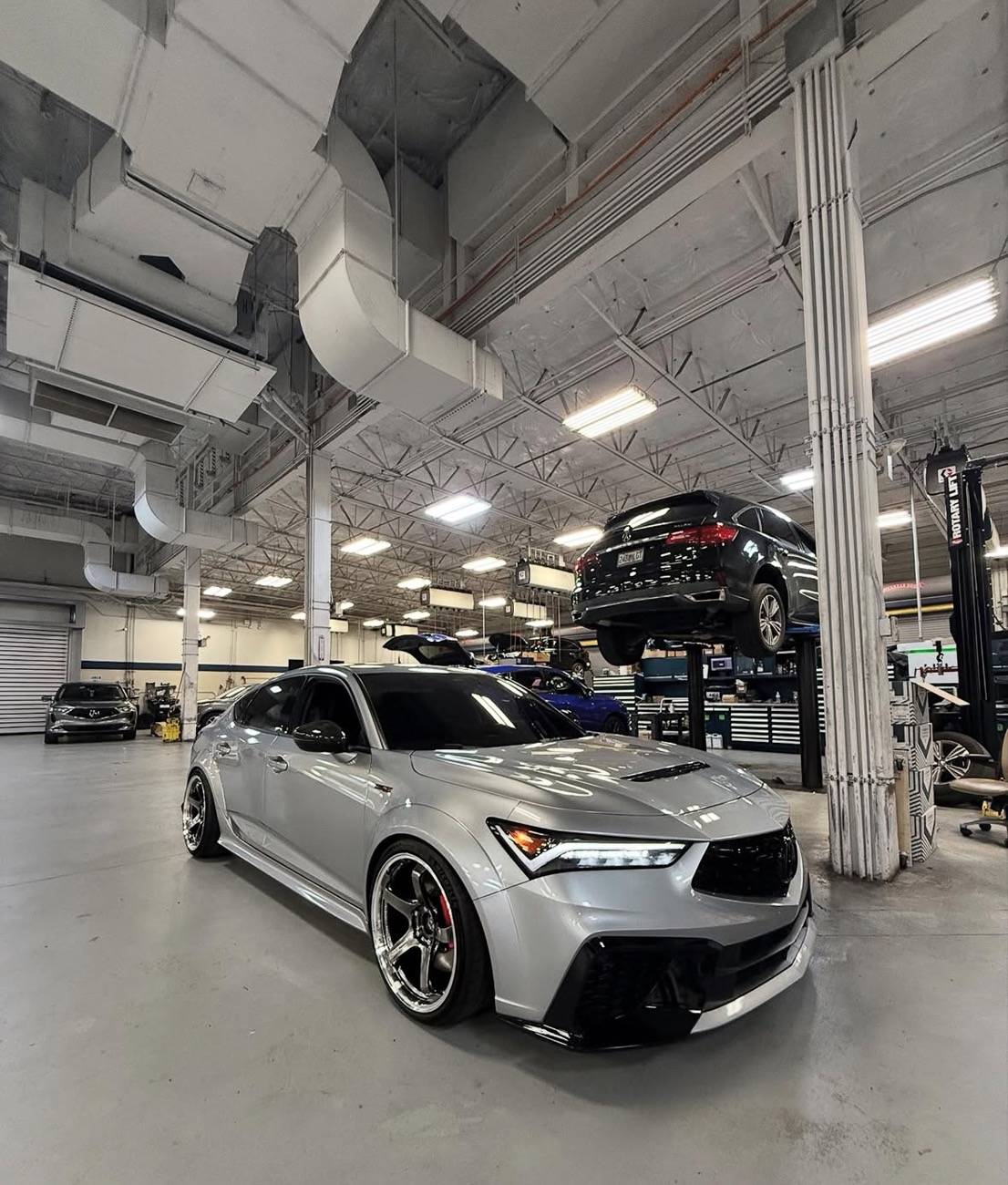

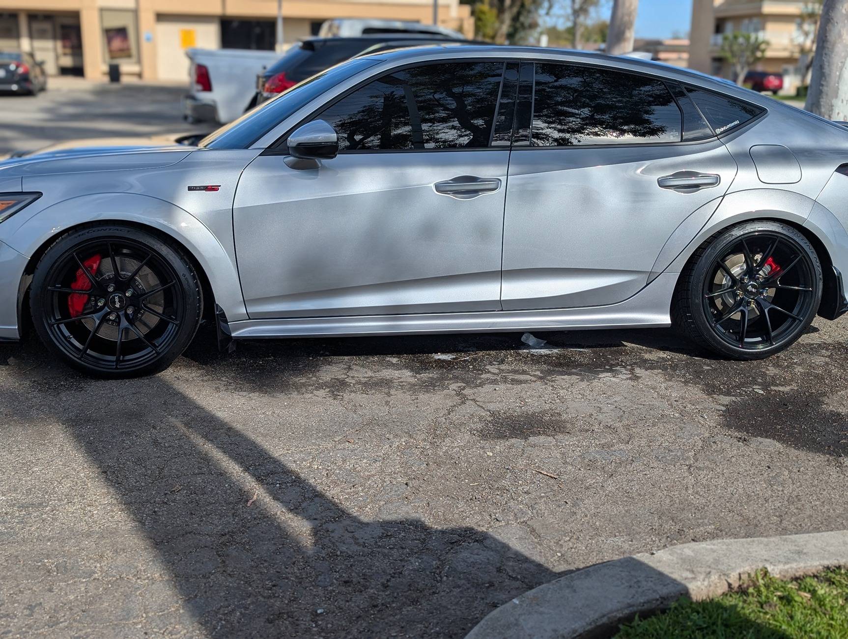

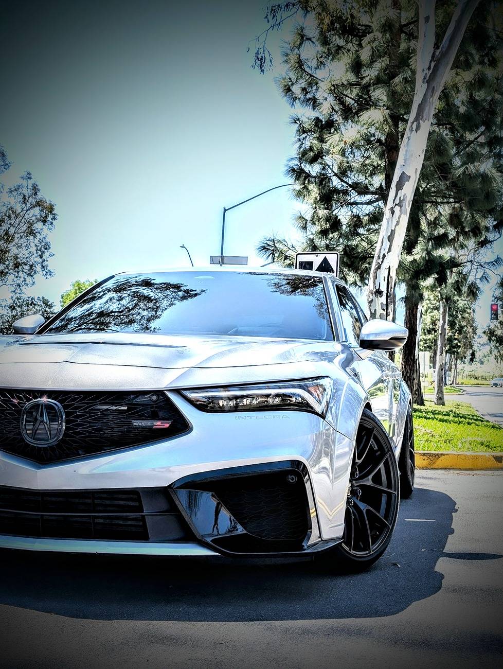

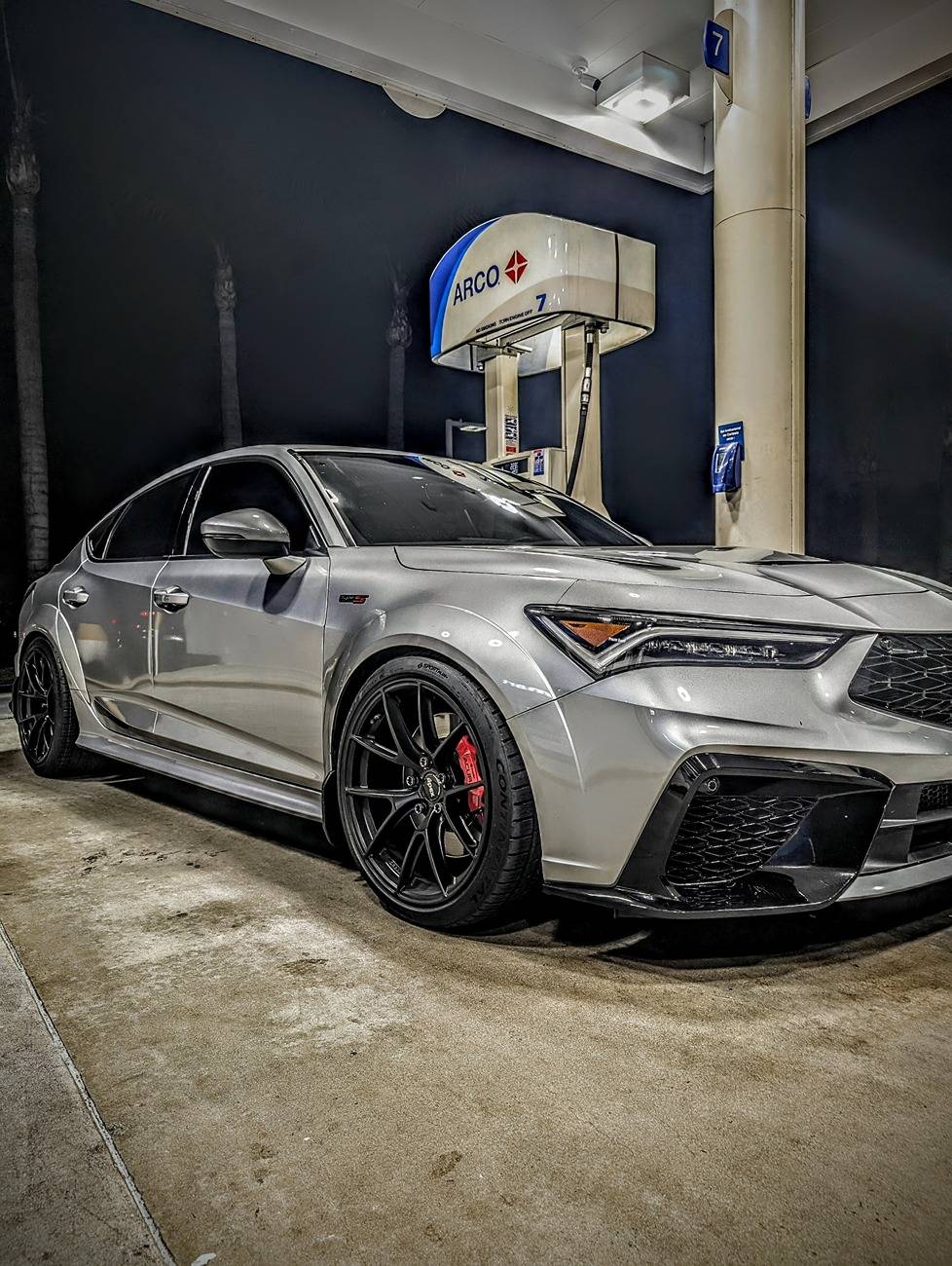

I never updated this post with my wheels to help out .. I ended up getting apex vs5rs 19x10.5 +45 and tires conti 285/30/19 no rubbing lowered on H&R ..out mot of pics so you can see different angles hope this helps someone
Do you think there is more room for a taller tire, i.e. 35 profile? Not wider, as it def looks like ur maxed out.

Do you think there is more room for a taller tire? Not wider, as it def looks like ur maxed out.
Someone else I know took the gamble of a taller tire and it rubbed ...that's why I went wider so it can overlap a smitch and definitely helped ..that little bit higher allows me to not scrape on my driveway

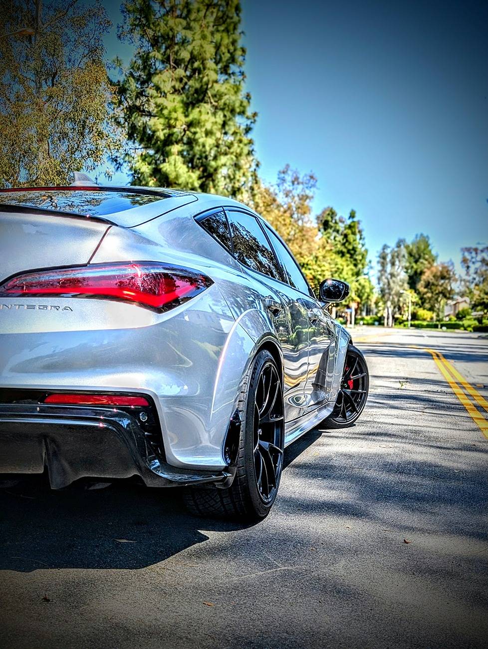

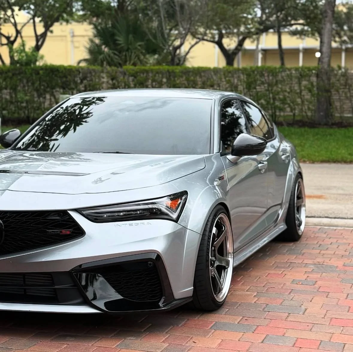

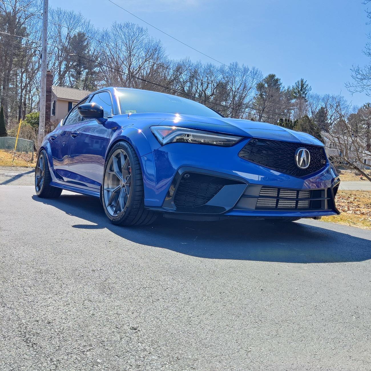

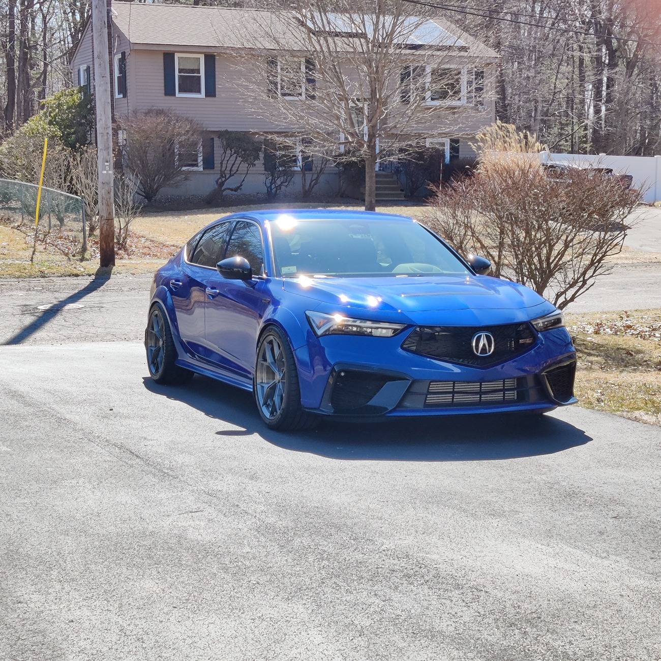

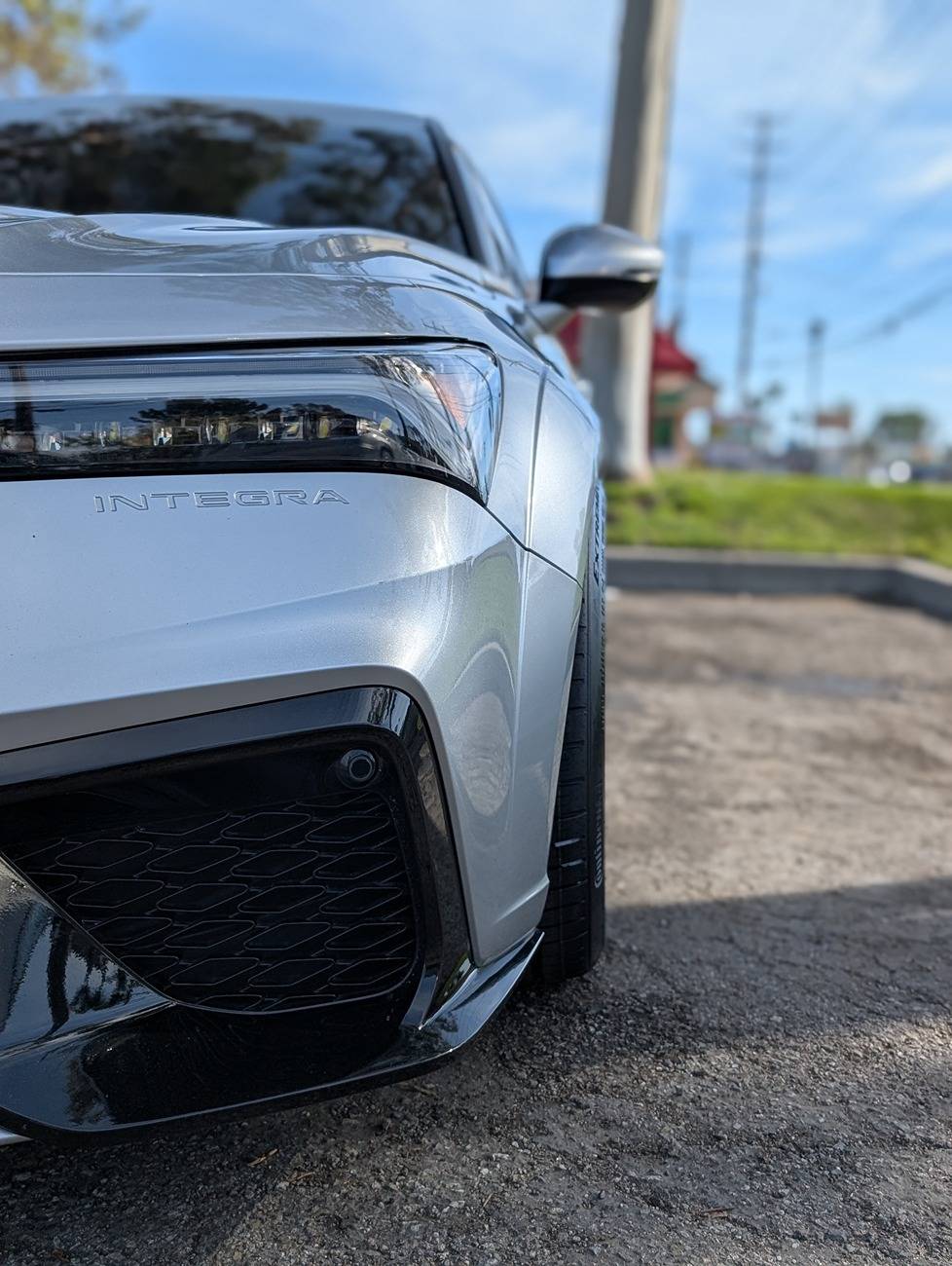

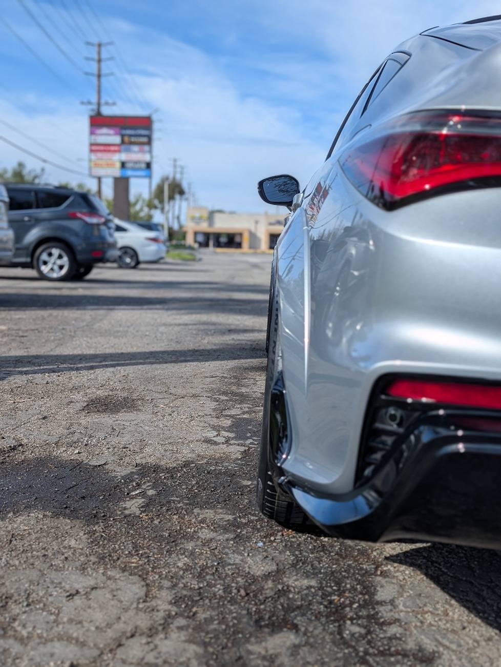

Depending on your offset and camber, you might be able to get away with 275/35. I ran 19x9.5 +35 275/35 and it rubbed a little. Also lowered on h&r. If I could get -3 on camber I felt I would have been ok.
+40 or higher offset and I don't think you'll have any issues with a drop and factory alignment.

I just have to say it, I just can't get with the vibe of the 35 a/r tires on 19s for these cars. Aside from the admittedly weird sense of "heebie jeebies" I get for deviating from the OEM aspect ratio- that's probably just a "me" thing- but to me, it makes the car look way too "elevated" for my tastes. I mean, these pics give a strong "trans am" vibe.
I will just never understand why so many people seem to want this.

Meaty is back in!! lol. I like it. Kinda beefy and muscular looking.
I’m going to go 275/35 on 18’s for the track.
I do like the 19’s for the street though. 275/30 is perfect on 19’s. We just don’t have a lot of tire options.

I admit I'm 50/50 on this tire setup for exactly that reasons you mention. My goal was for a slightly more compliant ride and the looks as just a benefit. Turns out it's a bit too noisy for my liking and I the number feel was a definite drawback. I'm also not quite sure how I feel about the look; a bit too bulldog-ish for my liking and it doesn't really fit the overall look of the car. By itself it looks good as a wheel and tire setup but on the car I'm a little apprehensive.
I'm strongly considering a 275/30 or 285/30 but I'm currently back on the stock tires for the time being.

That looks REALLY good. These exact wheels were my first choice. Maybe they are again lol.
They really do look good in these specs. For the street I would run these and switch to a dedicated track set.

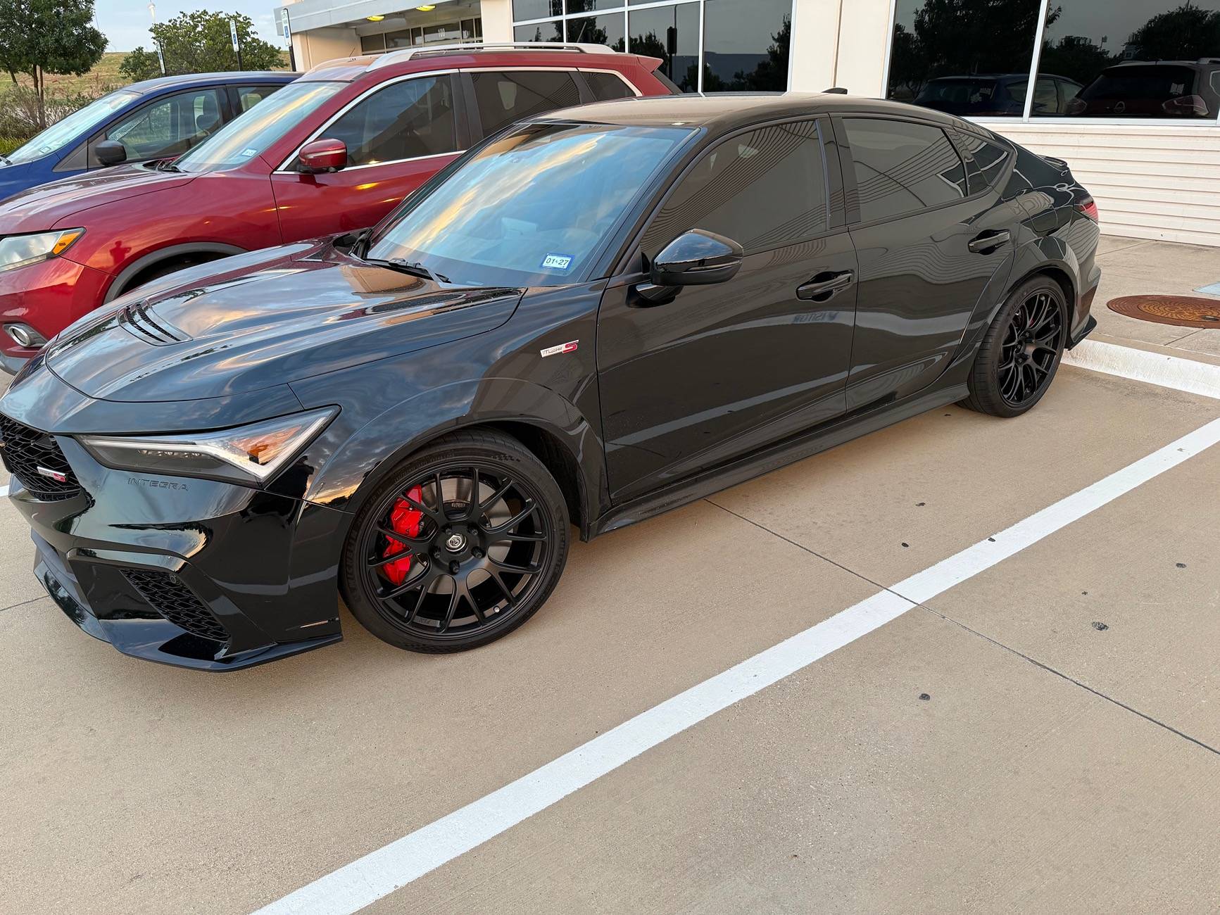

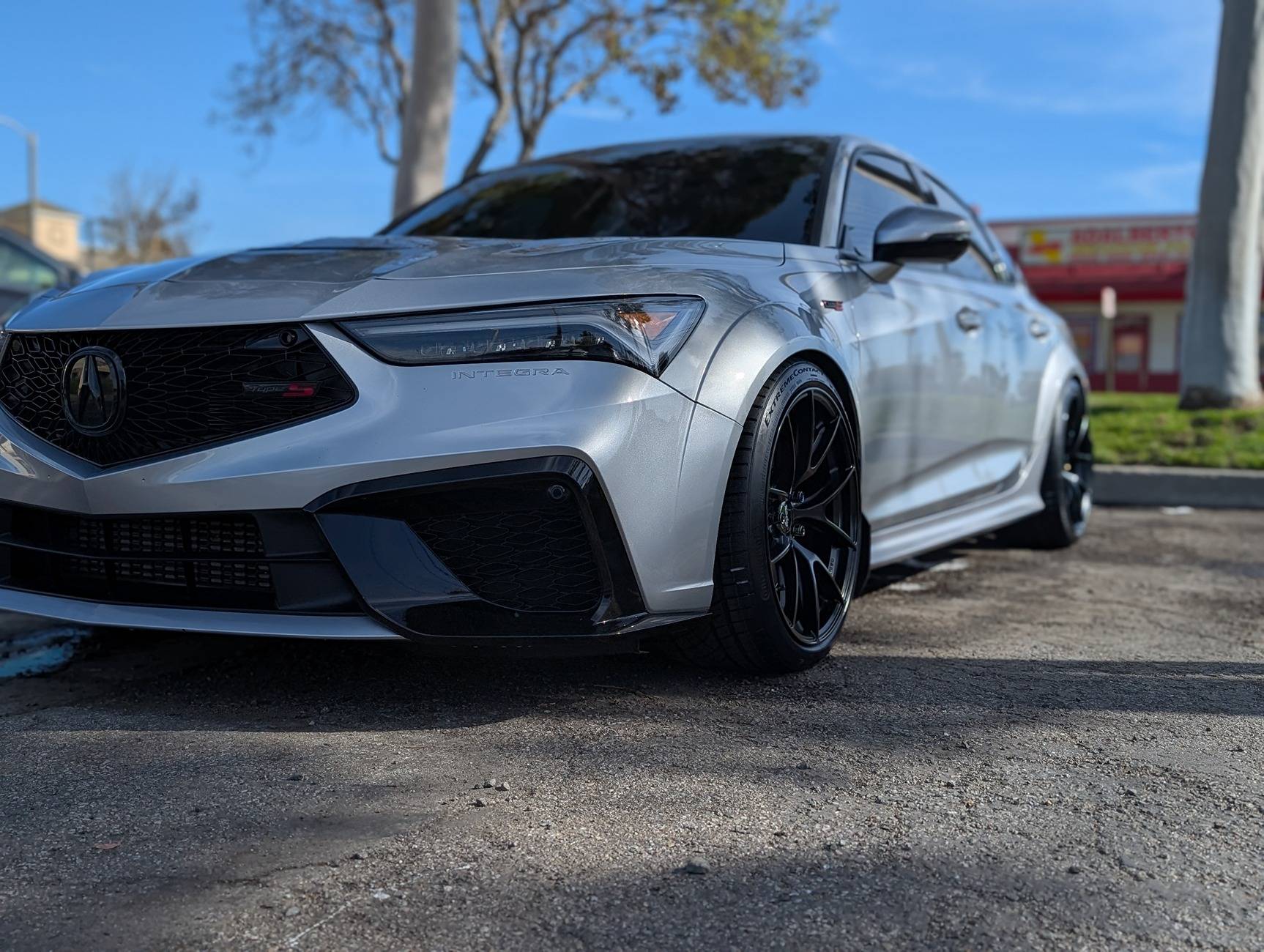

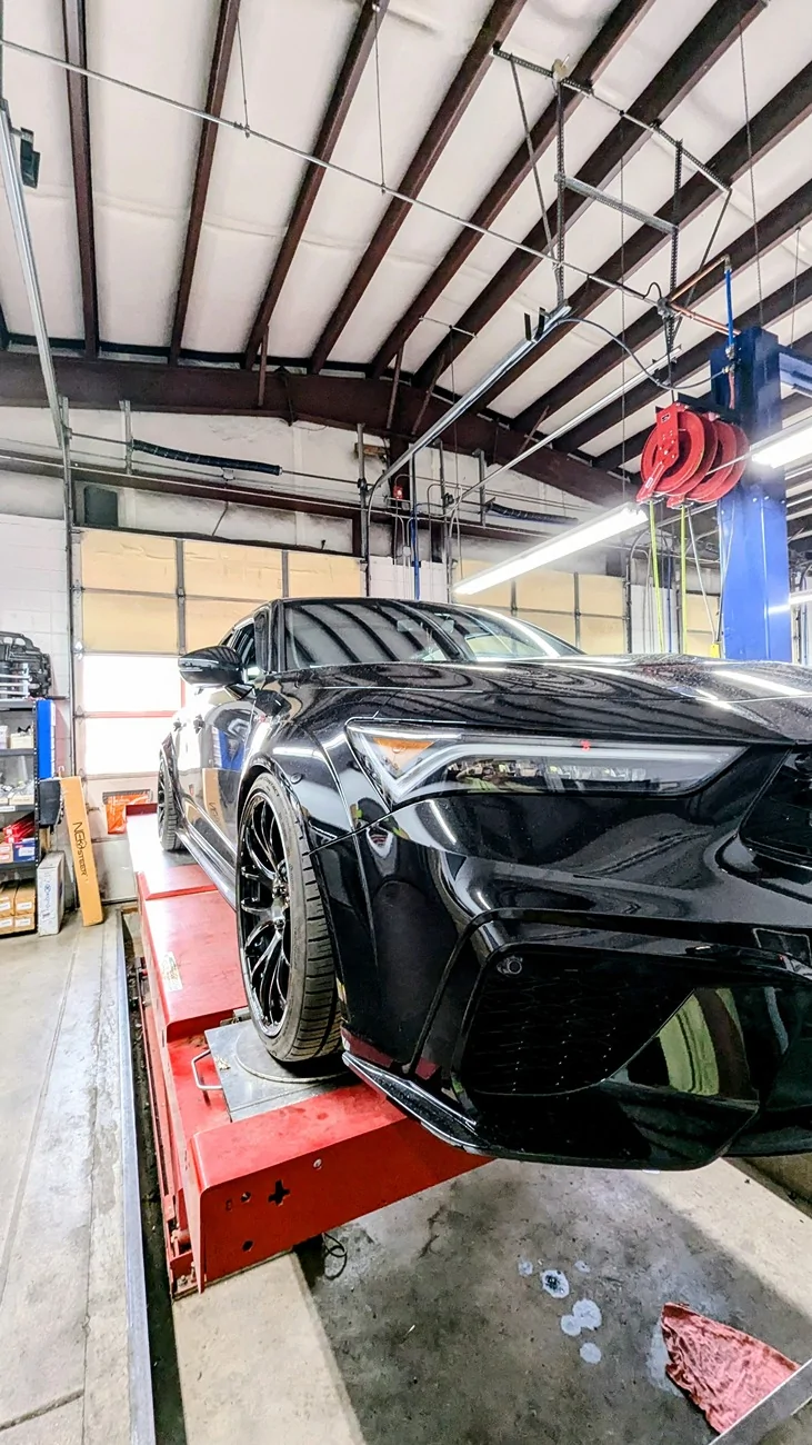

Picked up some Konig F1M forged wheels, they come in at 19lbs a piece and got a great deal through discount tire. Missing center caps bc Konig only sent 3 but overall really impressed with the wheels. Specs are 19x9.5 +45 stock height
Acura Integra Official Wheel Fitment Thread for DE5 Acura Integra Type S IMG_0842
Acura Integra Official Wheel Fitment Thread for DE5 Acura Integra Type S IMG_0843

I just have to say it, I just can't get with the vibe of the 35 a/r tires on 19s for these cars...I mean, these pics give a strong "trans am" vibe.
Totally agree. Too me it's too puffy-looking, and the car is too high off the ground, plus there's the whole tire being 5% bigger than stock and the odo/speed/gearing being off by that much.

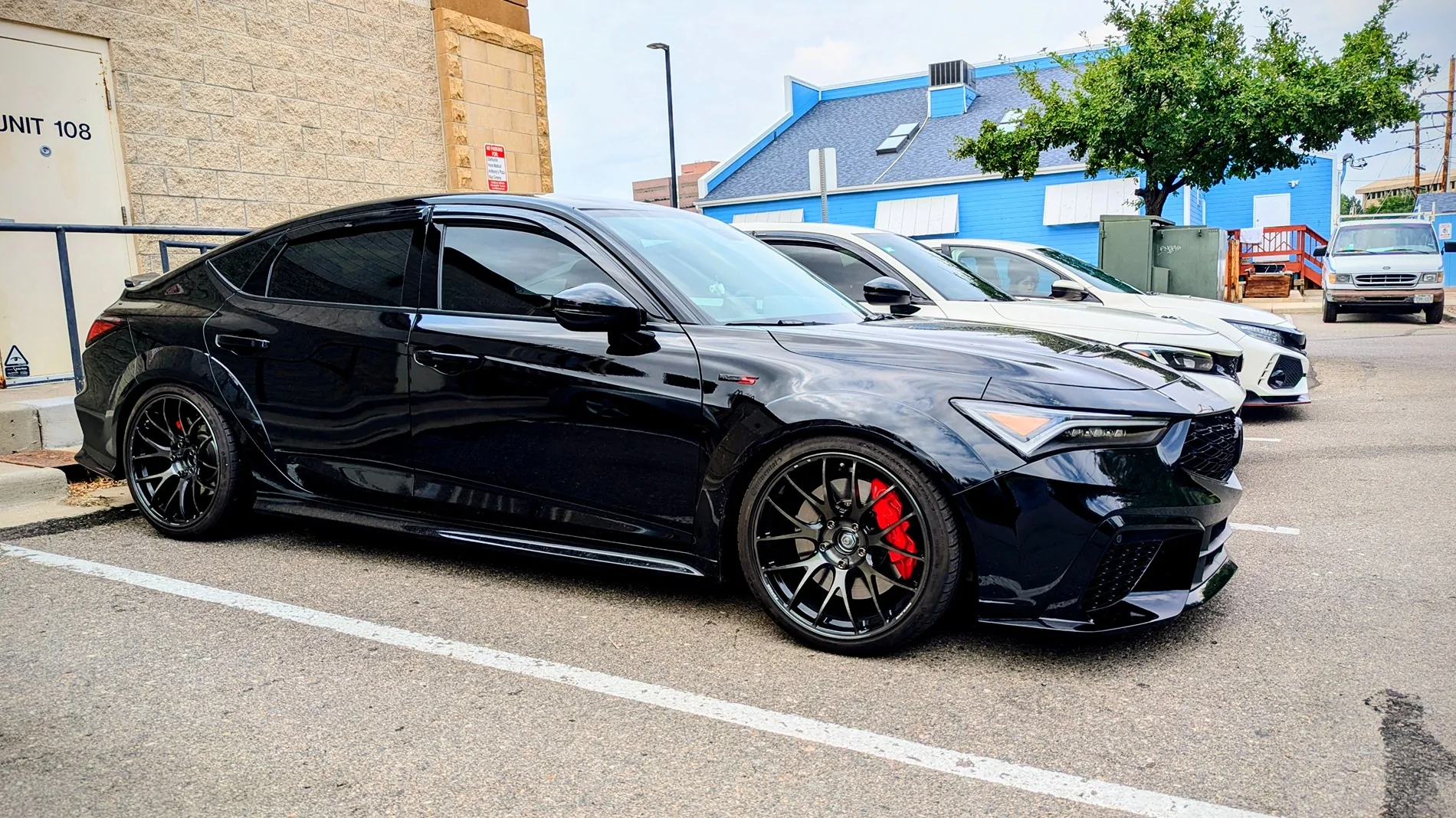

No rub
19x9.5 +36 Volk G27
265/30R19 Conti DWS
Lowered on Swift Spec R, pins removed

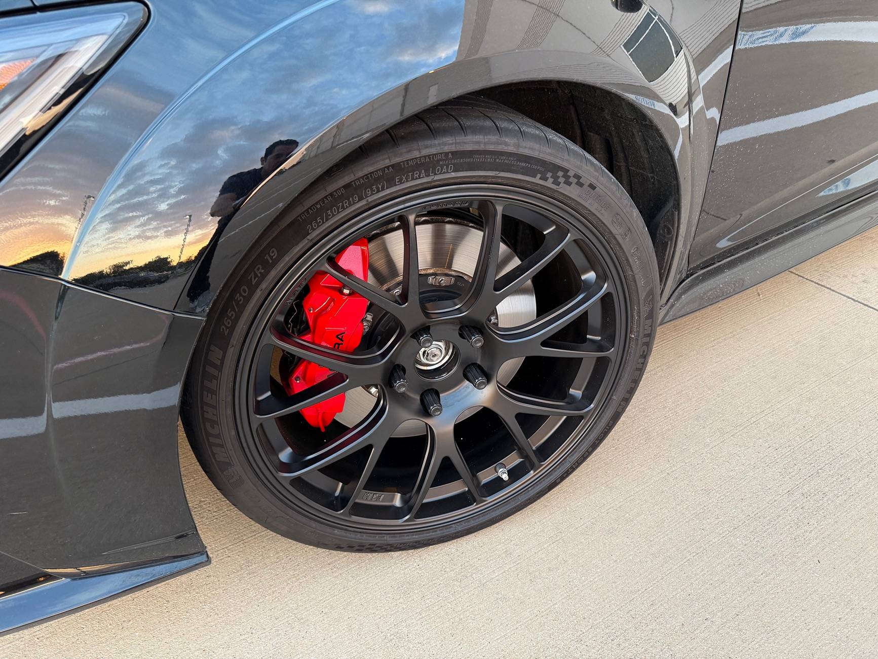

235/40/18 +40
Vredestein Quatrac Pro
Using it as a second set for mild STL winters. Really comfortable quiet tire, but obviously with the size I lost grip, but it'll be good until spring. Rim was $147/ea at Tire Rack.
Do you know which rims those are at tire rack? I need something for winter here in Indiana.
