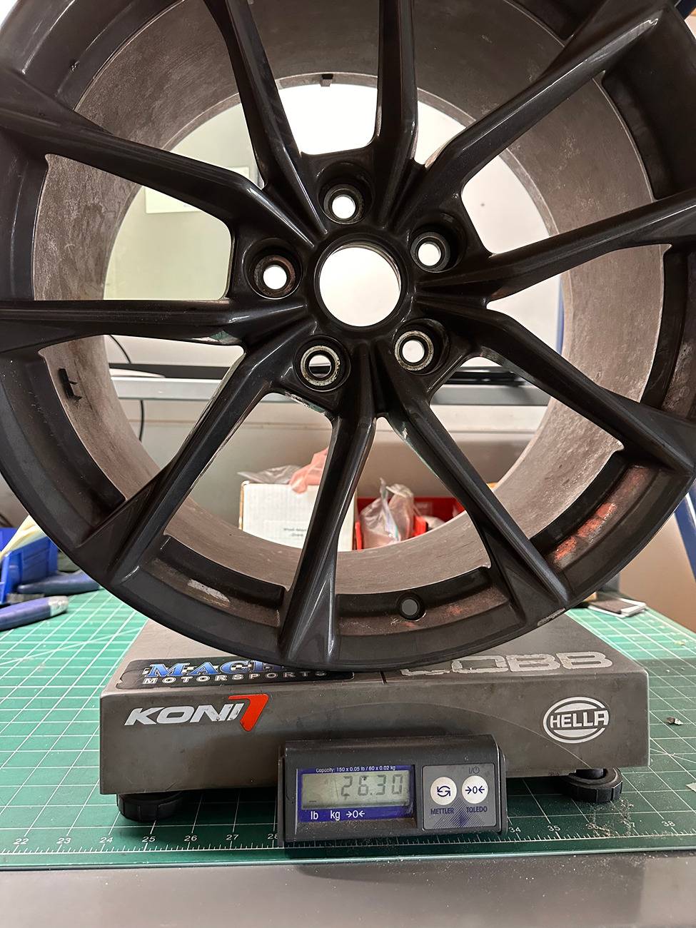

BTW, what does an individual stock ITS wheel weigh?
Also, what's the centerbore diameter of a stock ITS wheel?
The stock 19x9.5" wheel is 26.3 pounds according to my shipping scale. Centerbore is 64.1mm. It's the same wheel for 2024 and 2025 model years. There wasn't a 2023 model year Integra Type S.

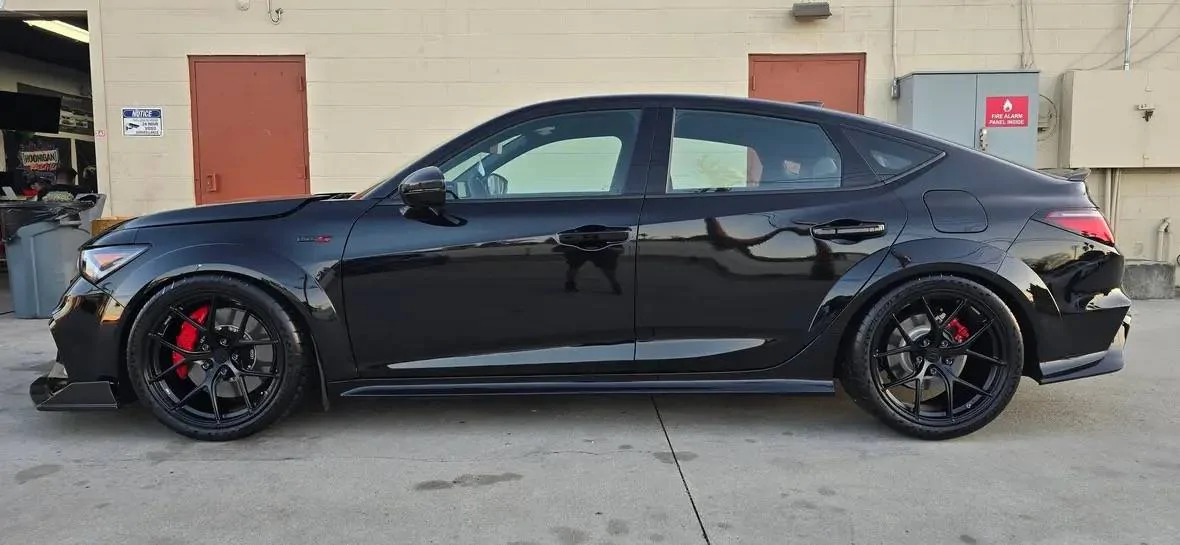

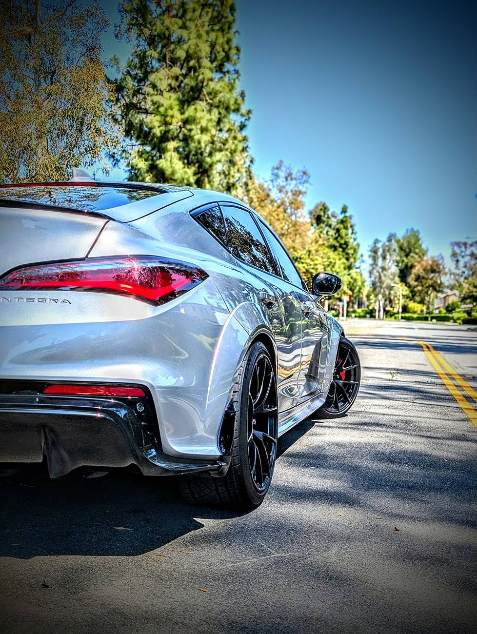

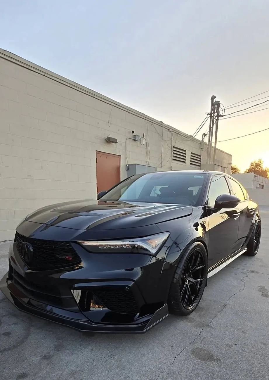

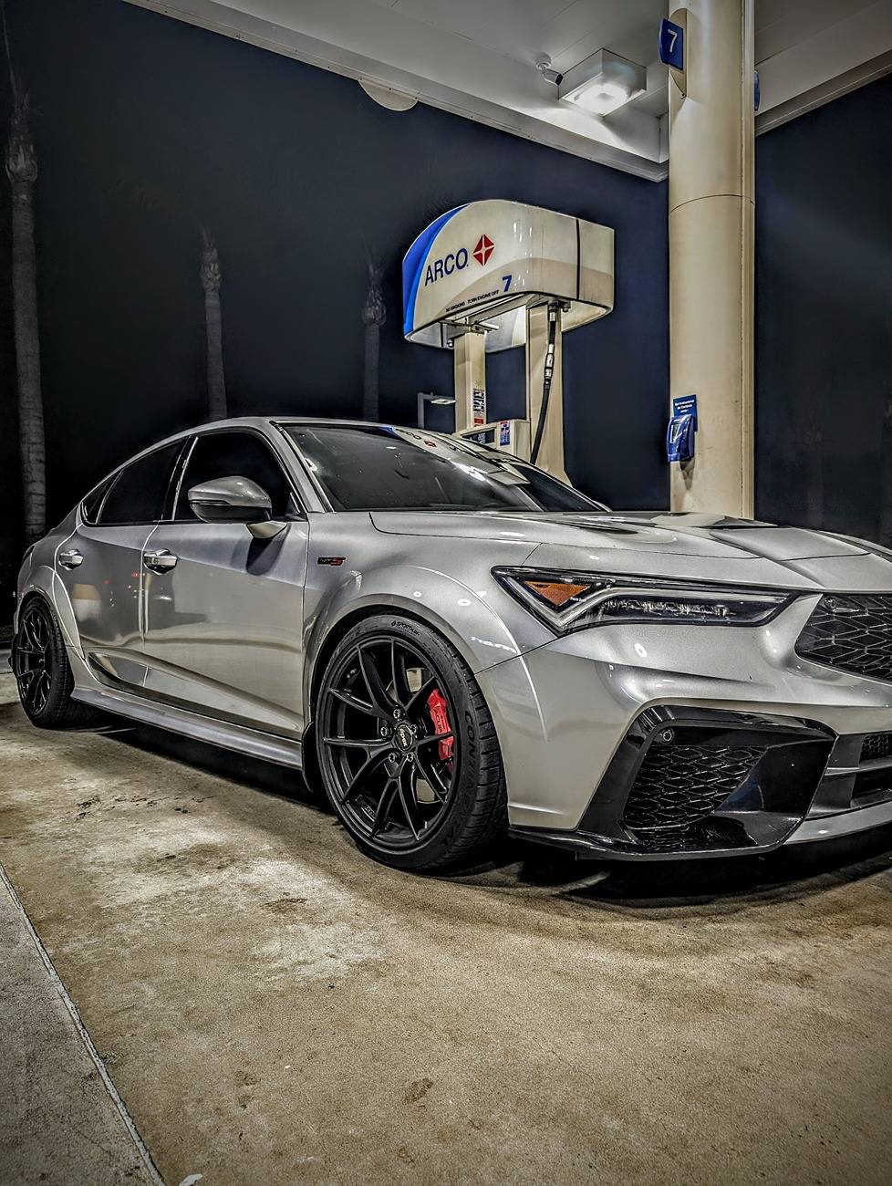

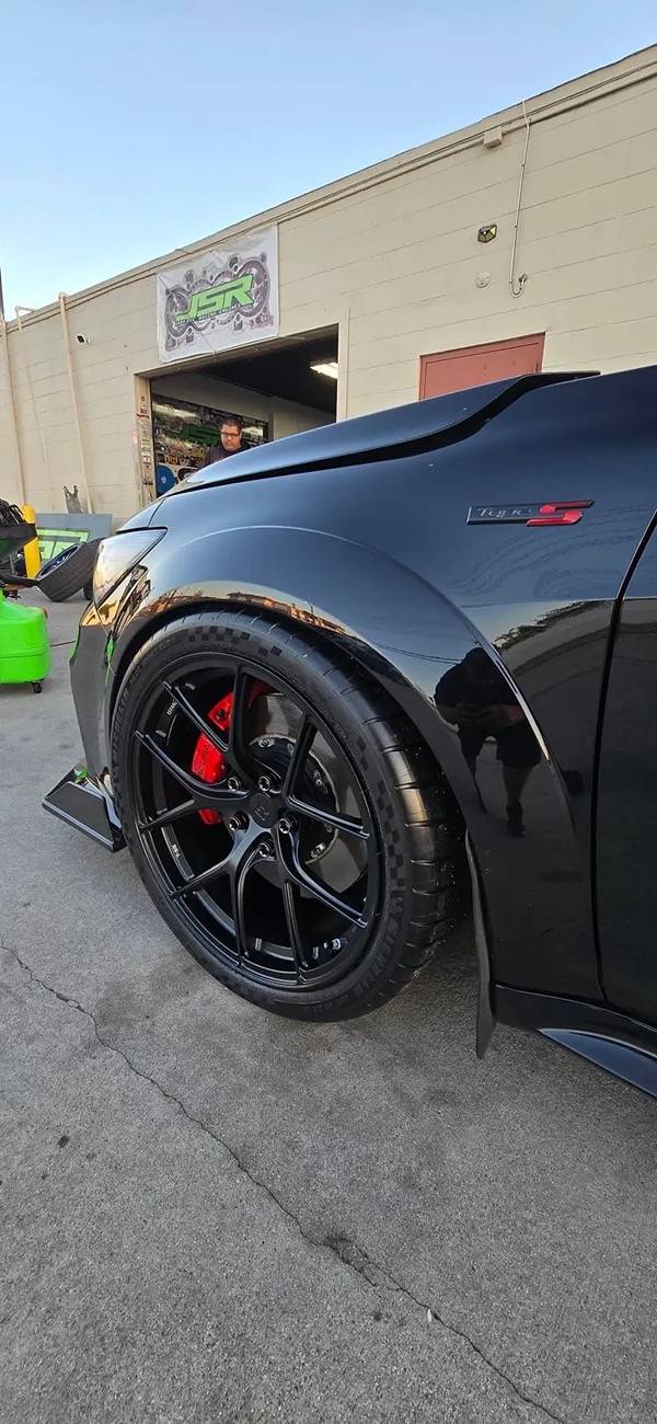

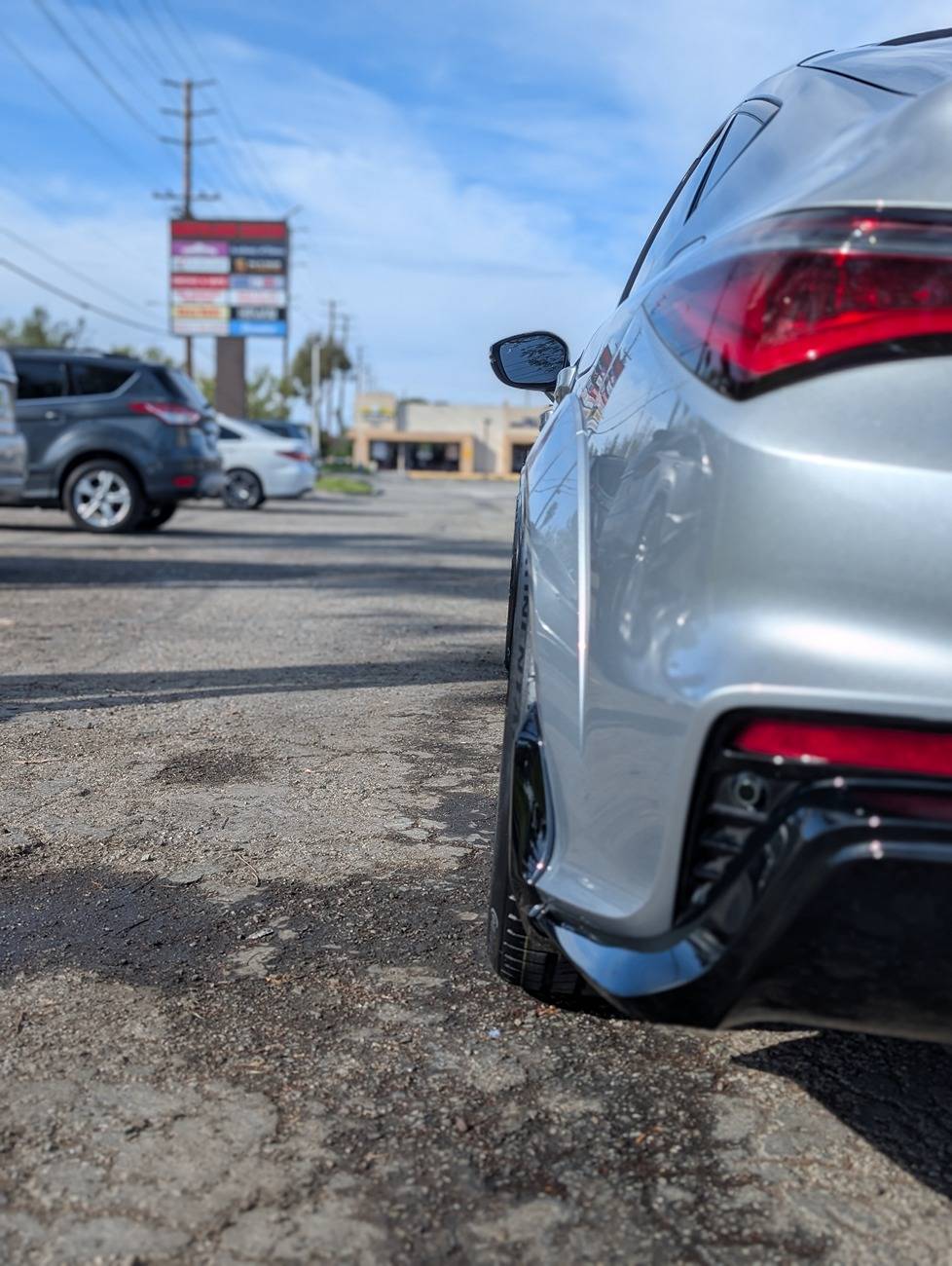

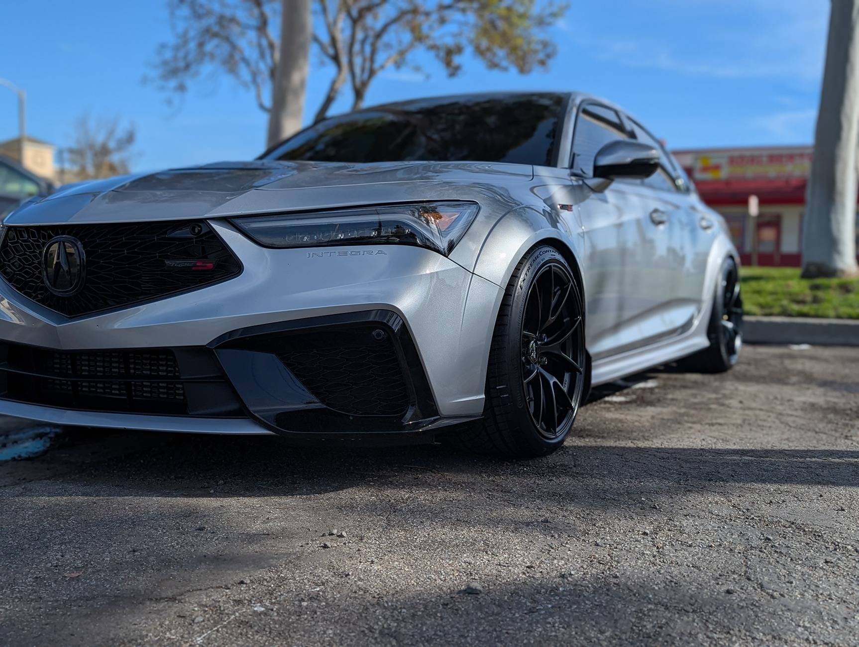

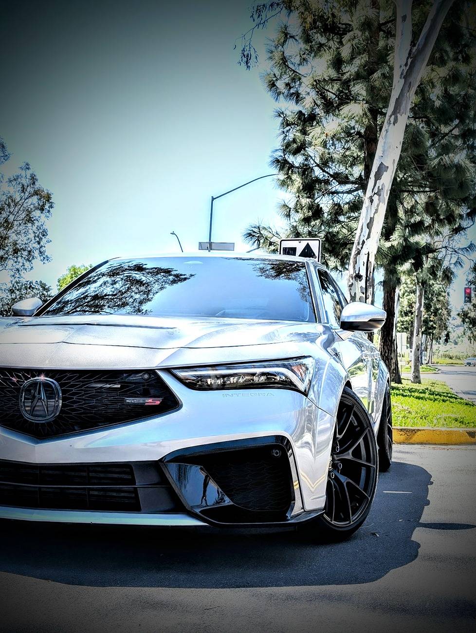

I never updated this post with my wheels to help out .. I ended up getting apex vs5rs 19x10.5 +45 and tires conti 285/30/19 no rubbing lowered on H&R ..out mot of pics so you can see different angles hope this helps someone
This looks great! How close are you to the suspension? I'd love to run something like this with slightly less poke in the front. Could you have gotten away with a +48 or +50?

I think I'm maxed out tbh ...I'm lowered on H&R springs ..anything more and I think it rubs
Good to know. I wanted to drop on Eibach Pro-Kit, so I'll need to go less aggressive. Thanks!
