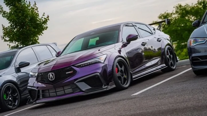

19x9.5 +40 Superspeed Rf05rr - Plus 3mm slip on to clear brembos, so effective +37 offset
265/35r19 Advan Apex's
Eibach Pro kit

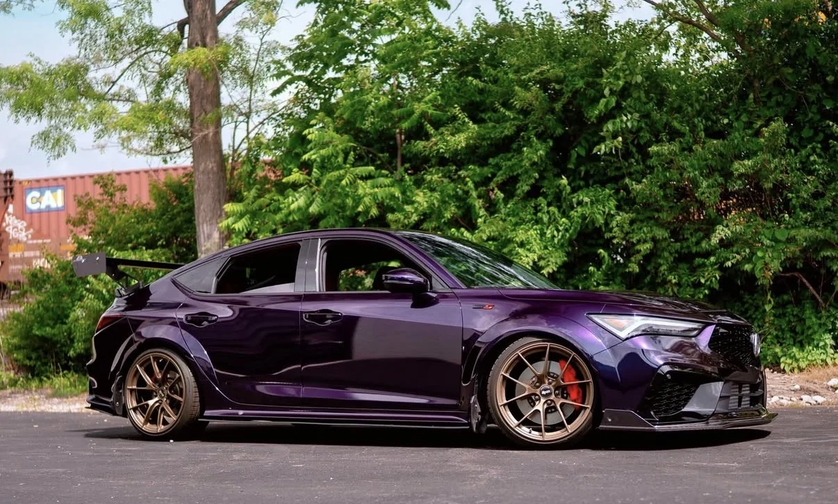

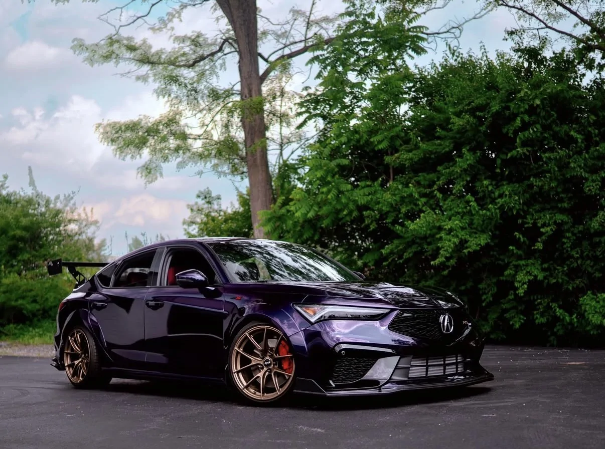

19x10.5 +45 APEX VS-5RS
265/35r19 conti sport 03
Eibach Pro kit
35 profile 19s on 10.5 et 45... any rubbing? I'm running 285/30R19s on 19x10.5 et 48, but was considering 35s.

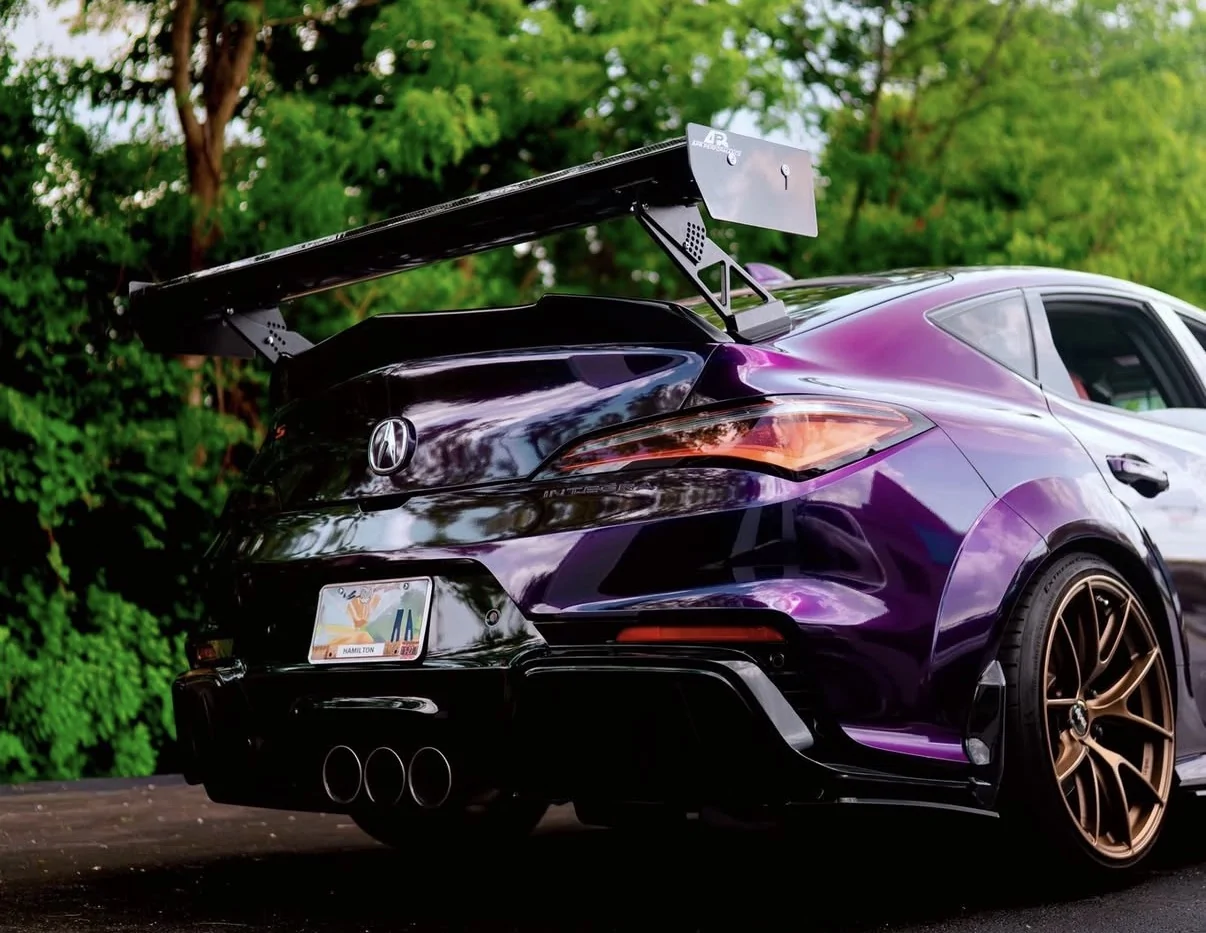

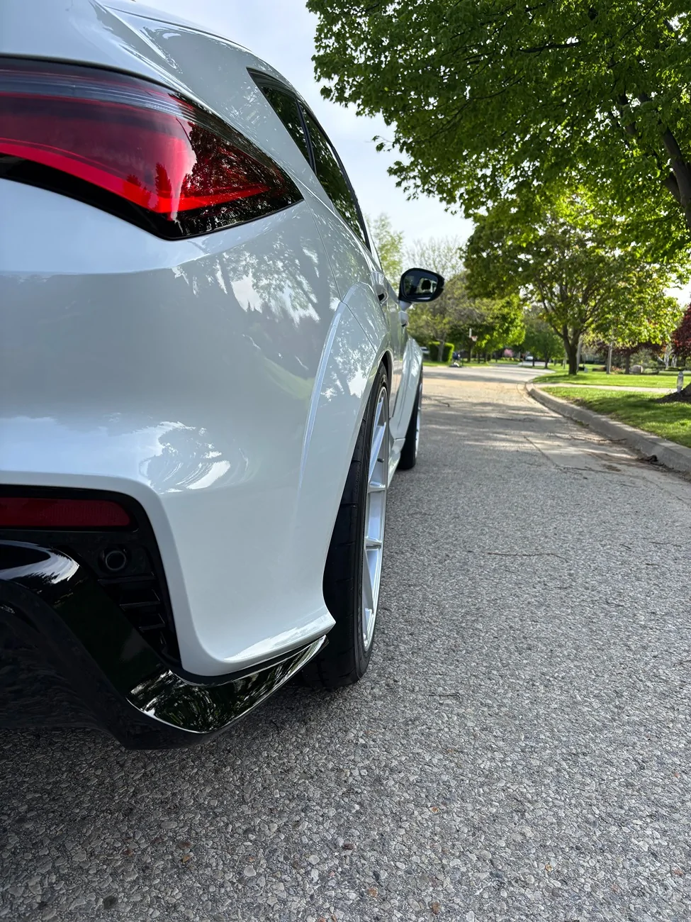

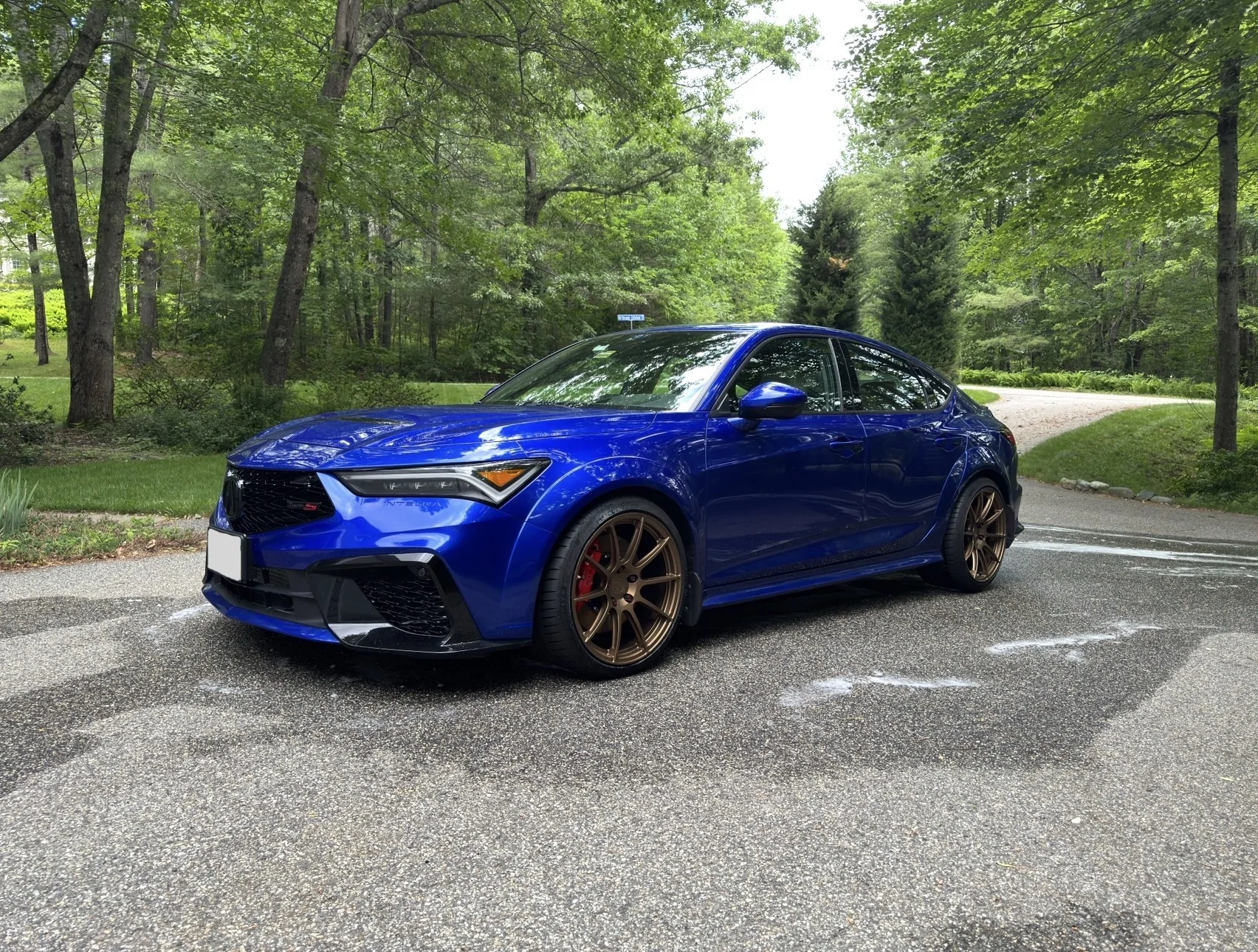

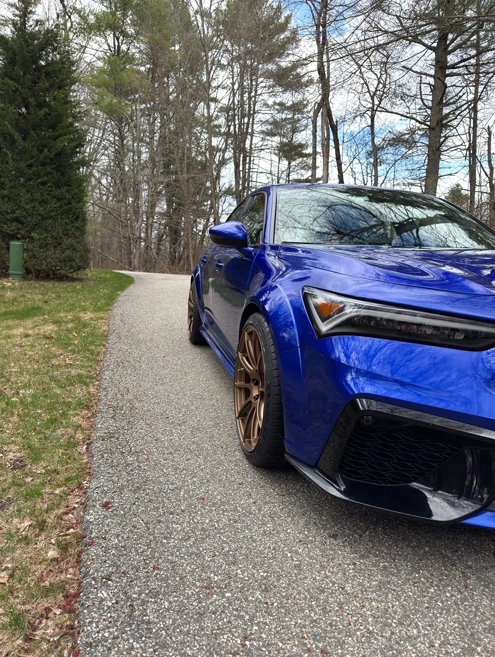

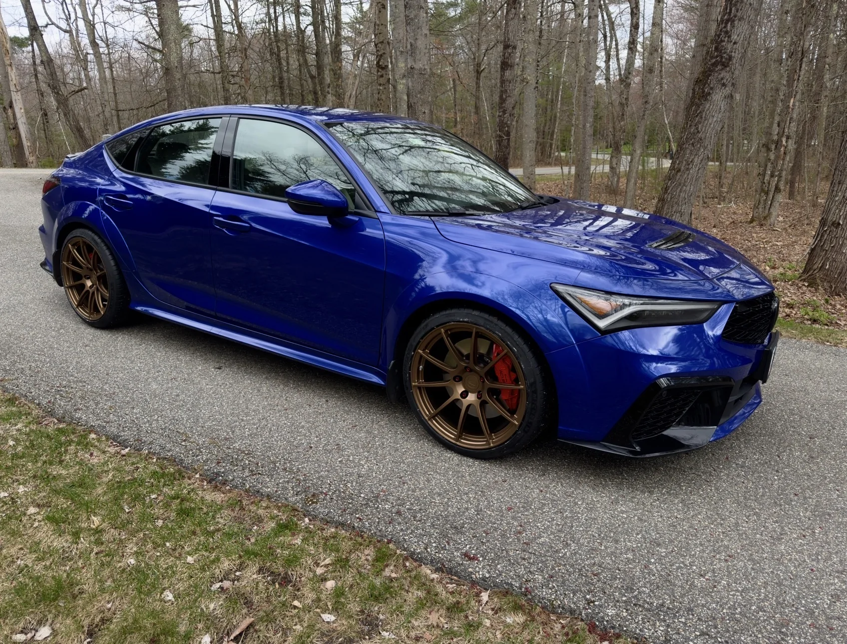

I never updated this post with my wheels to help out .. I ended up getting apex vs5rs 19x10.5 +45 and tires conti 285/30/19 no rubbing lowered on H&R ..out mot of pics so you can see different angles hope this helps someone
Beautiful build! I just want to confirm you have 100% no rubbing. None at full lock or under load, etc? I just picked one up and if its not rubbing, your build is going to be my inspiration!

Im coming from stock, any issues with the 285/30R19 rubbing? I want to do that setup with the 19x10.5 just dont want to cause any rub.
Im going to do Eibach Pro Kit and 20mm wheel spacers to get started along with some ground effects. I want to make sure I have a wheel/tire setup that wont rub when I get around to it.

I am on stock springs. I have absolutely no rubbing with a 285/30R19 on 19.5 x 10.5 et48. Whether or not you would rub with the Eibach Pro Kit, I'm not sure. 20mm (or 25 to be extra safe if you're using them to determine fitment) spacers is a good test.
@optronix is running those springs (I think) with a very wide 275/35R18 (200TW... maybe the new RZ?) on 18x10 et40, which is very slightly more aggressive fitment than my wheel/tire setup, and I know he originally had a bit of rubbing, despite many posters claiming no rub with lowering springs at 10" et40.

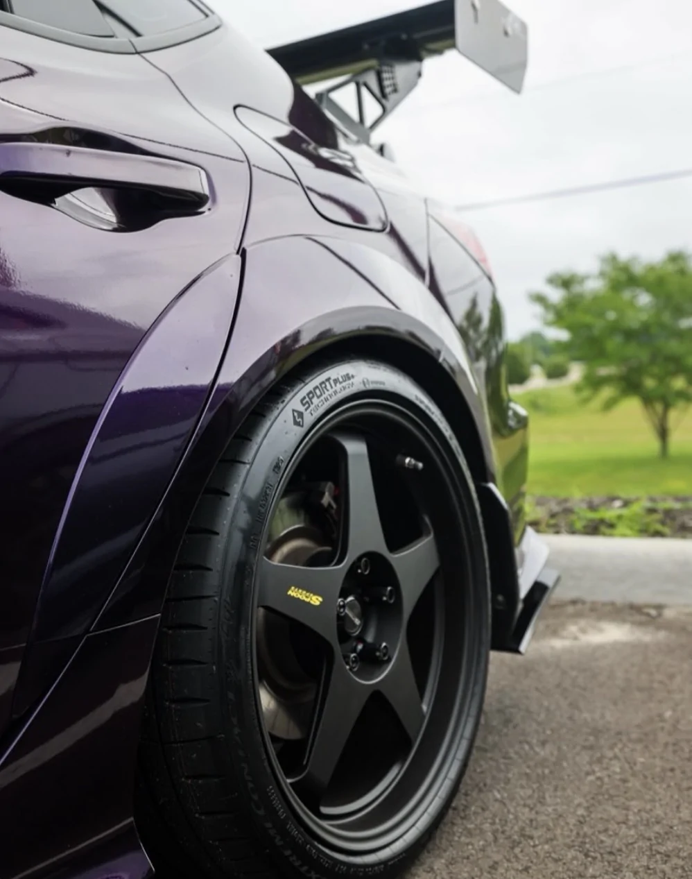

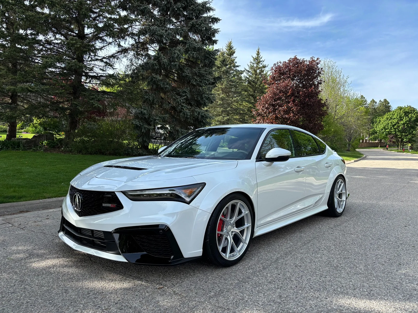

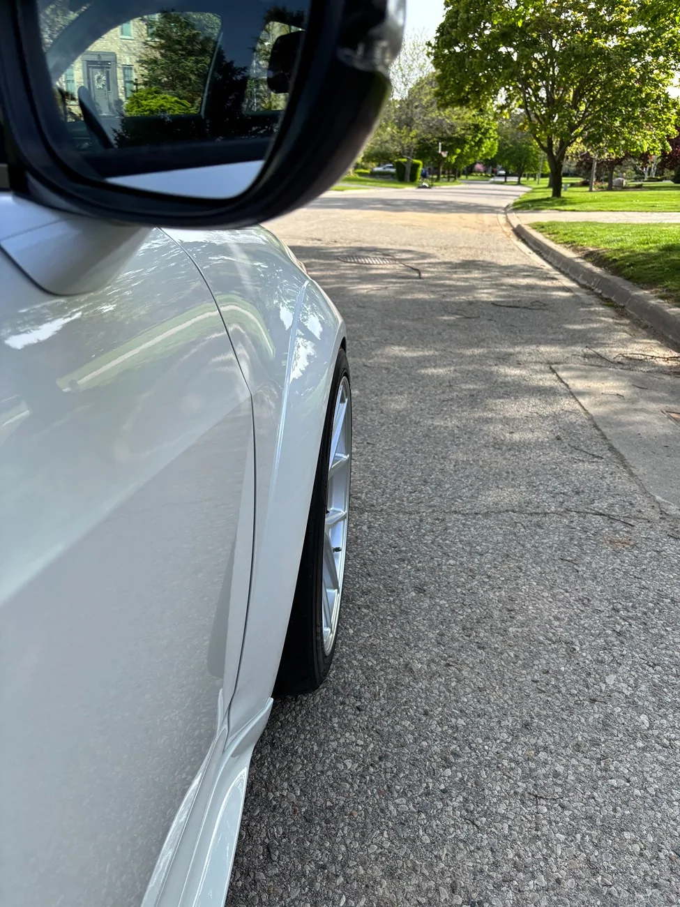

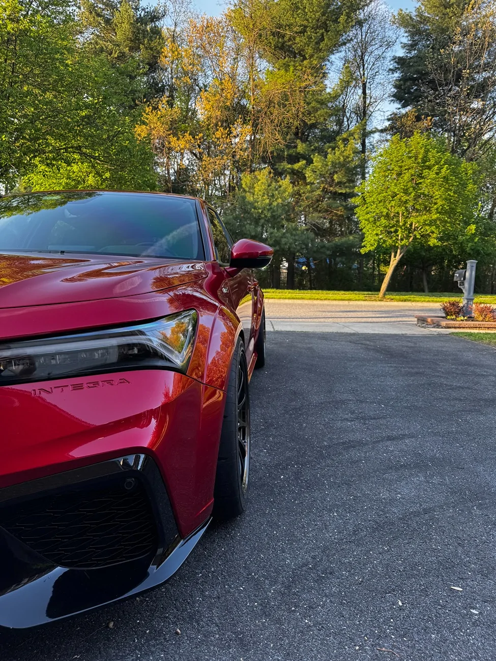

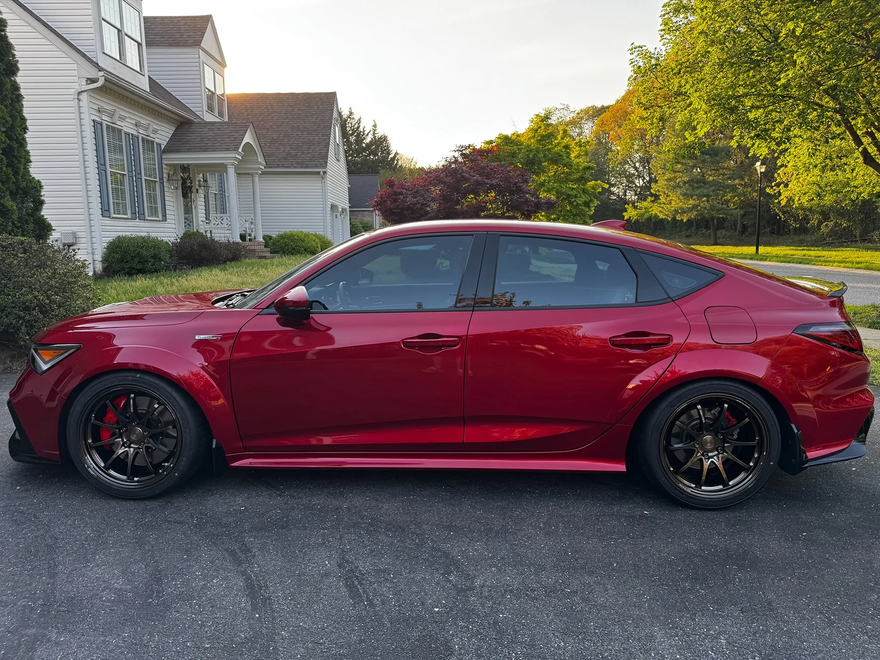

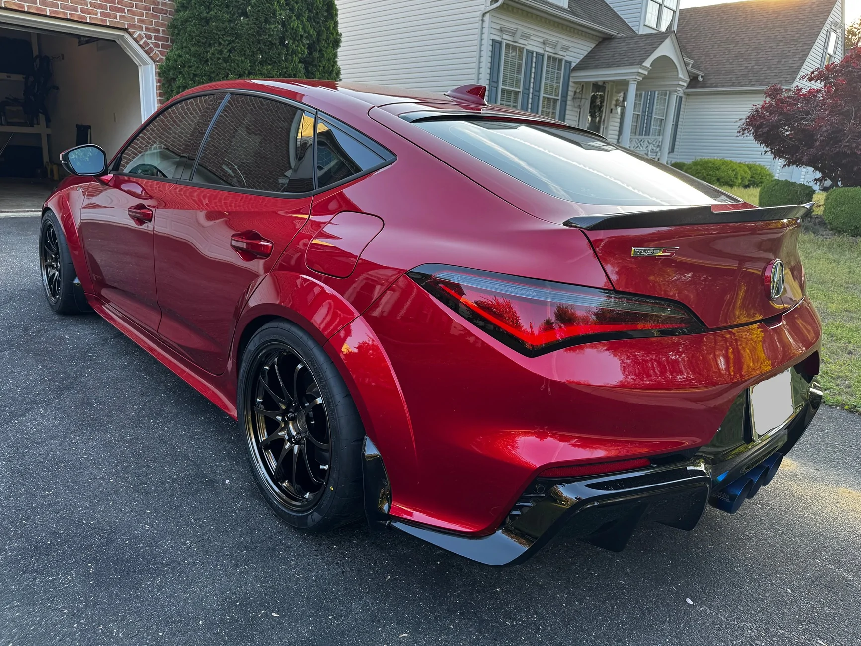

Yep, 275/35 18 RE-71RZ, they rubbed a bit on first install but after about a week or so (including 6 autocross runs :eek:) I can't notice any rubbing anymore. It basically only rubbed on significant dips at speed. I checked the inner fenders and all suspension components, just a few scuffs so there was just the slightest of rubbing going on.
Here are a couple pics of that setup; it's actually rarely on the car as I prefer the OEM Michelins for the street so kept my 19" Apex VS5RS around. I think this is about as aggressive as I'd ever want to go; pics don't really do it justice I've had people tell me it looks like it has a widebody kit.

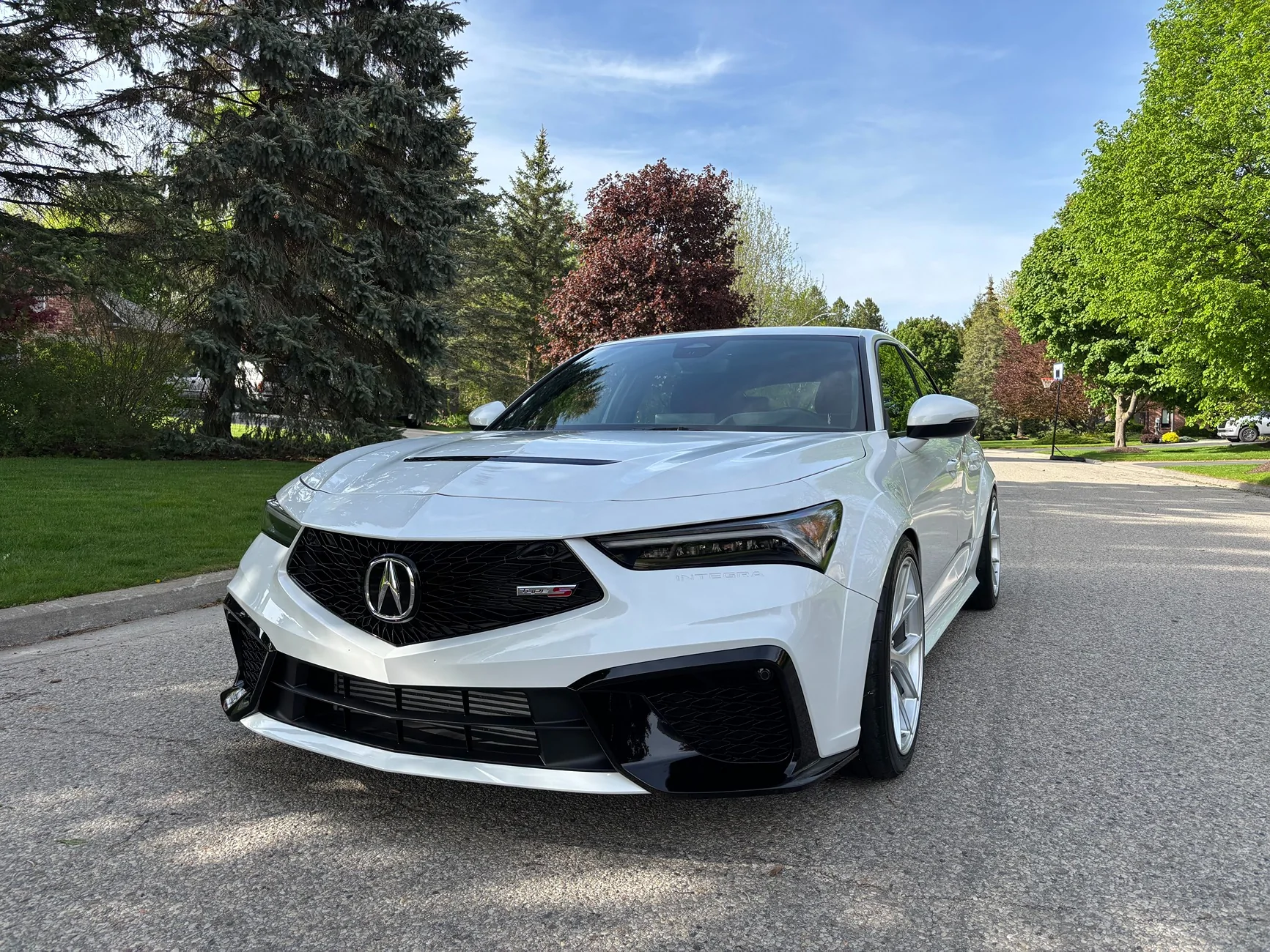

The wheels Im looking at are et47. I saw one guy on here said no rubbing with the 285/30R19 et45 on 10.5s. He was lowered on H&R springs which look to be ever so slightly lower than the Eibach kit. Just dont want to spend a bunch and be disappointed by some rubbing.
You have some pics of your ride? Id like to see that on the stock height. I might not even need to lower.
Aesthetics are much better with a drop, imo. I was on the fence, but I decided to stay on stock springs, as you introduce some (correctable) geometry issues (like F/R camber relationship, roll center, and bump steer) and you also give up a significant portion of the optimal operating range of the front suspension re: dynamic camber (the design attempts to minimize the camber change that a mcpherson strut exhibits during compression... it performs extremely well in the first 20-25mm of compression but begins to trend more closely towards standard mcstrut behavior as compression increases). I didn't want to have to run significant negative camber up front to compensate.
