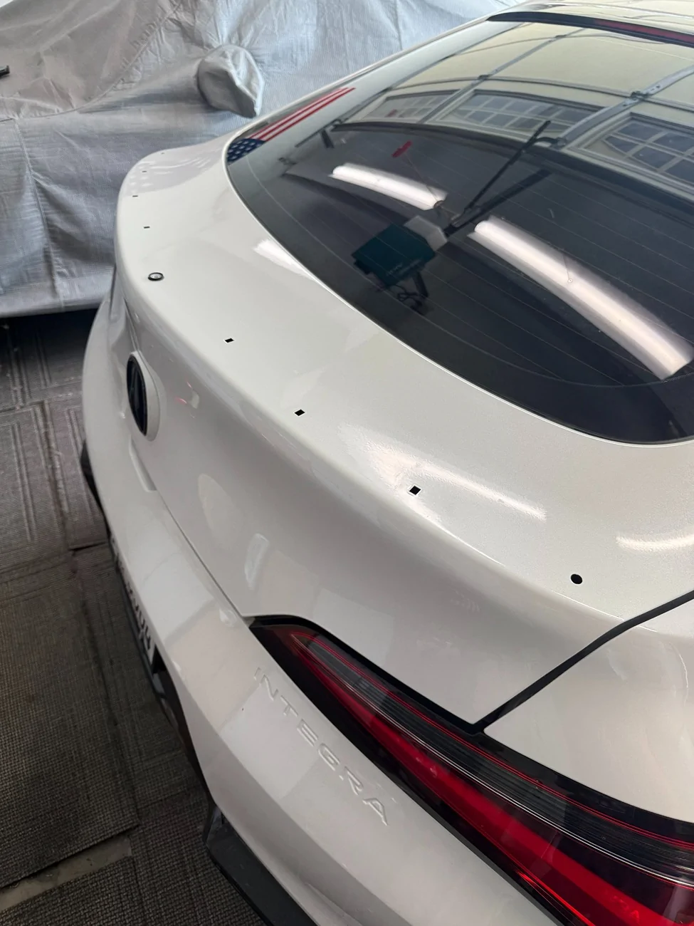

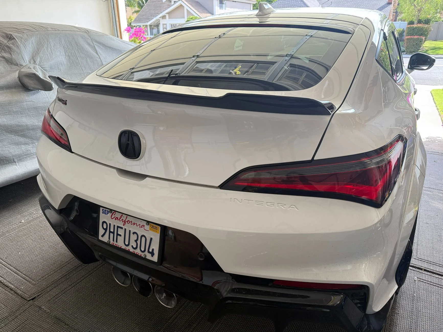

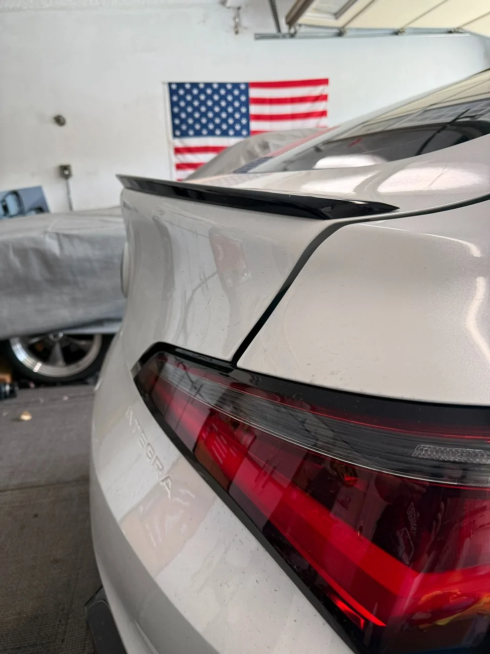

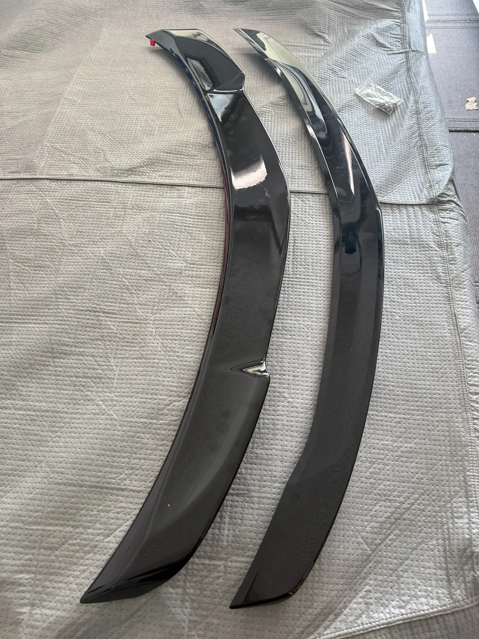

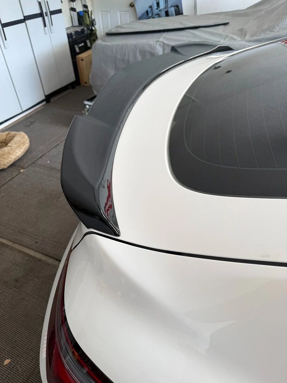

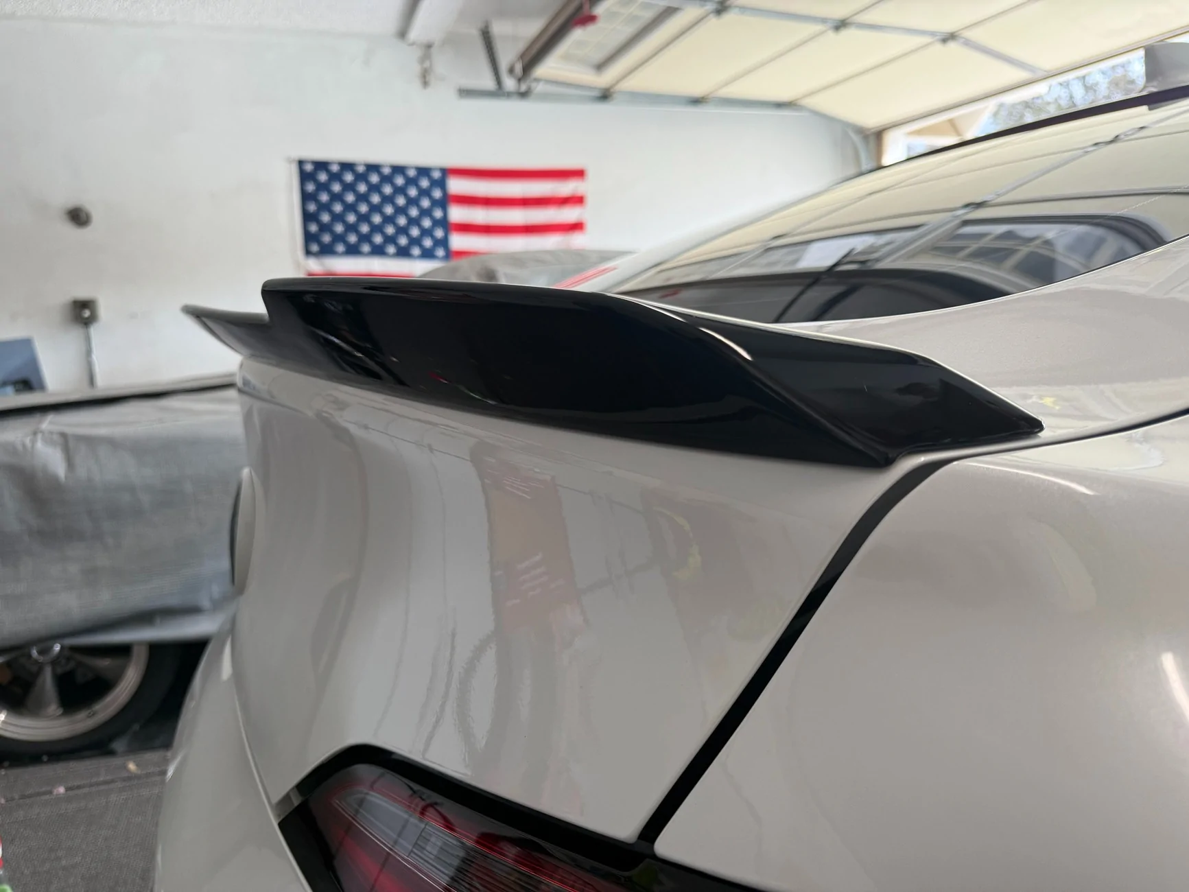

Installed the Extreme Online store factory style extended spoiler. I liked the OEM Carbon Fiber spoiler style, however, I don't want any exterior carbon fiber, I was looking for a gloss black alternative. Was able to get this for $150 shipped, and was one of the very few I could find that is bolted to the car. Spoiler matched perfectly to the factory holes and gave everything needed to install. Still looks very factory; I'm very happen with the results.
Did you get this from a supplier or consumer? If the former... Are you able to share your source? $150 is a great deal.

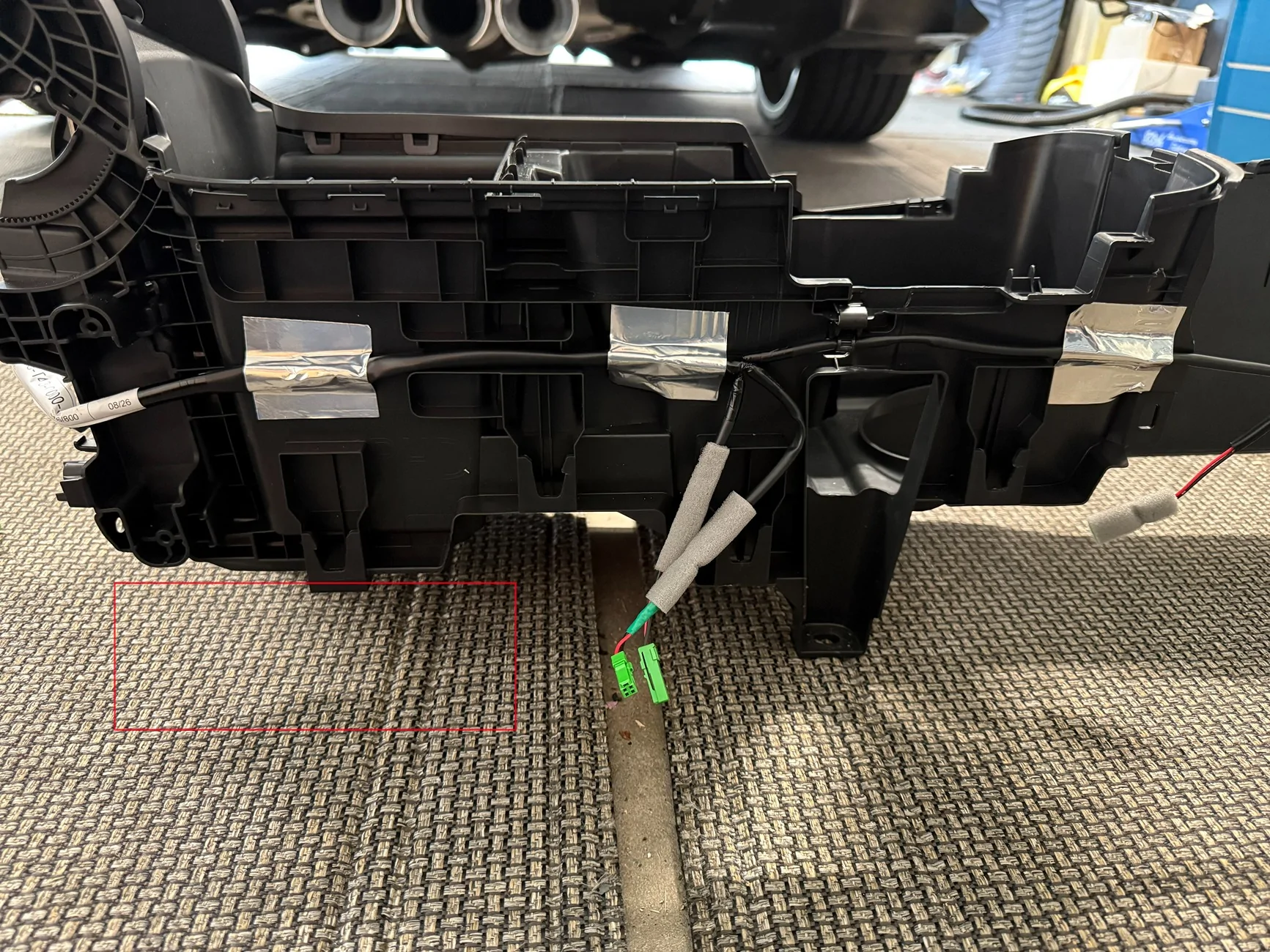

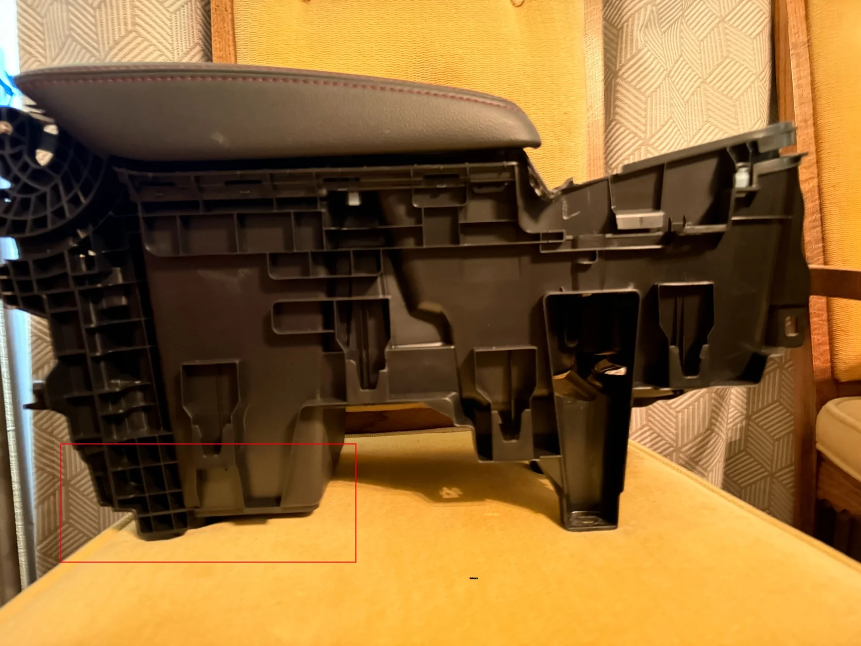

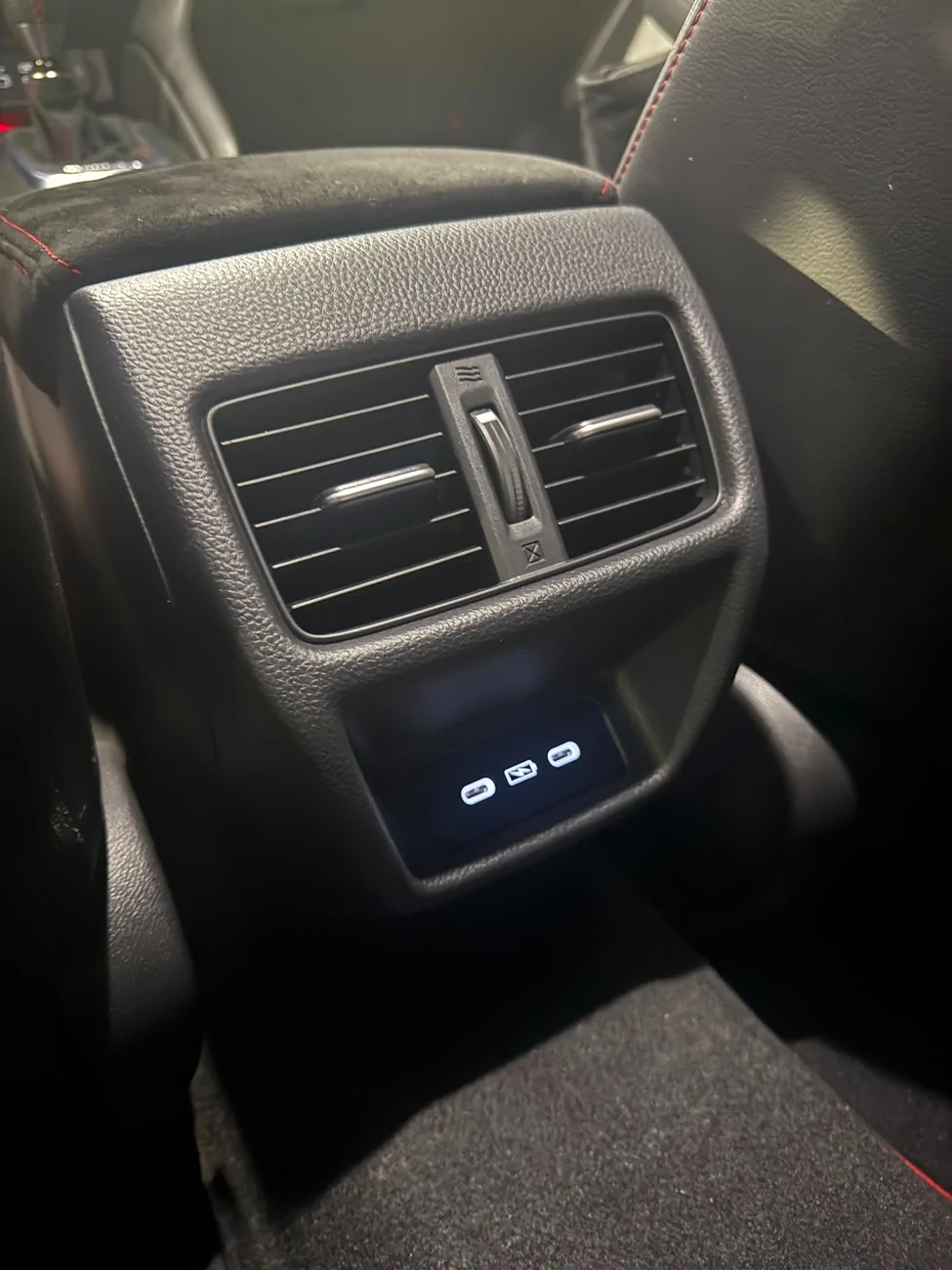

I ended up buying a full center console from a Type R, it isn't as deep as the Type S and allows for the duct to be routed properly. There is a lot involved as I found out as I progressed with the project.
Mikstore kit: $260
Type R center Console, Ebay: $210
Parts for the OEM Factory rear vents and USB: $220
Bracket and hardware for Type R Box: $20
Grand total was a little over $700 to complete this.
I probably went about it the wrong way and there was probably a little bit better and cheaper way to get this accomplished. However, coming over the pond makes a lot of the cost about 1/3 in shipping.
For Reference, here's the Type S Box:
This is the Type R Box:
This is the bracket and hardware needed for the Type R Box:
https://extremeonlinestore.com/products/2023-up-acura-integra-rear-spoiler?variant=46396579381418
If anyone decides to purchase, the very middle hole will/should be covered with something as it is no longer used. The plastic clip should be removed as well...or at least I removed it.

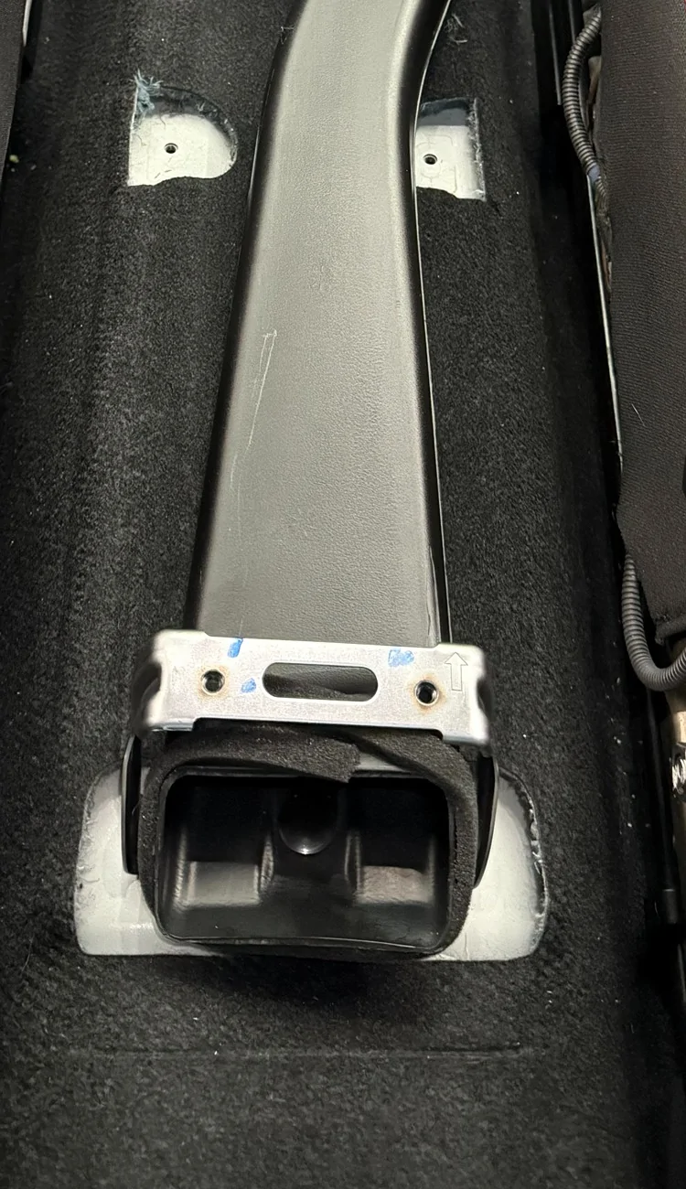

...and I'm also shopping for a new type s duct inlet thingy... If it even comes as a separate piece I can buy.

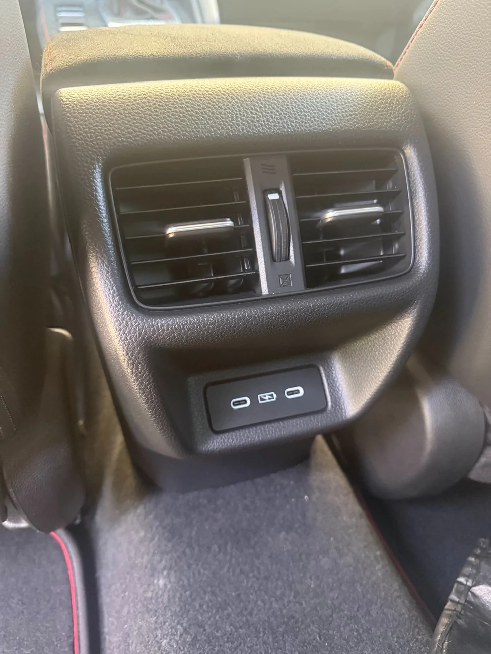

Finally completed the rear vent with factory USB-C charging ports. Nothing like Genuine Parts!

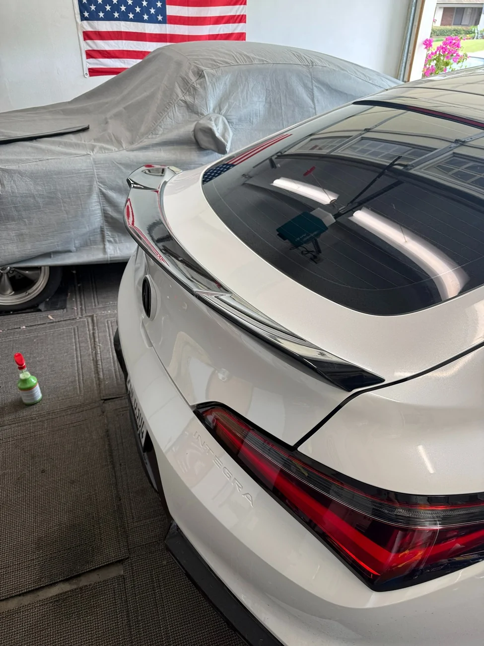

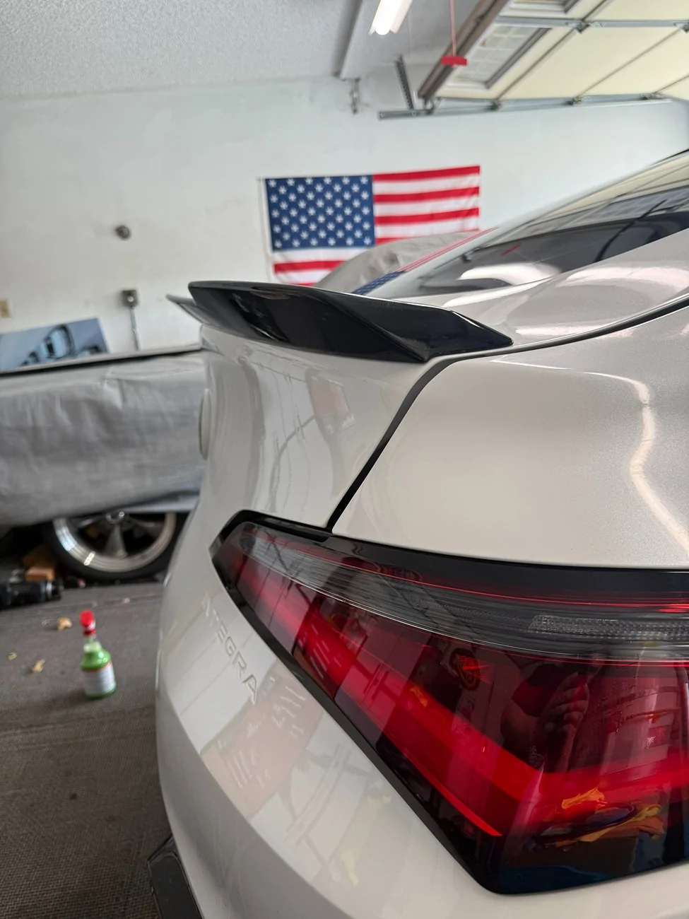

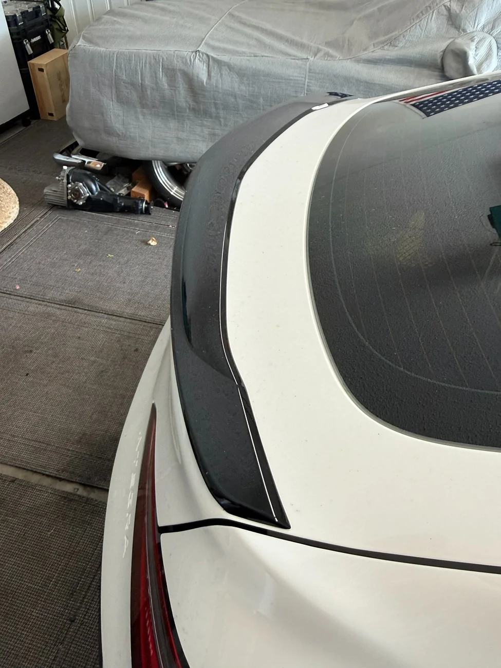

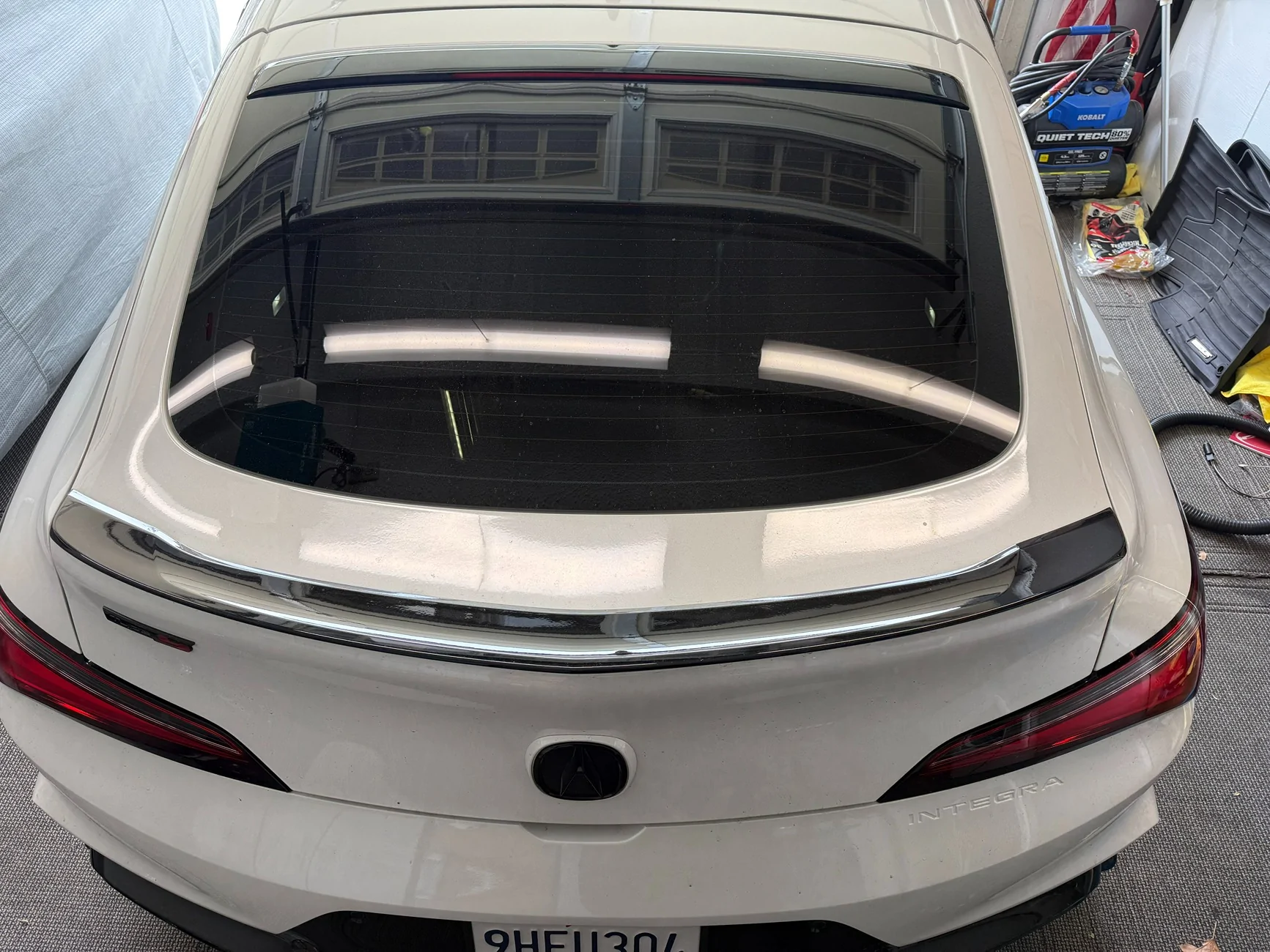

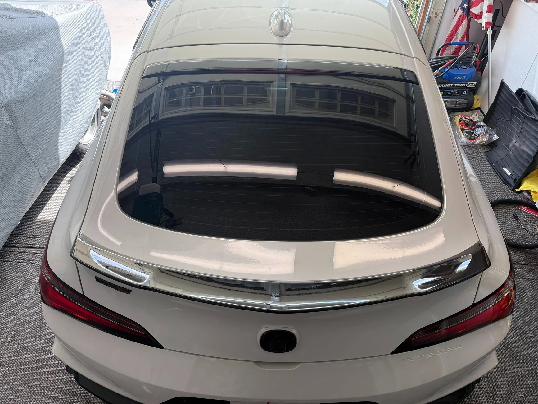

Photo Op with the new spoiler, liking the profile!
So much better.
I planned on doing the rear vents, and I still may, but now it's a third (soon to be fourth) car, so it may not get a lot of attention anymore šŸ˜’.
Looks much better with the larger spoiler. I've seen a couple cars now with the original lip spoiler and the back end of the car just looks off. Looking good!
