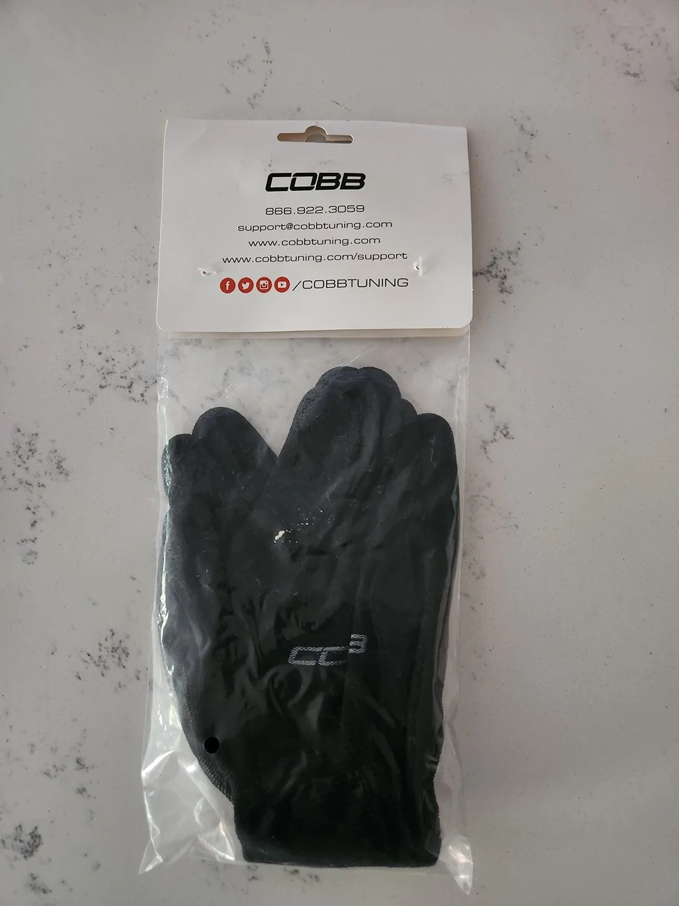

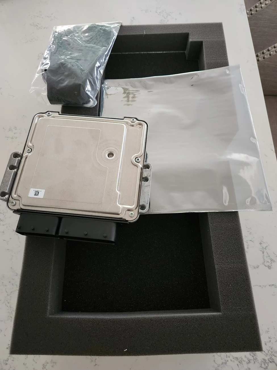

The ECU still needs to be unlocked so I had to mail it in. It's a very quick turnaround and they make it simple for you. They send a box, custom foam insert to fit the ECU, anti-static bag to place the ECU in, and a pair of COBB Tuning work gloves:cool:. They also have step-by-step instructions available to remove the ECU.
I didn't send it out strategically to minimize downtime. I simply sent it out when it was convenient. What I mean by that is: I sent it out on Friday from Atlanta, GA. It was delivered on Tuesday to COBB Tuning in Austin, TX (They're closed on weekends and Monday was Memorial Day). The ECU was unlocked by COBB and left their facility the same day it was received. I got it back on Wednesday. Presumably, you could send it out on Monday and have the ECU unlocked and back in your car by Wednesday as the happy path. Credit to COBB Tuning for making the process both simple and easy. The thoughtfulness and attention to detail made this a great UX.

I dropped mine off on a Thursday afternoon and got it back Monday morning.
Agreed, the process, packaging, and nice touches like antistatic bag and gloves were a nice peace of mind feeling 😊
