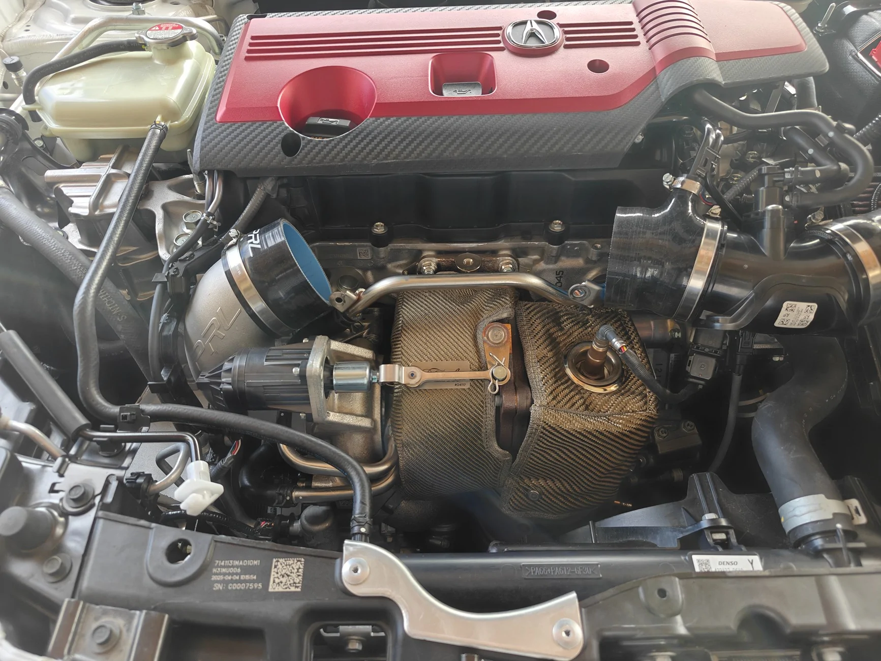

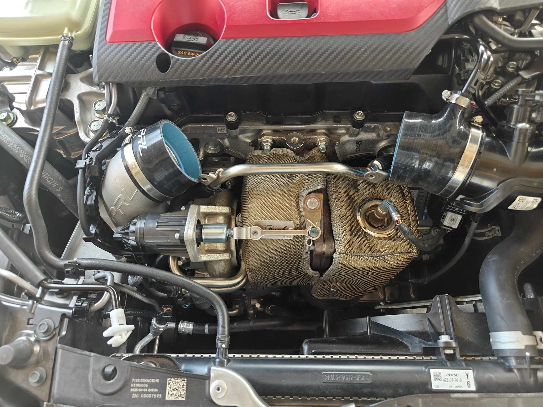

Decided to keep the turbo and downpipe elbow blankets and installed them today. Used safety wire instead of the supplied safety springs as it's a much easier install that way. Used a proper safety wire pliers to twist and secure the wires.
So far, I've noticed an increase in low end torque especially from a stop light (since that would have previously introduced some heat soak).

Don't know if it's in my head, but lag feels reduced too.
Not in your head. Keeping exhaust warm keeps the gas moving. It's still nowhere near an NA or supercharged engine, but it does improve a lot. Especially as things heat soak and you're in the higher torque range.
