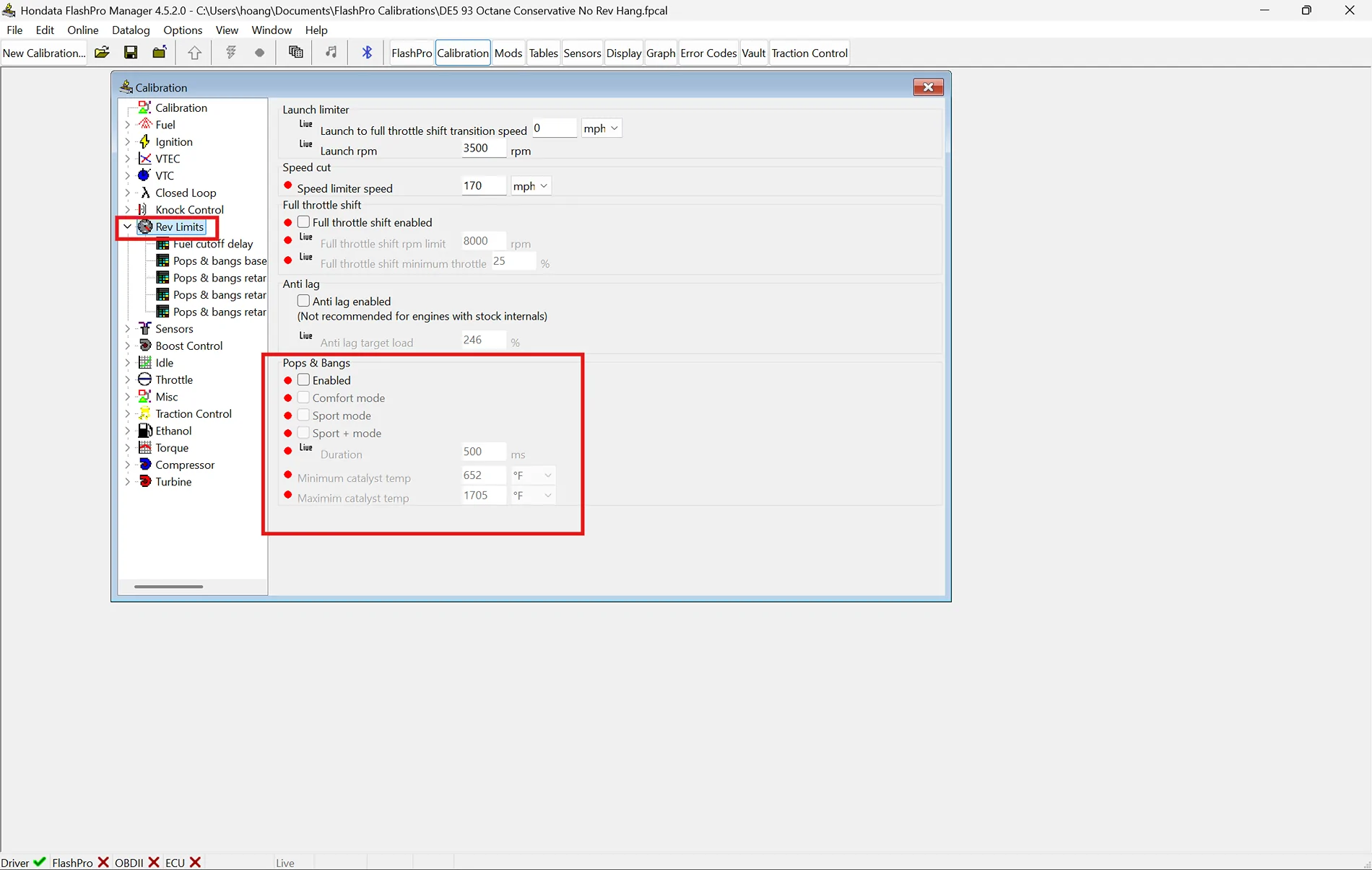

Question for the experienced Hondata people: I am going to try a canned Hondata tune, but with the integra type s selected as the car, I cannot disable pops and bangs (it reselects itself). Is it okay to use the Civic Type R binary in place? Or can that damage the ECU?
you're right that in the 'mods' menu, the pops and bangs reselects itself when unselected, happens to me too. instead, go to the 'calibration' menu and go to the 'rev limits' top menu and unselect from the 'pops & bangs' section, this works for me.
