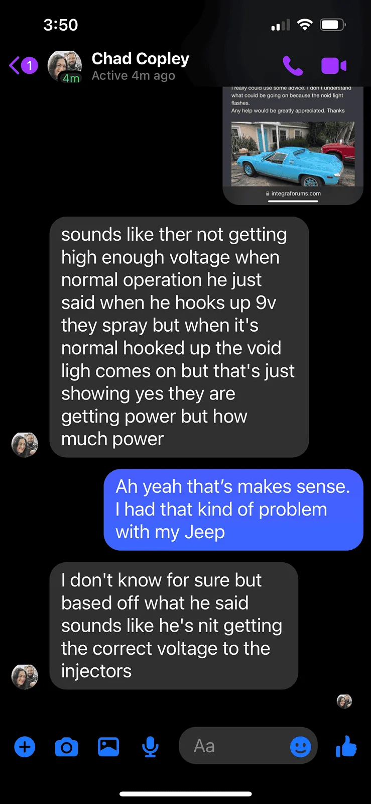

I asked a local builder I know that deals with GSR engines a lot. Hopefully this helps or you get it figured out soon!

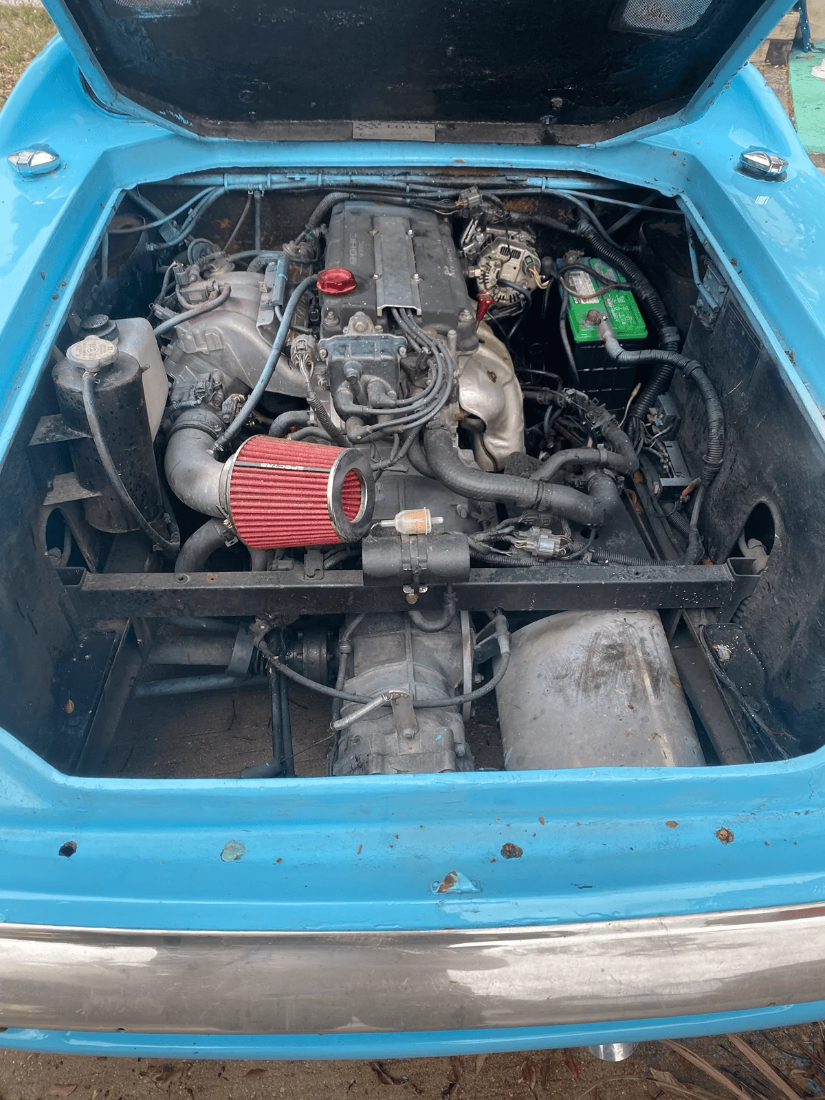

I didn't do the swap but it worked great then the clutch blew and it sat around in Florida weather now trans but npc start. Injector4s are working and they are getting fuel but not firing. A noid test says the eco is putting out a pulse but they'r not firing. Can't fight it out. Here 's a pic of the motor. Let me know if you have any ideas. Thanks.
