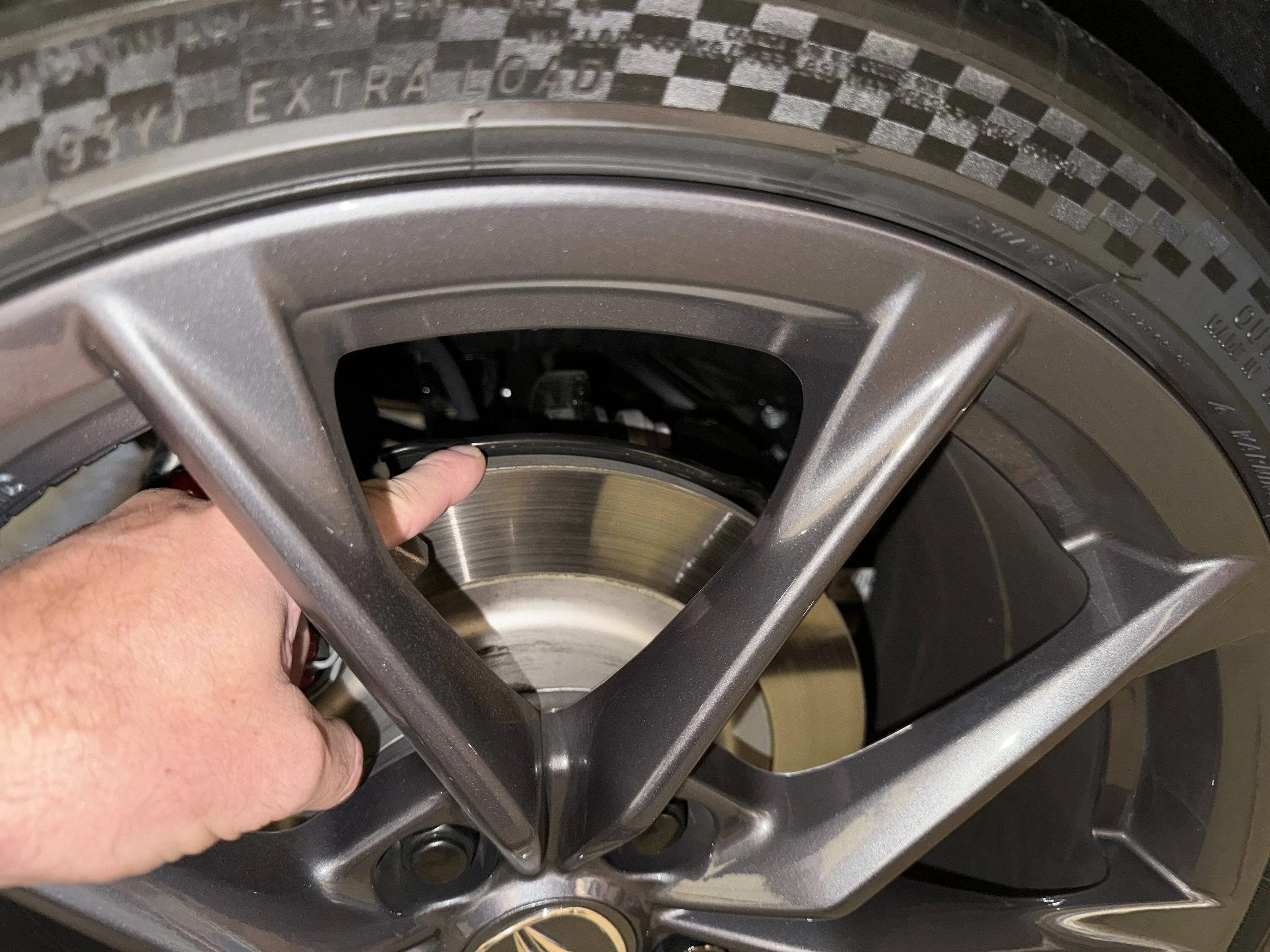

can somebody take a picture showing where exactly these rocks get stuck at? i've had it happen before as i mentioned but i was able to dislodge it by driving, but next time it happens i would liek to pull over and know exactly where the rock is so i don't fumble around in the dark or whatever
There are metal shields on the rotor and tiny rocks can pop in here
Acura Integra Does Honda actually test these cars on "real" roads? (screeching noise from front wheel) IMG_0096
