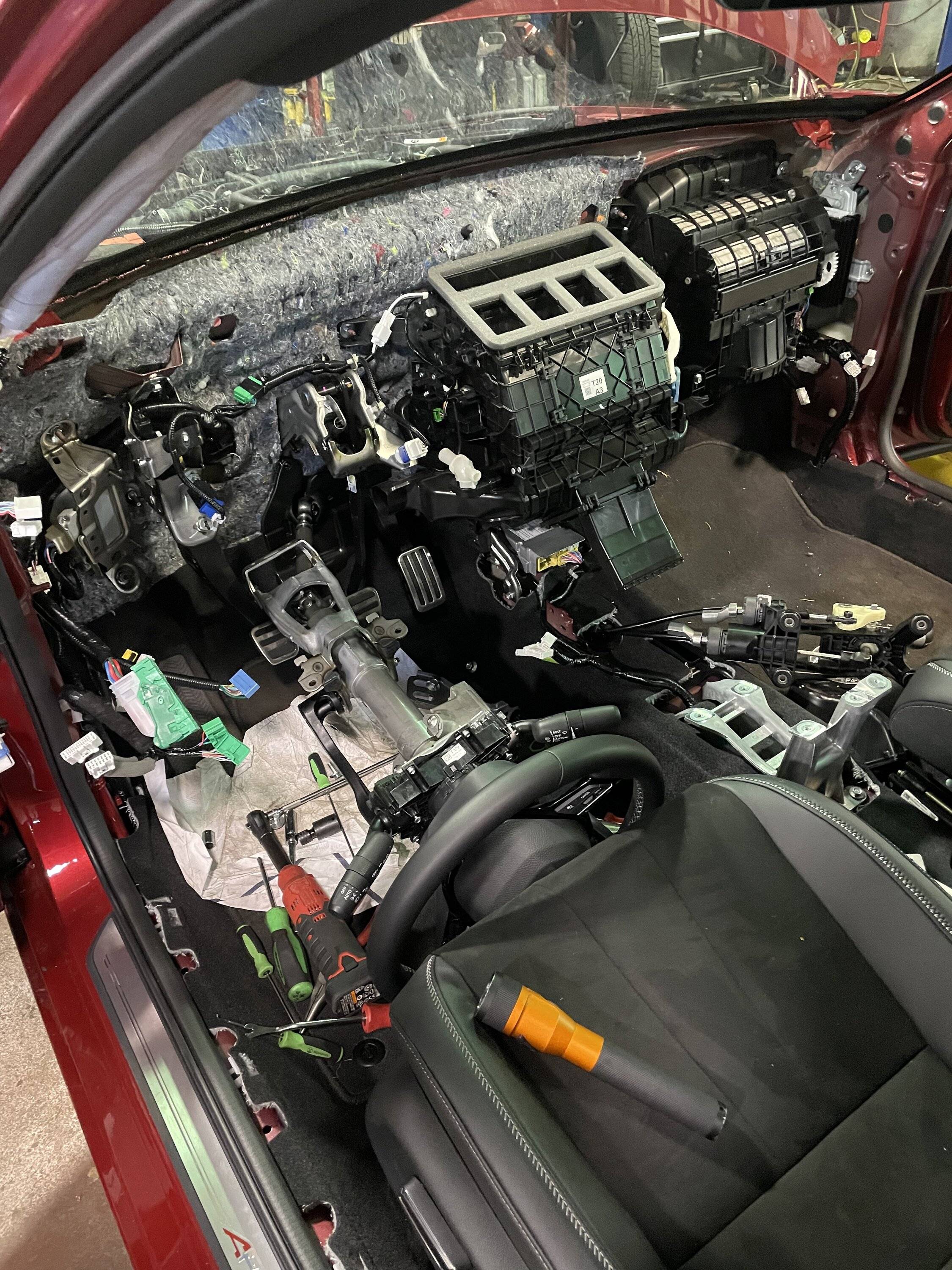

came across this thread searching for interior rattles. At work I’m working on a 2023 integra with a rattle coming from the dash area. Happens between 3500-4K rpm’s. We tracked it down to the heater core lines rattling against the heater box under the dash. After tearing the dash out i found a broken stud on the heater box that mounts to the fire wall. My guess is the broken plastic was vibrating against the fire wall. We found the rattle by reving the car to 3500 and moving the coolant lines from the heater core. When you shifted the lines the noise went away.

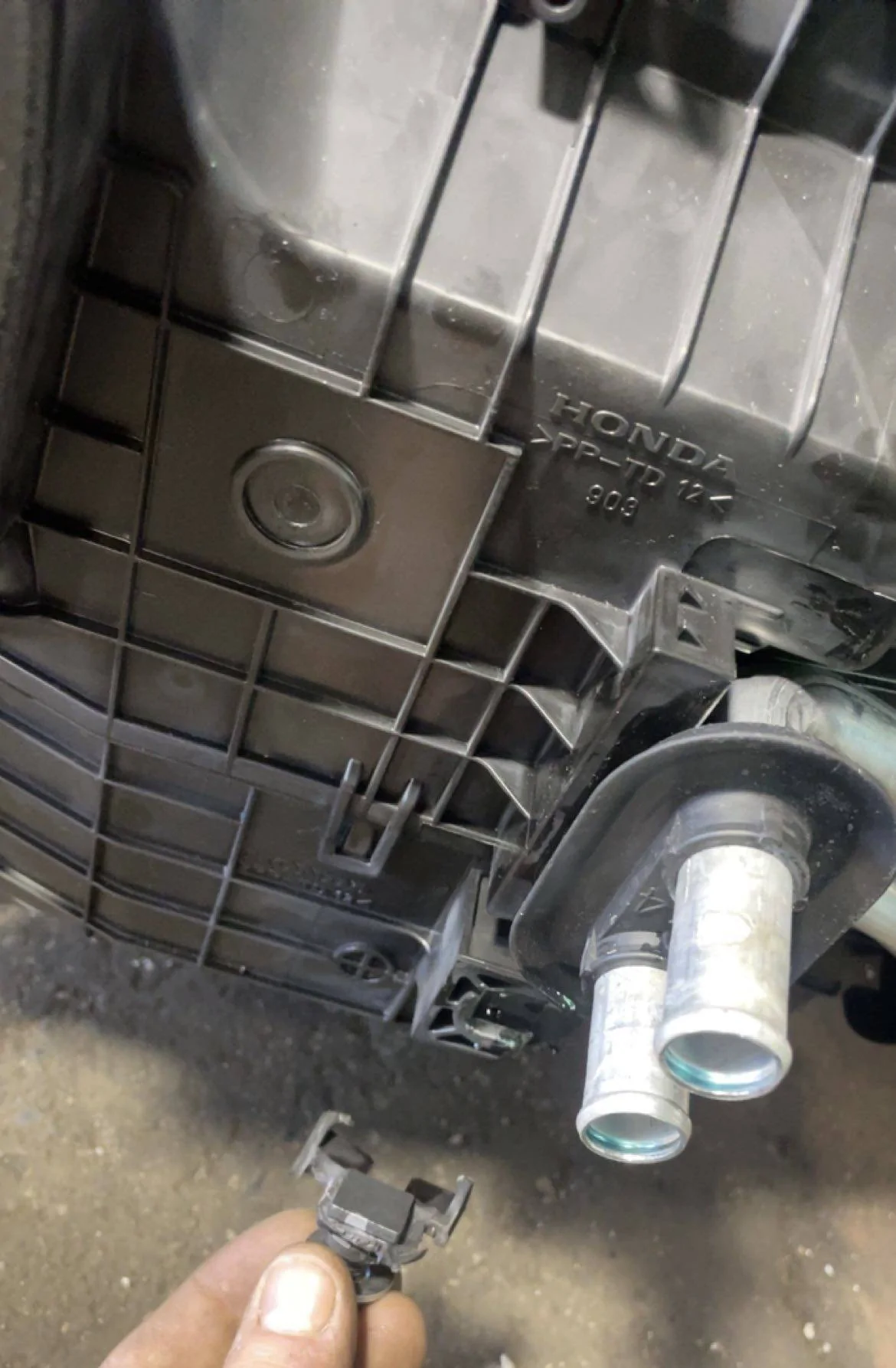

Well i was the tech working on the car… so i ended up replacing the heater core, and the heater core stay which is a small plastic clip that holds the heater core lines to the box. The lines were vibrating against the box. You can see if this is your noise by reving the car till it makes the noise then hold it there and have someone else shake the lines inside the engine bay on the fire wall.

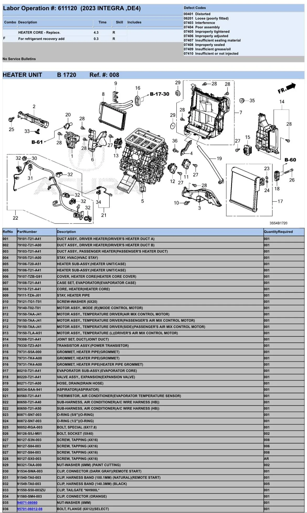

number 9 in the picture i added is the heater core stay. The top clip was broken off.

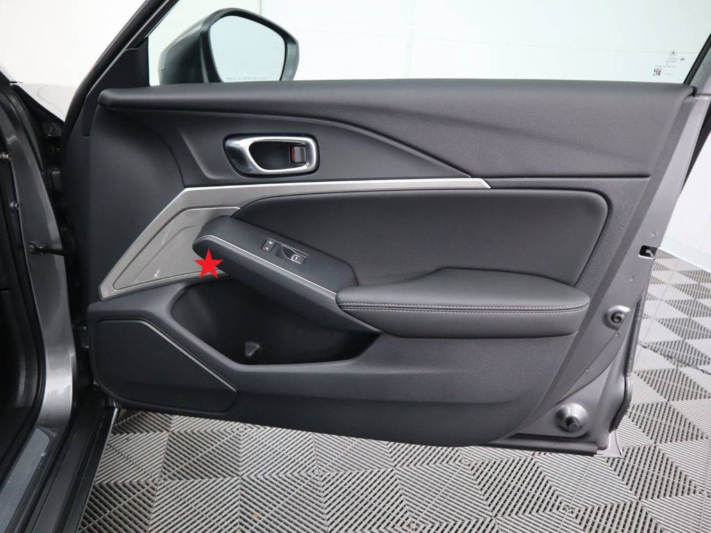

I also had a similar rattle on the passenger side... could've sworn it was coming from the glovebox. I'd originally had a dash cam with that cable buried behind that passenger leg panel. I thought that was the problem, so I hardwired the camera through the rearview mirror with a dongle after reading about it in another post on here... But that didn't fix the rattle. So then after an hour in the garage listening to music turned all the way up, I finally reproduced it consistently enough to locate it - in the passenger door. This isn't my photo, I just grabbed it off the internet, but I put a star where I found it. It was the retention clip for the metal covering over the speaker that wasn't completely seated. Pushed it back in, pop, put the door panel back on and bam, no more rattle.
