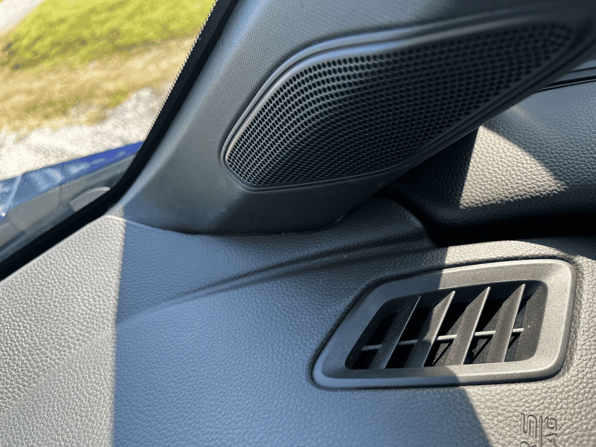

jjmika
Mar 12, 2023
2023 Acura Integra
Found my dash rattle cause was the passenger A pillar rubbing against dash, just wedge some foam seal, or cloth, paper whatever, should stop it.. I used black sunglasses bag. Just pushed in with key so can't see it from driver seat.
never came back to the forums after positing before, but I also found this to be the issue with my car. Got some foam and wedged it in
glove box also rattled like crazy so I took some foam to that too.

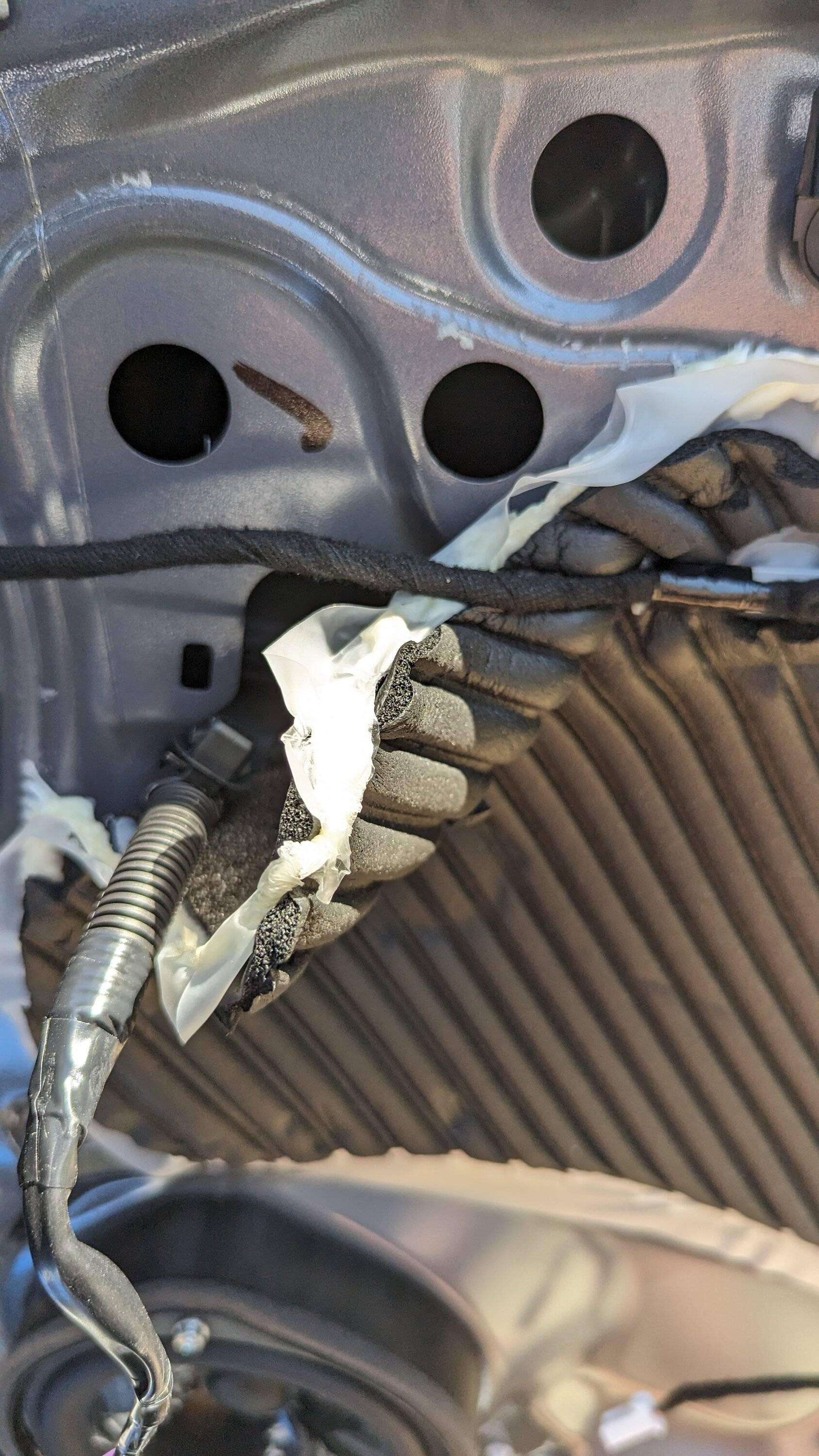

Doing the mirror mod I found something concerning. It seems that someone went back into the front doors to do something. I found the factory moisture barrier to be damaged and partially removed. Also passenger side the harness for the mirror wasn't secured in place. Another source for a potential rattle.

Was this a higher pitched buzz you were getting? Mine seems to be coming from the passenger a pillar as well. Had one in the center console under the shifter but while on the highway the other day, a swift open handed pound on the passenger side of the center console seemed to have cured it ? can you post a quick pic of where you had placed the foam wedge? Or a screenshot of a stock a pillar with the area circled? It wouldn’t surprise me if it was a design/mass-assembly thing and that’s why so many folks have similar rattling in similar places
at first i couldn't tell that it was the A-pillar, but i got the windshield replaced and the rattle got louder after that, so that's how I found out that it's the A-pillar. Told the dealer the A-pillar is loose and it's rattling, they said they couldn't find anything. So this is my solve for now until I go back and have them look again. Still experimenting with positioning but for now I have a foam piece shoved into the crevice between the pillar and the dash by the vent, as well as a piece further up in the crevice closer to the windshield.

Right in thanks for the reply! I’m going to try the same when I get home with some felt scraps I have. I wonder if mine is about the same area causing the sound
