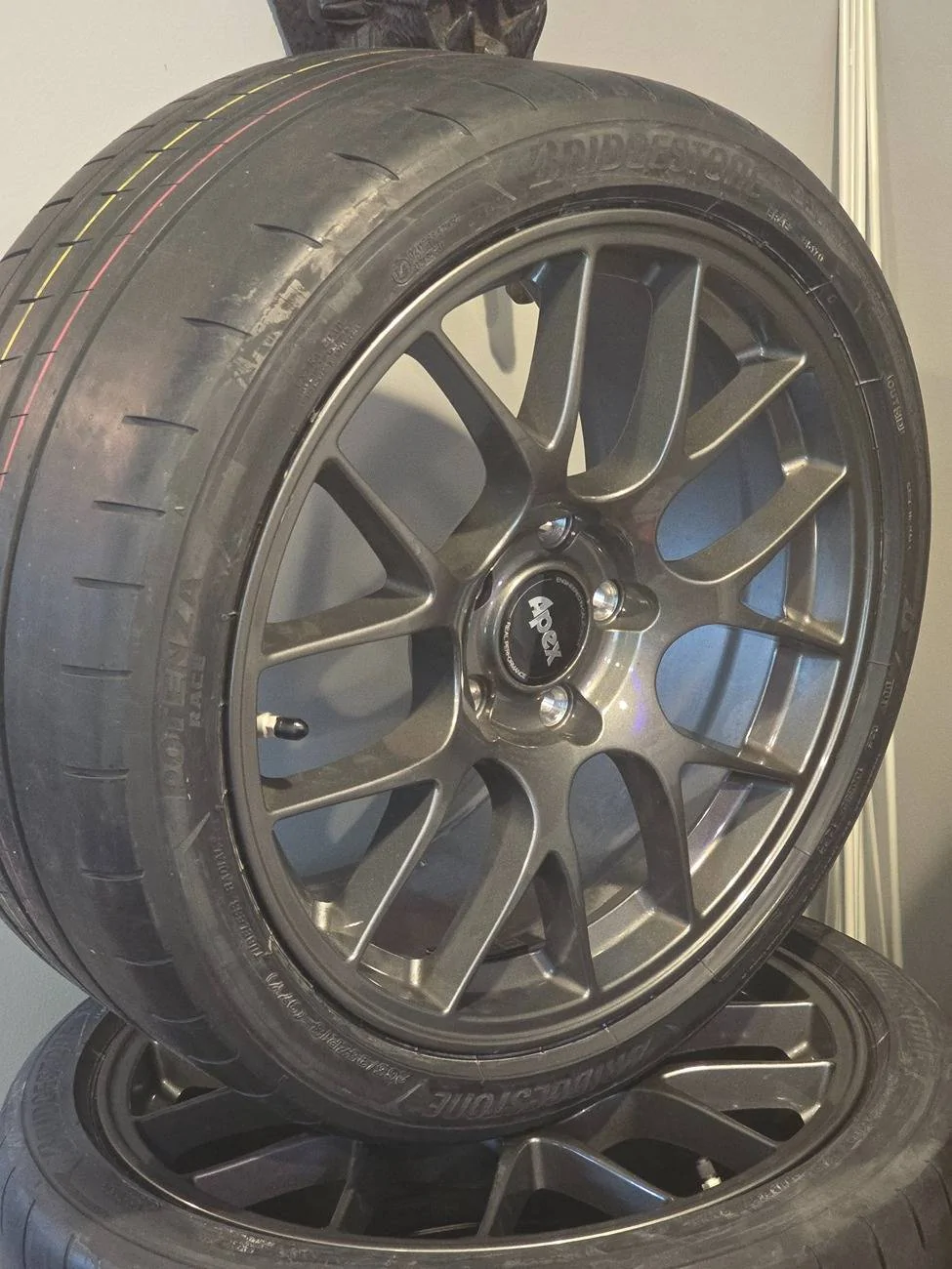

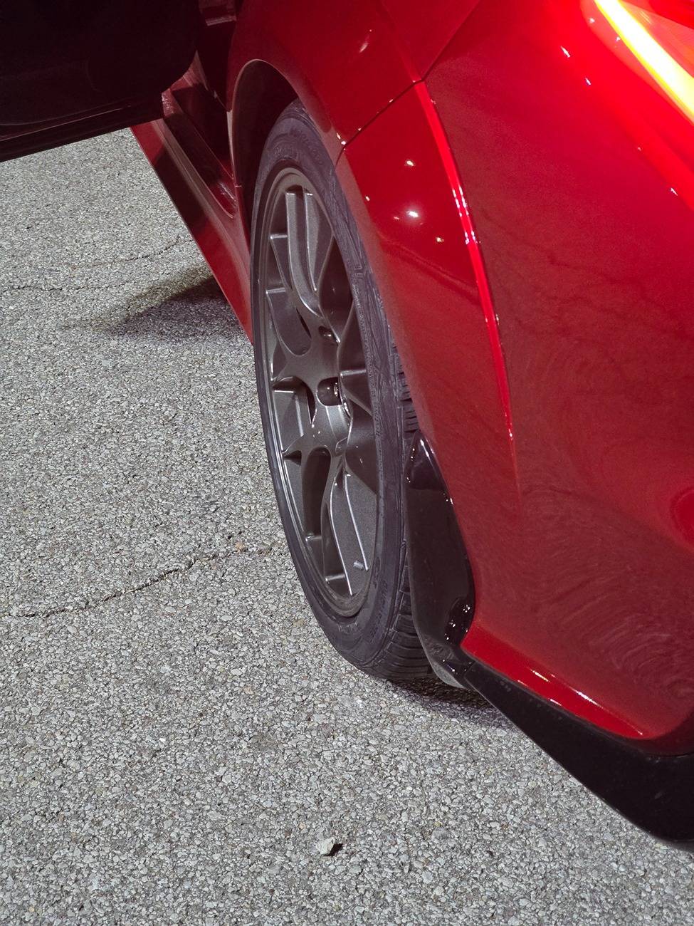

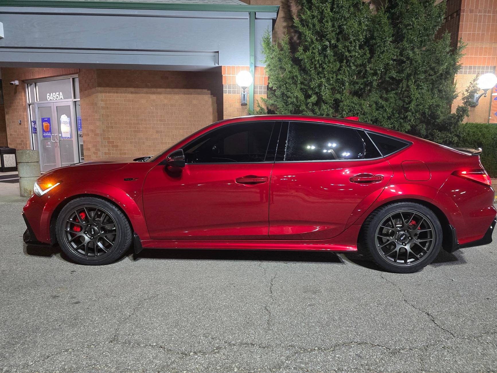

Hey, do you have any pics of these wheels on the car? Thinking about a second set for the track. Would downsize to 18x9.5, 265/35 tires +43 offset.
I do. These are my winters and I threw on the track tires for now. Ideally I'd like to go to an 18x10.5 et47 with a 285/30.
These are the 18x9.5 et58. They fit great and torque steer is mostly unaffected.
You wouldn't go 285/35 on 18s?
I am also eyeing Apex 10.5 et 47, but the HRC Titan 7 TS-5s at 18x10 et 55 look nice, too.
