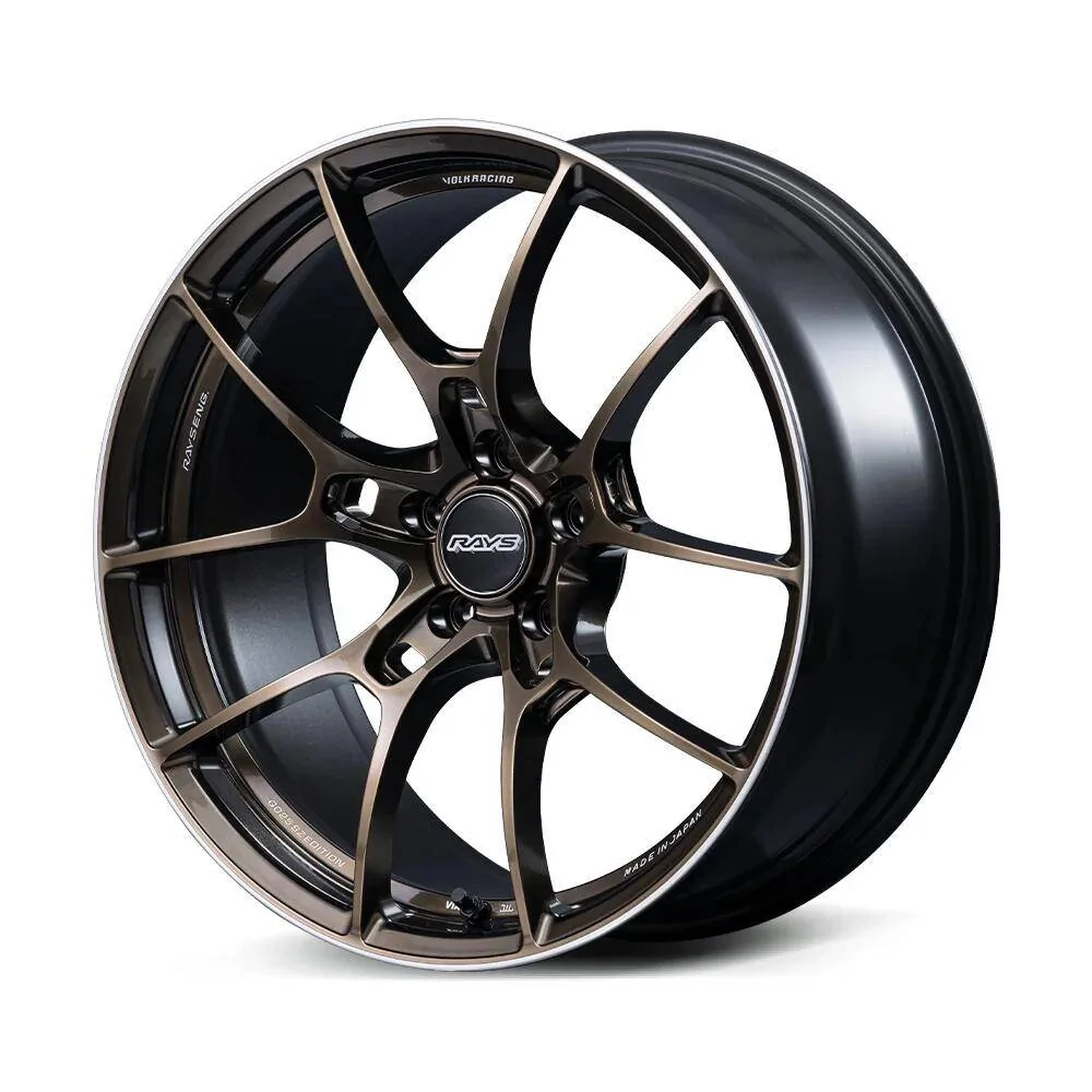

The price makes sense. Maybe another way to look at it is not so much Apex is a "buget" wheel, but there are wheel brands that are premium.
For example, there's about a ~$300 delta between a VS-5RS and a Volk G025, even on sites like Black Hawk Japan (~double the price apples to apples but import fees should be taken into consideration). I imagine the finish to be infinitely better; you can even tell in pictures.
https://www.blackhawkjapan.com/products/rays-02269954421sz?_pos=3&_sid=d642a14d7&_ss=r

Now I want those wheels! Damnit! You think the $701 per wheel includes all fees? That's a nice sale.
I may have to go back to Enkei to afford a dedicated track set.
That's a good take. Agreed "budget" might not be the best term. Quality products, and a good step above most flow formed wheels. Barrel designs are generally strong too from the.

I honestly don't know. What I do know is that I was dead set on the G025 until I found out about availability. I couldn't get a set within 6 months.
Black Hawk is interesting, tons of great feedback from other forum members but without any personal experience I can't comment. Their prices do seem almost too good to be true, and who knows how the recent tariff conversation will impact things now or in the future. I am a big fan of my Apex's, but the Volks continue to call out to me! I will probably have them one day, but for now I have many other priorities and the Apex's work just fine.

The style is similar enough too.
I'd love vs5rs in motorsports gold. That's a really good combo with red.
