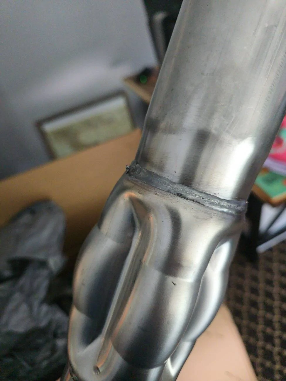

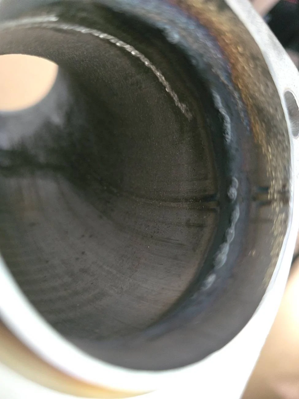

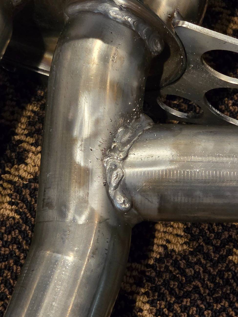

Well, Borla exhaust arrived today... The curse of the Integra continues...
I knew I was getting into a slip fit exhaust so I wasn't expecting quality there, but I was disappointed to find the tubing has seams everywhere, globs of rough welding, mountains of shavings inside the piping, and the general exterior is pretty scratched up. Most of this is trivial and meaningless, but the seamed pipe has a likelihood to rust. The most disappointing thing is that the helmholtz resonator has a bunch of metal shavings inside of it and they rattle tremendously any time the exhaust moves at all. I can't imagine that would be silent once on the car.
I sent an email to Borla, so we'll see what they say.
@egxflash did yours come with all the metal shavings and rattling from the muffler section?

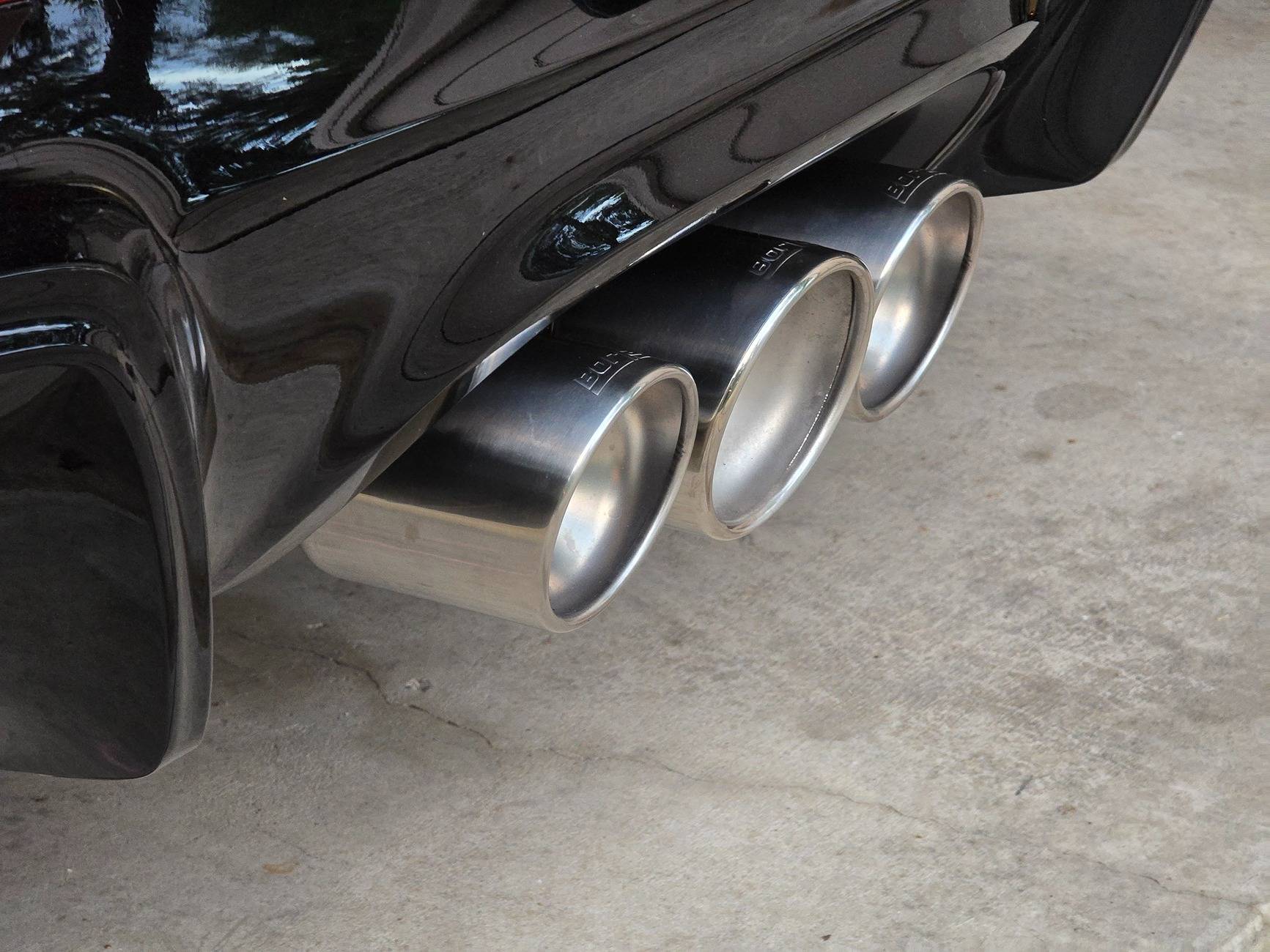

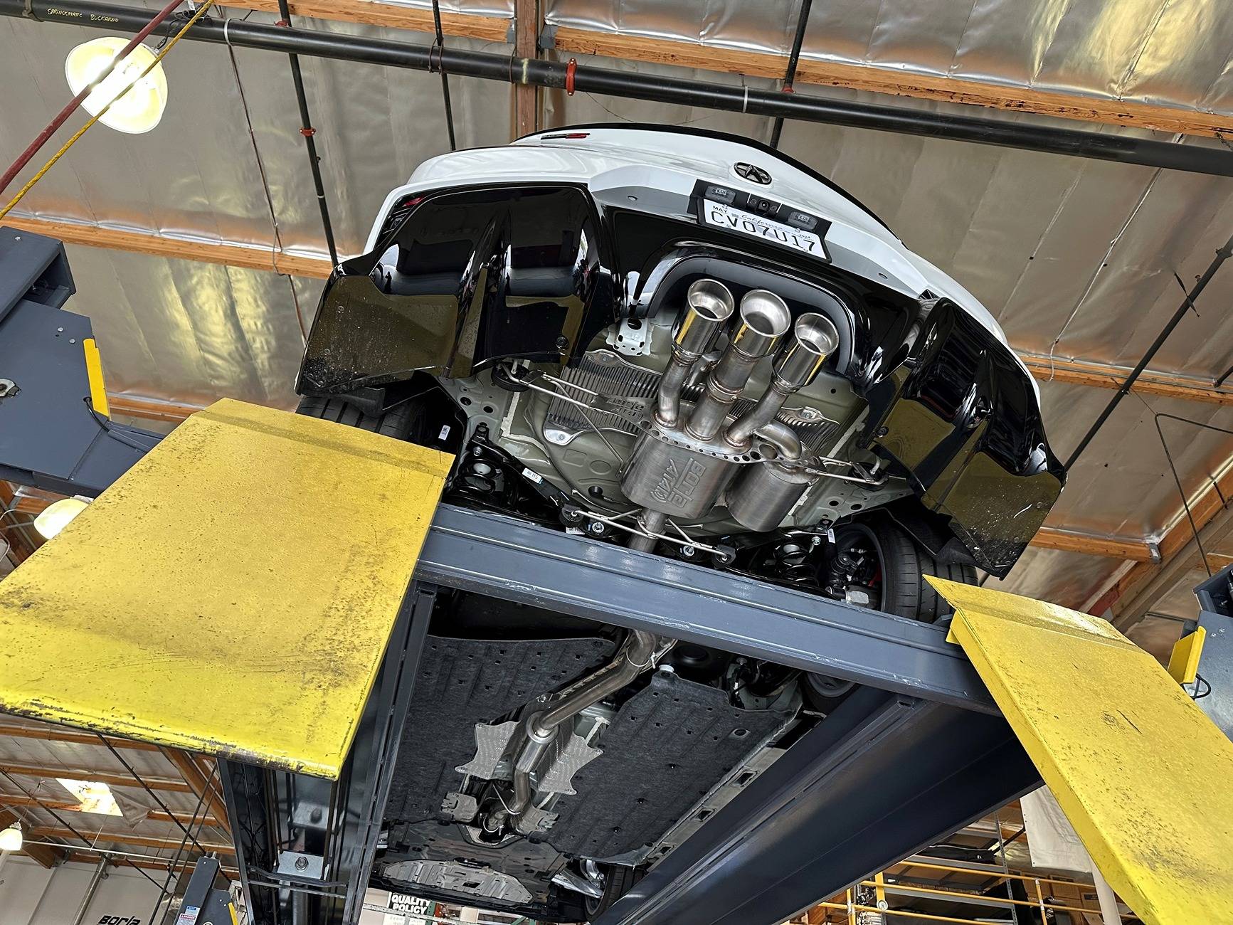

Since they used my car to test fit, I left the car with Borla and they installed everything on for me. From what I could see underneath the car, I don't have those issues, but to be fair I didn't see inside the pipes.
No rattling for me either (at least not from the exhaust - interior pieces is a different story). For what it's worth, here's a piece of info I gleaned during this whole exchange: when I asked what I'd be getting - a prototype or the production, he said the prototype but that's probably best for me since they have to get that one perfect for them to base their scans or whatever off of. Now, whether that's true or not, I'm not sure.

Yes they're correct. Once they create the model, each stamp out from the factory after is going to be + or - some range within a spec. For example, my exhaust tips are slightly closer on the left two than the right two. By about 2mm, which almost no one would notice.

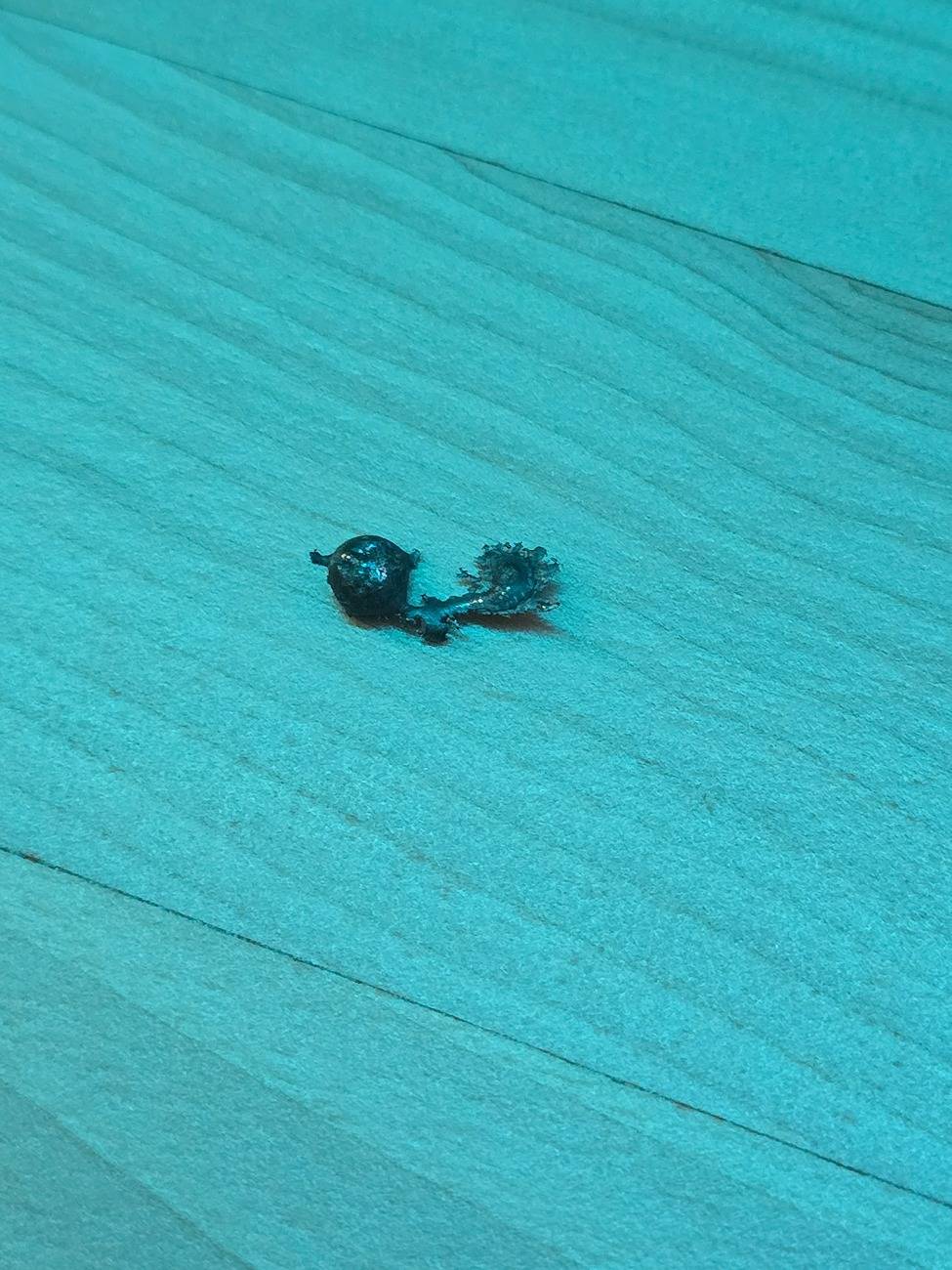

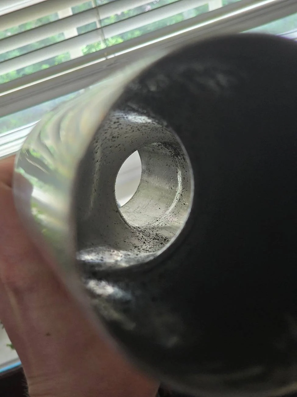

I was able to get my smaller shopvac attached to some 3/8" hosing and get the hose into the res. With a lot of shaking and suction I pulled quite a few metal bits out. It's finally not rattling, but there's about 2 or 3 small granules left.
Here's an example of the size of the bits of metal coming off:
I wouldn't be very happy myself if I got what you got tbh. I hope Borla makes it right for you. They're good folks and they're a local company so I'm rooting for them but there's enough competition out there now.

Borla was willing to send me a new muffler section but they were a couple weeks backed up. They were able to tell me what the inside of the muffler and helmholtz looked like, so that helped me visualize where the metal was.
After a lot more vigorous shaking the metal chunks fell out and now there's no major noises from the helmholtz.
They did confirm the welds were consistent with their manufacturing process and they stand by the function more than the appearance.
It's not quite the product I'd expect for the price, but as far as sound goes I don't see any other companies doing sound tuning to this degree. I'm excited to hear it once it actually goes on!

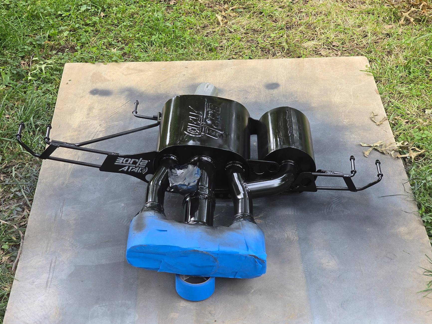

I went ahead and painted the muffler section with header paint because I want it to blend more. Primer, black, and satin clear coat.

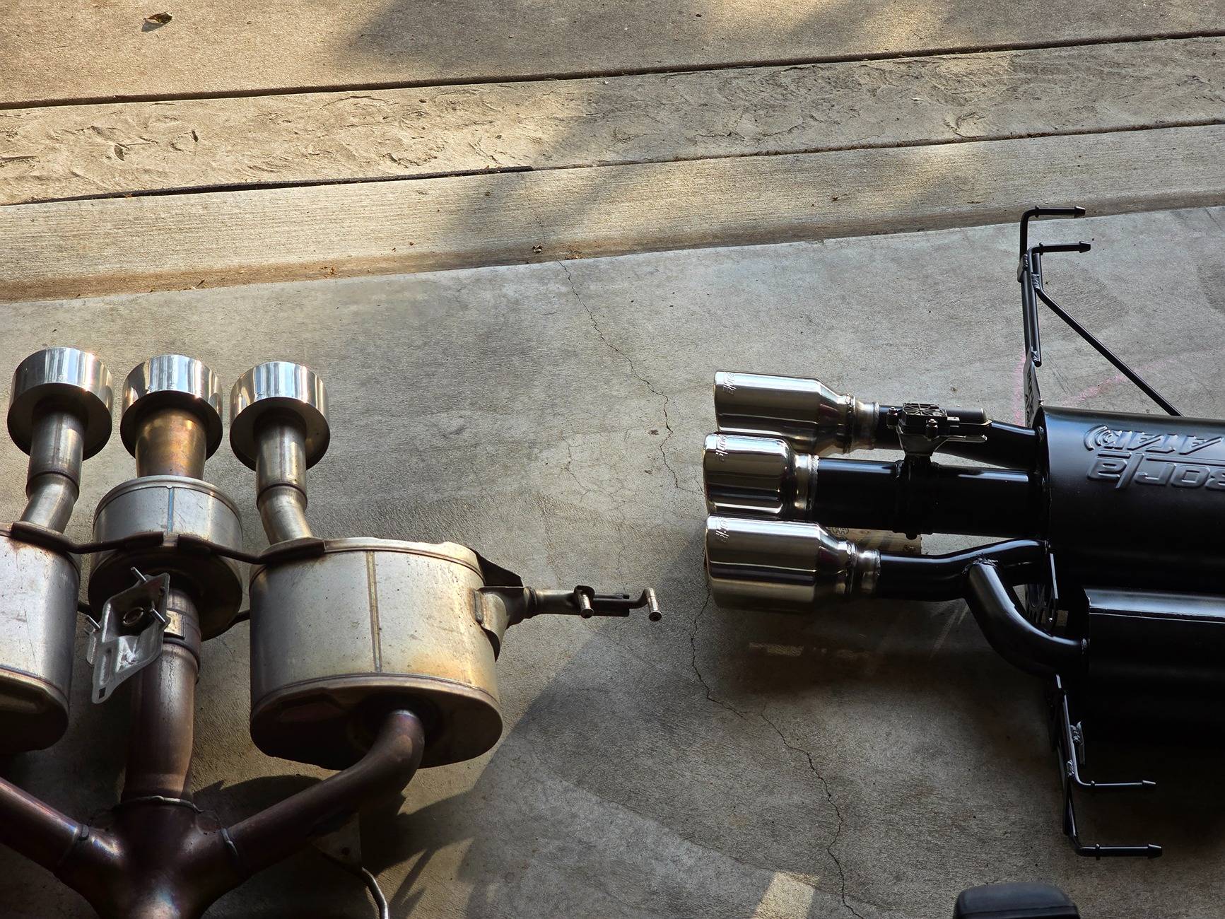

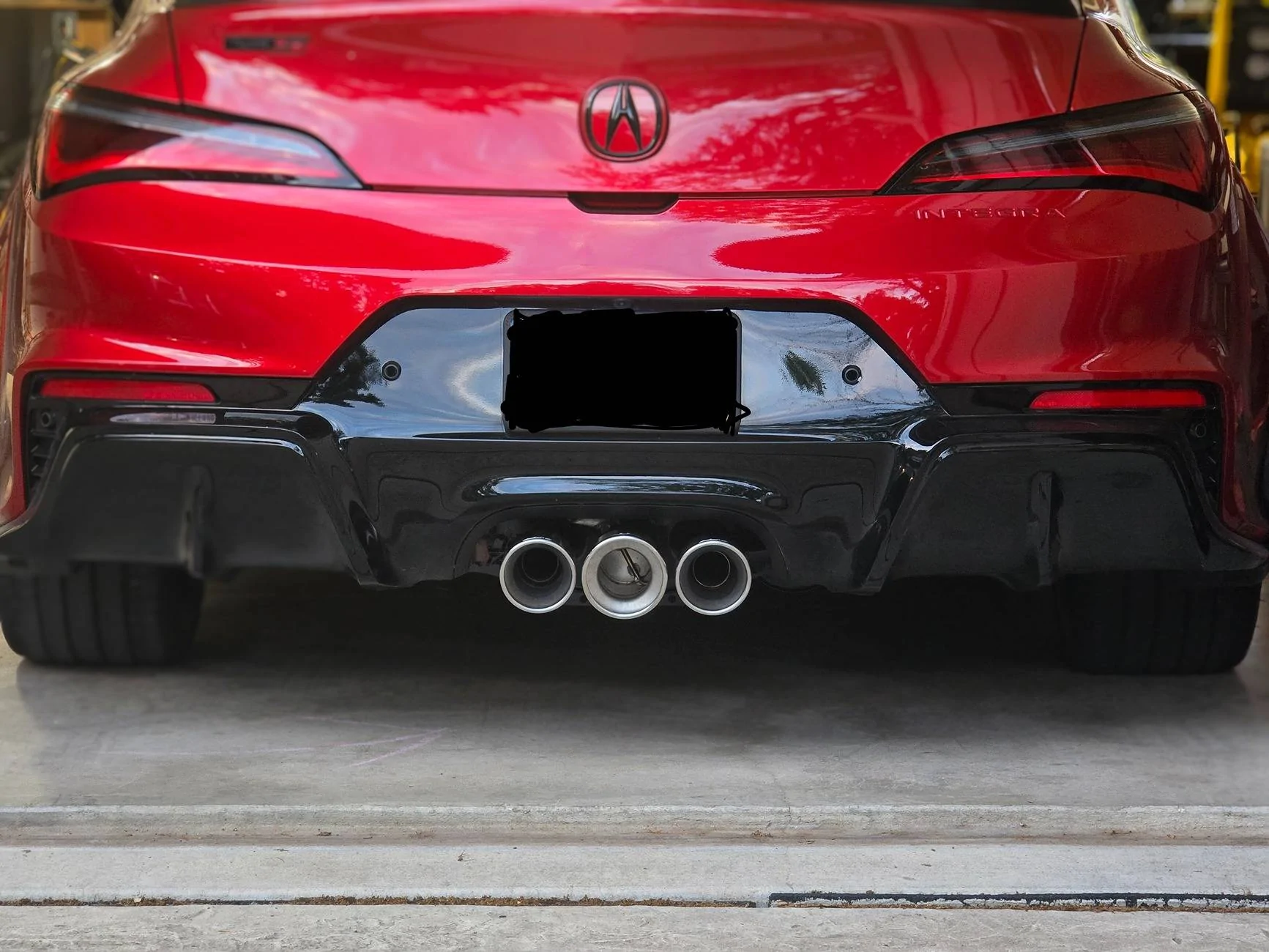

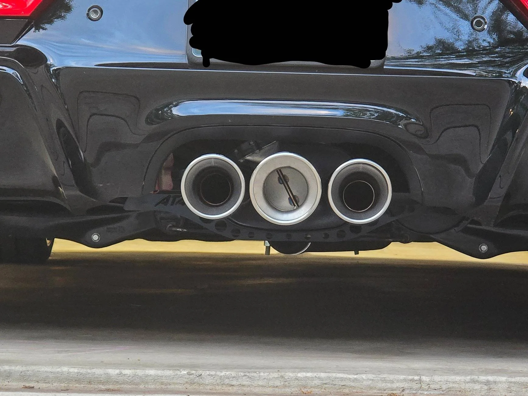

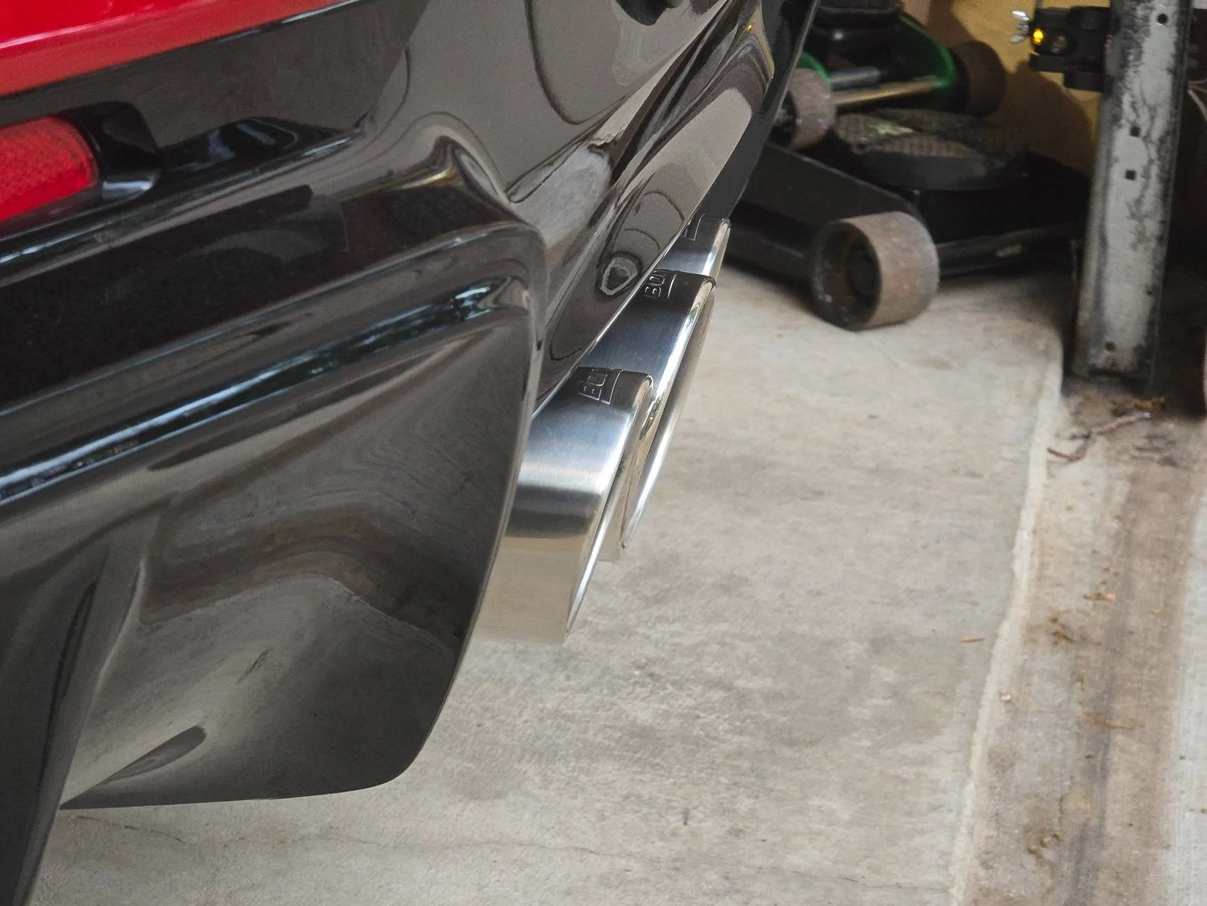

Well, it's installed. I'm a borla believer now. The pitch is slightly higher with the helmholtz, and in comfort it's louder but a bit more pitchy (good thing). Not so much louder that it's obnoxious but loud enough to hear it cruising along now. Sport and sport + it's a lot louder. The bangs are more noticeable, but I feel in sport it's more than good enough for the street now. It doesn't sound sanitized anymore, which is fantastic!
Comfort is pretty damn comfortable isn't it? I think it's between stock comfort and stock sport with it being closer to comfort.
I definitely agree with you on sport mode being good for everyday cruising. On the stock exhaust I was on sport+ 100% of the time but it pops and bangs a TON on sport+ now.
Curious - what'd you think about the two smaller tips on the side? A lot of people on here were super against it at first (and I wasn't crazy about it either) but I've grown to like it.
I'm still working my way into the break in, so I think comfort is closer to where sport was before, but I do think it will warm up a bit and soften as it gets miles and probably move more towards comfort.
I actually like comfort a lot now! For zipping through busy traffic it's the perfect volume.
When no one was around the other night during a takeout run, I had a blast in sport+. I don't think that would fly in traffic without scaring or angering people ?.
You know, I didn't like the tip design in photos but it's grown on me in person. I don't even notice they're different sizes and the rolled edge helps minimize their size a bit. I still wish they had a resonated option with a sharp angle edge, but that's always solvable with an Ali express order.
The only downside so far is that you just can't fly under the radar. Even in comfort, every pony car or import with an aftermarket exhaust wants to Rev at me, lol. Lots of attention, especially in a red car.

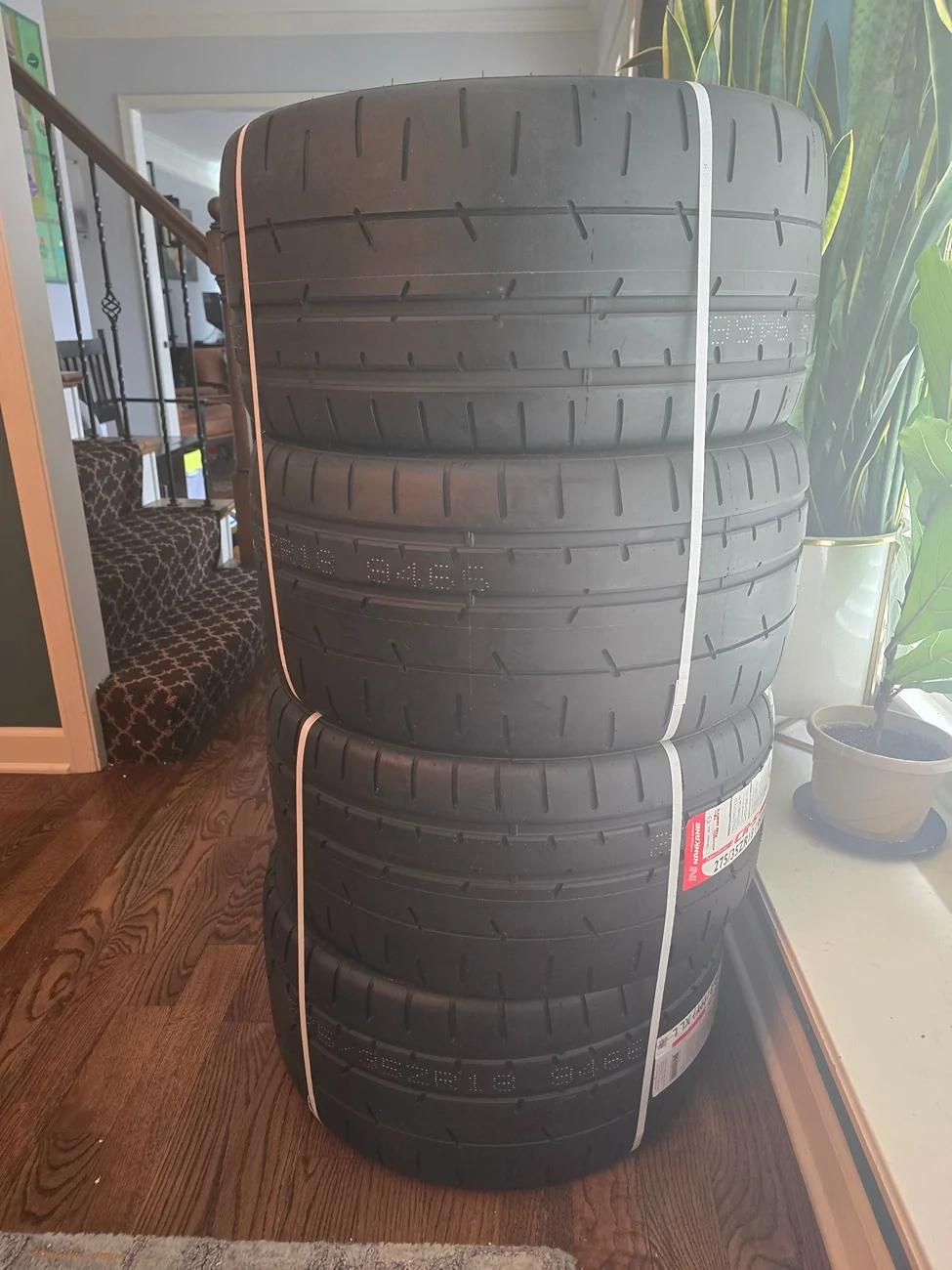

Also, new rubba!

The only disappointing thing was the nankang crs v2 tire. They definitely grip okay, but their life is poor. Well managed heat and pressure still led to the fronts being worn down to the wear bars in just 4 sessions. That's telling me these tires will likely last about 16 sessions total (or about two full weekends) before they're totally toast. Better to be on a slick.
