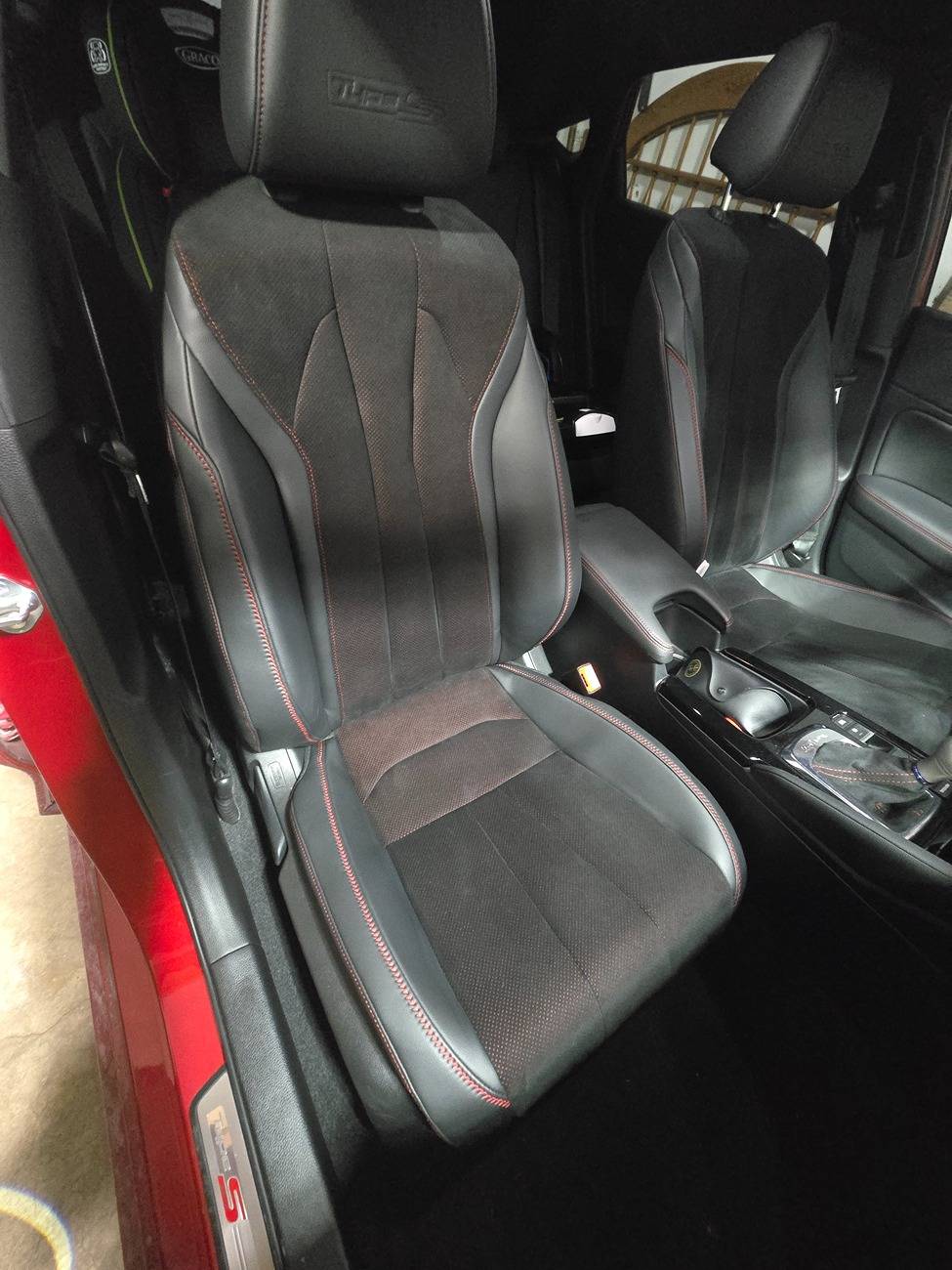

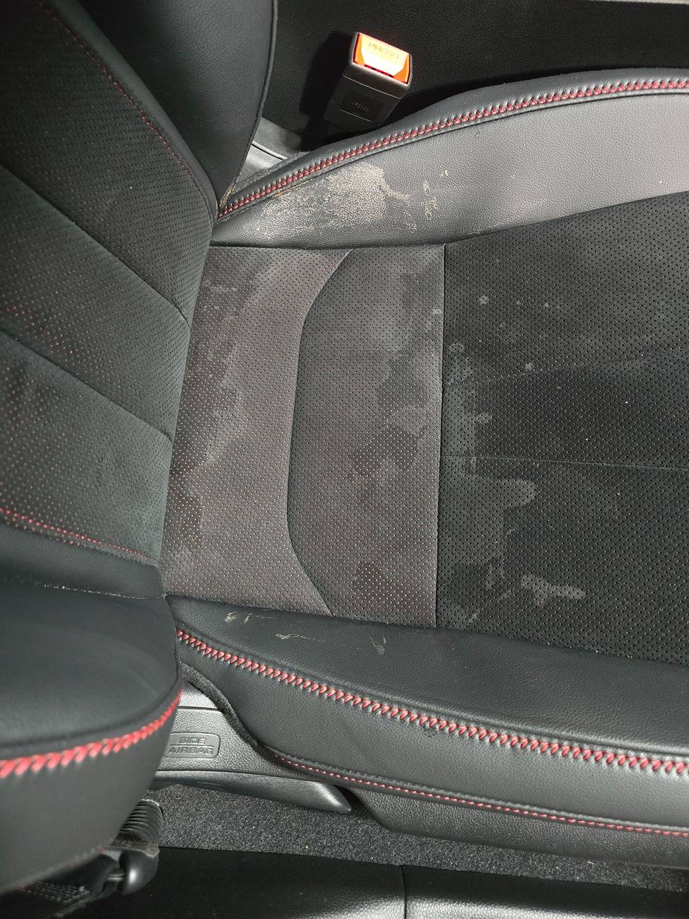

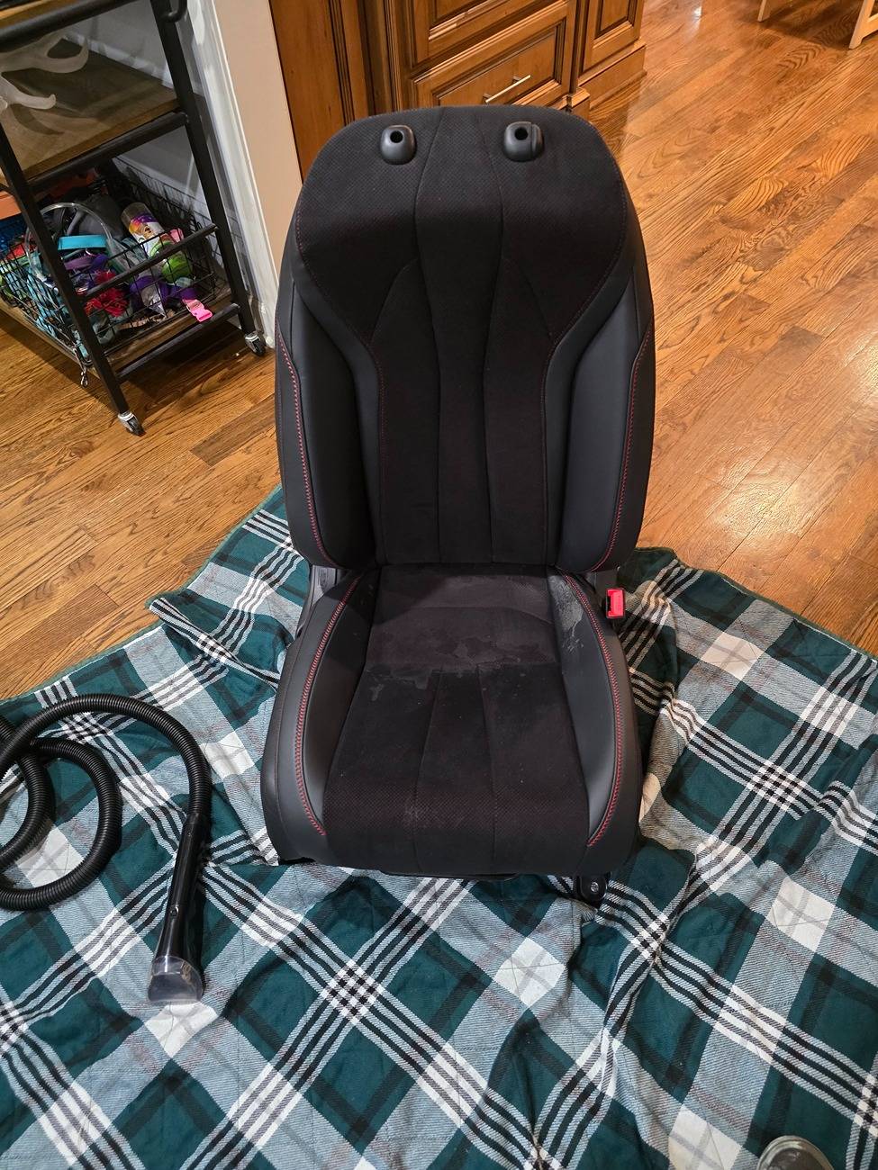

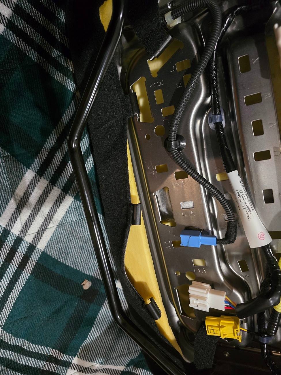

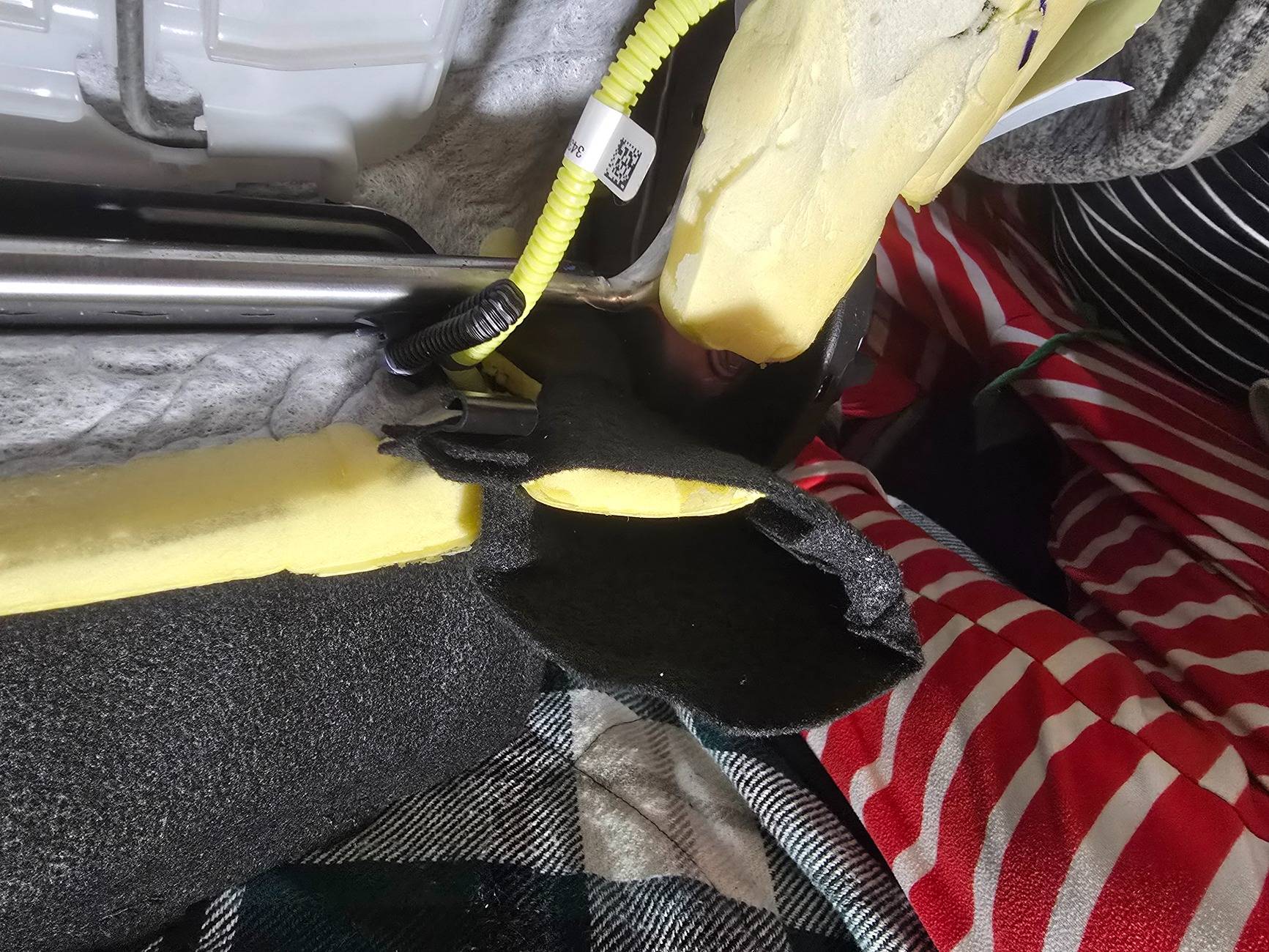

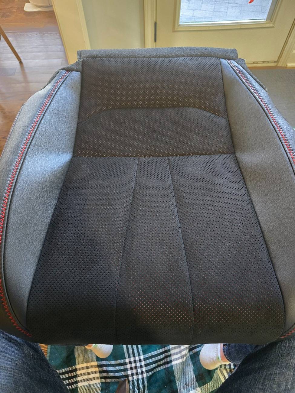

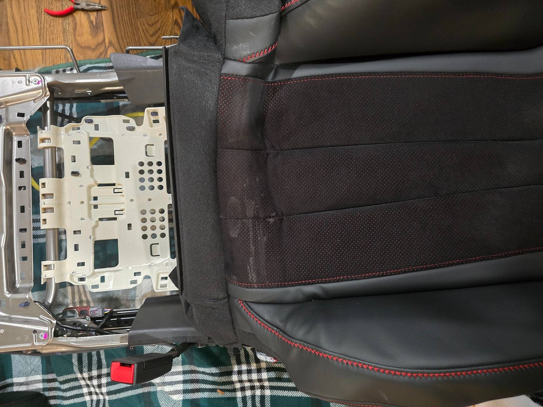

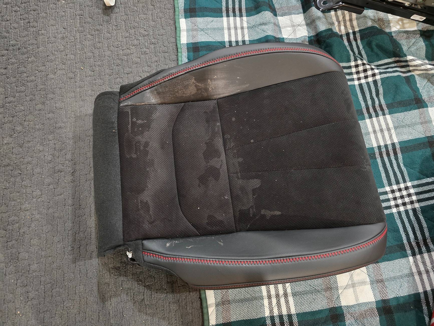

Well, on Friday I spilled a chocolate protein shake into the passenger seat of my car. Yes, I violated the cardinal sin of no food or beverage in car. Given it's milk and whey, time was of the essence to clean it up before it would ferment. This was bad, really bad... I almost just blotted it and sold the car bad. In the end it took me (and my upholstery bissel) nearly 10 hrs total cleaning to get the stains, crunchiness, and chocolate smell out. I decided to take the whole seat apart because it's easier on the back to do inside and I wanted to get all the nooks and crannies.
I am tremendously more appreciative of these seats now!! They are the first thing on this car I feel was well engineered with forethought. The build again is crap because multiple clips were loose or off and the entire seat cover itself isn't pulled tight enough from factory. This explains why almost every its I see has wrinkled leather on the passenger seat bolster and why they feel so loose compared to other vehicles. The good news? The microsuede is waterproof!!
Fun fact, these seats are NOT Alcantara! They are microsuede! This means they're more durable and you can be A LOT more aggressive about cleaning them!
I went slow, started with blotting and drying first, then tried sonax blotting, and eventually gave up and went to the bissel. With the bissel I also used a concoction of baking soda and water to get the chocolate smell out. This was tough work. I would not trust a detail shop to do this unless they're charging you nearly as much as two new seat covers. It's a lot of labor.

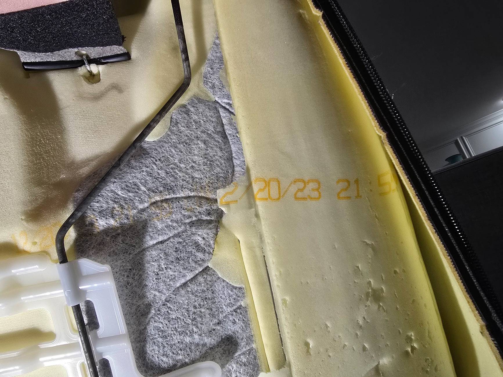

In the process, I also discovered these seats were made in Jan and Feb of '23 which lines up with my "car is built and sits around for certain parts" theory. I know someone contested this saying the car is built in a month or two, but given the date stamps I've seen all over i just can't fathom that's actually true, especially since we know the tranny is shipped from Japan.
Anyway, here's photos of my idiocy and work.

Punishment fits the crime. That's arguably the worst spill I've ever seen lol.
Looks like you did actually get rid of all of it though. That could have been a totaling event for most of us.

Years ago my godfather spilled milk in his car in Florida. To this day that smell is singed into my nostrils. From that I knew time was essential and getting all of it up is a non-negotiable!

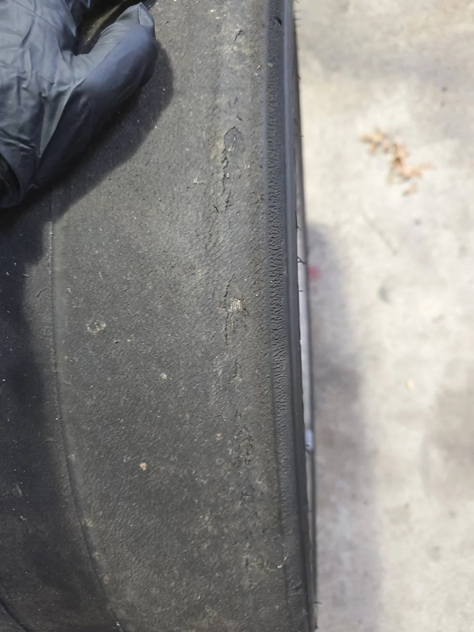

Here's how you know your tires are definitely done:
Acura Integra Back on Track 568e3c05-9a0f-4c8e-97a4-ba1271a45abd
These are toyo RR and have only 22 sessions on them. I'm getting my racecar ready for next weekend where a friend will shake it down for me while I instruct and drive the its. The toyo tires are complete crap. Don't waste your money on the rr or R888r. They're easily 2.5s off pace a Hoosier R7 and more like 3 to 3.5s off a Michelin medium slick. For this coming weekend I'm going to swap on some R7 that have 20 sessions on them and will likely get another 6 to 8 sessions. They're totally heat cycled out so they need 3 laps to regain grip, but that's enough for a shake down.

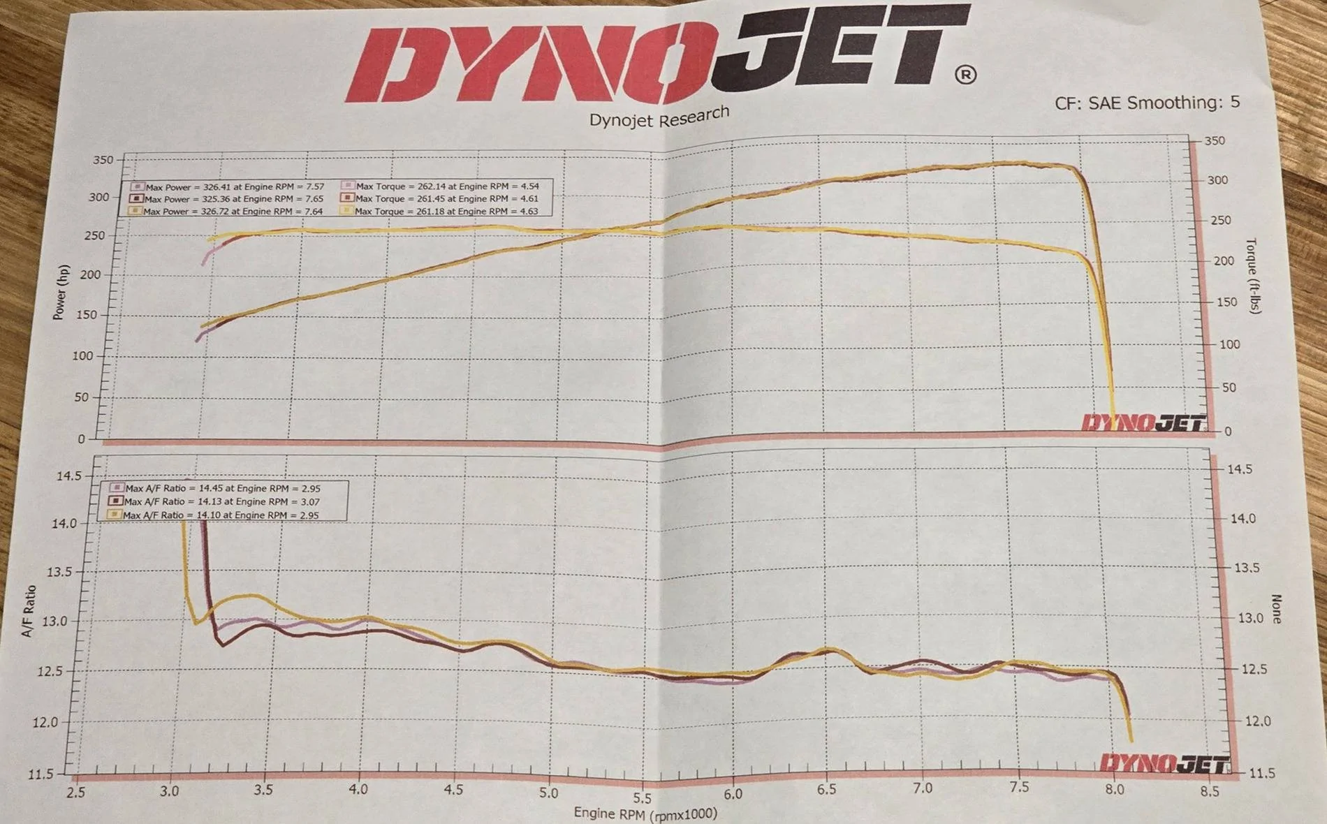

So I got a yearly dyno done Friday on the z after all the maintenance. It picked up power as it heat soaked and the dyno operator and shop owner both mentioned it's the most consistent car they've dynoed in a long time. It made a peak 326whp on a dynojet dyno (mustang would be 360 or so) and if you account for drivetrain loss it's making about 400 crank. Here's a photo of the last 3 runs after an initial 4 runs. They specifically ran a small fan to ensure I'd get typical post track conditions for when we get pulled for a post run dyno.
I also took the Integra out. It did well and was fairly fun. The ps4s are a huge limiting factor on fast tracks and warm days. Unfortunately I didn't get a decent video because I had two students and the sessions were stacked pretty closely, in addition to supporting my friend driving my Z. Busy busy busy!!

What do those VQ's make on a dynojet stock? I haven't had hardly any seat time in a z/G3x, but primarily that's because I was actually severely disappointed when I first drove one with the power. I didn't hoon on it, but the G35 I drove felt anemic just driving around on a test drive. Anything over 300 whp (that isn't an s2k) would have to "feel fast", but stock I just couldn't get over how slow it felt, and it never made sense to me. Did I drive a lemon?
Also regarding the ITS; I'm very much looking forward to upgrading tires. But also very much not looking forward to what will likely be a yearly expense... I've pretty much decided on the Nankang CRS v2. Seems like a good fit for dual-duty autocross and HPDE (with the obvious fact that the RE71 is not available in a 19" size I'd want), but I imagine they won't survive any longer than the expected 5-7 autocross events and up to 2 HPDEs I plan on averaging a season.

The vq37vhr in the g37 and 370z makes about 270-280whp stock. So FBO nets a decent amount. Even at 326 whp it definitely feels anemic down low. It's an engine that NEEDS to be wrung out. An around town putter it's not. That's where the its shines because of its down low torque, but the its also doesn't feel like it's getting faster the higher you rev it out.
My buddy that was driving my z this past weekend felt he had no power until I explained it's not Rebecca from accounting, it's that spicy little redhead Jessica from finance and she likes it rough. He got the picture and started dropping a gear earlier, letting the revs shoot up, and tossing it into corners like the momentum car it is. Total game changer. It's a car that tells you quickly when you make a mistake or you short shift, but it's also forgiving when you toss the rear end and incredibly progressive on slip angle (a la drift car legend for a reason). The flat wall of torque may not be huge, but it certainly provides a consistency that no turbo engine can match.
I've considered eventually going ham on it with cams, billet oil pump, balanced crank, and making 390whp at 9000rpm, but that would bump it up a class and tear up tires and brakes even faster, lol. As it stands I eat front pads in 24 sessions and rear pads in about 64. Hoosier R7 are done at 12 heat cycles and trashed by 24...corded around 30 and they run $2k a set.
