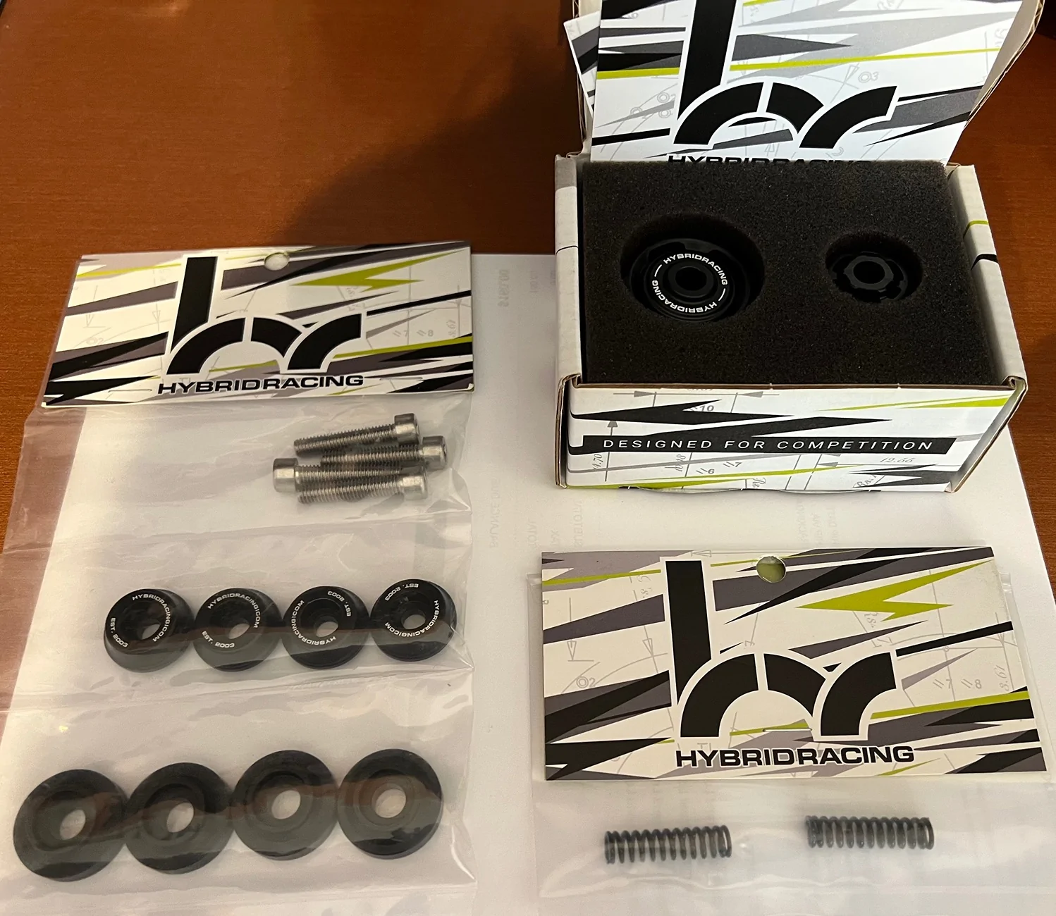

I’m adding the following items to my Hybrid Racing shifter this weekend just to crispen the entire shifter assembly. I’ll report back once installed.
- Hybrid Racing Shifter Cable Bushings
- Hybrid Racing Shifter Base Bushings
- Hybrid Racing "Heavy Duty" Transmission Detent Springs
Have you ever finished this install? I personally have almost the same mods, just different brands, and I find the shifter way too stiff and brutally hard to enter reverse. I'm thinking of undoing the Hybrid Detent Springs.
You're the second person I’ve heard say that about the detent springs when matched with an aftermarket shifter and cable bushings.
I haven’t installed the detent springs yet. I will be doing the base bushings for sure tomorrow or sometime this week.
Do you happen to know where the other post was? I think the detent springs by themselves were a good balance, very mechanical feeling. After adding the shifter cable bushings, the gears were not too bad, but the reverse is unbearable.

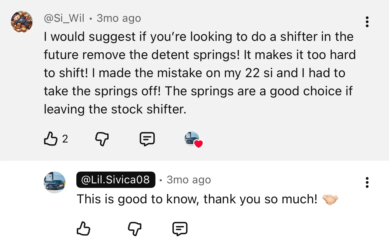

Please post up your results here too, after you install the detent springs.
Also, from hybrids website, it seems the detent springs will only affect the throw play while the "gear selector springs" kit affects the gate play.
I'm hesitant to change either of these out until I hear from a trustworthy source that the play is meaningfully reduced by installing these. Thanks!
It was a comment I saw while watching a few install videos on YouTube.
Nevermind... They're cheap. I bought em and I will report back. I might just install one of them: whichever controls the lateral detent.
