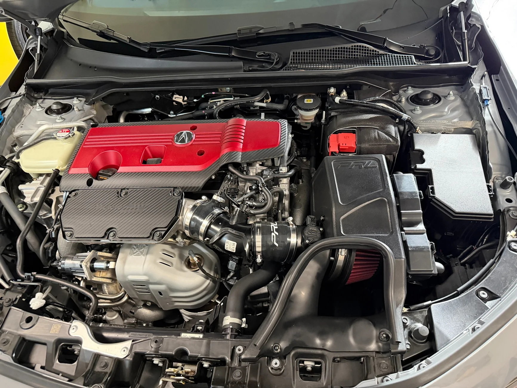

The intake is great but honestly, the TSP + PRL isn't as loud as I was expecting. What are people doing for more volume? Would like to retain the factory valves and zero drone is a hard requirement.

PRL HVI w/ AEN filter and TSP downpipe + PRL front pipe.
Bumping up to a 3” exhaust will help with volume. There’s also the borla, the only 2,75” option but I dunno if a dp overwhelms the polyphonic thingy? I assume not but maybe wait till either folks agree or correct me
Regardless. Dont go crazy. Stay away from the invidia r series and awe track and the other louder ones. You having a dp now, it could end up being too loud and or droney bro.
With high flow dp comes high flow responsibility.
Honestly, driving it more, I think I'm ok with the volume I have now. I'm able to hear it over the music which is basically good enough for me. I can also just turn it off if I want to hear it more lol.

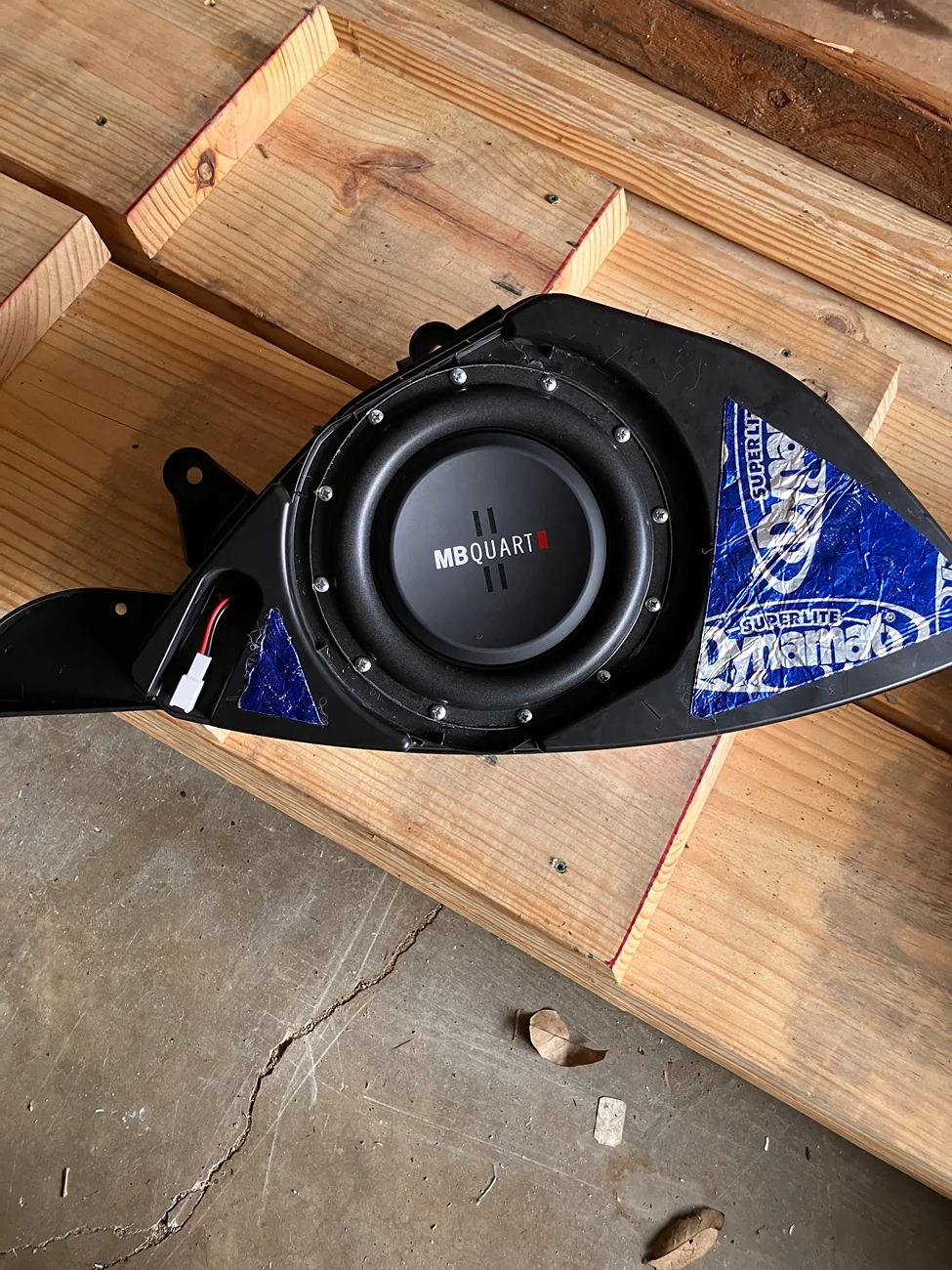

Installed the MB Quart sub today along with adding ResoNix sound deadener and absorber to the inside wheel wells... Will take if for a spin later to see what kind of difference they both make.
Any update on how much of a difference there is?
In my case. About 10% stronger more pronounced thump. At about volume 10 and up it’s a lot more tho. It’s like it’s on a weird curve. At about volume 13-15 it Genuinely feel like 20-25% more thump
The inside of the box was filled with that stuff tho. Whatver it was called. How ever much you think you’ll need buy more. That little box takes a lot surprisingly. Maybe it wa called poly fill?
for 60 bucks and like 60 minutes of work. It’s worth it imo
Plz keep my observations in the “this guy isn’t an audiophile at all” pile tho
