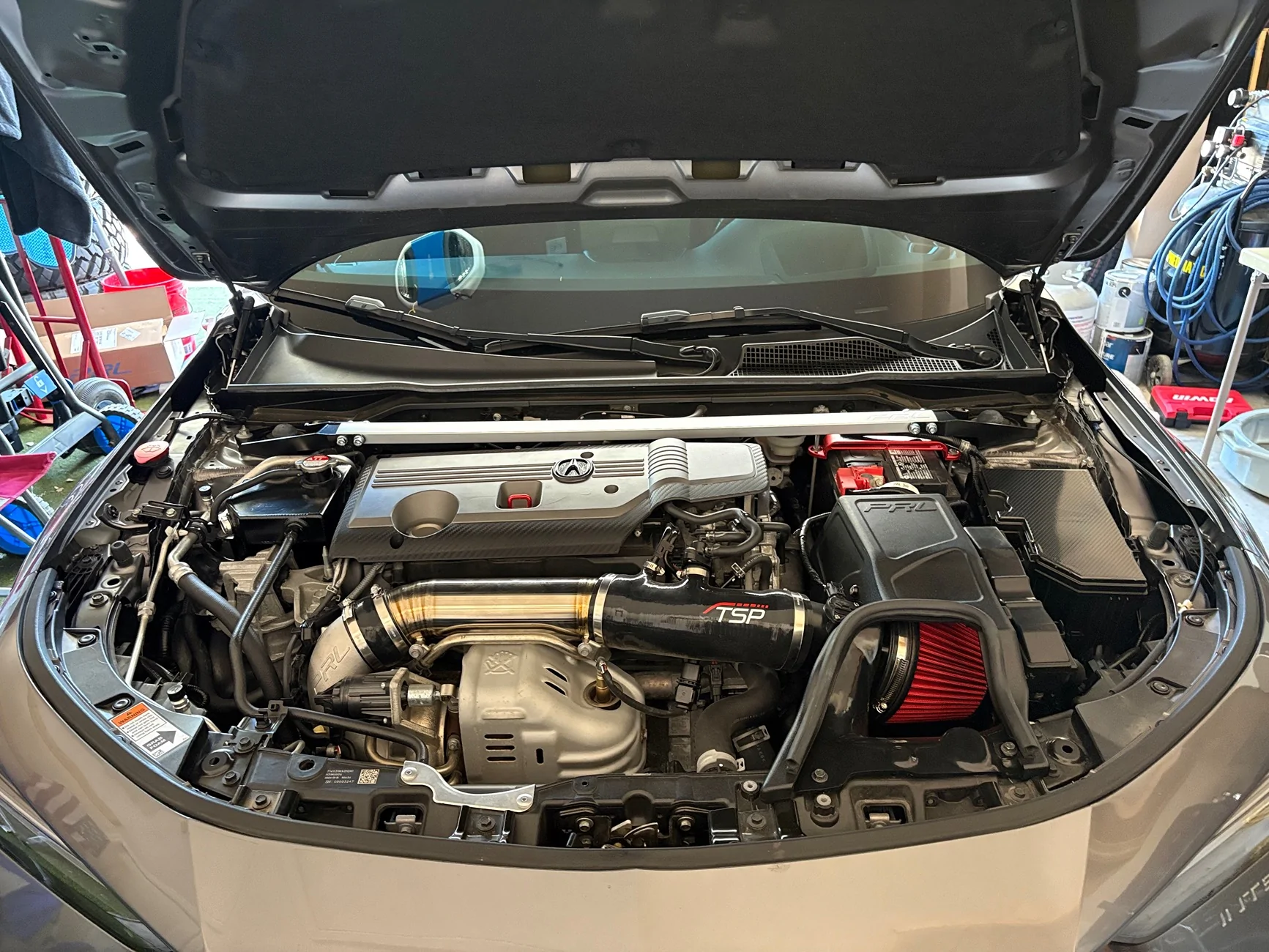

He was also seeing iat in the 180s 😳. I told him to remove the stupid drip tray under the louvre and his iat immediately dropped into the mid 130s. Still roughly 40F over ambient, but I believe with a turbo blanket and reflective foil like I did he should be able to get it down another 20F. The blanket is worth probably 10-15F and foil another 5-10F. 20F over ambient is a really good place to be.
Do you put the drip tray back when you’re not at the track or drive it like that daily
I was thinking of modifying it/ keeping the right side so it still protects the airbox inlet but is more open from the center over. Keep some rain out if I do have to drive in wet weather

I pop it back in for street. Takes like 30 seconds because it's just a few 10mm bolts. Honestly though, I rarely drive the car when it's raining because visibility is meh, wiper sprayers are trash, and Midwest roads are garbage so I'd rather take one of the SUV.

What drip tray are yall talking about? Is it that little aluminum looking thing that gives access to the oil filter?

Nah. Lift the hood. The black metal thing under the louvre (vent) on the hood.
Oh. So why the hell is it there to begin with? That’s the thingy I’m not supposed to touch cuz it’s always hot right? The hell is its purpose
just guessing, I assume at lower speeds it allows air to funnel easier for the sake of keeping lift low in the front? By removing it I think it’s less functional till you’re at a much higher speed? But then I guess that wouldn’t explain the better temps? Hmm

It's literally a rain catch and drip guide. The water raining in from the louvre flows down through the catch and then drips down the hole at the bottom to land forward of the turbo and engine and right behind the radiator.
The factory louvre is actually incredibly well placed! The most effective louvres are right behind the radiator because that's a source of hood high pressure, clean air flowing over top, and a great place to extract hot air directly behind the radiator. This is ideal (and the way the gti tc car actually places their louvre). I really don't understand why the hrc hood louvres were placed out the way they are. It's a lot less efficient that way, extracts from the sides of the engine, and their only benefit is that they're larger so they flow more air out. Typically on racecars you place louvres there because of bracing that exists in the center section when you're retrofitting, but the factory hood already had it right. They should have just made it wider and longer with a tall wicker and called it a day.
